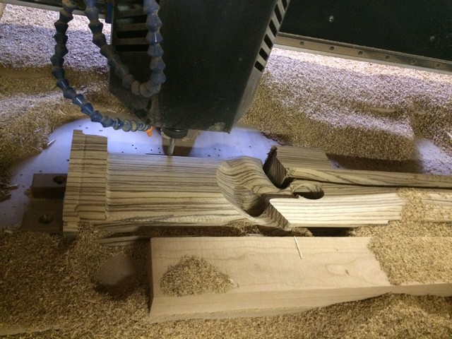

Just thought I'd post an update. My build has been delayed a bit mostly due to lack of budget but I finally got going again. Got lucky and a friend contacted me to cut 6 x bench-rest rifle stocks which helped a bit for the hobby cash-flow. My stock making hobby is what what got me into cnc in the first place :-) Here's a pic of one getting cut
http://www.mycncuk.com/attachment.ph...id=15330&stc=1

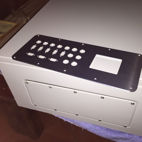

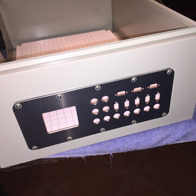

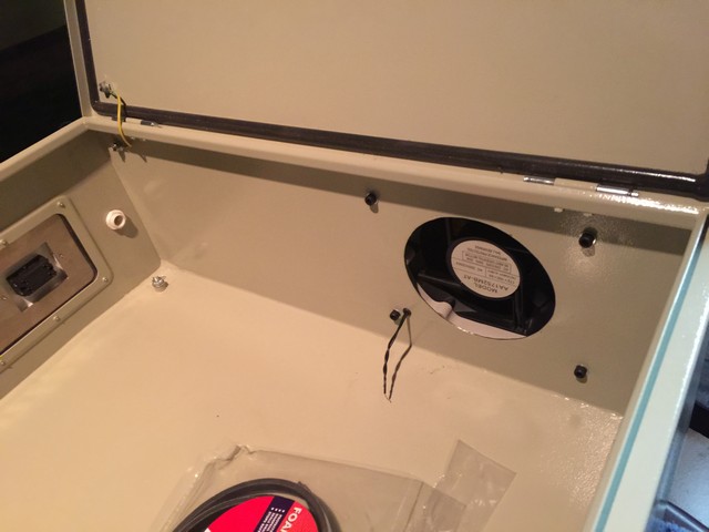

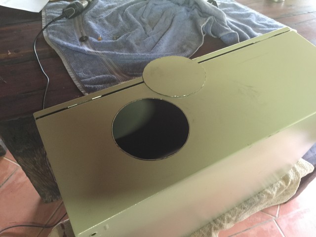

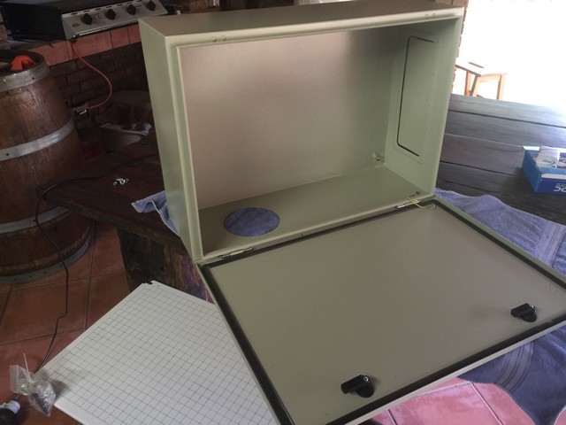

Anyway back to the topic. Got a nice 800x600x220mm steel cabinet for a very reasonable price (+- 70GBP). I was concerned about my ability to cut holes etc in the steel but got it done relatively painlessly using a Dremel and those small clip-in cutting disks.
http://www.mycncuk.com/attachment.ph...id=15334&stc=1
I cut a alu panel to replace the steel one that came with the box.
http://www.mycncuk.com/attachment.ph...id=15333&stc=1http://www.mycncuk.com/attachment.ph...id=15341&stc=1

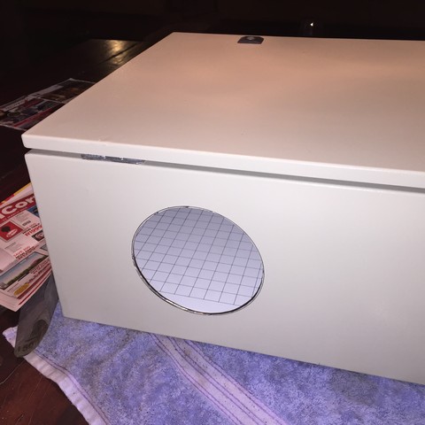

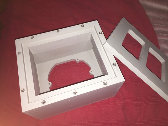

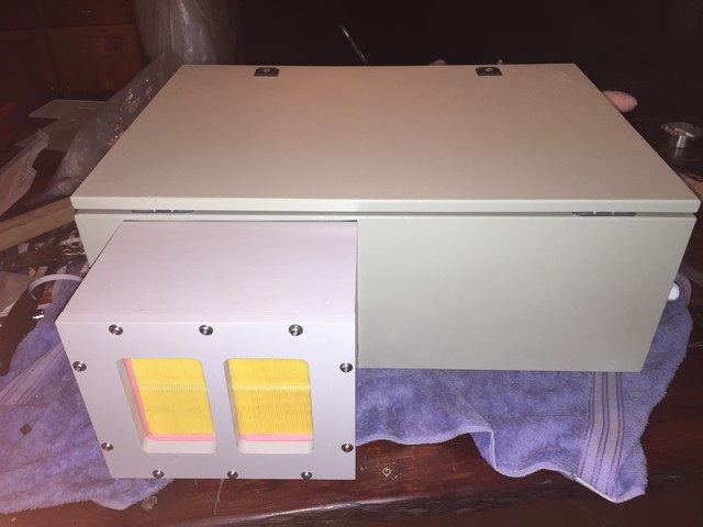

I made an air filter box with a cheap car filter to house my huge fan and keep stuff out of my control box.
http://www.mycncuk.com/attachment.ph...id=15338&stc=1http://www.mycncuk.com/attachment.ph...id=15339&stc=1http://www.mycncuk.com/attachment.ph...id=15340&stc=1

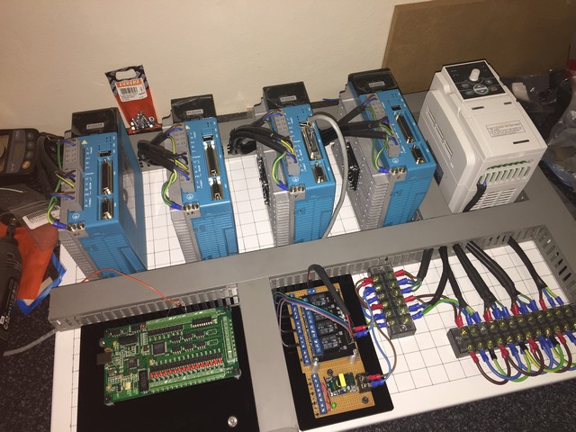

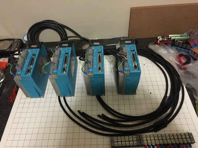

I think I have figured out what I want to do with my wiring. I'm a bit further along but these were the last photos I took.
http://www.mycncuk.com/attachment.ph...id=15336&stc=1http://www.mycncuk.com/attachment.ph...id=15337&stc=1

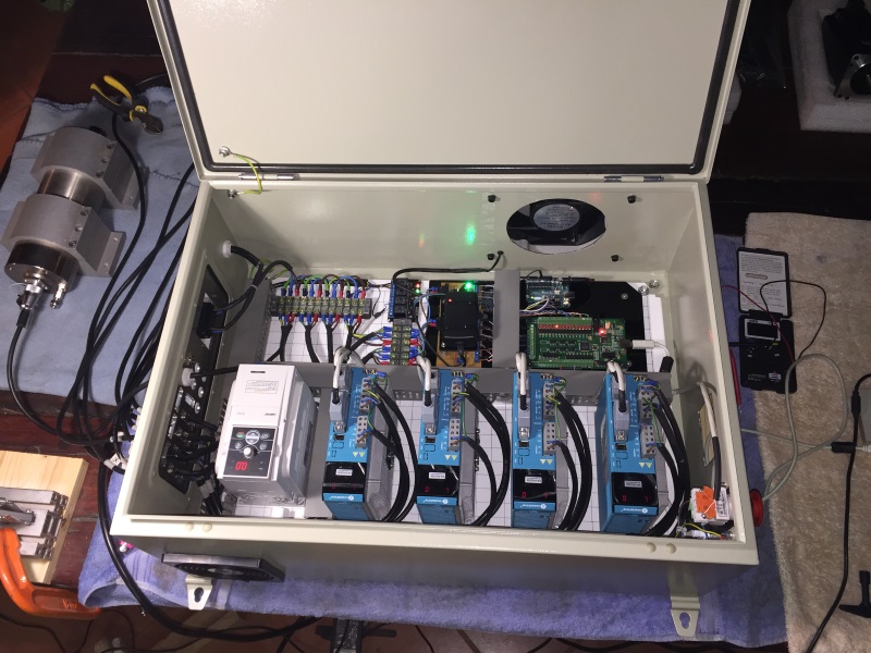

WHOOHAA, its running! :excitement:
Finally completed my control box. Decided to chuck 4 of the safety circuit relays and replaced it with an Arduino which resulted in a simpler overall setup. E-Stop button works as expected and any fault or position loss will stop all motion.
http://www.mycncuk.com/attachment.ph...id=15522&stc=1

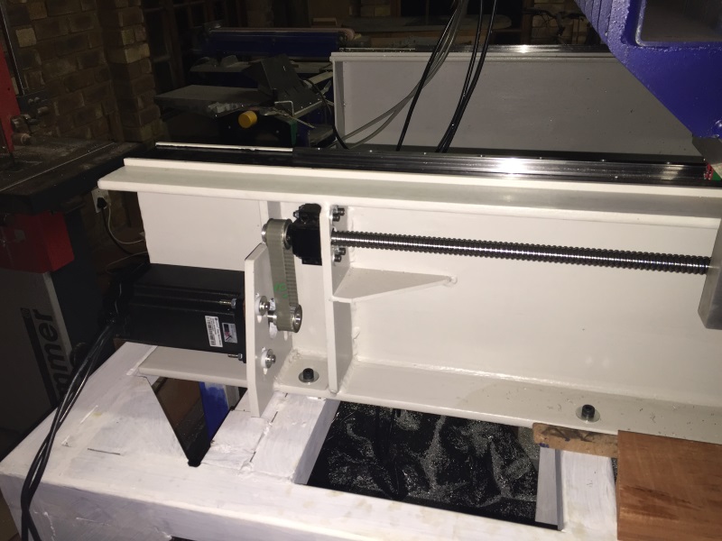

Steppers now mounted
http://www.mycncuk.com/attachment.ph...id=15524&stc=1

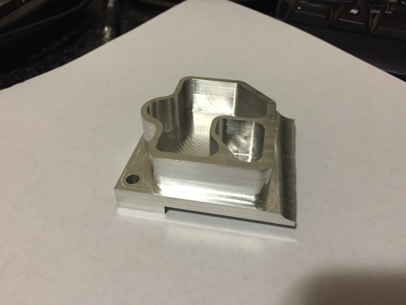

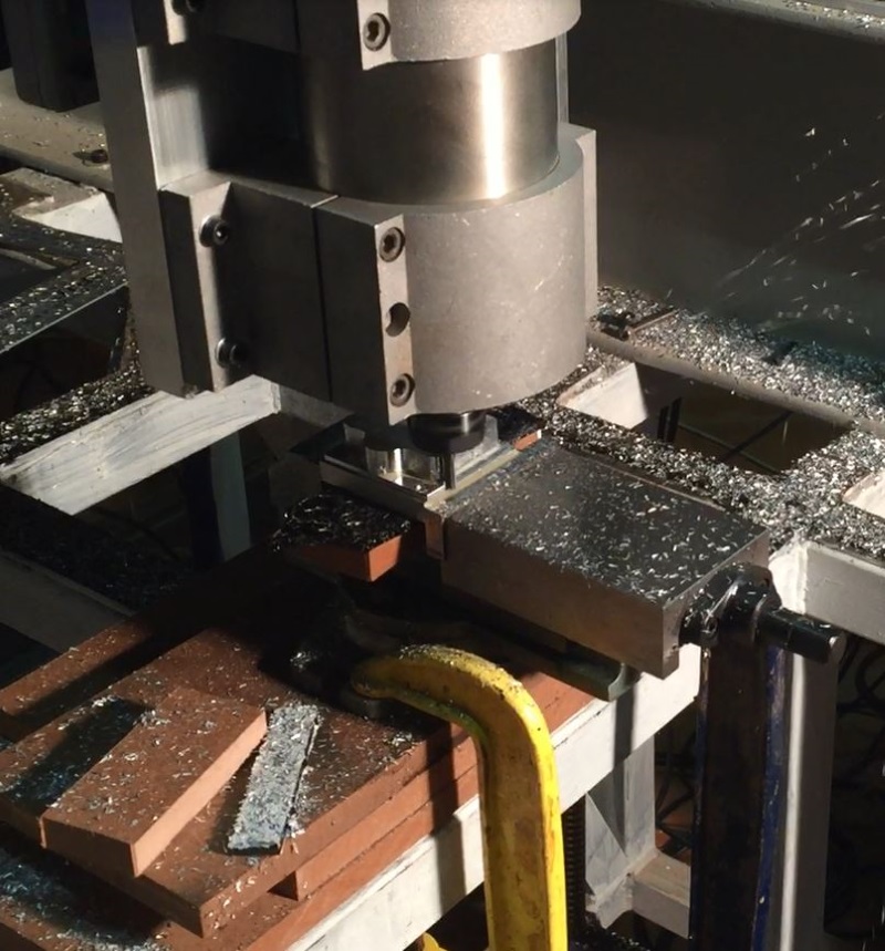

Have to do the wiring of the machine now, fit cable chains, zero and limit switches etc but could not resist to try a few test cuts. No machine bed yet so I just clamped a vice on a few blocks of wood. Took a lot of effort to get this far but thinks are finally comming together and I'm absolutely over the moon with how the machine cuts. Part below was cut 15mm deep with a 6mm HSS endmill at 1000mm/min @ 3mmDOC and finishing cut at 500mm/min and 6mm DOC.
http://www.mycncuk.com/attachment.ph...id=15521&stc=1
http://www.mycncuk.com/attachment.ph...id=15523&stc=1

Thanks Jazz. Apologies, that came across wrong, ill try to explain. I wanted any fault signal to disable all movement and I could not figure out an easy way to combine the 4 stepper driver fault signals into one so I got them to switch 4 small relays and then wired the relay switches in serial so if any one opens it cuts my 5v enable circuit etc.
There are probably better solutions but I replaced those 4 relays with the arduino using 4 inputs and 1 output. Arduino Inputs connected to stepper driver fault outputs and the 1 output connected to all driver enables and spindle relay. The few lines of code check the inputs and if any change is detected it takes the output pin low disabling all drivers and switch the spindle off. Ive tested this to death and it works like a charm.
