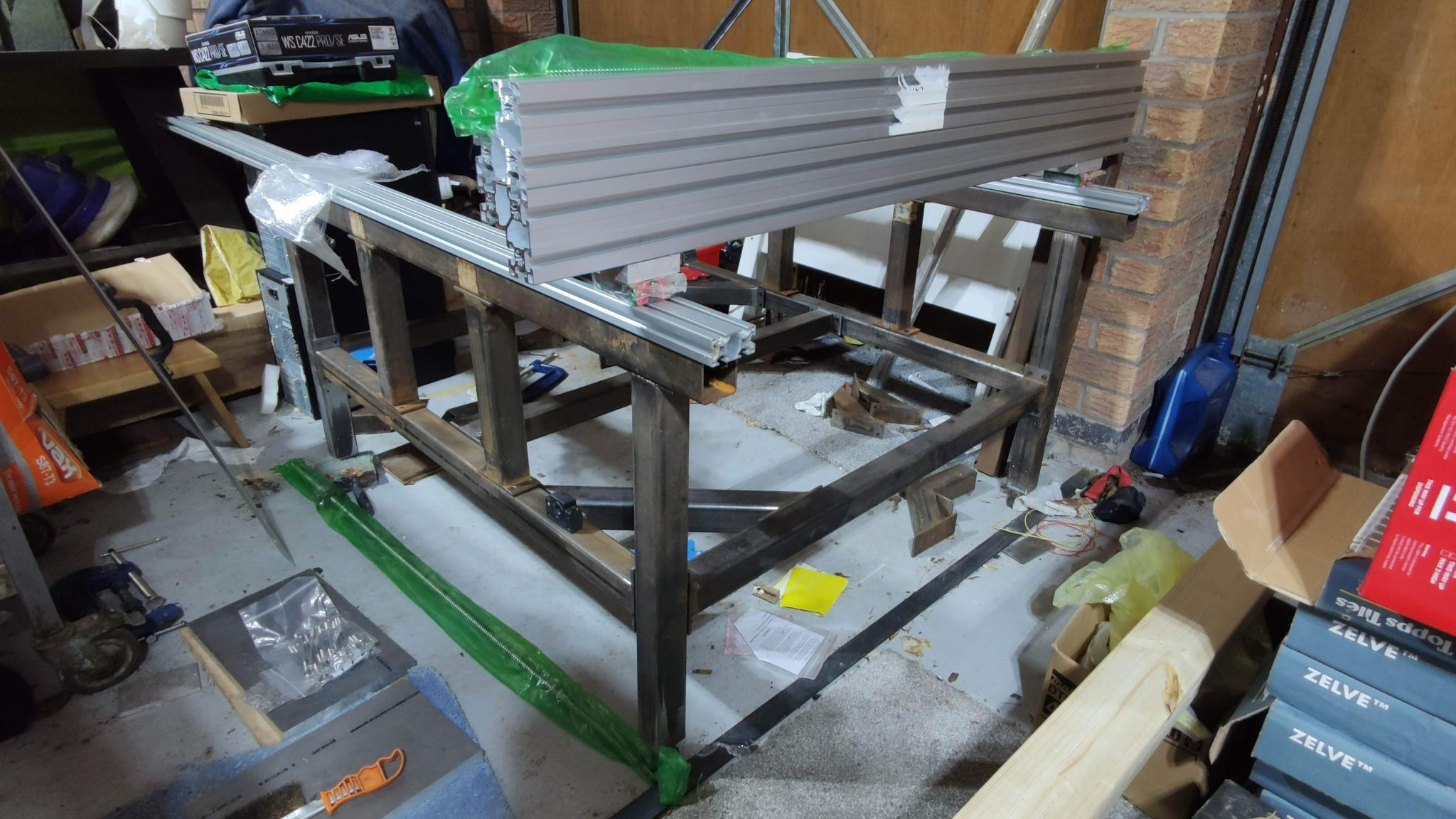

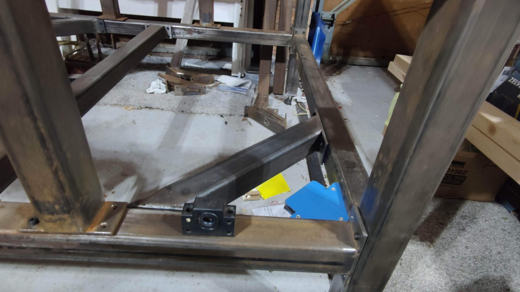

Re: a Steel Box Section Build with SBR20 & Ballscrews Plus a few questions

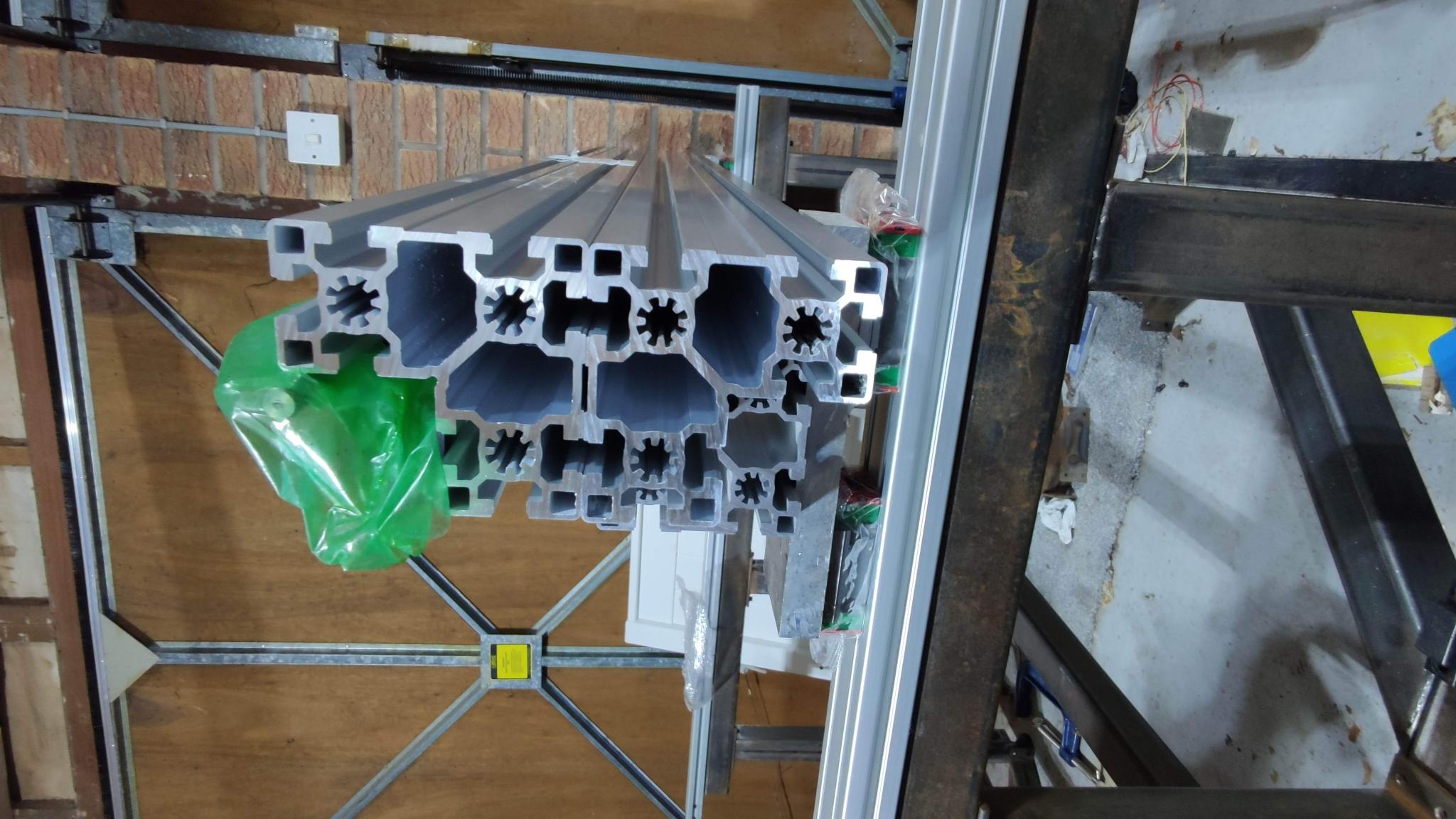

Hey Everyone
Well it's been a while since I have posted anything but I have been slowly doing a little when I can sneak off to the garage for a short while.
I have still been lurking furtively in the shadows though :)
I have noticed that since I started the Make "a quickie CNC project" that my quality of work has gone up and so things that I must have been happy(ish) with originally I have then re-done to a better standard. I would have never thought I would still be making this thing when I first started designing. but I am also grateful that I am.
It has been in my thoughts at least once a day of solving different things and I am learning new skills all of the time. So instead of the CNC creating items it really is turning out to be my actual hobby to create this thing.
Sometimes when I have had a rough day I go to the design space in my mind and build it. Okay, some might say actually physically building stuff is the way to go through.

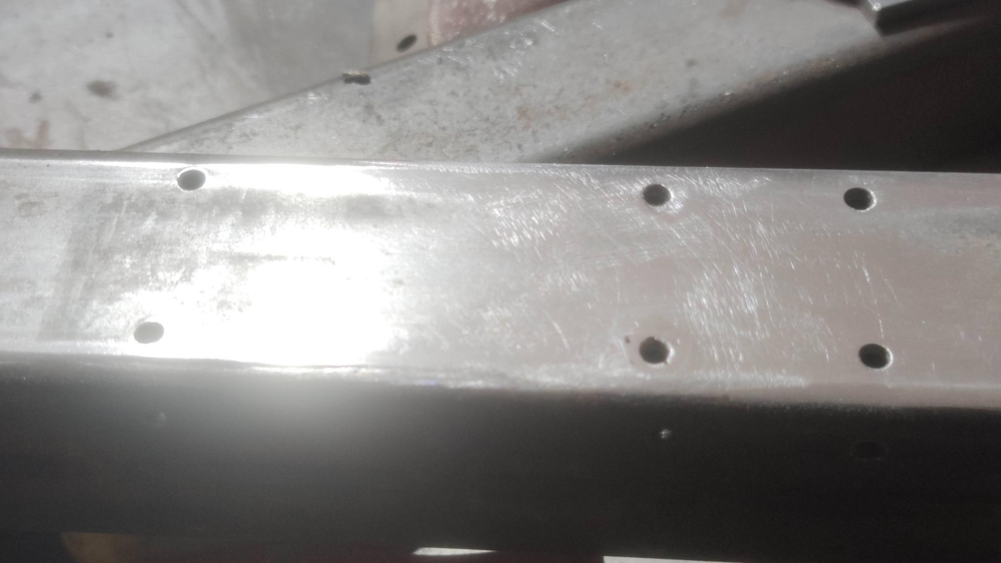

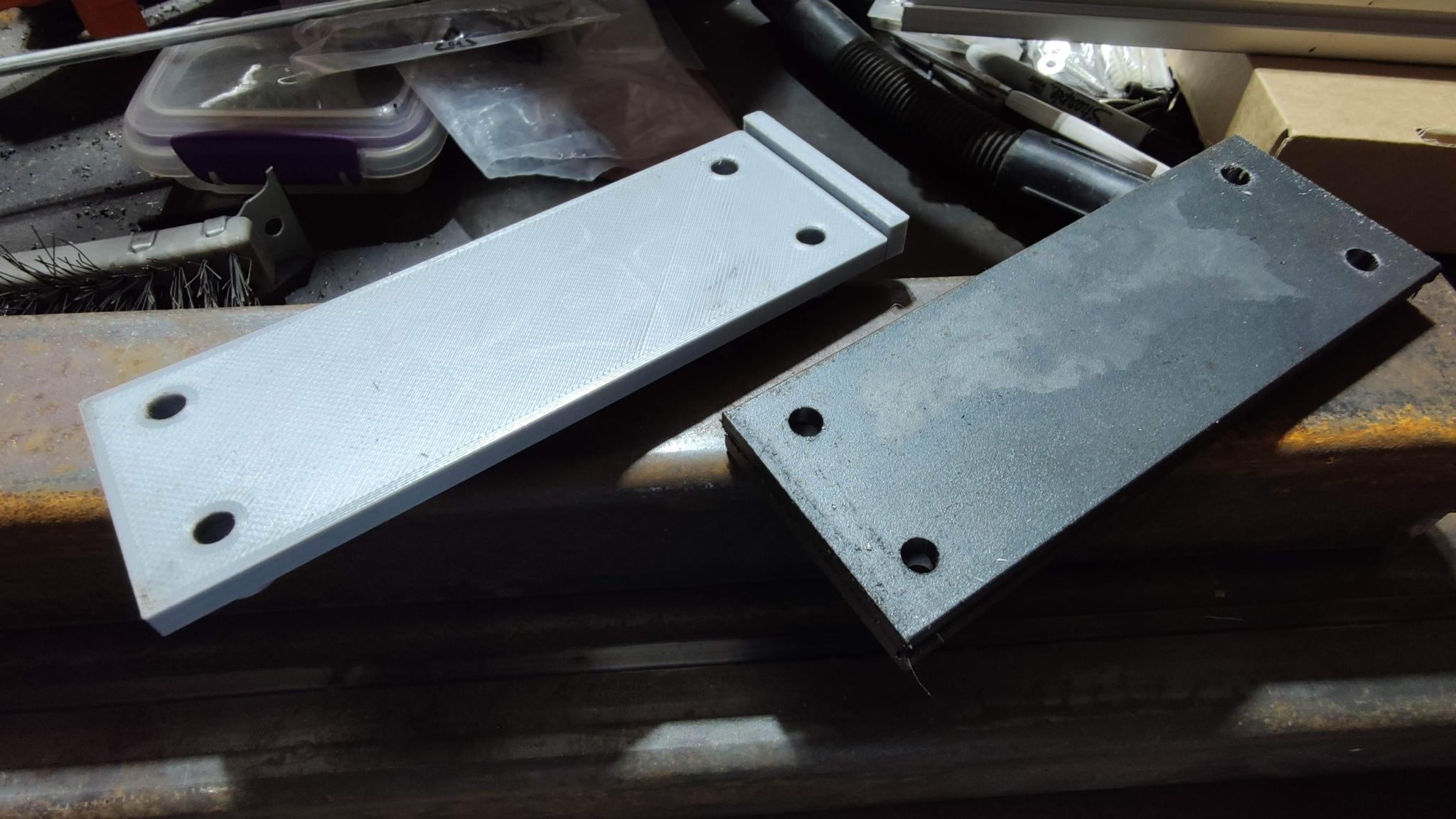

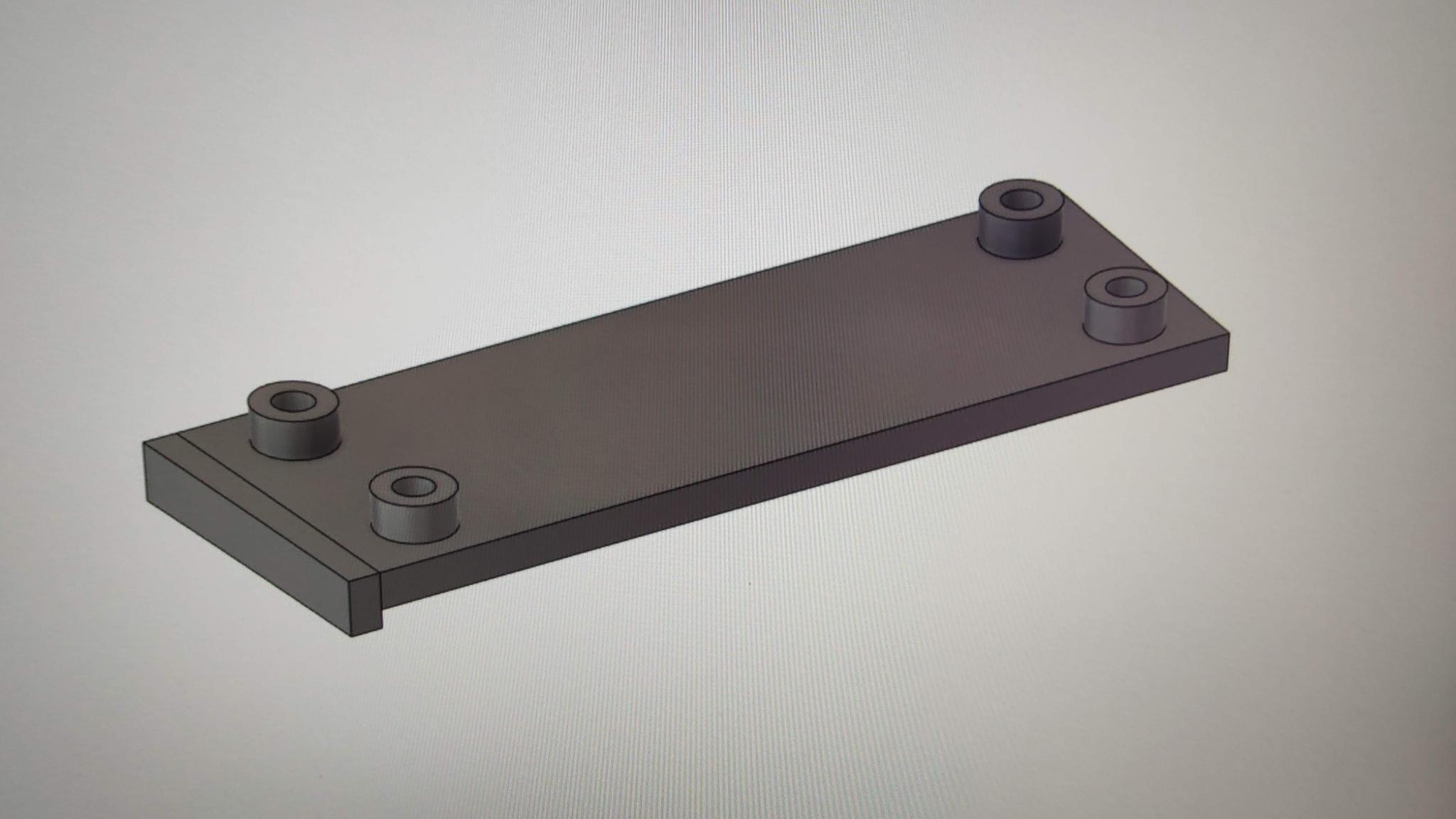

My Hole drilling was always an issue of getting it accurate enough to be happy with but with so many possible ways it could wander slightly even using centre drills i still wasn't happy, So I have been using a little sieg x2 mini mill and that has made the job much better but it doesn't have a DRO on it as yet and so even though the mill can get to the correct place a drill can (And does) move around.
I have always stayed away from 3d printing thinking that it wasn't for me and that the quality of parts that I had seen from other people's tries just wasn't something that I would use. Well, how wrong was I.
I have purchased the Ender Creality 3 and it is amazing. sure it can create stuff that will sit collecting dust on the shelf but also it can create useful parts.
it is supposed to go to 0.01 of an mm
Attachment 31255
So I created a drill template so that even if it is wrong they would all be the same so they would be right (My Logic anyway).

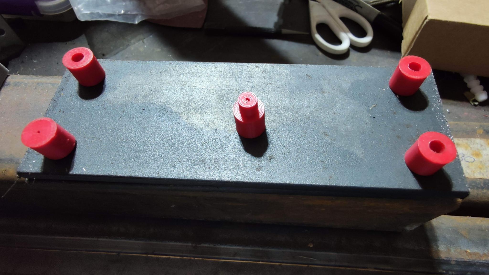

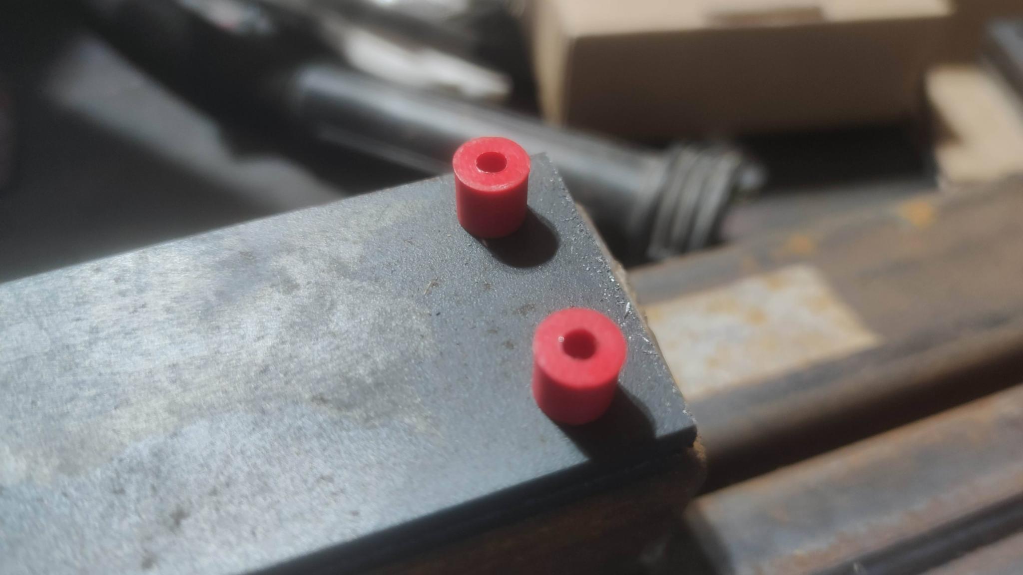

Attachment 31256
I have had issues with getting the drill marks as accurate as I wanted so I made some centre drill markers and some Centre drill markers with very small centres so that I could mark the masking tape and then use a punch to get it pretty close.
Attachment 31257
Attachment 31261

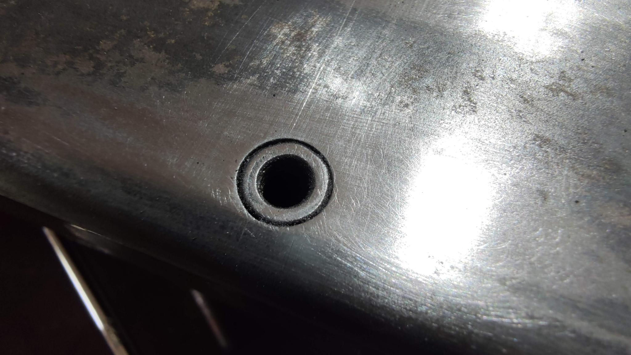

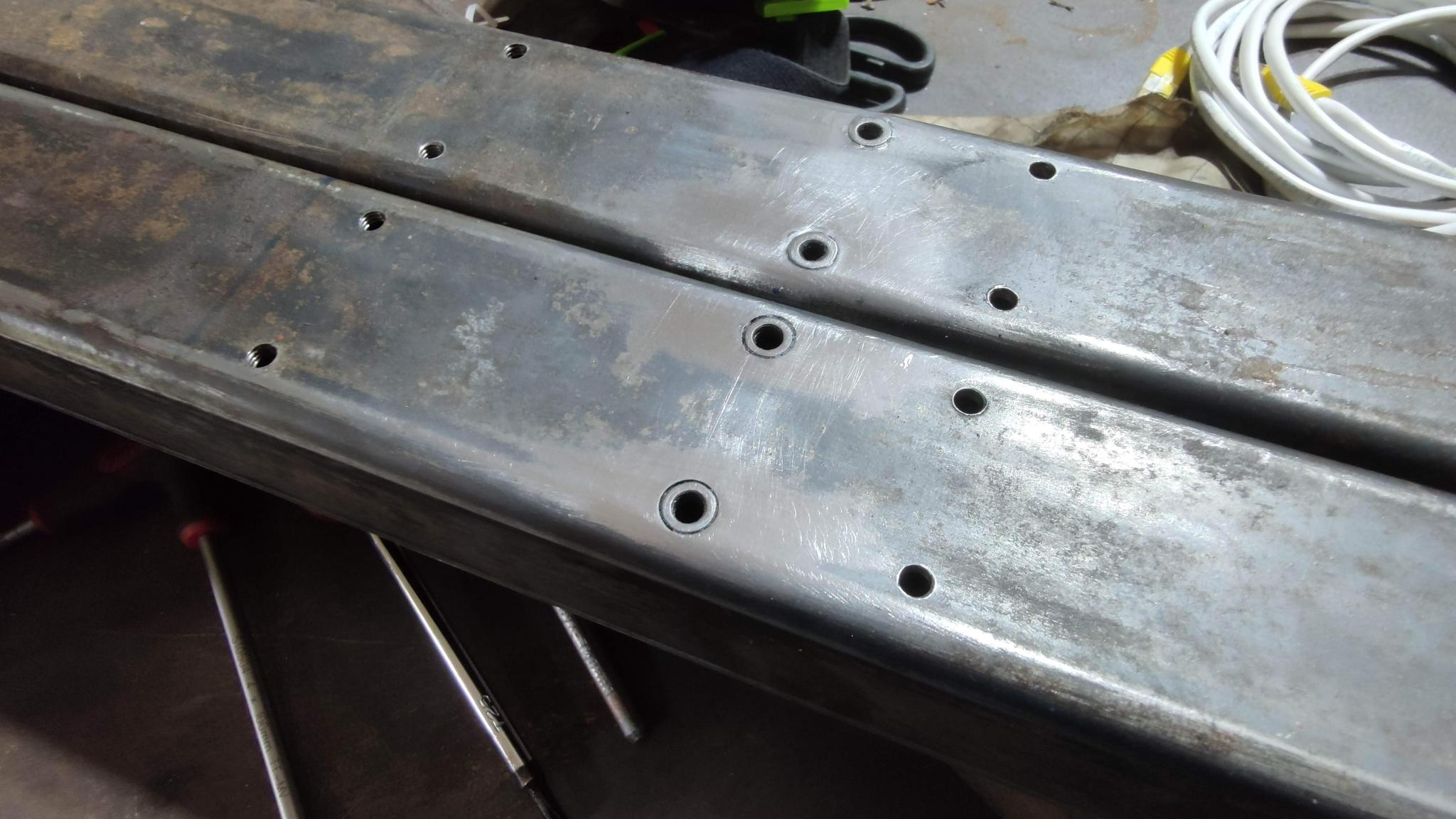

So then onwards to fix my errors from my previous times. JazzCnc mentioned a long time ago about welding nuts into a hole and especially because I am using 3mm it would help. I haven't done this on all of the holes but on the not-so-accurate holes, it has worked really well.
I took the coating off with the Brick cleaning acid as suggested (I do listen :eagerness:)
Attachment 31258
Attachment 31261
Attachment 31259
Attachment 31260

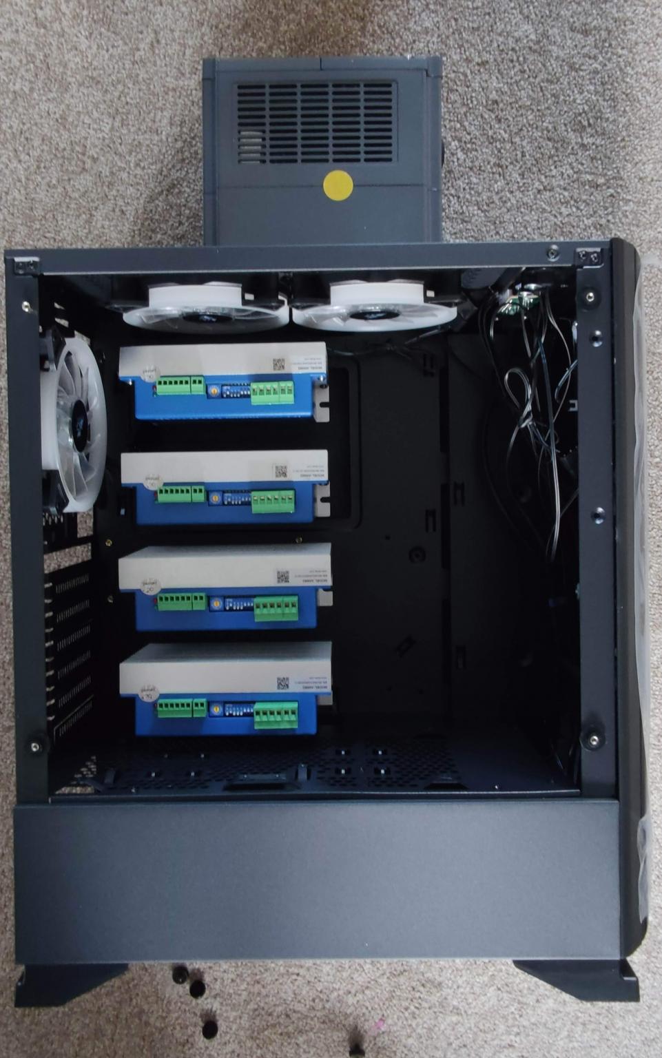

Since it is a little chilly out there and the garage is cold at the moment I have started to look at making the Electronics side of things whilst I wait for the heat to come back. Cold fingers and screws are always an experience :tennis:
Attachment 31567
I have been looking at using a PC tower case because the wall enclosures just seem so much money at the moment but I also like the size of the case, then the expansion ports will be to connect the motors and Sensors and various items.
The Powersupply will be out of the way underneath the main section and so will help with the separation. then I will run the fuse and MCB in the same place as the Toroidal power.

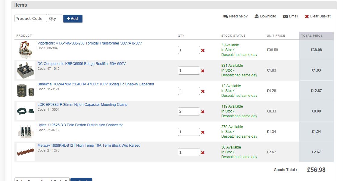

So I have been looking at using a 240 Volt VET Toroidal Power unit which has x2 25v outputs 625 VA.
I am using the lead shine AM882 drivers with the four cnc4you 4nm motors. which show they take around 2 Amps so need 70v to run the lead shines.
but I wasn't really sure if this is the correct unit I will need in all honesty.
https://www.rapidonline.com/vigortro...-x-25v-88-0012
the bridge rectifier I have been looking at is a 35 Amp rectifier https://www.rapidonline.com/dc-compo...mb356--47-3228
but that is then when I have become unstuck on the Capacitor choice and I'm not sure how to work this out so I wondered if anyone could possibly point me in the correct direction.
Thank you very much.
Rob
Rob
The attached is all you need though the price will be wrong. The toroidal you have is ok
This vid from Joe will help https://www.youtube.com/watch?v=4OoQ...zD30sZjtp_VyqY
Attachment 31568

Thank you very much for that, that is a great help, I haven't made a power supply like this before so I'm not sure if these create much heat when in use. The space will be a little limited so the components will be quite close to each other and planning to put the incoming MCB for the power supply Horizontally above the toroidal doughnut the plan is roughly to keep it a similar size to a PC power supply in height but in a longer package.
