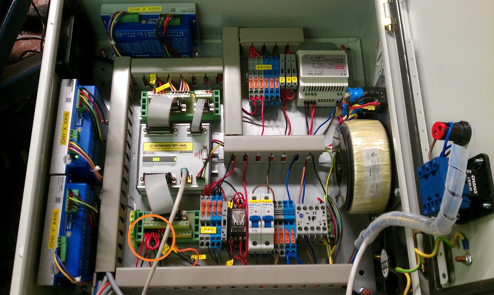

Please if you get the chance could you give the updated schematics a final once over? Only additional thing I changed further to the suggestions was earthing the Spindle to the VFD rather than star point as I guess will make wiring easier.
Ok few small details.
The Green wire you have coming off Stepper B (-) I'm hoping is representing Shield going to earth and your not actually taking B(-) to earth.? If correct still only earth at the Controller end not the Stepper end.
Don't need 24V to outputs 0-3 because your not using any. Your only using the onboard Relay which is output 4 and doesn't need 24V.
Fans can get away with sharing fuse. I use 2 x 12v wired in series because are cheaper and easier to find.
With the 24V for Controller I/O save your self some wire and jumper between the Pins. Don't need to run separate wire to each pin. (See pic)
Don't forget to send Earth to Machine Frame.
Attachment 19571
