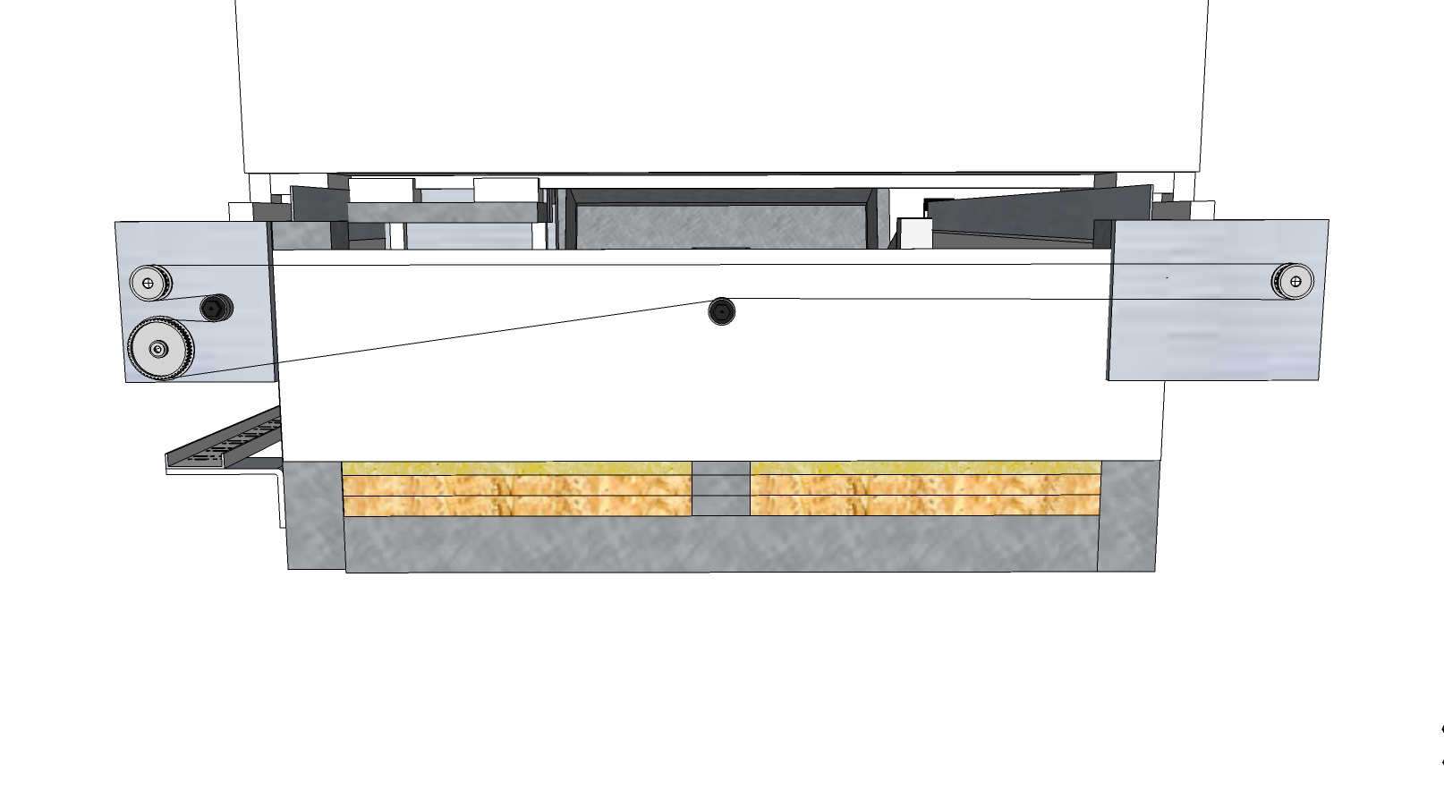

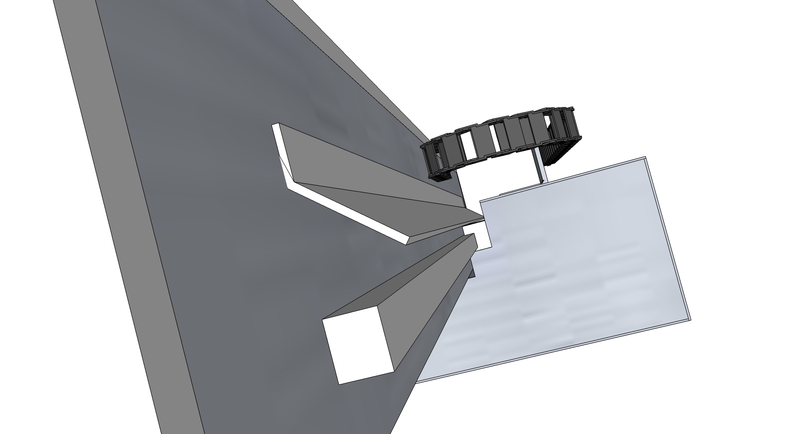

Quick assemble of the gantry this morning. Got the holes for the X axis ballnut holders to machine later on the Y axis endplates, then some pads to make for the ballscrew ends...
http://tapatalk.imageshack.com/v2/15...f44a98c9c0.jpg
Thinking about it I'll make the pads first and then see if I need to machine back the Y axis end plates...

One of the things that I didn't think through properly with regards to assembly was the X axis ballnut holders. I got the aluminium ones that are small and compact and they fasten from the underside/reverse so on my design I'd gave to take the gantry end plate off to remove them which is far from ideal. I've ordered a couple if MGD16 ballnut holders that can be fastened from the outside. I'll probably have to machine back the base so it is the same height as the current ballnut holders but that's no biggie with the mill.
http://tapatalk.imageshack.com/v2/15...26c26554bd.jpg
Link below is flycutting the DE mount to remove the 1.2mm needed to make it fit.
https://www.youtube.com/watch?v=k7BDi5H78rE&feature=youtu.be

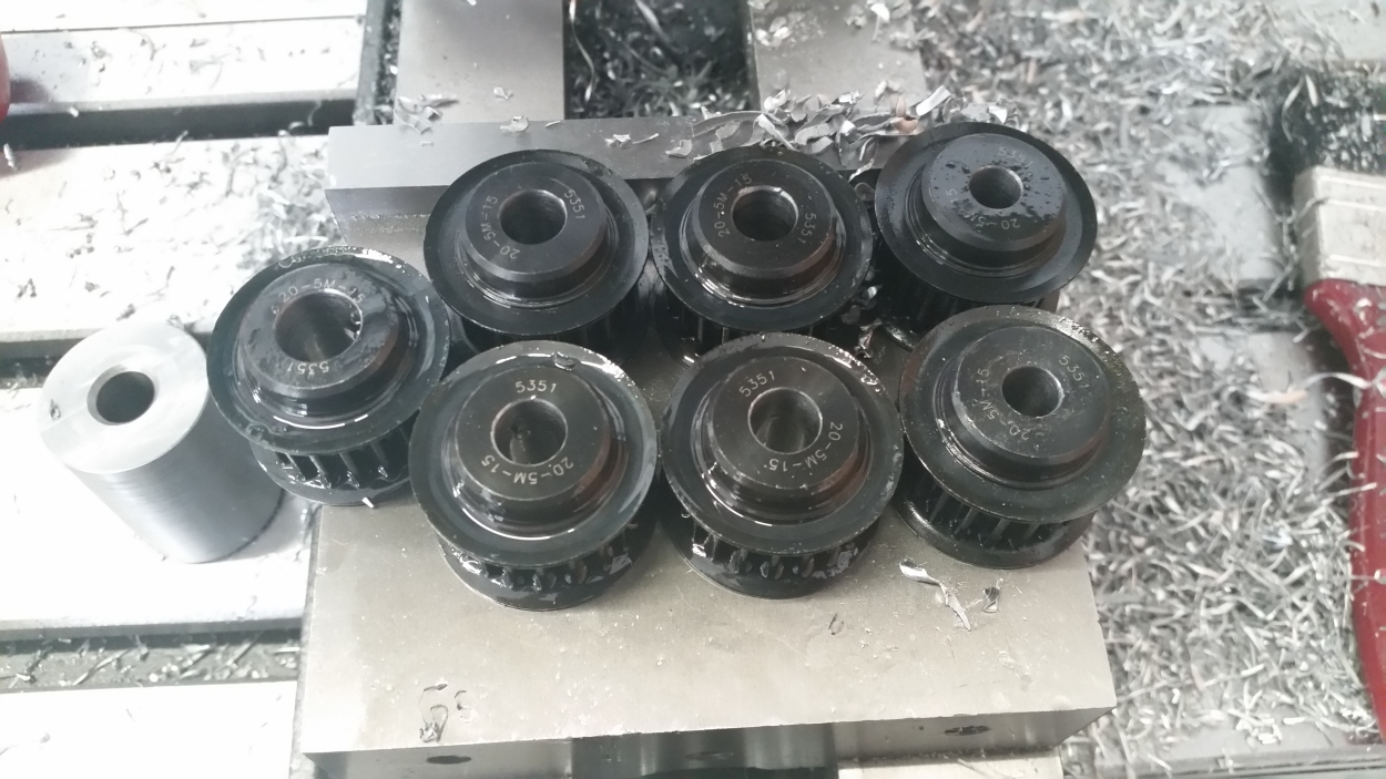

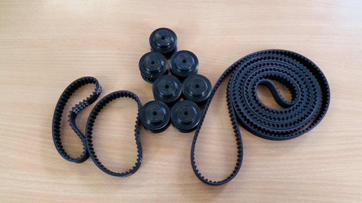

Got some belts and pulleys today, didn't get them from Belting online or anyone like that as our local company we use for bearings etc. Gloucester bearings (Hayley) were so much cheaper for the pulleys and a bit cheaper for the 2525 belt...
7 off 20 tooth pilot bored pinions - P20-5M-15F £1.73 each
1 off 2525-5M-15mm HTD belt £14.85
2 off 265-5M-15mm HTD belt £4.31
I realise that the pinions aren't pilot bored like the ones from belting online but I was going to have to drill them out to the correct size for the ballscrew ends and stepper shafts on the lathe anyway.

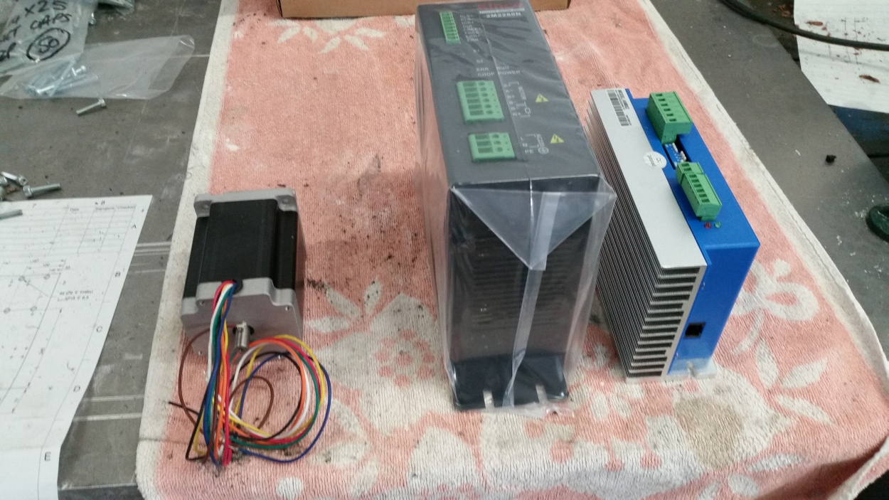

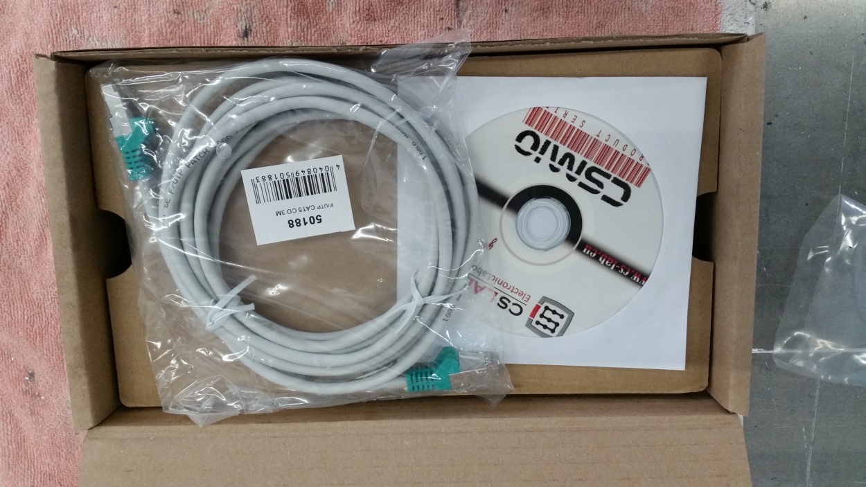

Got another package just now....it's like Christmas :yahoo:
Opened the box from Gary @ Zapp...
Attachment 14753

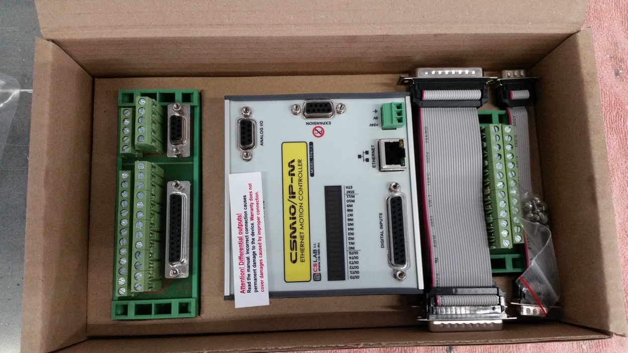

CSMIO....
Attachment 14755 Attachment 14756

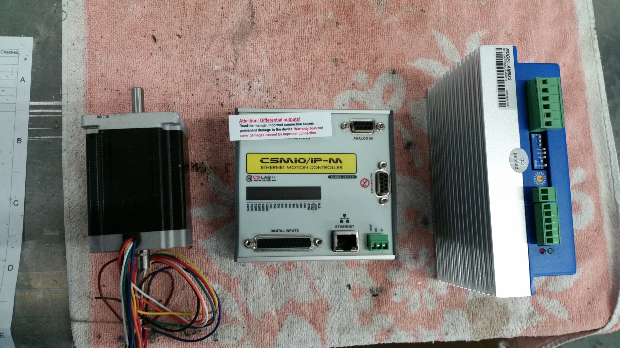

Showing it's size against a Nema23 stepper and AM882
Attachment 14754

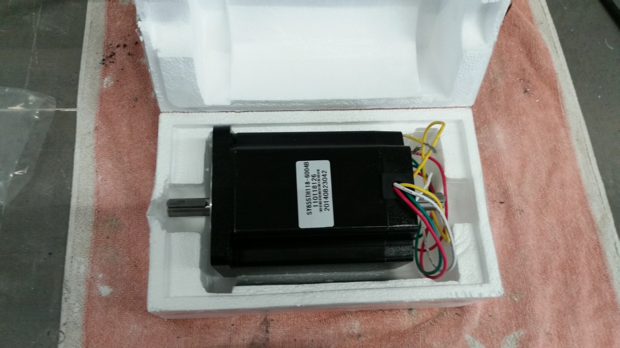

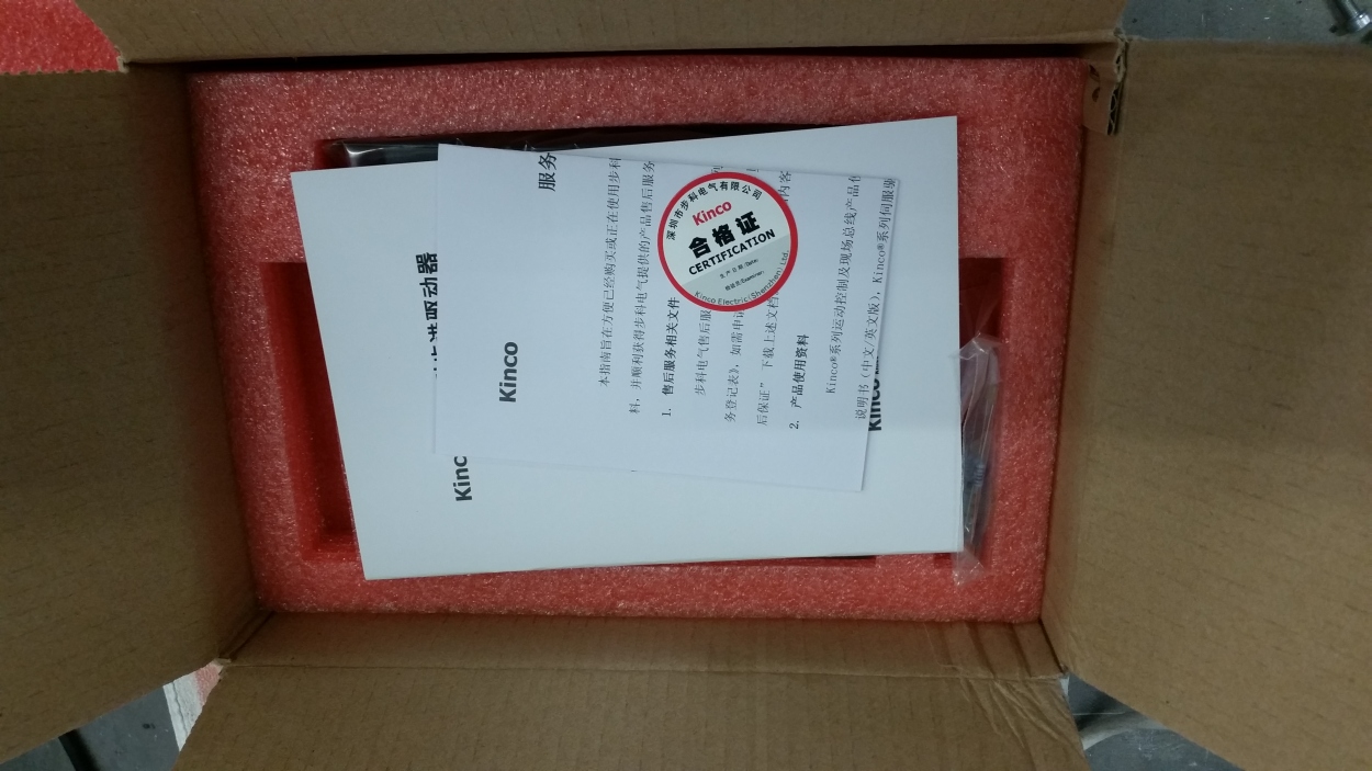

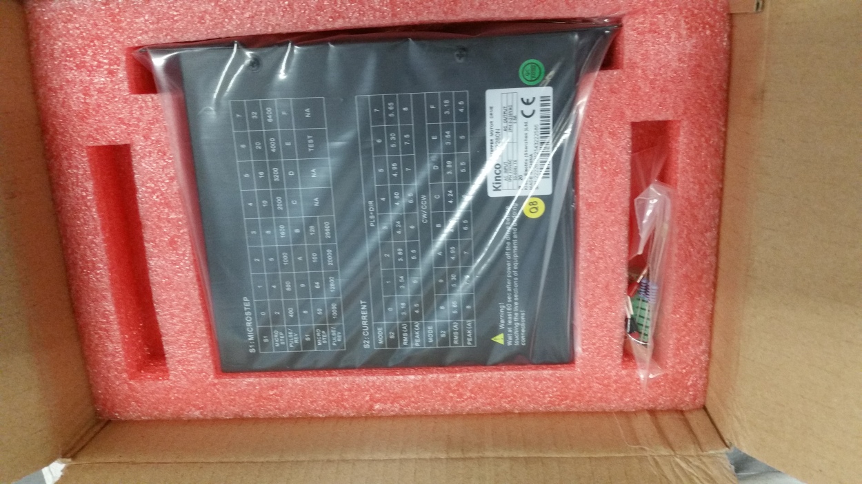

Kinco 230V Driver
Attachment 14757Attachment 14758Attachment 14759Attachment 14760

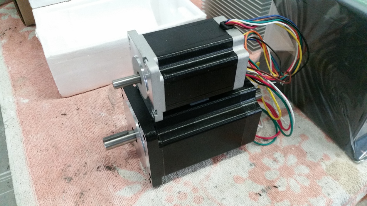

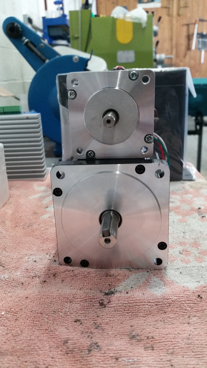

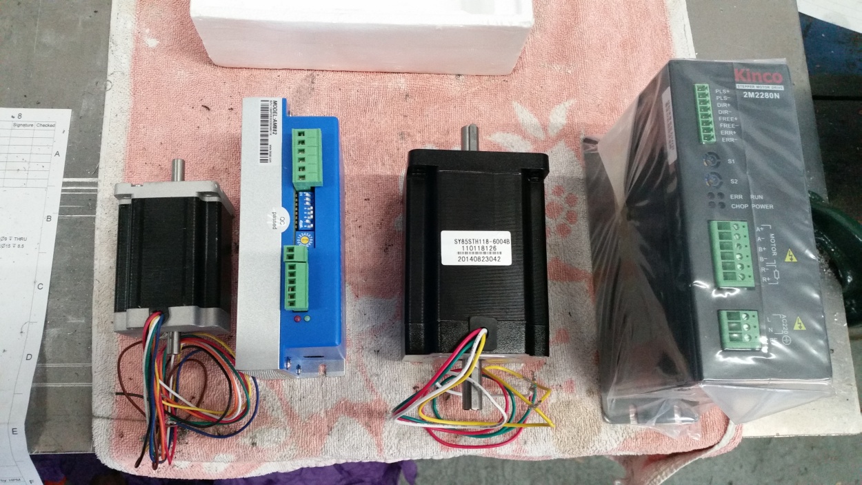

Nema34 8.7Nm motor...(4 off)
Attachment 14762Attachment 14761

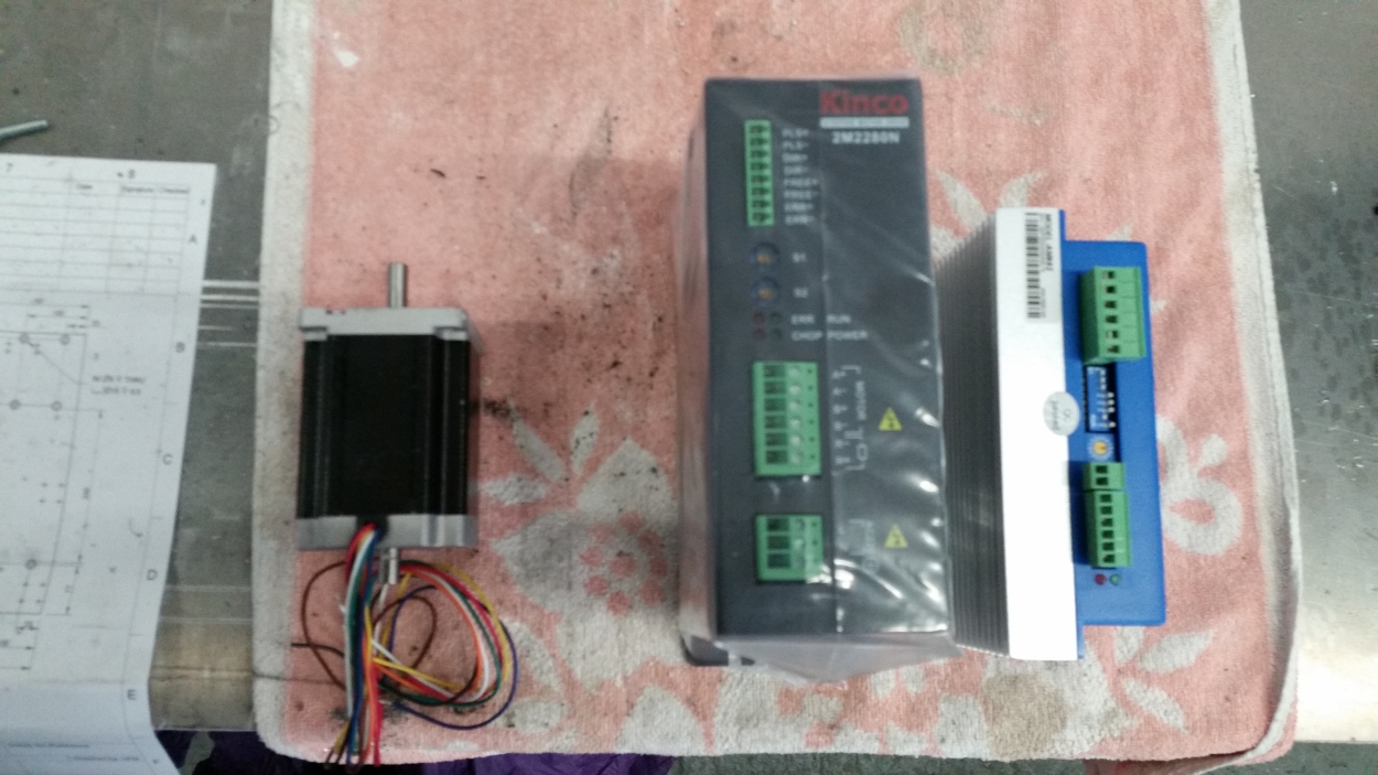

Showing the difference between a Nema23 and 34...
Attachment 14765Attachment 14767Attachment 14766
Drilling the pulleys...2x8mm, 4x10mm & 1x12mm
Attachment 14764Attachment 14763
Re: Comments sought on new build: A CNC Router for RC Gliders and Planes
Getting close now Neil !
A cracking set of bits, should run nicely with those fitted.
routercnc
Cheers!! Only one Nema34 is going on this....it'll be on the X axis driving the twin ballscrews. The other 3 will be going on the mill conversion ill be doing next...hoping to do more tomorrow but work is getting in the way!
That's a smaller nema34 of the bunch, colossal aren't they !
.Me

I've bought the transformer, rectifier, 4 4700uf caps and holders, a 600x600x300 cabinet, loads or bootlace ferrules, wire, din rail and terminals, door interlock....tonnes of stuff but I'm sure not everything i need.
I'll be picking people's brains about the safety relay/s for the safety features...

Scratched my head a bit today trying to work out how to mount the Y axis stepper motor so I can adjust it to tension the belt. In the end I've decided to put the pulley on the rear of the stepper and mount the stepper on the front via a bracket...
http://tapatalk.imageshack.com/v2/15...4e0ce78ea0.jpg
http://tapatalk.imageshack.com/v2/15...a74cd0fe07.jpg
I'm hoping that as the only tension on the stepper is from the belt that this arrangement will do?

Nice build sir!
I don't have first hand experience mounting stepper motors this way but it looks trouble. Maybe too much strain on motor?
I guess as long as you fabricated the mount you might as well run it and find out.
Do you have special machining on ballscrew? I notice longer area for the pulley? Or is it just my eyes...
Bad idea that dude.!! Bearings will suffer and could cause resonance which will affect motor. Just pocket the Mount deeper so pulley goes thru it.
Or have idler arm tensioner tension belt from side of gantry.
