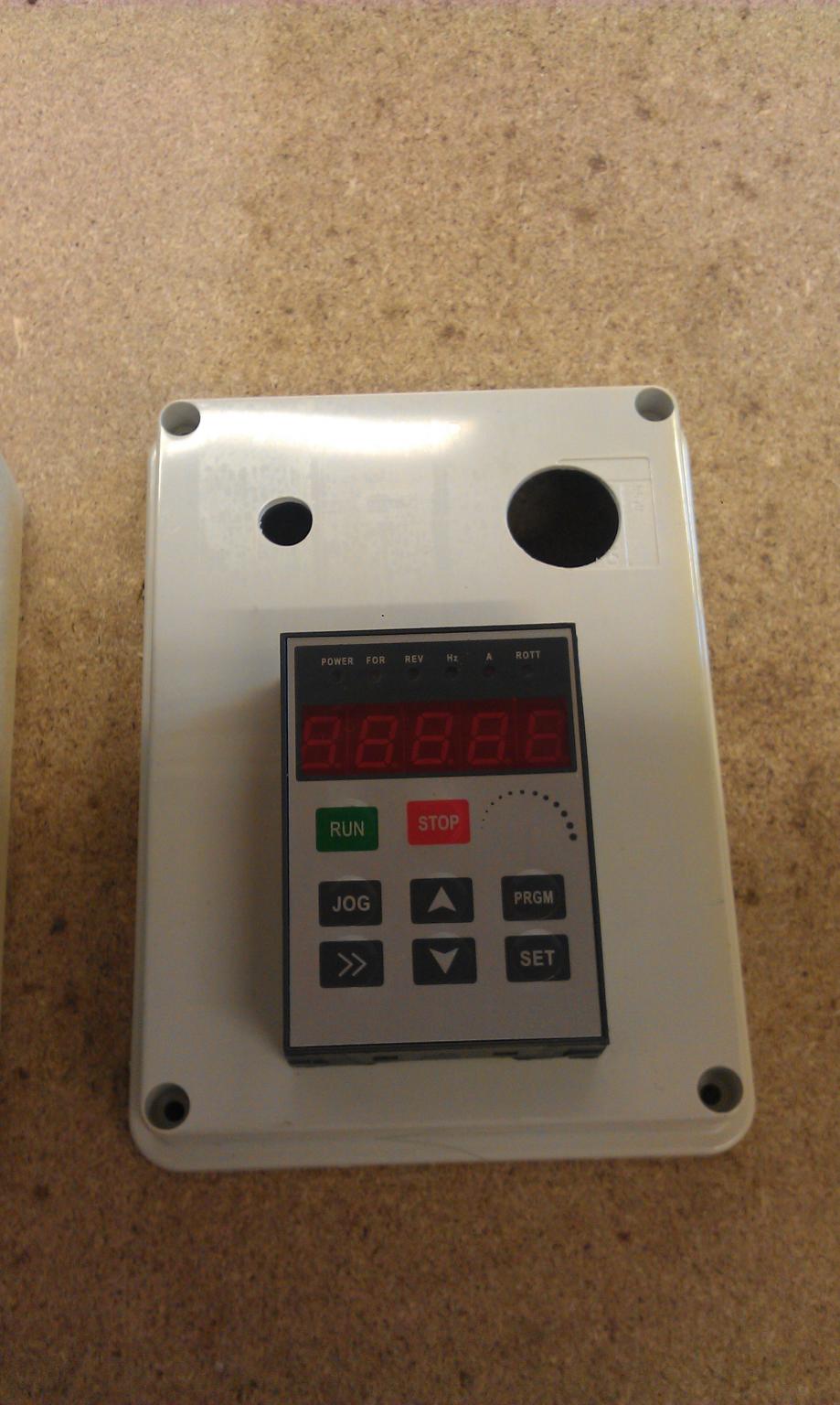

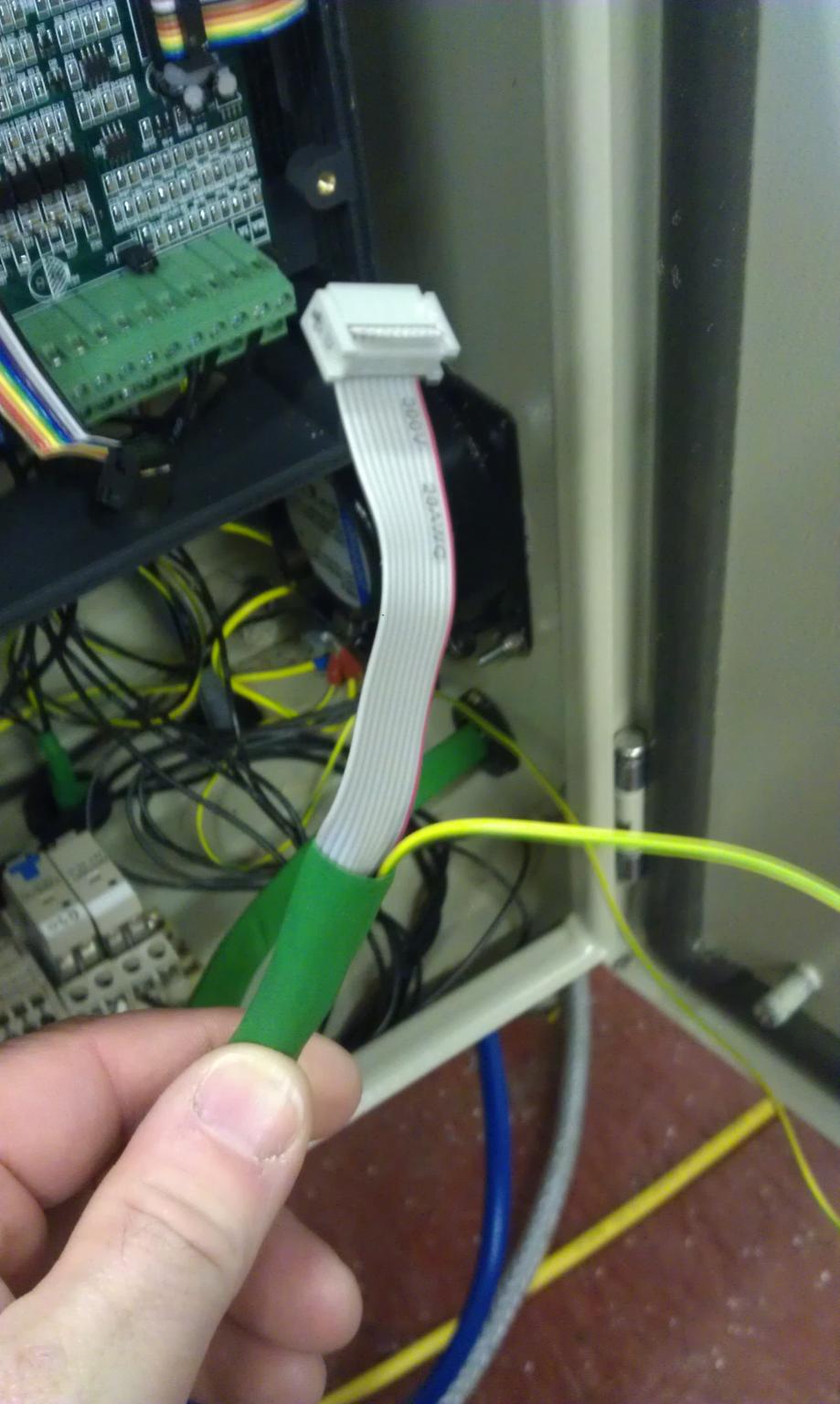

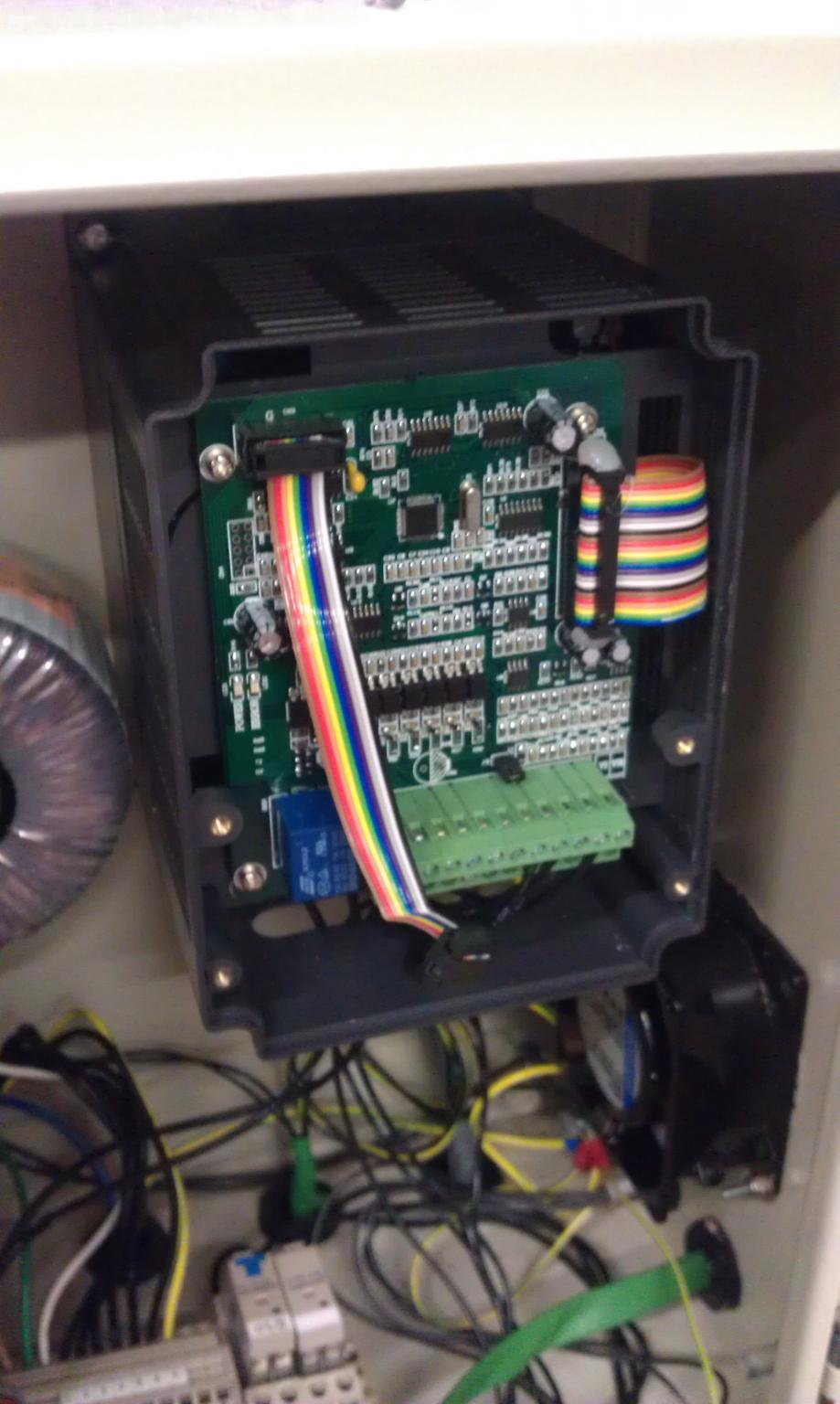

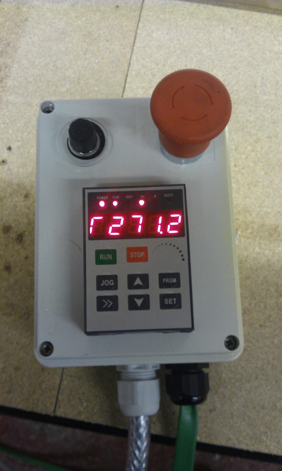

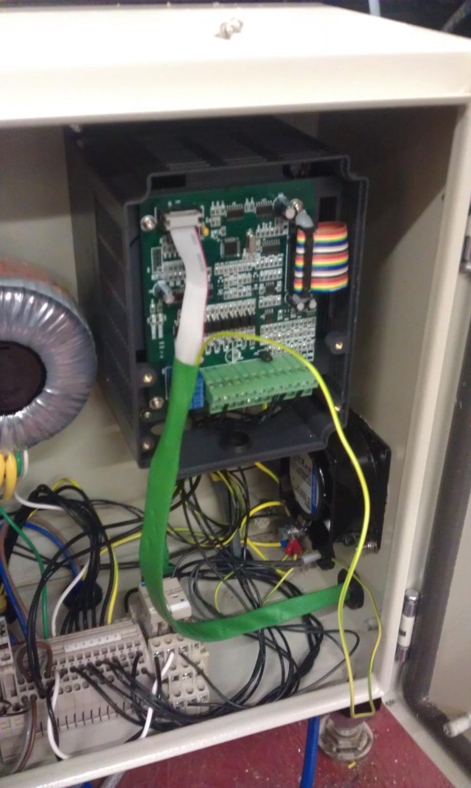

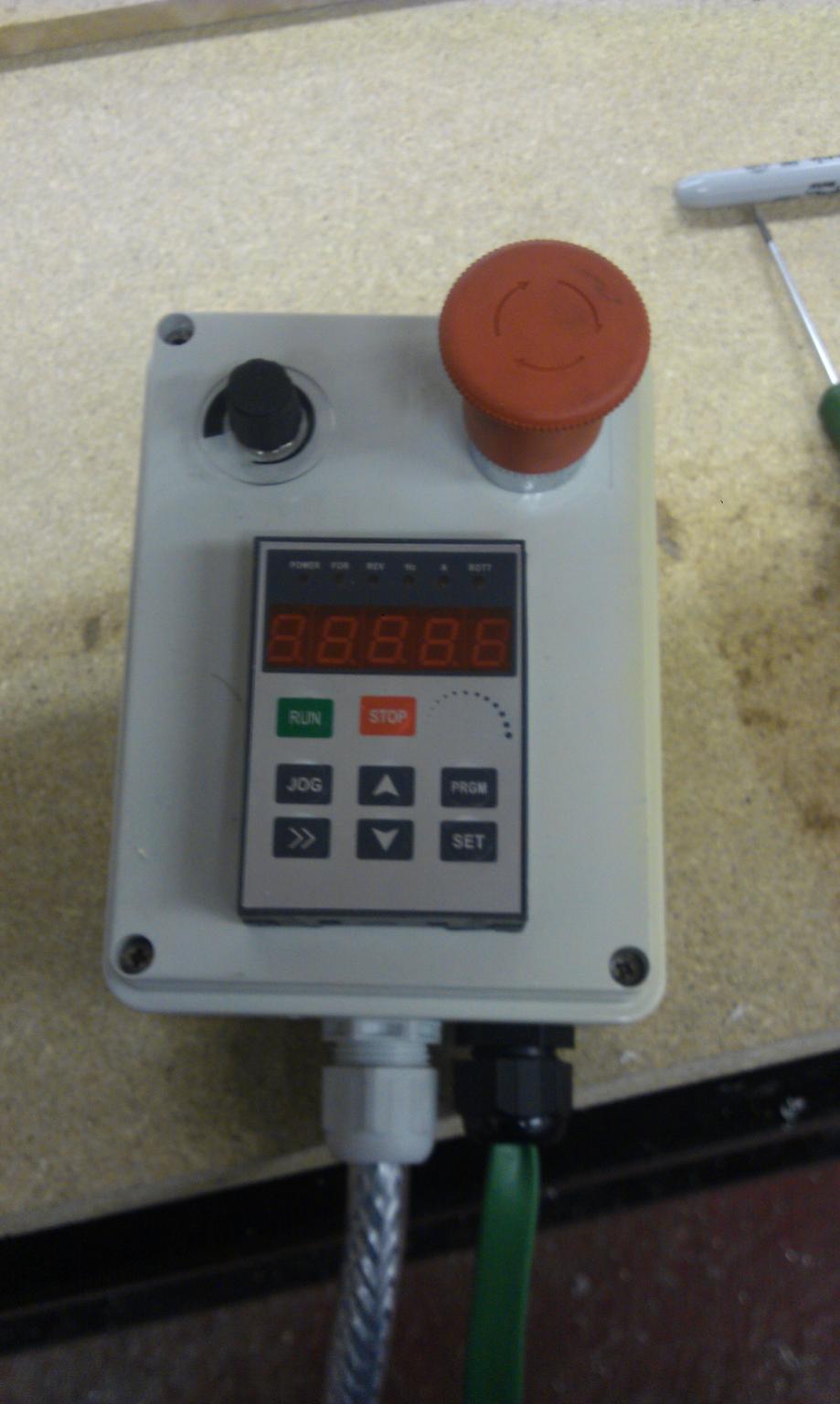

I decided that I wanted to see the display on my inverter so that I could get a basic idea of the spindle speed.
I removed the front cover from the inverter and found that the display box could be removed. As the photo below shows tha display box is connected by a 10 way ribbon cable.
Attachment 4818
I made and fitted a new cable, 10 way flat ribbon ran inside some shielding then covered in heatshrink.
Attachment 4819
Cut out the box lid and fitted the display unit.
Attachment 4820
Fitted the speed control pot and an emergency stop button and connected everything up.
Attachment 4822Attachment 4821
Power on and test.
Attachment 4823
All seems ok.
Ian
Re: Web Goblin cnc has begun
I like to see my VFD screen but not for speed.?
I have it set to show current being drawn this shows me the load on spindle this way I can see when the tool is getting worn. Also good for gage to show material hardness, esp usefull with shity ALi that has soft or hard spots.! . . Also tells me If I'm being greedy on the DOC.!
Everything Jazz just said... I almost invariably leave mine reading current. Especially on the lathe as there it's actually possible to hit the current limit, though I don't cut that fast often :naughty:
I mounted my VFD on the ceiling above the lathe so it's easy to read and accessible which is handy when thread-cutting.
How long is the ribbon cable? Good to see that the signals made it that far.
I might well change the display to current later on. At the moment I am still taking it easy with depth of cut and feed speeds till I get used to what I can get away with.
Jazz, I know what you mean about Ali. You can hear the change in the tone of the cutter when you get a change in the material. We also get it alot when cutting mild steel on the laser at work. The cut quality will be really good then it will go crap for a while when we hit a bit of crap steel. Sometimes it can be right down one edge of a plate. Makes the operators think the beam alignment has gone out.
Jonathan, the ribbon cable is around 2.5mts in length at the moment. This might get shortened a bit when I decide where I am going to mount the box.
