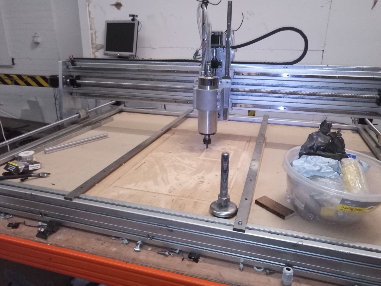

I won't have the spindle so low in the mount I only have it that way until I fit a physical limit and limit switch so I can't run the Hiwin's off the rail on the Z axis.
I intend to put a bolt through the bottom Hiwin fitting that sticks out so it's blocked off and the carriages cannot come off.
Attachment 23533
This is a photo with my elephone better than my fuji camera so happy with it ;) You can see my make shift clamps but also going to have a vac bed

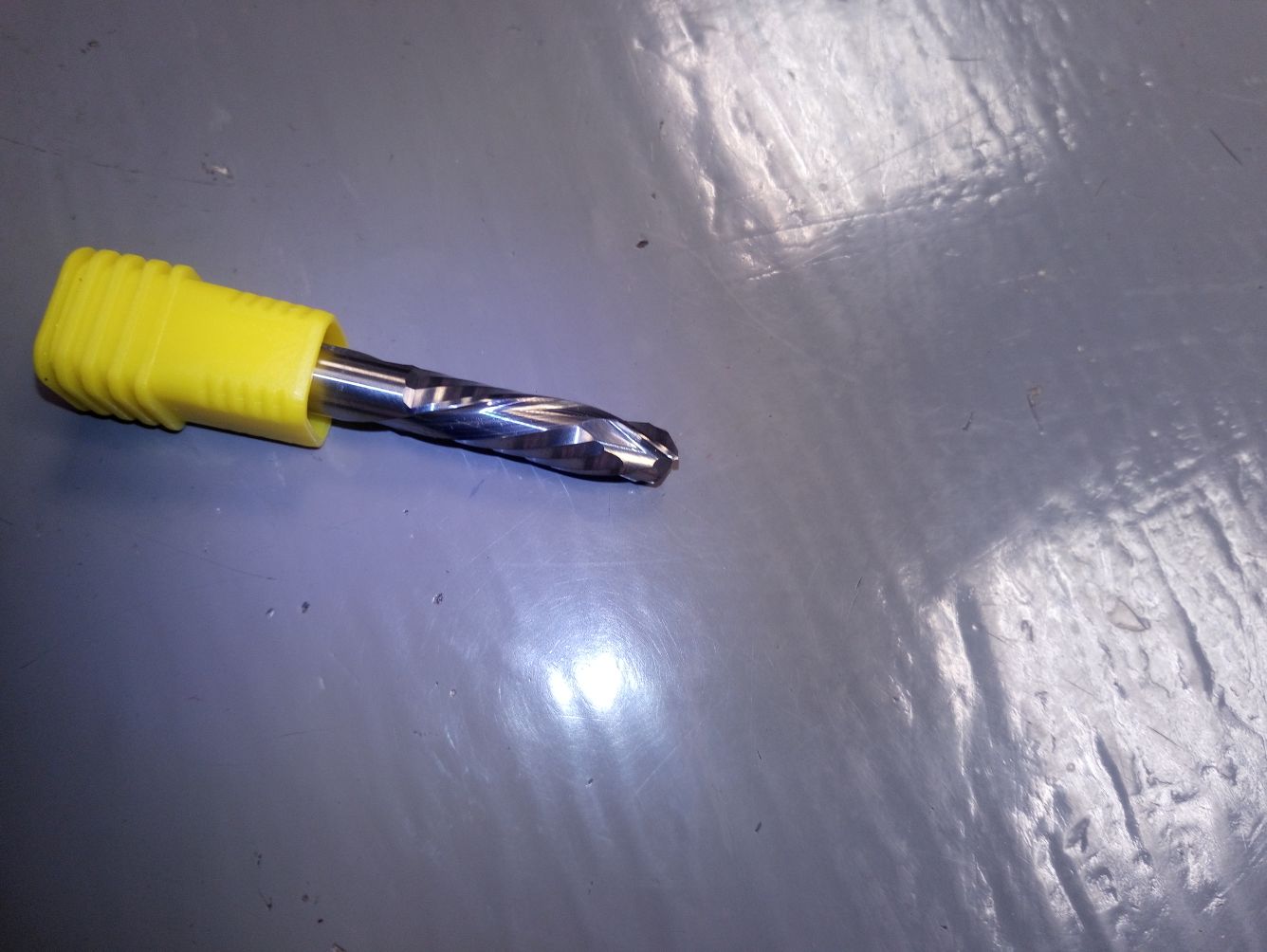

Compression bits are funky
Re: New build with recycled parts on a ridiculous budget 120cm*60cm work area
Nickhofen
Art!
let's see how she cuts ply next ;)
