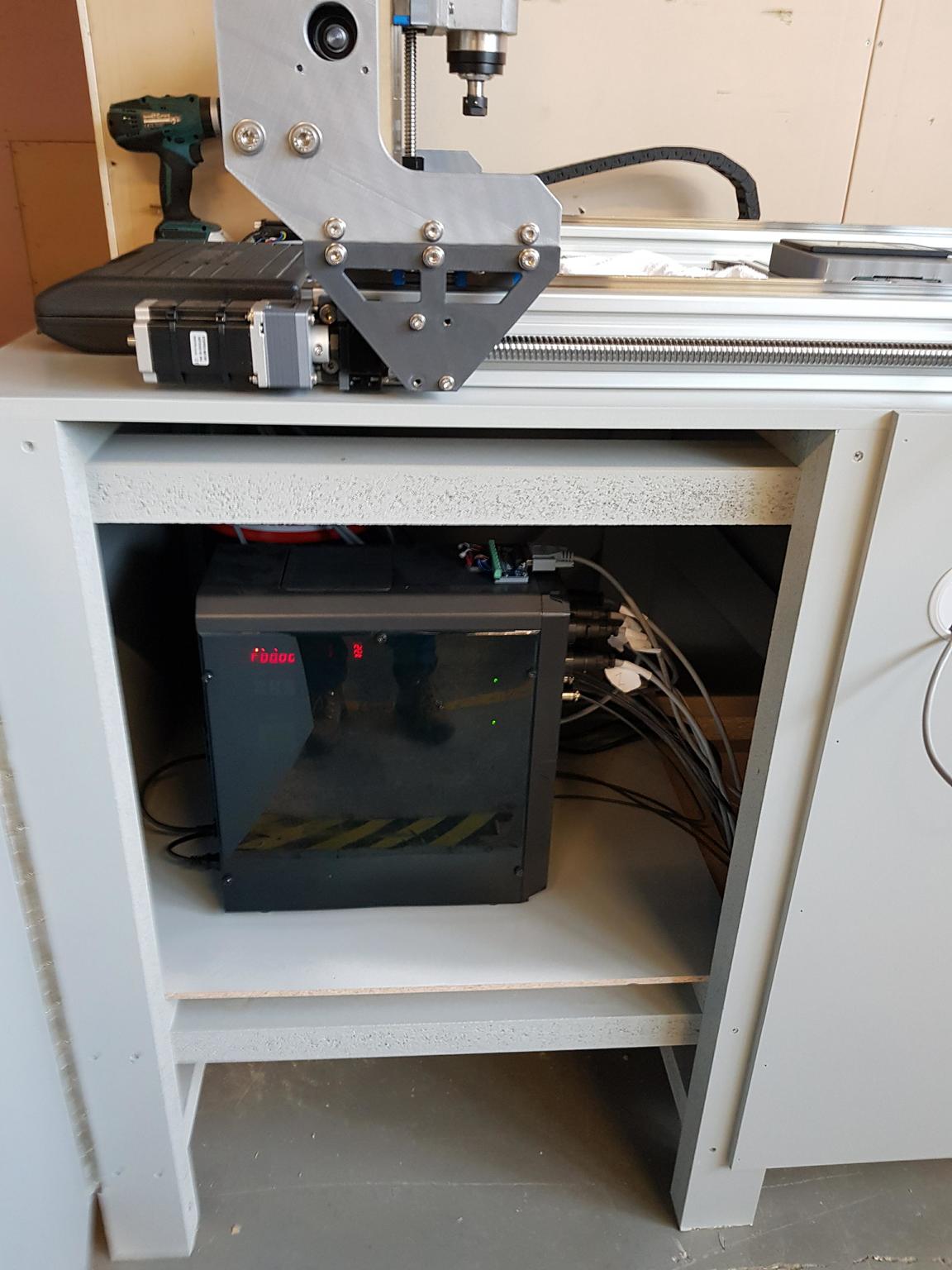

Hi guys, had some time recently to get some more done on the router. I had to get it out of the office and onto the shop floor so made a makeshift bench for it, it weighs about 80kg and is pretty sturdy, i bolted the router to the bench using M8 T Bolts.

Next i put the Spindle back on and reconnected everything, setup the Limit / Home Switches for the new parts and ran some tests. At a first glance the Spindle seemed to be trammed ok, however i need to get some other bars for my Dial Indicator so i can connect it to the spindle properly and get it dialed in as much as i can. I also 3D Printed a Makeshift Dust Shoe until i can draw up something to be machined from Aluminium.
https://thumb.ibb.co/d3AmM8/20180714_153327.jpg
https://thumb.ibb.co/kZw48o/20180714_170559.jpg

- Fit some Brackets to Bench so that the Controller has somewhere to rest.
