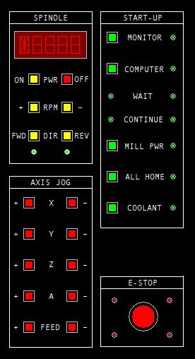

Ok the first draft of the control panel is ready, its not to scale, its more of a concept rather than a tue representation, and i expect i will have more controls to add and possibly some taken away.

Nice panel layout, but I think there are some things to consider...
Q1 Are these illuminated switches? If not, consider using illuminated ones inatead of LED repeaters, saves real estate and assembly effort and looks neater
Q2 How are these going to drive the mill when Mach3 is switched off?
Q3 As it stands I reckon you need 11 inputs to mach 3, you have 10 on 2 parallel ports...
Q4 Whats 'Feed' for?
Q5 If the small round circles are LEDs how will they be driven for the mains circuits e.g. computer and monitor power (and do you really need those anyway?)
Mainly because ive got the LED's and the nice chrome holders on the shelf, and ive also got the switches, (shown in previos post) and to be honest ive seen and used many broken illuminated switches but never the solid top ones.

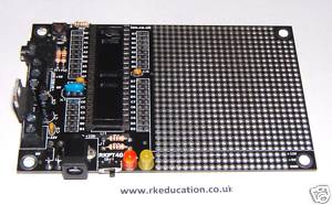

At first most of the switches will just address MACH, but when thats up and running, I will use this (already purchased.)

irving2008
Not all the buttons will be connected to MACH, IE none of the spindle motor speed controls and most of the others are power switches anyhow.

Q4 Whats 'Feed' for?...
If i am to have successful manual control i will need to have a feed rate control
irving2008

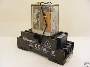

I have these on the shelf too :)

I am as always open to suggestions from people who have experience using a mill both manualy and by CNC so if you see anything you think i have missed or messed up then pipe up because I will just as likely forget..
Having looked at the panel the only wsitches that will address MACH are 2*X, 2*Y, 2*Z, 2*A & E-Stop. that makes 9 I think lol
What board is that (& chip) ?

Ummm, OK, but hows that going to work - which axis does it apply to?
Ricardoco
Home and/or limit switches...?
fleabay item number 250576566482
This is why I think this forum is tops...there is always too many trees...you cant see all the wood, its so helpfull to have someone who can look and see the obvios.
Ok to incorperate the extra inputs you have highlighted i will have to rework the axis control, maybe an axis selector button and a plus minus button..
Thanks Irving.
