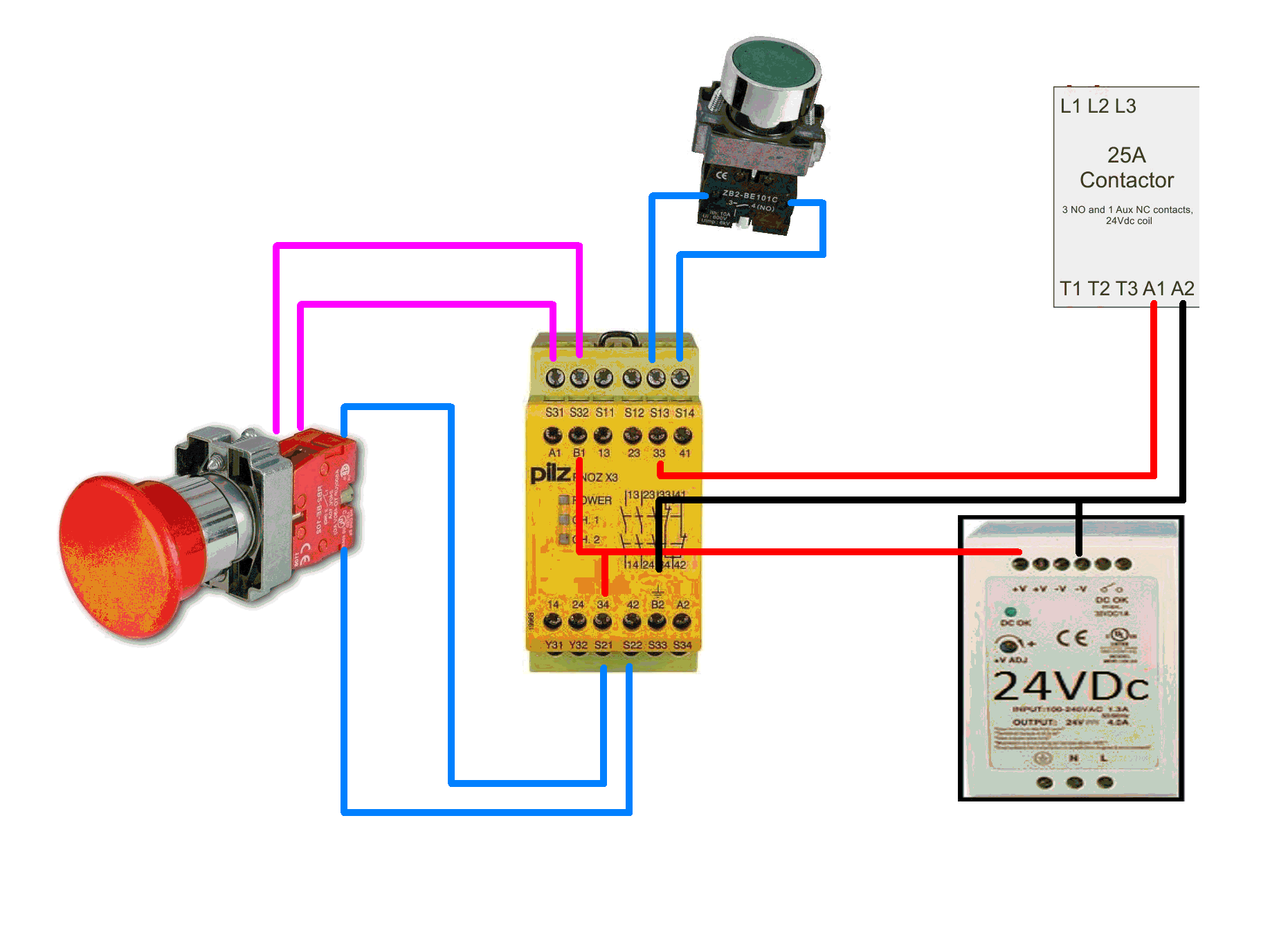

Tonight's task is to work out how a bloody Pilz PNOZ X3 works!!

One thing with X3 is that A1 A2 which are often the DC Coil terminals are infact the AC coil terminals and B1 B2 are the DC terminals.!! . . . . This caught me out a few weeks ago.!!. . . Presumption is the mother of all F@~k up's as they say just like not RTFM. . .Lol

That's the only thing I'm clear on Dean, what I'm struggling to get my head round is which terminals look at which relays. I'm not going to be switching AC now I don't think as I've got a 230V contactor with 24v DC coil coming (3 NO & 1 NC contact) so will switch the AC through there...
Easy neil.
13 & 14 NO Contact
23 & 24 NO
33 & 34 NO
41 & 42 NC
If you want Short circuit across contacts detection then use Dual channel E-stop which means 2 x terminals on each E-stop connected as below.
Contact #1 between S21 & S22
Contact #2 between S31 & S32
Then jump wire between S11 & S12
Reset button Between S13 & S14

Ok so those are the connect through terminals, which are the ones that control them? There's 11 & 12, 21 & 22, 31 & 32.....
Like this Attachment 14964

Quick hand drawing of power circuit so far. Pilz X3 is switching the contactor to kill power on e-stop.
