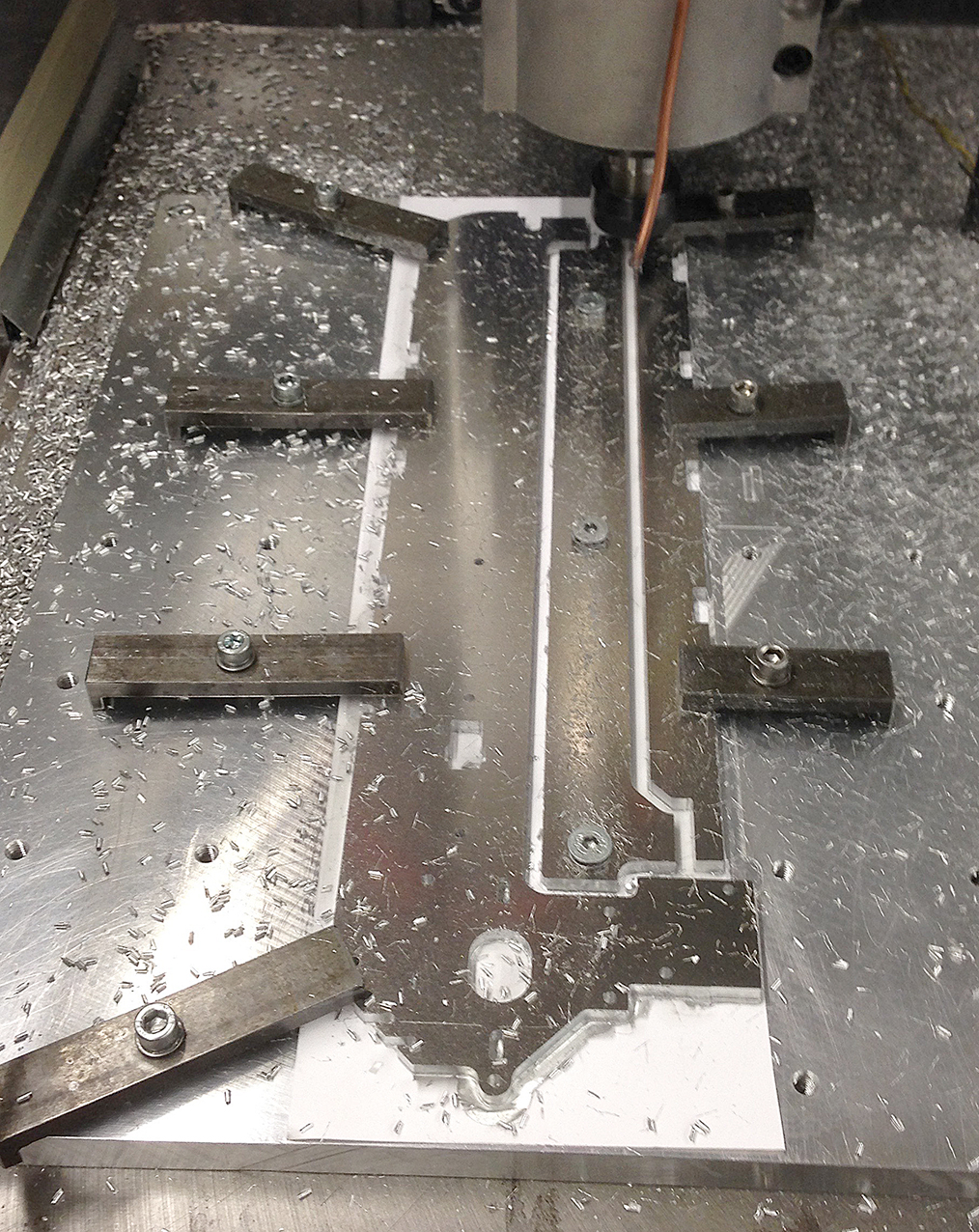

So i would modify the drawing to make the outer edge of the two parts into a single path, then connect the inner edge of both parts into another solid path that overlaps the first path at each end, then as you say, run the small holes and the outer path to finish state and full depth, remove junk frame, add clamps to each part and run middle path to finish.
I'm liking that, thanks. It means adding another two tool changes but thats not really relevant if it ensures the parts come off in top quality AND without any onion-skin to clean up.

Thanks CharlieRam, your idea worked perfectly, best parts so far and a lot less stress on the nerves ;)
I need to make some decent clamps etc but the extra tool changes were more than made up for with the time saved through not having much clean-up to do, just a quick run with a de-burrer and a little emery cloth.

Glad it helped, If you drill the holes first, then do the pockets and outer profile, m00 etc. would that reduce tool changes?
Re: Questions on using a moving gantry style mini-mill...
Not this time because the holes need the 2mm tool to get the sharp corners I need.

Ok, getting smart here...
I want to insert a code snippet in Sheet-Cam that will run the tool to my park position (M883) and then pause for me to dive in and change the work clamps etc for the final processes.
It seems to be posting the code wrong though as shown here:

Unless I am wrong, this will lift the tool (line 24350) then go to park (line 24360) then pause (line 24370) BUT the spindle will still be running as the M05 is not until AFTER the pause (line 24390)??
Seems wrong and dangerous?
Looks a bit messed up but all I am doing is inserting a code snippet that has two lines :
M883 (Go to park)
M0 (Change the clamps)
Any ideas, I have posted on the Sheet-Cam forum but???

From Les at Sheet-Cam:- you have to add the M05 as well because the post does not know what you want to insert so it treats it as text.
Now it looks like this...

Seems like that will work
The new code snippet worked well, very slick now - pauses, goes to park, tells me to change the clamps, then goes to tool-change then starts cutting, nice :)
The only odd thing i saw was that the job timer in Mach3 was reset at some stage, not sure if it was the pause or the "go to park" macro call??
Also made up some nice clamps to replace the bent bits of scrap I had on it ;)
Attachment 18208
The bed does need a skim though, I have found in the tool drawer a nice 12mm inserted tip carbide cutter that should do nicely for this.
