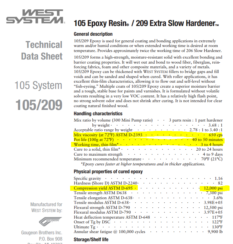

From a first reading it seems to have ( according the numbers of the datasheet ) smaller combined viscosity (225 mpa.s) than 105+209 hardener resign (650 cps ) , also it has pot life 80-100 minutes (slow hardener ) smaller than 105+209 (40-50 minutes) , and the price is 18.42+vat pounds.
I don’t know which product is better for our application.
Its not only that. There are other things important for leveling the rails. The compression yeld, surface quality and precision.

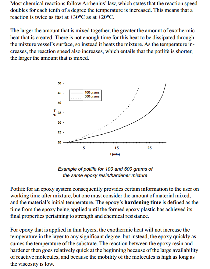

For example west system says pot life of 100gr at 22 C, other says pot life 1lt at 25 C. How to compare?
Also it is not clear what everybody mean by saying Pot life, gel time, working time. I call them . One says all the above are the same, other says they are not. I have not a way to compare.

Also its compressive strength is bigger than west system (13778 PSI vs 12000 PSI )
For sure viscocity is very low ( ten times smaller than west system) , but working time also

2x90mm Hiwin each side, separated at least 90mm each +50mm force spread approximately each side, that 20mm wide= ((2x90+90+2x50)x20)2=14.800 mm2= 148cm2
12800psi to kg/cm2=843kg/cm2 , so we have 148cm2 x 843kg/cm2==124 764 kg . safety factor 125 tons :3= 40 ton gantry , It seems enough, yes?

3. gell time is when the poxy becomes unworkable. Pot life is the same but only if you keep the mix in the pot, where it hardens faster than if spread on the rails. Thats why the confusion. the more epoxy you keep in one pot, the faster it hardens, hence they must state how many g or kg when saying gel time or pot life.
