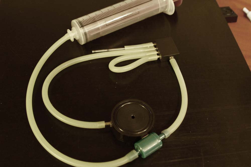

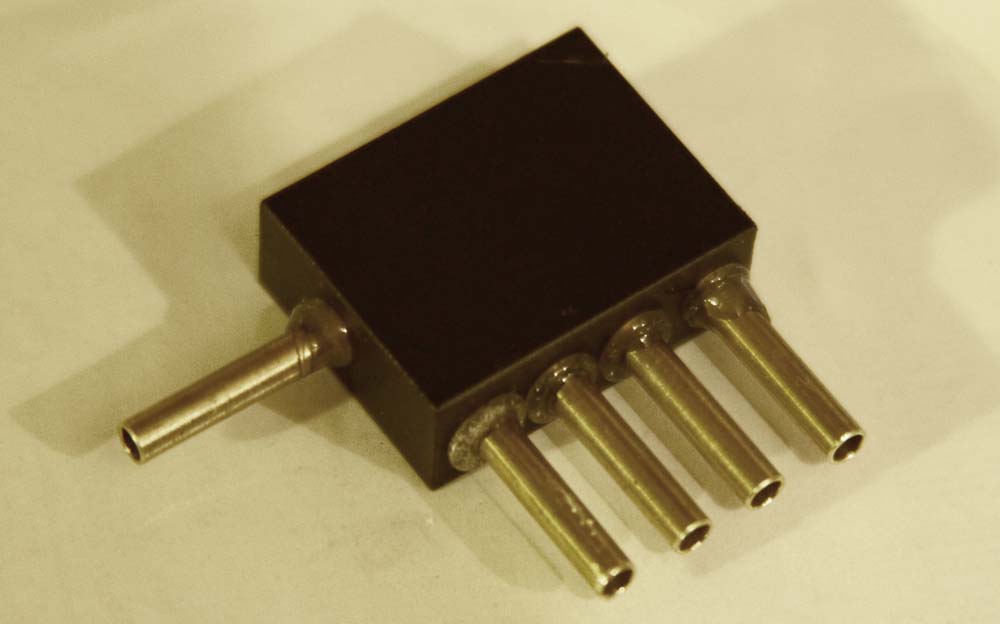

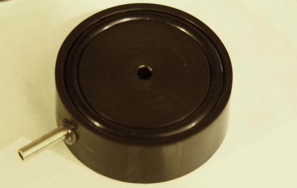

3 Attachment(s)
Re: Fingers crossed it'll cut ally
some developments :) another 4 pads to make and im ready to give them a try
Attachment 3607Attachment 3608Attachment 3609
its probably wise to keep the lose air to a minimum, small bore pipes etc that way you can pull a harder vacuum
i will be using a one way valve between each pad and the manifold (makes sense if you think about it)
iv oppted for the 35mm o-ring size for now they have a good holding force but not enough to bend/warp 2mm alli (i think) i may make some 60mm pads for heavier material cutting if these work out well
the glue im using is the heat type, iv had no leaks so far :)
you could use two o-rings (one smaller and inside the other) to clamp over holes
you could make up some exelent kits with this stuff
but we will see when it comes time to do some cutting on them:eek:

Interesting stuff. You could stick a sheet of whatever plastic you're using down to the bed and mill slots/holes for the air ... then flip it over and cut out a grid of rings to fit your O-rings. Might be worth thinking about what pattern of rings would hold things best - some bigger than others? Could have rectangular ones, all sorts!
I might have a go at this, got some 6mm acrylic that would do the trick. Got plenty of O rings from £1 shop. Some might be big enough.
With a sufficiently big syringe how many pads do you think could be served? Or are you sucking the air out of one at a time and swapping the syringe round?
iv considered it for long runs, might be a pain to get the holes routed to each o-ring if its a complex pattern
the problem with mixing diffrent size o-rings is the diffrent surface arias would compress the o-rings diffrent amounts
im going to try using one syringe and fix one of the one way valves as an exsaust so you could pull the initial vacuum the pad valves will hold the vacuum ill press the syringe home and the air iv removed from the pads will be routed through the exsaust one way valve ?????? if you can get your head around that :)
i need to do a drawing to show you what i mean.... imagine you have two one way valves attached to the end of the syringe, youll work it out :)
am i sending you a large syringe ? (iv got a few from work)
Oh, two valves ... you're using the syringe as a pump!
If you could send me a syringe that would be great, I've not got any that seal any more - found out they don't like concentrated sulfuric acid. I can papal you something for it.
I had better buy some valves and tube. What diameter are you using?
