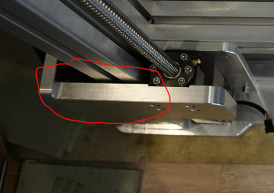

		Hi Zeeflyboy,
Very nice speeds for a small router. I only use about 400mm/min with an 8mm endmill and 0.5 radial cut on my milling machine, so I am rather jealous. I'm starting the process of building a router similar to your new one, but with dual screws/pulley on the X instead of your two motors, so I am following your progress.
One thing I noticed, although your finish looks very good, in the area circled in red you have these vertical lines that are kind of similar to what I sometimes get with my milling similar plate thickness. Do you know what it is causing it?
Edward

 I get similar lines.  I've always put it down to insufficient machine stiffness and slight ball screw backlash (~50um typically).  Commercial machines which are very stiff and heavy, with low or zero backlash don't have them.
