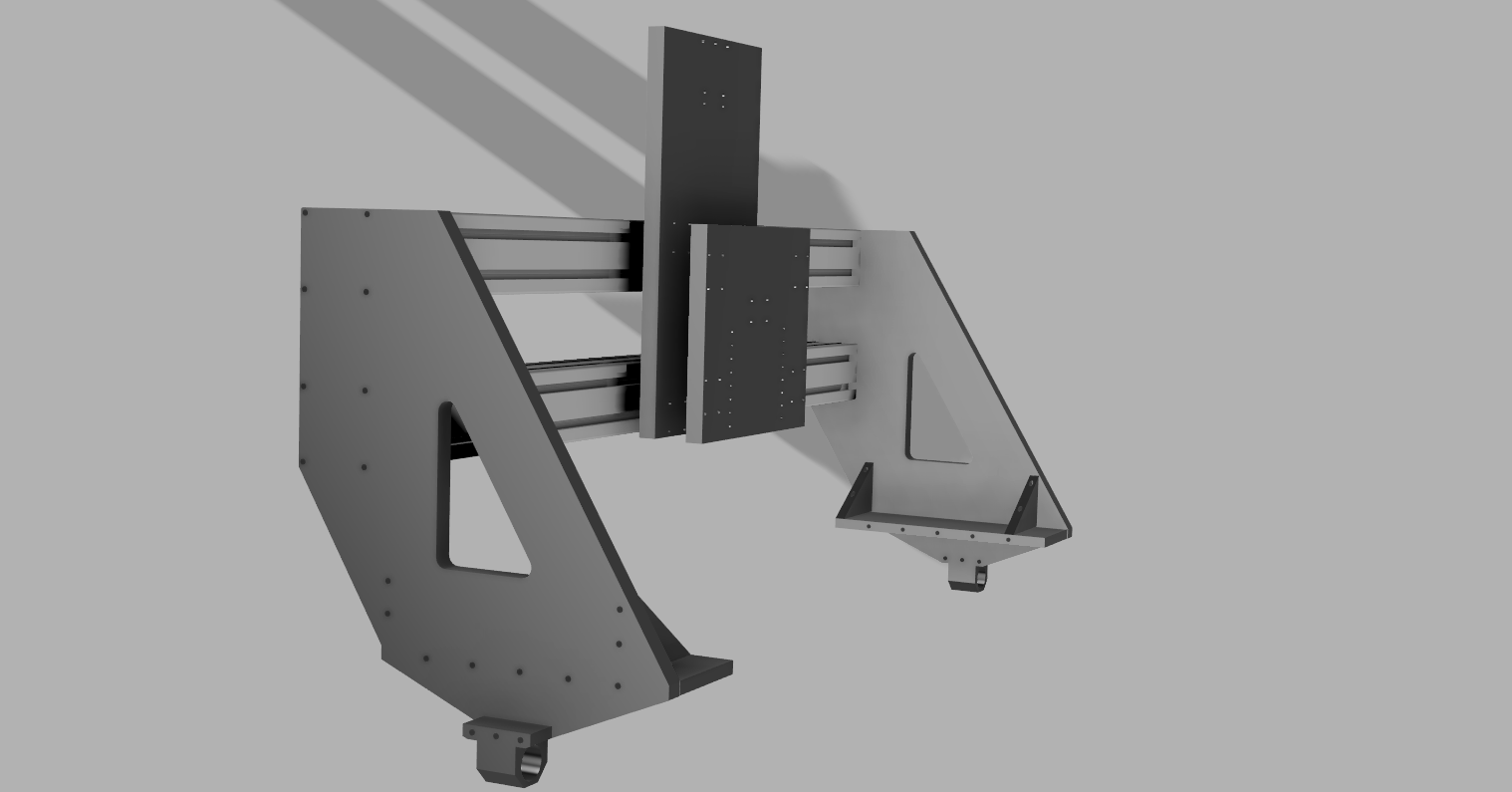

Ok guys - here is my final design
20mm thick
May put gussets over the ballscrew attachment, but Ill wait and see how rigid it is without
Nick
Attachment 19987
Attachment 19988

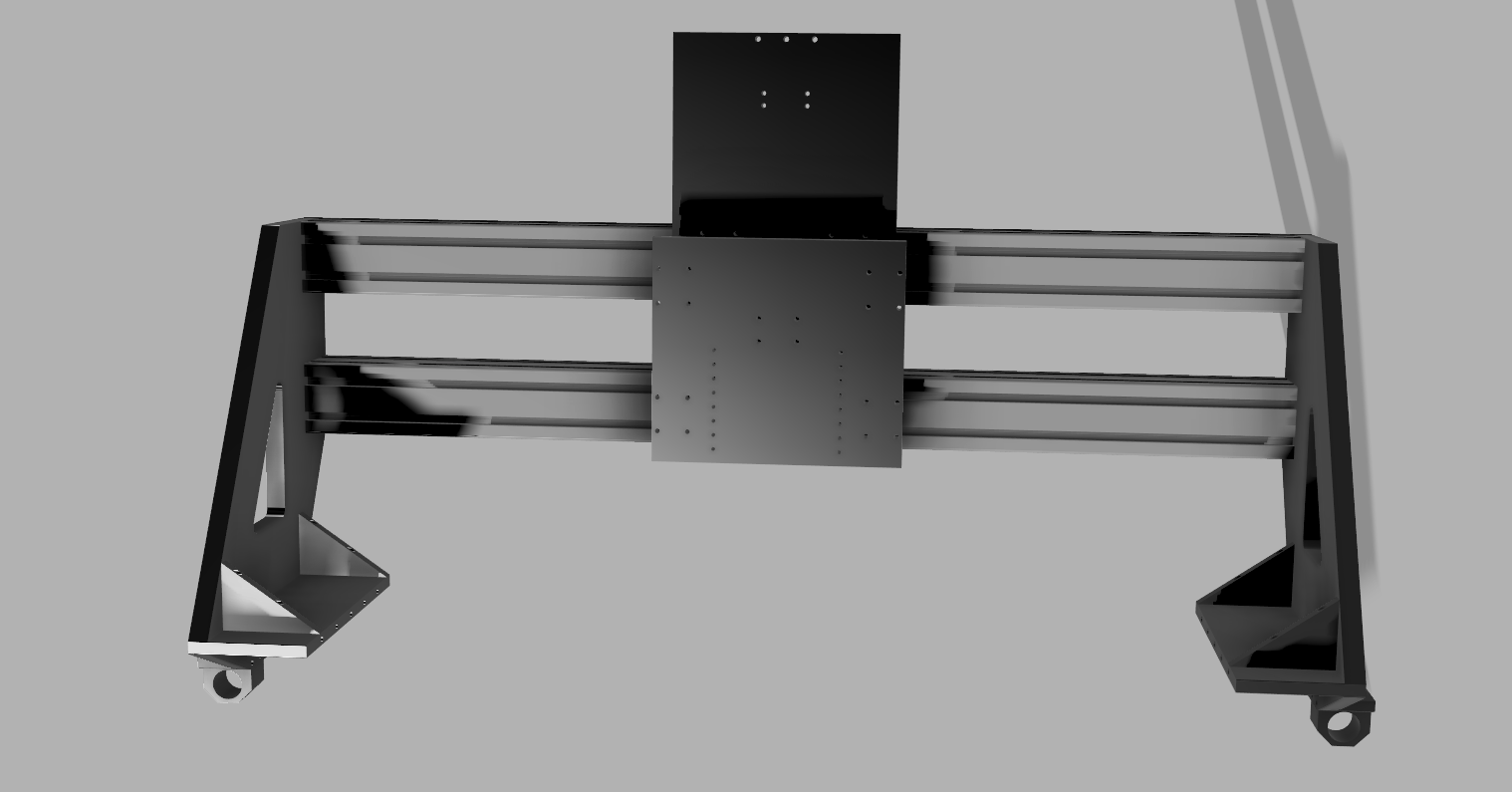

Re: Gantry Aluminium thickness guidance
So it was a busy Christmass
Went with 20mm thick
What do you think?
Attachment 20133

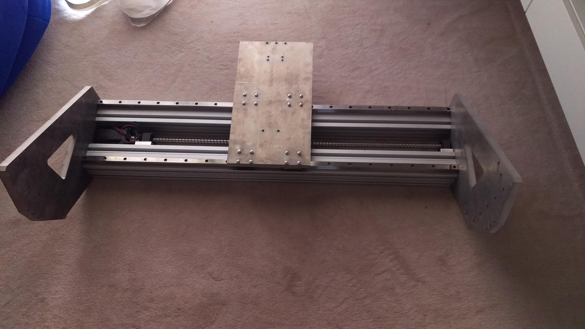

Hi Nick
You have been busy! so have I, finally got my machine cutting. Anyway the 20mm plate on the gantry sides will give stiffness in the Y/Z plane. BTW I noticed on your Z-axis plate the bolts are raised. You should counter bore these so that the trucks for your Z axis will have some where to be located. Remember Jazz's comments about mounting the rails on the back of the plate which holds the spindle and the trucks and ballscrew get fitted to the plate as shown in your photo.
All the best and have a successfull 2017!
Mike
MikeyC38
Hi Nick
Mike
Yeah, thanks for that, I realized this as I was staring at it yesterday, will have to counter bore to even get cart to slide past the bolt head I think.
I've decided to go the other route and mount the rail on the sides of the plate pictured, and just have the cart on the back of the spindle.
