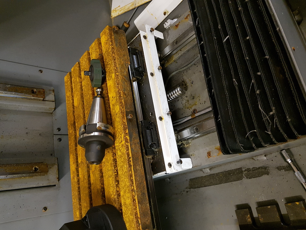

		In between doing 'other stuff' in my shed I had a look under the bellows on the y axis and under the guard on the z.
Not much to see under the bellows although the linear bearings and ball screw don't look obviously knackered.

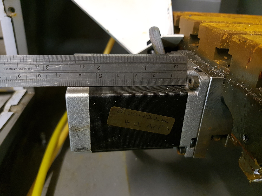

This is the x axis stepper motor,
Attachment 20426
Its smaller than the z axis stepper. I'm guessing its a NEMA17.
I'm going to google the numbers on the sticker (3100422k) to see if it throws up any clues.

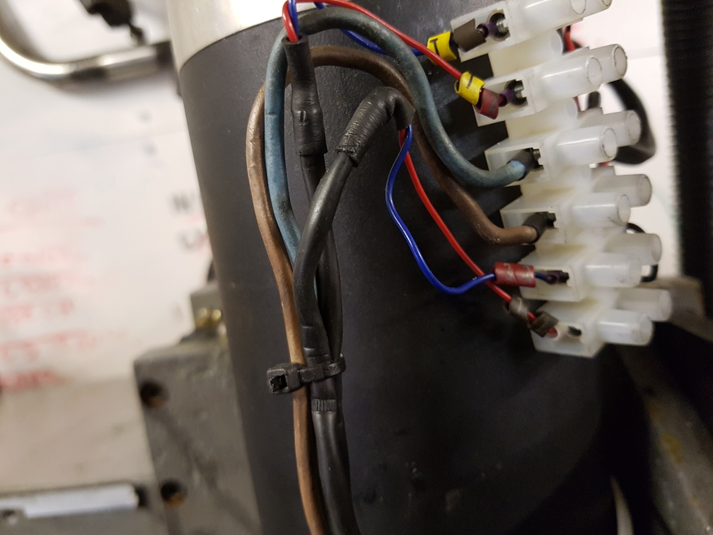

Finally I've had a look at the spindle motor wiring.
Attachment 20428
My guess is that the heavy gauge wires are power feed. I'm not sue what the pairs of red/blue wires are for. The top pair  both have yellow tags labelled 'T'. As far as I can make out the bottom pair has a red tag labelled 22 on the blue wire and a black tag labelled 11 on the red wire. The bottom pair are connected together by a short jumper on the other side of the block.
		Re: Denford VMC1300 - Rescued
		Have you downloaded the wiring diagrams from the Denford forum?
My guess would be one pair is a tacho feedback, and the other a thermal cutout (probably the ones that have been looped). If there's a model number on the spindle motor, you should be able to find a datasheet.
Also, check to see what wire numbers end up at the spindle driver, as that would give you a good idea, as only the power (probably via a relay or two), and tacho feedback will go to the driver. The thermal cutout would form part of the e-stop loop.

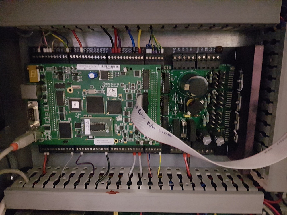

Managed to get some photos of the main components. I'm guessing this is the main motion controller board.
Attachment 20528

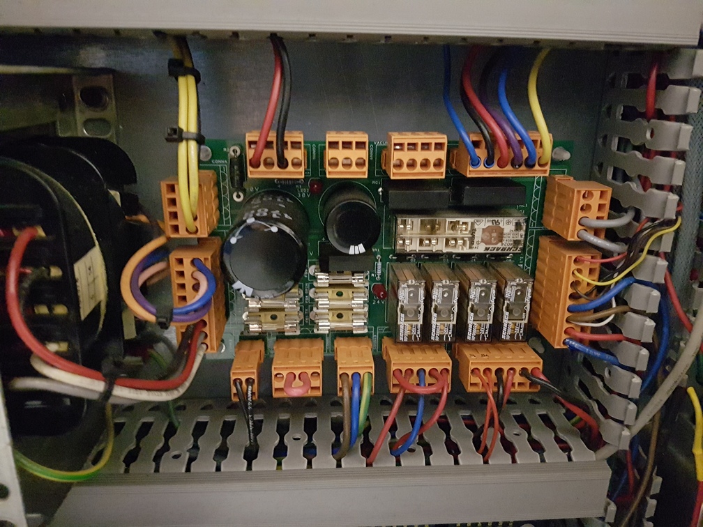

Power distribution (????)

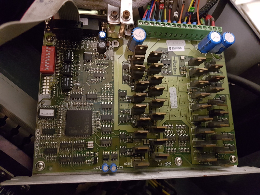

Stepper drivers
Attachment 20530
The stepper drivers appear to be labelled XLT50-S which should help me identify the wiring diagram to use.
My plan is to replace the motion controller with this http://www.ebay.co.uk/itm/EU-Stock-4...MAAOSwjDZYde-j
According to some documentation I have found online (http://www.parker.com/parkerimages/e...ive_manual.pdf ) the driver design is at least 14 years old, on the basis of this i'm going to investigate the options for replacing the drivers with something more up to date, any recommendations?

		EM806s are good drives. Did you order a programming lead, as it makes setting them up easier?
You'll need to study the wiring diagrams to work out what the power board does. I think some of the later Triacs used something similar, and some of the relays are used as interlocks, to ensure critical things weren't solely controlled by the controlled.
The top board is the later controller. Smaller machines used the in built stepper drivers in the lower board. If everything was still connected, you could possibly try powering it up and see what shows up on the 7 segment display. It would give an indication of if there was anything major wrong with the original controller.
