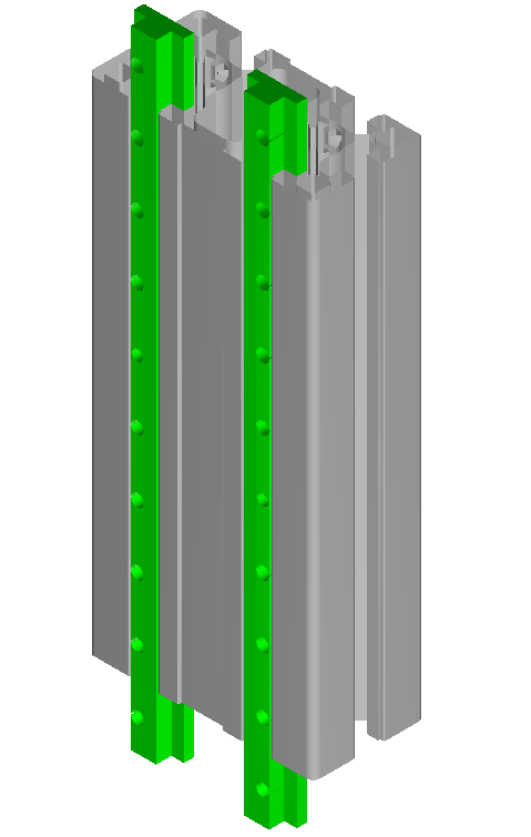

I did some basic cad so I can work out the mounting plates so I can either manufacture them myself or get them manufactured but unfortunately my decent computer is at work at moment so had to use the old laptop which doesn't support decent quality renders so this is the basic rendering made everything different colours to make it easy to see what's going on.
Need to add the ballscrews in of course and motor mounts but this laptop is so slow, will worry about z axis when I've actually build it ;)
Glad I started to cad out as I already see a few things I should tweak winging it was a stupid idea lol.

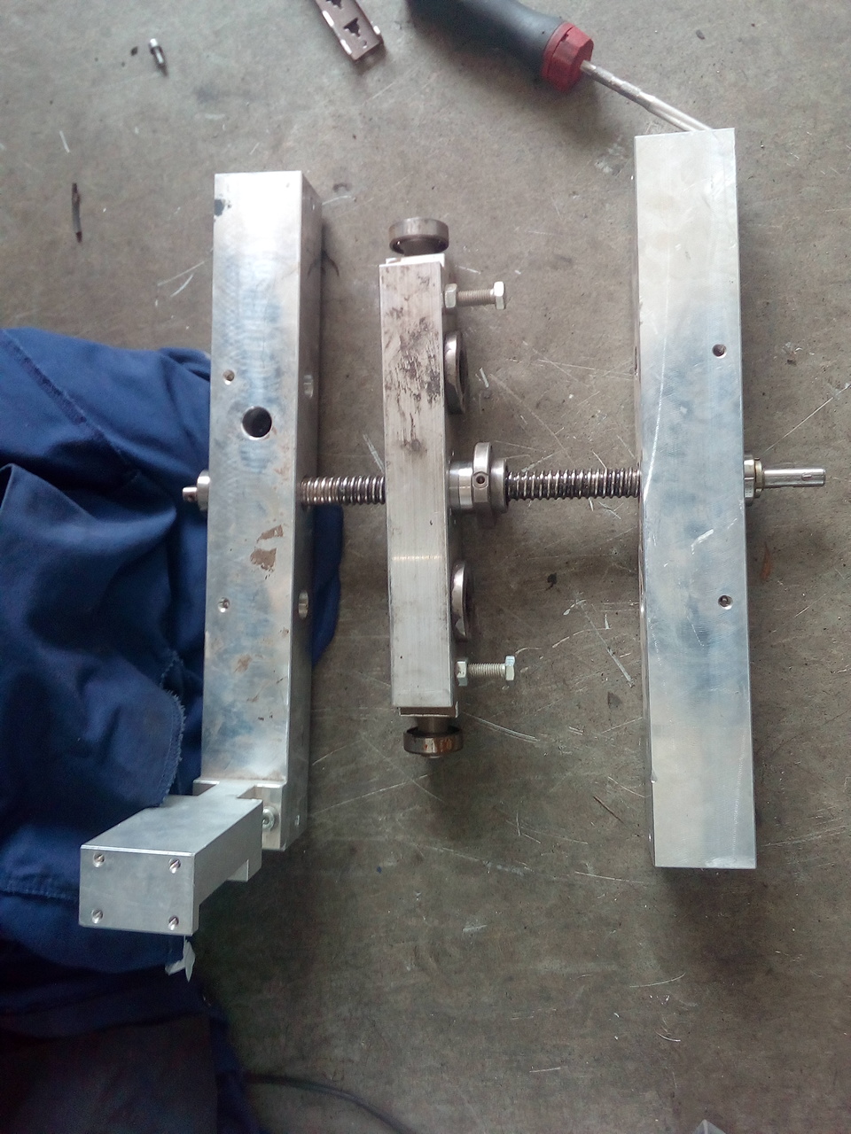

Starting work on my z axis ;)
Attachment 21550
Which means I'm is stripping so I can sort rebuilding this. Getting the bearings out will be fun ;) I do want to reuse these as they be far better quality than anything I would buy.
I need to get a proper plan for rebuilding this sorted as it's obviously very important lol.

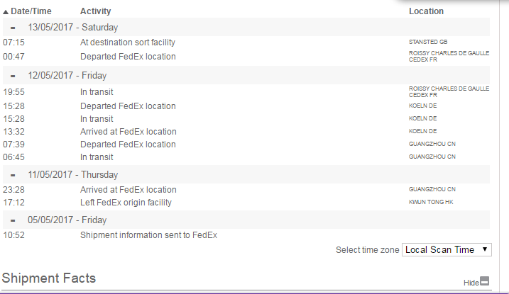

Ballscrews are in Standstead ;) so hopefully Monday they will arrive although we shall see how much import tax we get.
Tracking shows they did nothing for a week and then in 2 days it's here I wonder in future if I can pay a little extra for Fedex not to sit on it for a week lol.
I ordered them on the 28th took a week for the Chinese to organise fedex then a week for fedex to collect lol and then air mail in 2 days without the 14 days of mucking about they would have been super quick.

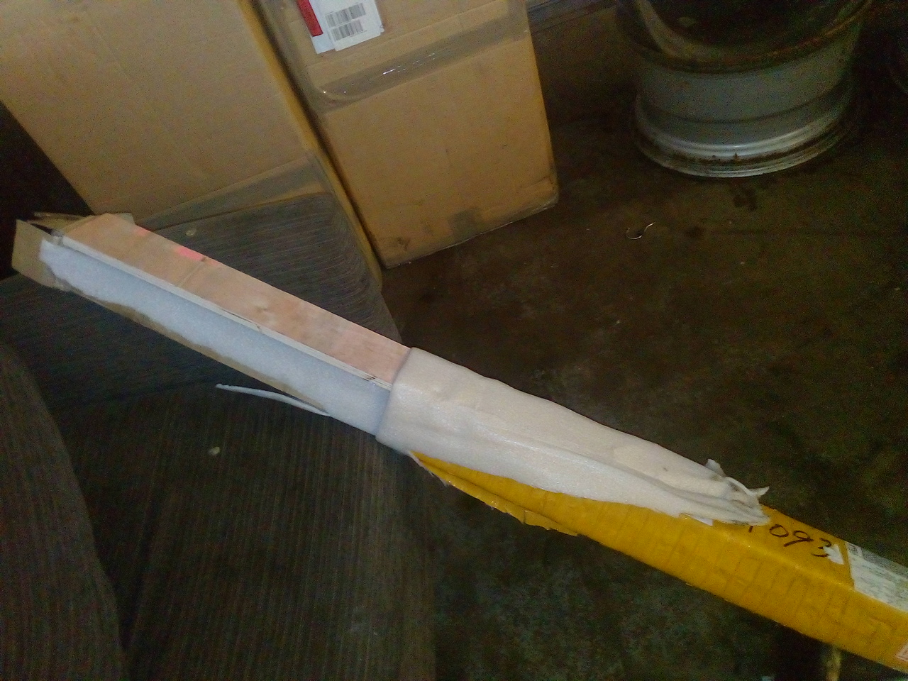

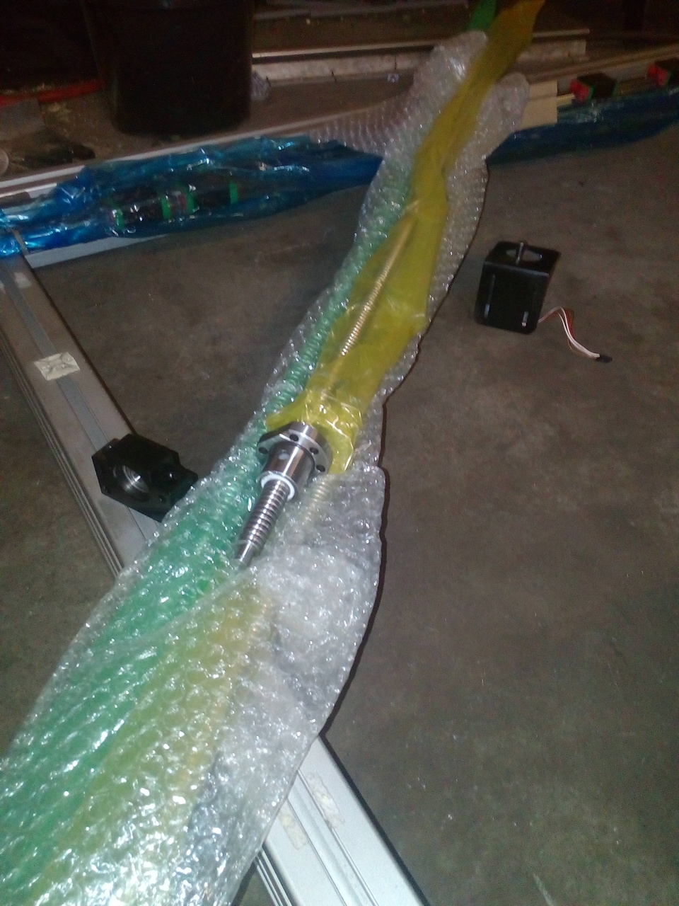

Ballscrews came ;) So Saturday will be play day and then Sunday cad day and Monday start getting the plates made for mounting everything.
Ballscrews were packed extremely well with plywood to keep them straight very happy with purchase and NO IMPORT TAX!!! So very happy.

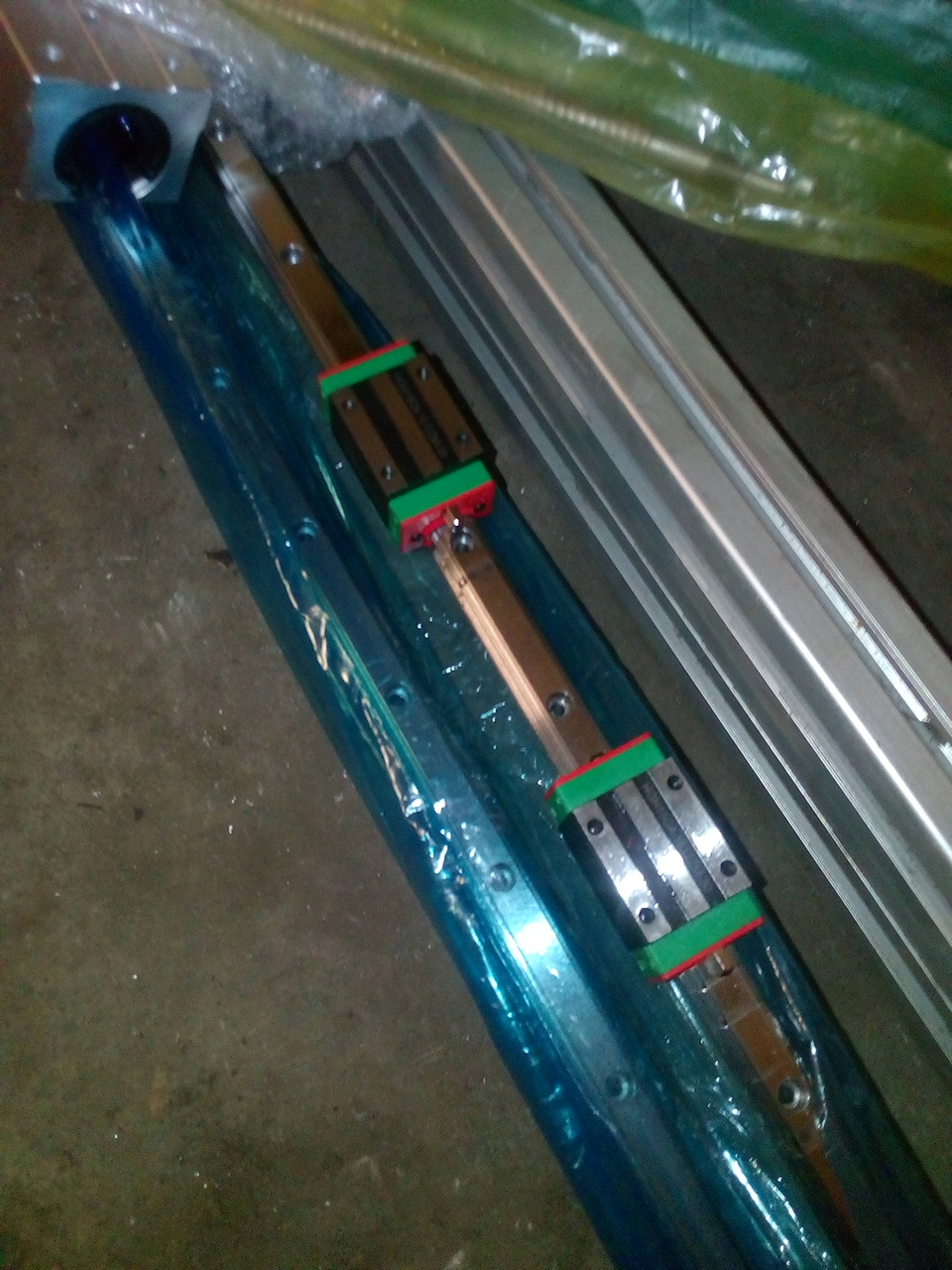

Ordered 2 nema 23 1.9nm motors, got m4 tee nuts for the 15mm Hiwin's (This was annoying as I have a couple of hundred M5's) and ordered A2 M4 machine screws to mount the Hiwin's as screwfix and toolstation don't have the right size I hope I got it right lol but £2 I can afford to order more if not.

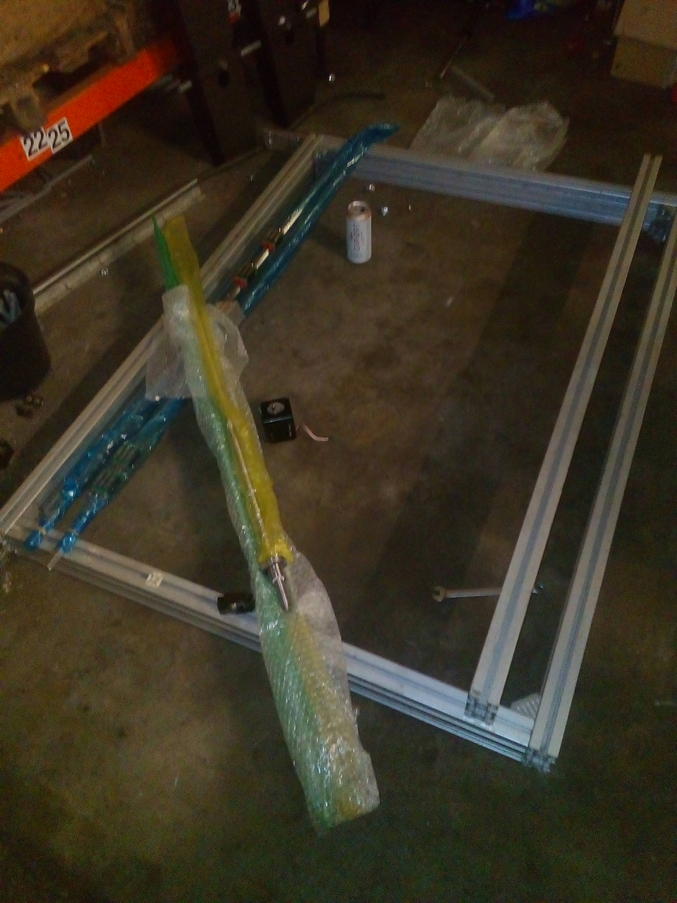

I find the Carlsberg export is essential to any machine build lol especially on a Friday night ;)Attachment 21737

The ballscrews were packaged properly
Attachment 21736
I love how tight the hiwin rails are (I paid £100 for 4 blocks, 1500mm long 2 rails) they're lovely to slide but I do worry 15mm is too flimsy.
Attachment 21495
Seems it would be better to built the gantry spanning the shorter width of the machine? Any particular reason you are building it that way around?
Gantry tends to be the weak point in terms of allowing flex, the shorter the span the more rigid it will be for any given thickness/extrusion type.
