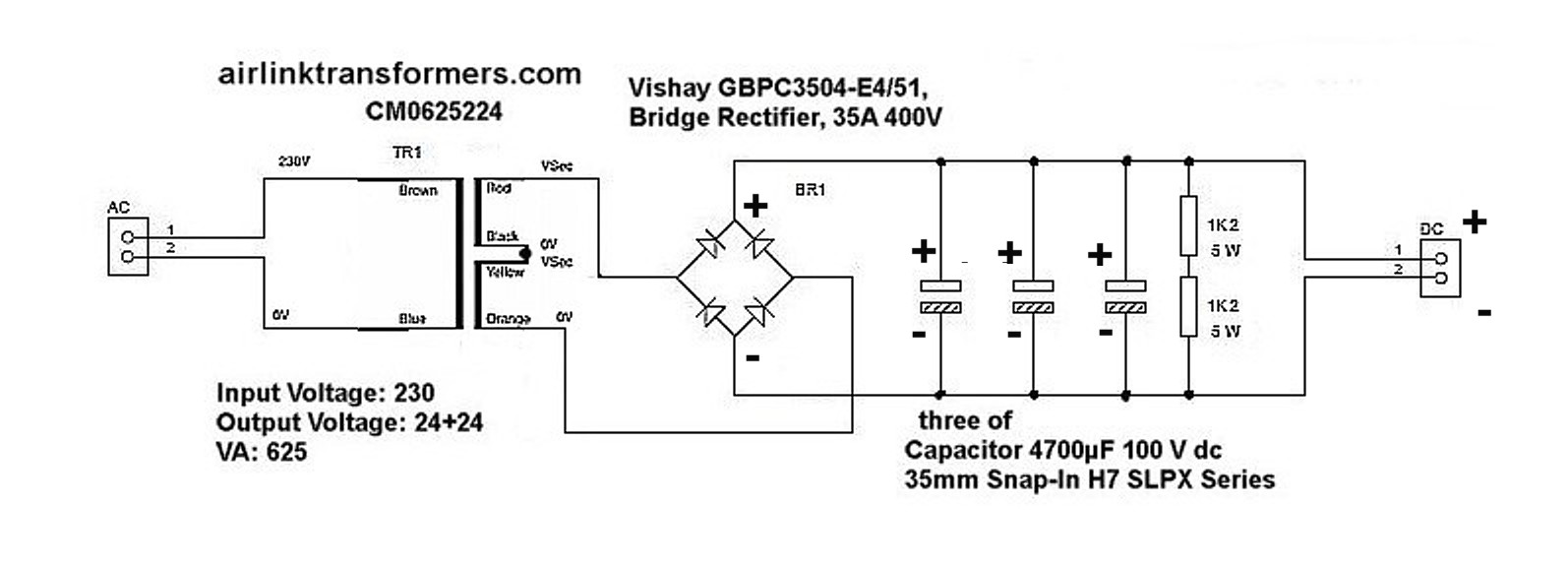

hi. this is what jazz sent to me for my psu. i'm running 2 4nm nema 23's and a 8nm nema 34 and it runs absolutely fine
You'll need:
Transformer with 2 x 25V secondery coils with 625Va output.
1 x 35A 300V or higher Bridge rectifier
3 x 4700uf 100Vdc capacitors with holders.
This transformer will work.
http://www.airlinktransformers.com/c...nge/CM0625224/
This Bridge rectifier.
http://uk.rs-online.com/web/p/bridge...fiers/6296320/
Capacitors
http://uk.rs-online.com/web/p/alumin...itors/8712748/
Brackets:
http://uk.rs-online.com/web/p/capaci...clips/2035698/
if you search for it there is also a wiring diagram for it on here somewhere. all you need is very basic soldering skills and its easy to do

Hi John
the link to the transformer does not work
a web search for the part number cm0625224 links to
https://airlinktransformers.com/prod...ange-cm0625224
power supply circuit
Attachment 21911
Attachment 21910
I notice that data sheet for the transformer does not specify the transformer regulation (change in output from no load to full load)
the 24V output from each secondry is when fully loaded
I expect off load it could be 5 or 6% higher
in my part of the UK, depending on the time of day
the mains supply is 243 to 248 V RMS
when the mains supply is 248V
the DC power supply output can be about 77V DC off load
or 73V DC fully loaded
John

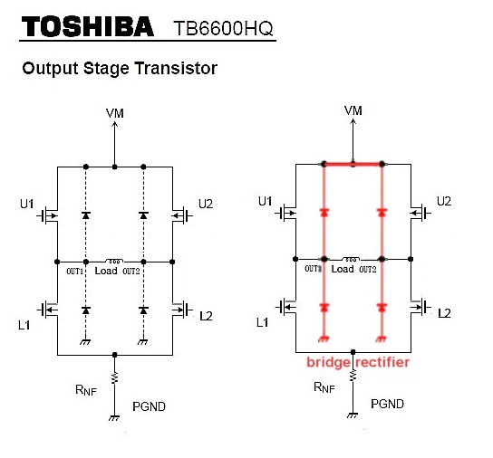

Hi Neale
The other variable is when an axis decelerates and the motors becomes generators returning energy back to the power supply capacitors
the voltage at power supply terminals could be increased beyond the drivers limit
if the decelerating axis returns a lot more energy than other axis use and the power supply capacitors can absorb
John

One reason I went with 2x45V in parallel rather than 2x24V or 2x25V in series is that it gives a few volts headroom. As has been said already, these transformers are specifically wound in a way that allows parallel connection safely but you shouldn't parallel-connect arbitrary transformer windings. Phasing is important; get it wrong with series-connection and you get zero output but get it wrong with parallel-connection and you are going to have a very hot transformer very quickly (before the fuse blows...) I'm using 625VA, but from some power measurements I have done on my machine, I reckon that 500VA is plenty. However, the bigger transformer was only a few quid more and it fitted the space available, so I went with the over-specced option. If I were building these things commercially, I would go 500VA or maybe a touch less and still be confident that I was going to run within ratings. I have a habit of over-building my own kit...
This link gives some results I measured on my own power supply. Yes, there is still a lot of mains frequency ripple on the DC side but the stepper drivers are very voltage-variation-tolerant. After all, they are typically specced to run between 24-80V absolute max, something like 28-70V in practice. While it is true that there will be some back EMF when the motor is decelerating, I didn't see any obvious evidence of large spikes on the oscilloscope amongst the general high-frequency switching noise (although I accept that this kind of thing will be difficult to see) but you have to remember that there are the smoothing capacitors that are going to take the sting out of these voltage spikes.
Overall, and even though I'm not the kind of guy who generally accepts blind "do this and you'll be OK" kind of advice without a bit more analysis, the answer is that everyone who has used 2x24 or2x45 transformers with 3x4700uF or 2x6800uF capacitors with the AM882/EM806 class drivers has been very happy with the results and you are unlikely to do better than this.
