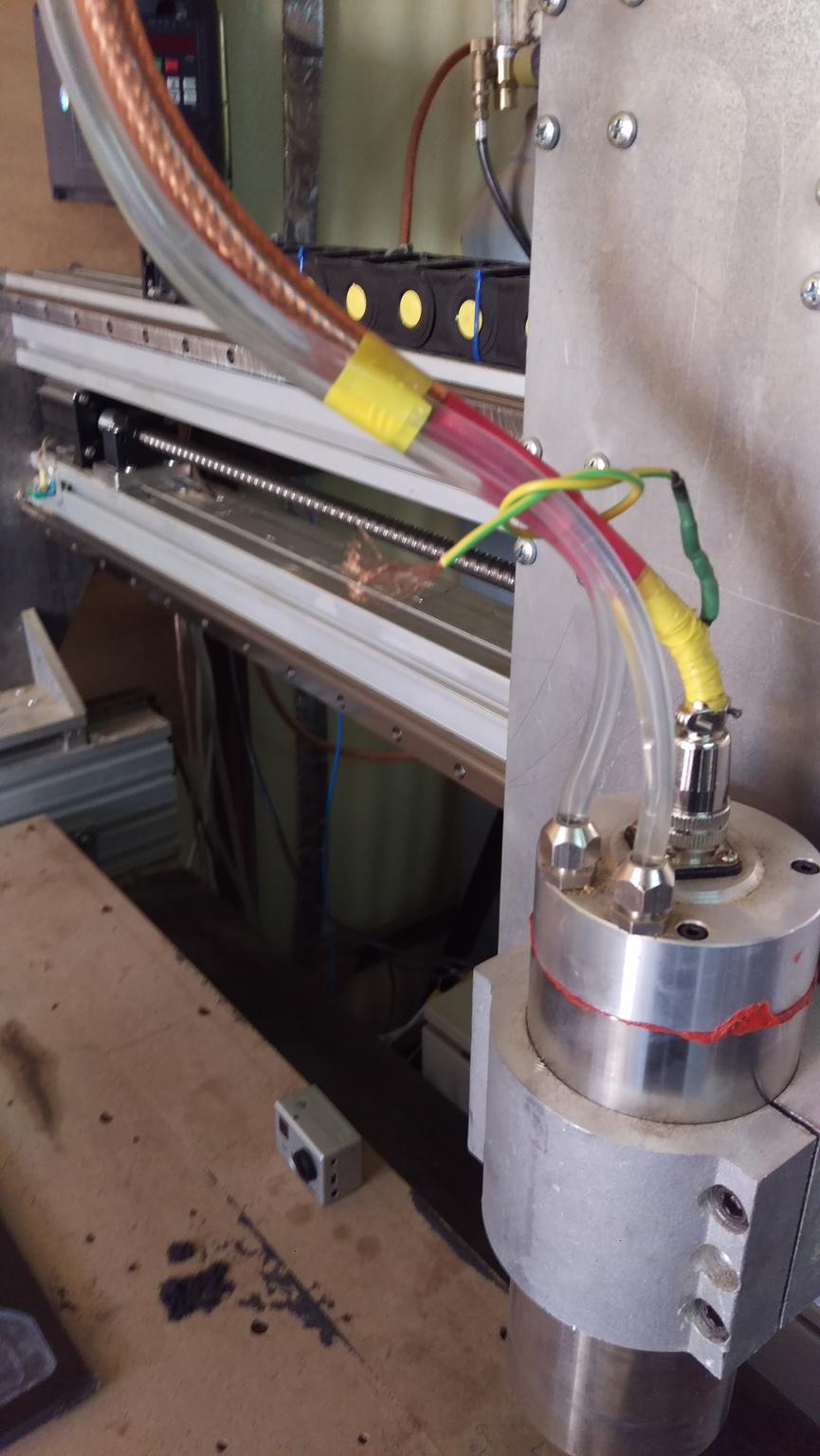

Ok - I've now noticed that the X axis jam that happened in mid air snapped the coupling in half.
Just ordered some different spindle shielded cable - siemens proflex EMV
I do have the spindle running in the same 50mm cable carrier as the X / Y motors... would this normally be ok? I don't think I've seen a DIY machine that doesn't run this setup yet?

Normally it is not an issue to run the spindle and stepper cables in the same cable carrier. I have done that and never ever could relate any problems to that.
Right now I think you are a bit upset and inconsistent/badly structured in your efforts to finding out what's wrong. I think it would be a good idea if you could cool down a little, accept the fact that you have many problems and try to solve them one by one. I understand that you are upset and emotional but it does not help in fault finding. Remove the spindle from the loop by completely disconnecting it from the mains. At this moment milling air is perfectly fine. No need for a spindle at all. Try to solve all the other issues first since your machine is useless as it is anyway. Describe your machine, post a few pics of major parts and technical specs and settings. Answer questions instead of asking loads of new ones in a non-structured way, because at least I have problems with understanding your actual issues, there seems to be far too many and probably not related to each other, but I don't know.
The snapped coupler may be because you are using the type which is frequently sold on eBay as "flexible coupler" and basically is just a joke and they can snap and also cause other issues, but since you don't post any pictures or video it is difficult to say what can be the problem with each issue.

So guys,
I am fairly confident that I have diagnosed the problem correctly.
Background - I seem to experience random jamming in the X / Z axis, where by the stepper would loose any huge amount of steps - up to 5 or 10CM of error per event.
It only happened when running parallel type operations with multiple quick Z or X axis toolpaths, or both at the same time. I can run a parallel operation in the Y direction with Fixed Z height, and have no issues whatsoever for hours, but the other direction - within 10 to 15 minutes guaranteed motorStall in Z or X
I changed the power supply from 600W switching, to 700W torroidal, to 1000W torroidal.
I tried 2 x different Gecko drive motherboards
I bought new Ethernet cabling from the laptop to ETH400
I replaced the Geckodrive with a PDMX126 + 5 x Leadshine AM882 digital stepper drivers
I ran the motors under both 3.5 Amp peak setting, and 3.5 Amp RMS setting.
I observed stalls occurring randomly 10-20 minutes in, in every single one of those tried changes
I currently have the Max speed set at 80% of motors peak torque rating, and acceleration set at 10% of the slowest acceleration speed I was able to generate an inertial induced motor stall.
I cannot physically make these motors stall no matter how hard I push / pull / sit on the gantry while it's moving, yet it still stalls mid air unloaded.
After finally videotaping 3 stall events, none of which were cause by excessive speed, loading or acceleration, and also noting the AM882 failed to detect the stall.. I then unplugged the spindle and on the first attempt got to the end of the toolpath without error ( It had failed 100% of previous attempts, within 13:20, 12:00, 9:00 and 17:00 minutes on the recorded occasions - including 2 of those where the spindle was spinning in the air, with and without a tool in, and not cutting anything during the test run but with stalls both occasions. )
Based on the above evidence, that the stalls are not occurring in the same place, or even at the same time, and I can't find any mechanical issue with the machine, It has to be an electrical problem.
It is not effecting the Y axis, and the Y axis cabling does not run anywhere near the spindle cabling, but the X and Z axis runs right next to it the entire wire length.
So, I have ordered some heavy duty VFD cabling ( siemens Protoflex EMV ) and I am also going to re-wire the Z and X stepper motor cables, with some different Foil + wire shielded, and move them to either sides of my cable tracks, with the water lines in the center.
After re-doing the cabling, that is almost the entire electronics replaced, except the ETH400, and stepper motors themselves.
My toolpath is being tested by the UC400ETH retailer, to confirm they do not see any issues from it during the parallel operation, to try rule that out also.
Should be able to test in a few weeks when new cabling arrives, Let you know how it goes.
