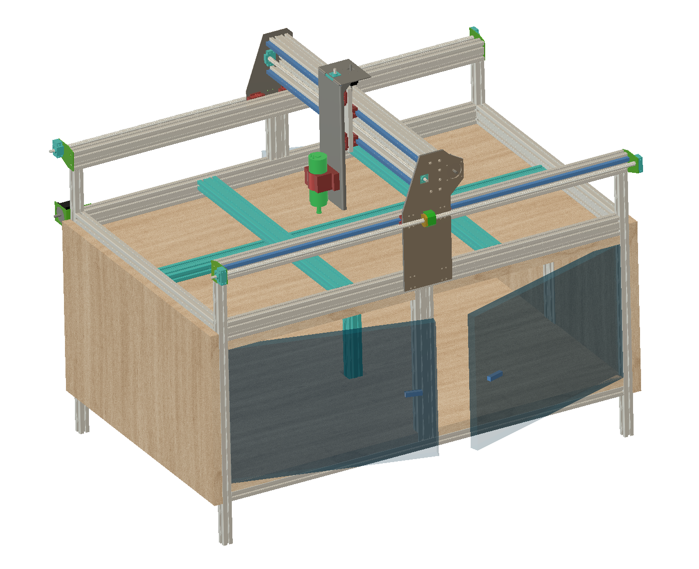

3 Attachment(s)
Re: Starting do design out my build, looking for critique

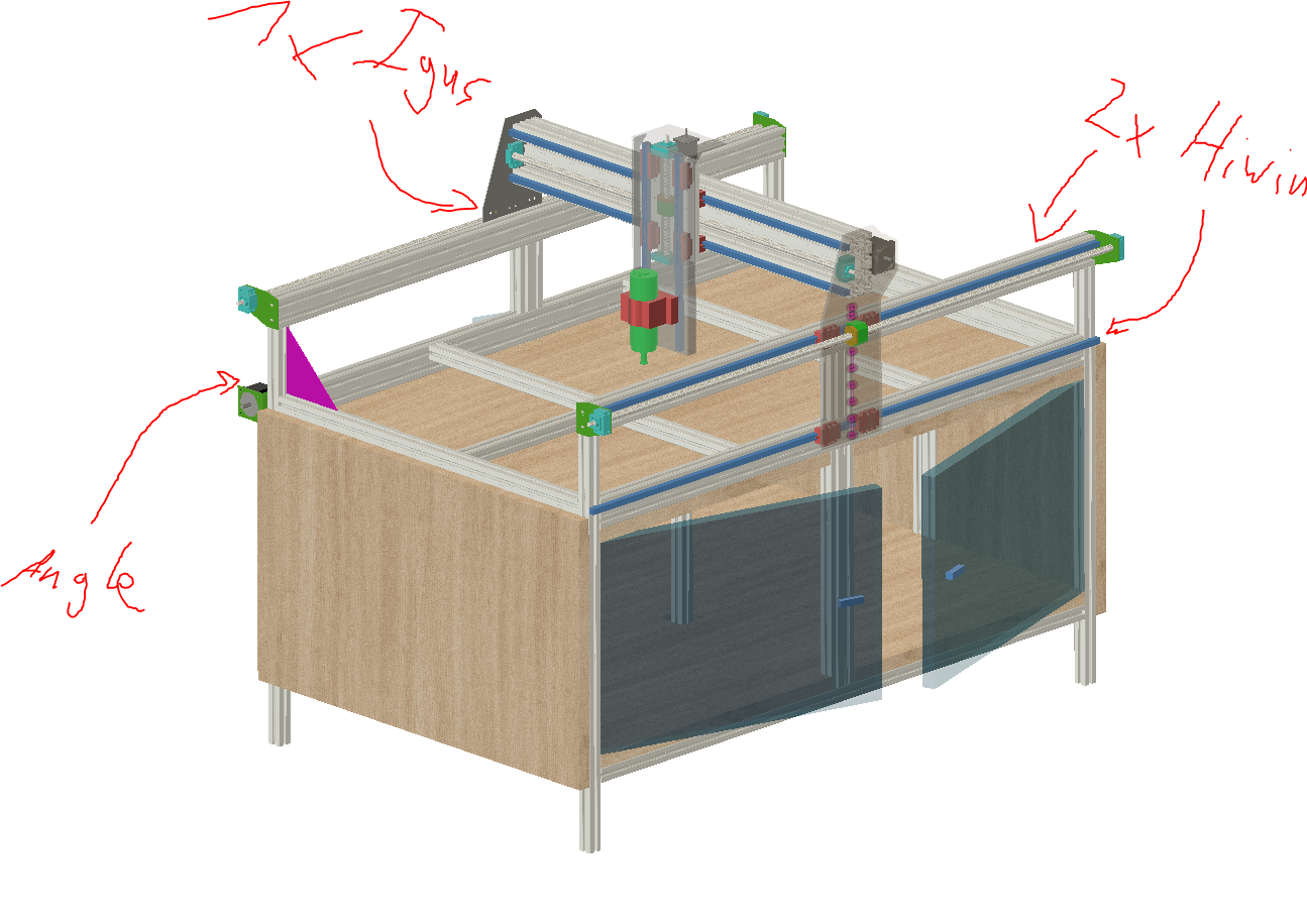

More progress, at least in the design department!

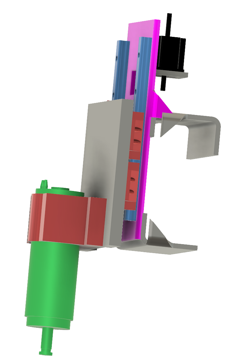

I did decide to design out the Z-axis a bit and plan on how to build it up, especially since one of my coworkers asked me the fateful question of: "Well it is technically possible to manufacture, but are you sure, that you can actually put it together like that, when it is in front of you?". With the earlier draft, I have no idea if that would be possible to actually assemble without a huge hassle, so I thought about it and came up with a better design, using screws and bent steel plates. The pink plate I will probably be changing out for a thicker aluminium one. Also something of note is that the bends and such are not accurate. I simply don't have enough time in Fusion's Sheet metal work-space, so I just went with the default settings for convenience's sake. After taking another look at your machine, since I was asking myself how to get more length out of the Z-Axis, I will probably also switch the rails to be on the sled and the bearing blocks to be on the gantry, like you did.
Attachment 26013Attachment 26014
I also changed the size of the machine in my Fusion design to reflect my "updated" plans for size. This broke a couple things that I did not yet get around to fixing, like the floating plates and angles, as well as those two Z-Axis bearings floating in the middle of nowhere. The original size was guesstimated around 1m x 0.8m x 0.2m while I was still messing around with the base design. The "new" size I plan on having is: X: 2m, Y: 1m to 1.2m, Z: ~0.3m to a max of 0.5m. I am not quite sure about what a good measurement for the Z-Axis would be, so if there are any values that have generally found agreement in what not to exceed, let me hear it :D
Attachment 26015
For the linear motion setup, I am planning to use Chinese 1610 Ballscrews and HIWIN-style rails (note: not original HIWINs). The reason for that is that I started pricing out the build to where I now have a pretty "final" (well, as final as it can be at this stage) price for it, bar the uncertainty of import tax and the like. All in all this puts me at around a 3k € to maybe 3.5k € total, if taxes end up really high, and of course, planning in a cushion in case something goes wrong. The difference of the Chinese rails to the original ones is quite significant in that, however, with the bundle of ballscrews, ballnuts, BK and BF blocks, linear rails and slides, being 50% more expensive, when using original rails, with all other things being constant. But I still have to ask: Are those rails okay to get, or are there any known problems with them, accuracy-wise or otherwise?
I have also checked these lengths in the motor calc spreadsheet, and with the 2m axis, I would now be down to 5.2m/s rapids from 7.5m/s. Should I reduce this to get back up, or should I be keeping it? My reasoning for going as big as possible, is to get the "best value", so to speak. I don't want to be caught standing there with my pants down, when a project requires me to have big machine. Alternatively I could also go with 2010 ballscrews and up-size my stepper on the X? I might need to properly calculate the increase in price for that out.

Now, on a completely new note: I have finally taken into account that I still need a table. I have chosen to keep this one on the back burner for a bit, until I got a preliminary pricing done for the machine itself, and I am now considering how to do this. Most machines I have seen so far, are using a steel table, that even reaches above towards the Y-Axis, where I have those big plates. Since I am using aluminium profiles already, I was thinking that I could just buy some more and make the table out of that. This would also allow me to slightly redesign my machine and allow for a similar design like yours, for example, with the raised sides. I am guessing that would be a huge plus in terms of rigidity, compared to my steel plates approach? I would, of course, loose some access and some space on the sides, accounting for the width of the extrusion, but with how wide the Y-Axis sled is, that should not be a problem in terms of actual cutting width loss, if executed correctly.

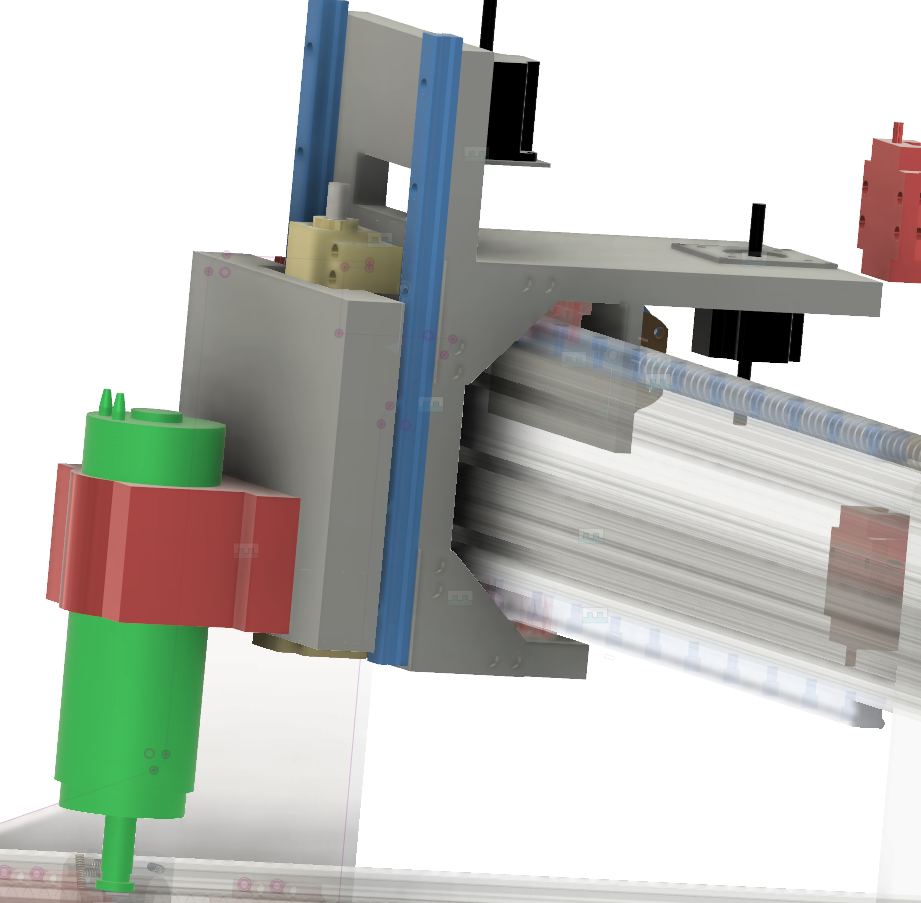

8 Attachment(s)

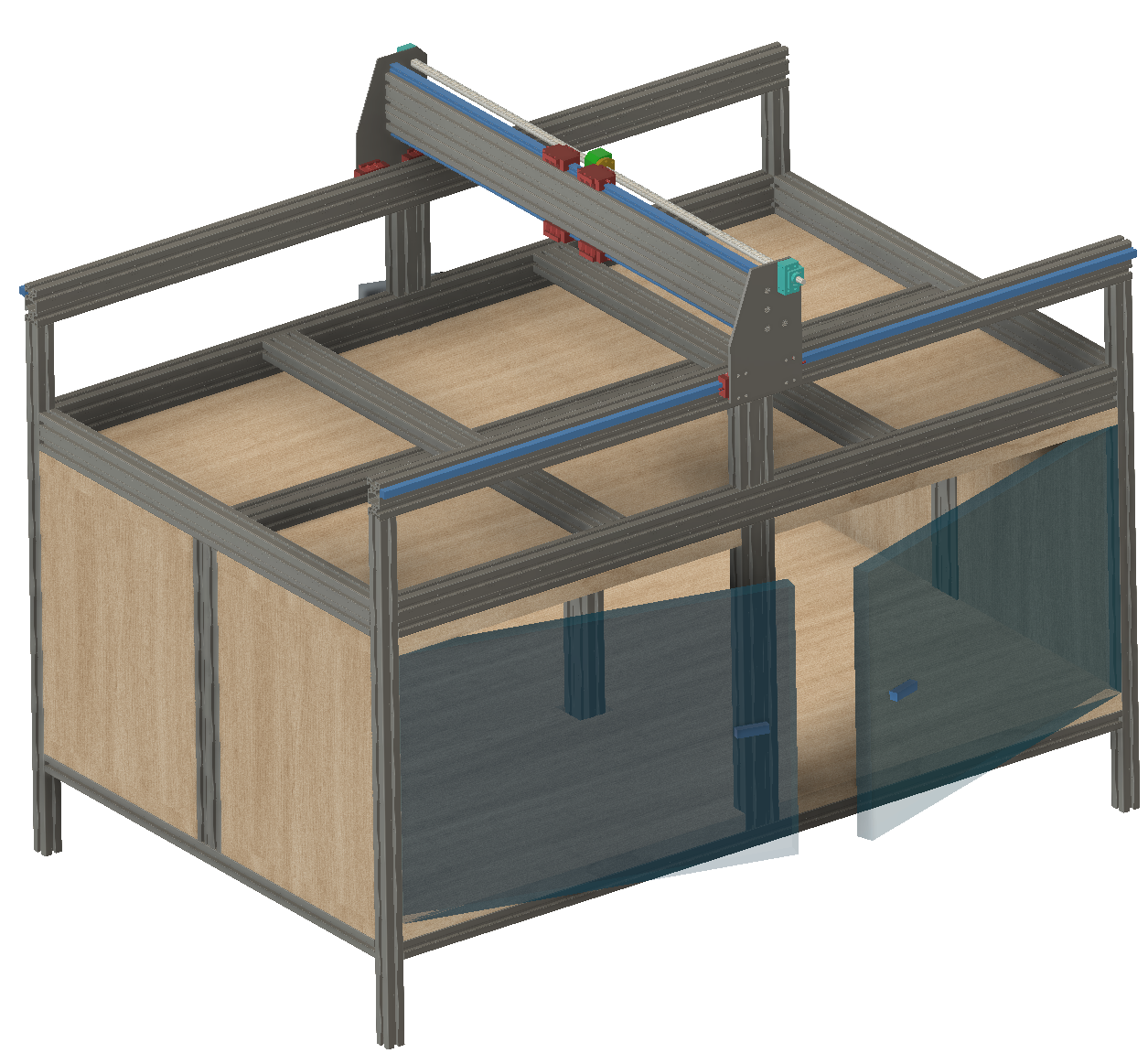

Hey everyone! More progress on the redesign. I sat down and actually worked on it everyday this week, and got some real progress done, finally. I am much more satisfied with how that one turned out, compared to the old one. Here is a side-by-side:
Attachment 26043Attachment 26044
It is probably obvious, but the old one to the left, the new one to the right. This will be the convention for pictures for the rest of the post as well. (On a side note: The blue extrusions are going to be changed from 45x90 ones to 45x45 ones, to save money. I just have not gotten around to fixing them in CAD, since they were pretty low on the list in terms of priority)

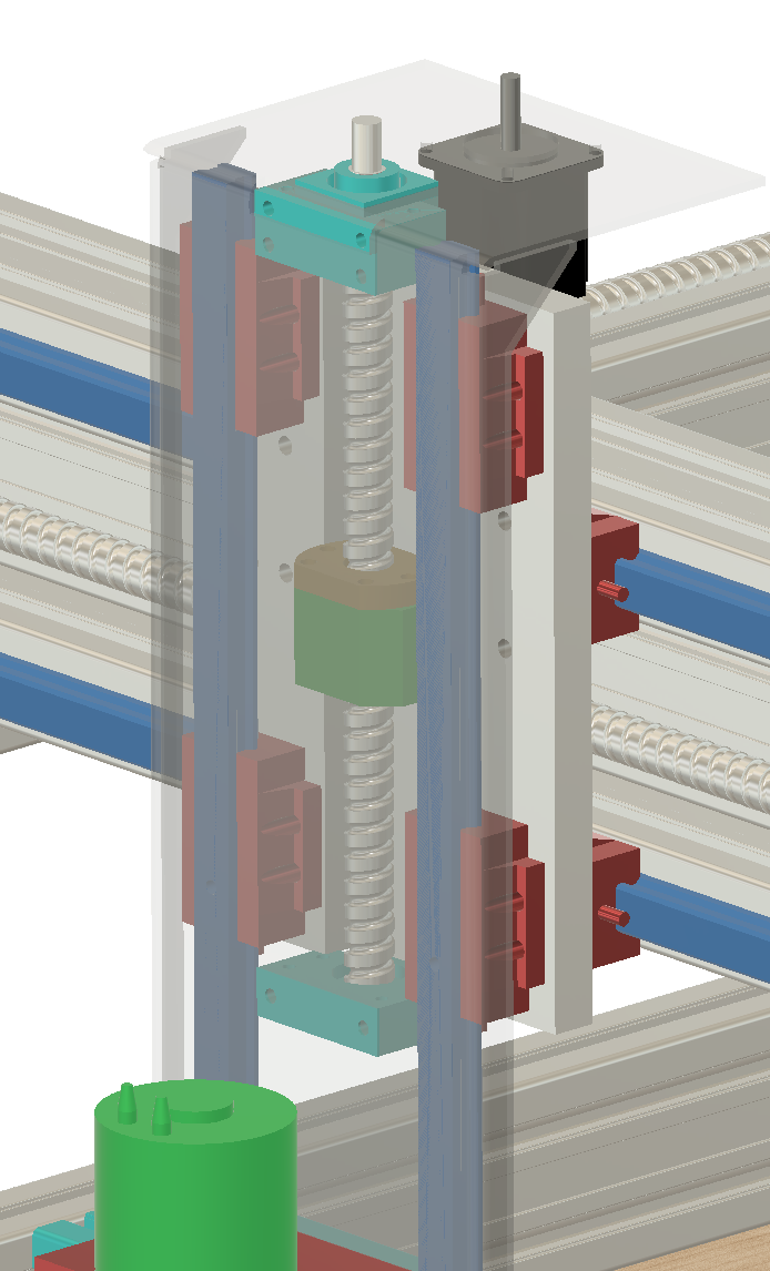

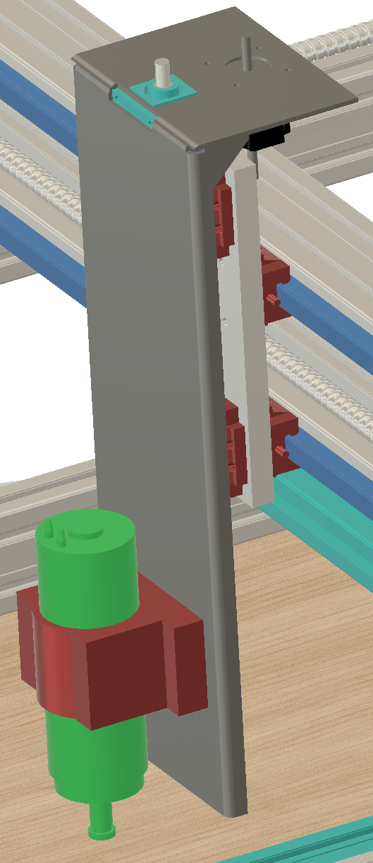

While being at it, I also changed a whole couple of things: Like the Z-Axis
Attachment 26045 New: Attachment 26046Attachment 26047
The Z-Axis got completely changed. Where it was a complex part before, it is now a rather simple bent sheet steel piece. The motor is now also affixed to the Z-Axis itself, and is moving with it. This is to keep the Gantry-side Y-Axis sled small. It also theoretically means, that I don't need to change anything but the Z-Plate, the rails and the Gantry sideplates to add more Z-space later on, if I ever decide on it. All in all, I like the design change of putting the bearing blocks on the Gantry sides, and the rails on the Z. Allows the parts to shrink a bit. That is one design change I picked up from AndyUK's build. The Ballscrew is also mounted on the moving Z-Axis, with the Ballnut being fixed on the Gantry Sled. One question that I still have, however, is how the cutting spindles actually get mounted to the Z-Axis. I understand that the spindle itself is mounted in the red aluminium ring, but how is that ring mounted? None of the pictures I could see in the offers showed any mounting holes. Are you meant to drill those yourself?

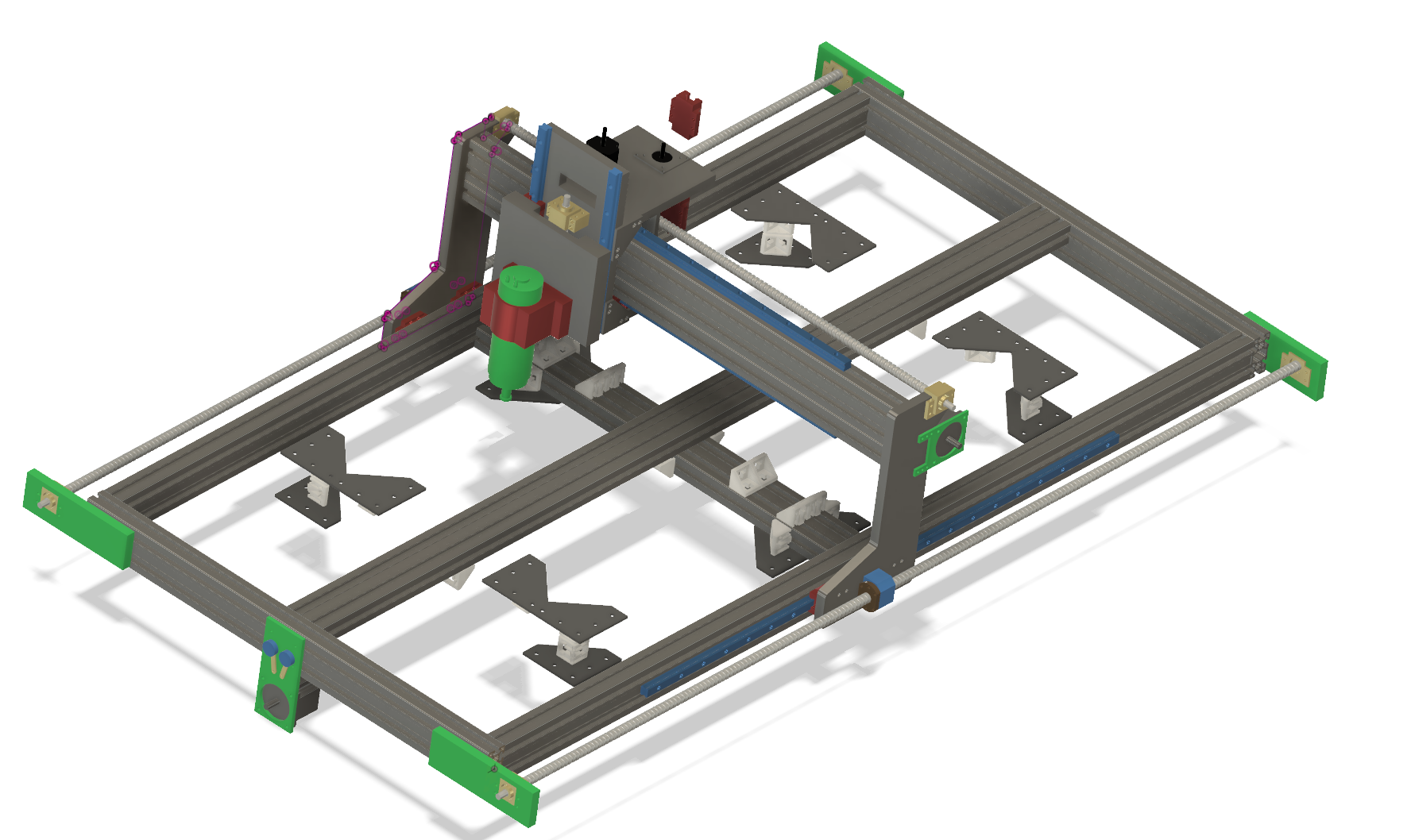

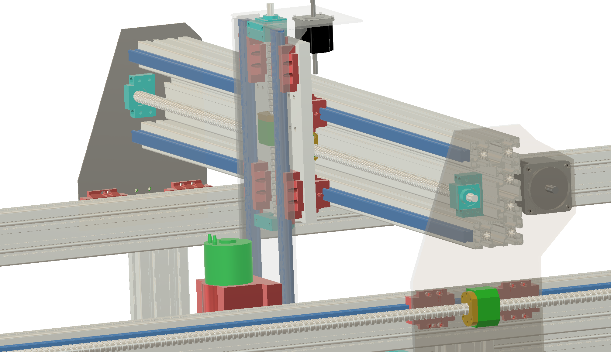

The Gantry itself got a revision as well!
Attachment 26048 New: Attachment 26049
The obvious thing is probably the size and shape change. I went from an L-Assembly to a C-Assembly. This is so that I could move the rails up front, which should not only give me more rigidity overall, but also allowed the massive simplification in assembly for the Z-Axis and Y-Axis Sled. This is one change I really took a liking to.
Something that was not quite obvious from the last post, but was already in it, is that one of the side plates fixing the gantry beam to the X-Axis is much thinner than the other one, in this case the left one is thinner (3mm of steel) than the right one(10mm of steel). This is to give the machine a way to have a bit of play, should something not be fully aligned, and off by a tiny bit. Another measure to the same effect has been brought up by my colleagues multiple times now: To only put linear rails and bearing blocks on one side, and have the other only constrained against translation/force, not torque, and we finally came up with a workable example, I want to discuss here:
Attachment 26050Attachment 26050
Let me explain. The plan would be to put the second linear rail on the lower extrusion on the right (looking from the front of the machine), and have both of them on the same side. Then, instead of a rail, have a supported smooth steel rod, and a cylindrical type round linear bearing on the left side, to replace the rail. That way, the linear bearing still constrains the movement on the translational axes and takes on the forces, but it would permit torque, which would fix the problem with it being statically overdefined. What do you guys think of that? None of the Logs and posts I have read here, so far, have reported any real problems with any of this, but one of my colleagues who has had contact with similarly built machines, with a different purpose (cannot exactly remember) is bringing it up as the thing they and their competitors did, to avoid problems in the same vein. And looking at the budget, one rail with linear bearings should not be the point that bankrupts me here :D
Another question I am having is regarding the long ballscrews on the X-Axis and the motor calc sheet. As discussed way earlier in this thread, I want to stay with a single stepper for the X axis, even though I have two ballscrews, linking them with timing belt. Now my question is, in the Calc sheet, don't I need to input a "times two" into the calc of the torque needed to spin the ballscrews, since the stepper needs to drive both of them at the same time? Since I want to go to 2010 or even 2510 ballscrews, that is one hefty variable to think about. From my initial messing around, I can either go less fast with a 2010 ballscrew (Around 6.3m/s rapids) with a weaker stepper, or find a much stronger one to drive the 2510 ballscrew at the full 7.5m/s rapids. Of course, cutting is another thing entirely, and I am still not quite sure what speeds to aim for here, but for reference, I have managed to get around 2.5m/s with 50N of cutting force, in my testing. Another way would be to stay with 1610 ballscrews and scale the X down from 2m to 1.7m, but that is something that I only want to be doing as a last ditch effort, so to speak.
And another on the ballscrews: Would I just mount normal timing belt pulleys to them, to connect them to the motors, or would I need special machining or parts here?

A few comments I would have from your last set of design drawings are:
- whilst 4 rails looks like a good idea, you will have a devil of a time aligning them I expect. Maybe 2 rails of a larger size might be better?
- Also consider the CS-Labs kit for the controller - many on here use them, including the venerable JazzCNC (which is always a good sign imho)
- Proximity switches if they are the type in a threaded housing, will give a nice amount of adjustment for the trigger point - you can do the same with micro-switches, but they then need a plate with slots to mount them to to achieve that
Keep going and I expect interest will pick up once you start building :thumsup:

I'm still aware I haven't gone through your calcs yet... Finding time is hard! Sounds like with the design changes though I may wait a little longer :)
I second Washout's comments about the CS labs stuff, looks brilliant. The thing that put me off was that the base model is only 4-axis, and it doesn't handle slave axis homing native-ly (although there are decent workarounds posted on here). Anything more than the base model is horrendously expensive, and I wanted future expand-ability to add a 4th axis which is gone if you use the 4th for a slave - but you avoid both of those issues by having a connecting belt and single motor.
Also, on the four rails idea, I think you'll definitely end up spending a few days becoming best mates with your dial gauge - but it could pay off in the end?
First impressions on the redesign; I think your CAD is coming along nicely, really shows. I do have a few concerns though:
- I question the Z axis travel length and why the plate is so large - Don't forget you'll have a bit attached to the end of your spindle, and its going to have to be quite a long bit to make use of your Z travel. I've got 18cm, and honestly, its probably far too much, most of the time you're really only needing to cut say 18mm plywood! The distance between the bed and the gantry looks huge - All that Z extension reduces the rigidity of the machine. Have a think about what you really need - can it be acomplished in other ways, such as an adjustable height bed or overhang section which keeps everything stiff for the majority of the time, but when you need to use the router on something large you can?
- How are you going to assemble the Z axis? Look through the design, building it up step by step, and imaging when you will or won't have access to each screw and what that implies. I've got my ballscrew and motor on the fixed bit because I can easily get to the four screws holding the ballnut onto the Z plate, undo them, then slide off the rails. Your design looks a little harder to physically assemble.
- The C beam - how are you going to attach those profiles to each other? Any weakness here will be quite problematic and you've got two joints which need to be constrained.
- 10mm of steel looks quite beefy for a side plate, but 3mm seems quite weak in my head. I realise its intentional, I'm just not convinced!
AndyUK
It seems I have messed up my explanation here. I do not plan on using four rails, but instead three. Two linear HIWIN-style rails on one side, mounted atop each other. The other side only has one rail, and a different type, namely the cylindrical Igus-Style rails that you also often find in 3D printers, like the Prusa MK3. That will still take some work aligning, I get that, but it should technically work to help let the machine compensate. I know, technically is a nice word, but practically often takes precedent :D I have added another picture, with the HIWIN rails in their place, to hopefully make that more clear.
Attachment 26060

[*] 10mm of steel looks quite beefy for a side plate, but 3mm seems quite weak in my head. I realise its intentional, I'm just not convinced!
This one's along the same vein, and it honestly also seems off in my head, but the math should check out there. Ultimately, the sideplates don't cost much to make, especially not the smaller one on the left, so if it turns out to be a problem, I can change it around without much of a problem.
[LIST][*] I question the Z axis travel length and why the plate is so large - Don't forget you'll have a bit attached to the end of your spindle, and its going to have to be quite a long bit to make use of your Z travel. I've got 18cm, and honestly, its probably far too much, most of the time you're really only needing to cut say 18mm plywood! The distance between the bed and the gantry looks huge - All that Z extension reduces the rigidity of the machine. Have a think about what you really need - can it be acomplished in other ways, such as an adjustable height bed or overhang section which keeps everything stiff for the majority of the time, but when you need to use the router on something large you can?
Something like that came up when talking to my colleagues as well, today. We came up with inserting angles to hold up the sides, which could be removed if needed, but when there, would make it a bit stiffer. I really quickly added one in the picture above, highlighted in pink. Imagine four of those in the corners.
Could you maybe elaborate on how an adjustable Height bed and that "overhang" would work? I have a hard time imagining those two.

[*] How are you going to assemble the Z axis? Look through the design, building it up step by step, and imaging when you will or won't have access to each screw and what that implies. I've got my ballscrew and motor on the fixed bit because I can easily get to the four screws holding the ballnut onto the Z plate, undo them, then slide off the rails. Your design looks a little harder to physically assemble.
Good shout! On the first look, I should be able to do a similar thing, but with removing the screws of the Z-Ballscrew Bearing Blocks instead, but I will definitely check that again.
AndyUK
[*] The C beam - how are you going to attach those profiles to each other? Any weakness here will be quite problematic and you've got two joints which need to be constrained.
I have enough space between the screw and the profiles, to be able to insert some angles to bolt them together (that is going to be some fun fiddling with angled hex drivers, however :D) and I can also bolt them together on the back side as well. With the sled in front, forming a closed frame and additional bolts in the side-plates, that should be enough then, right?
