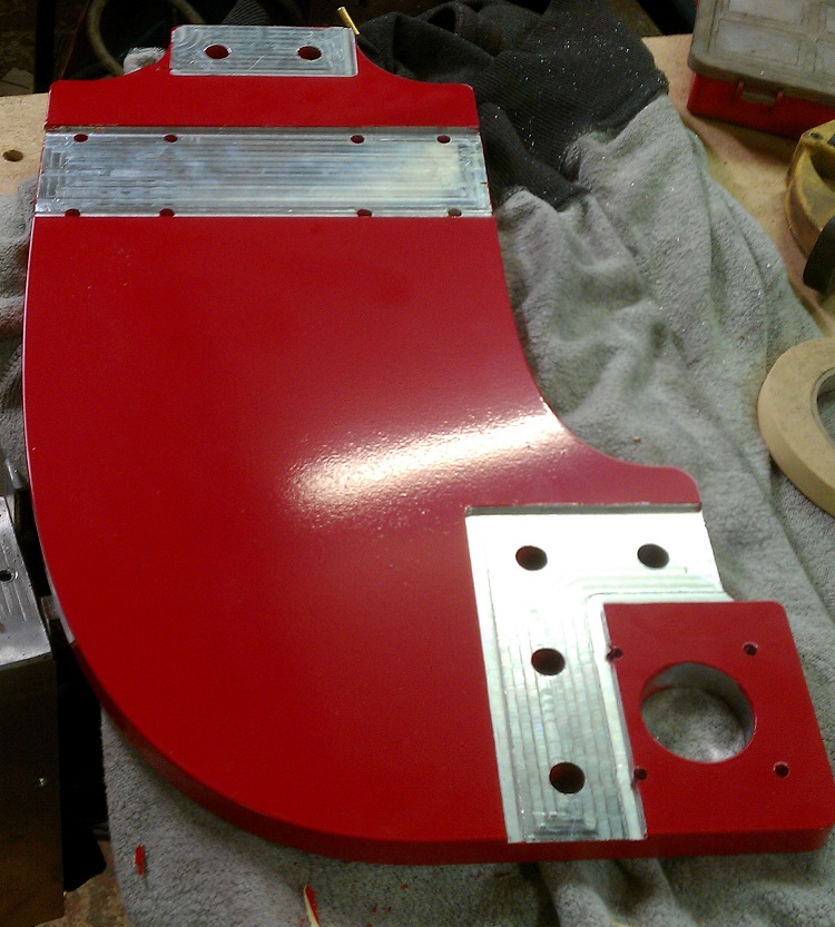

The best profile to use is 45 x 90 because it makes things easier with mounting ball-screws. However, 40 x 80 will work on smaller machine but you'll just need to make plates to mount BK/BF bearings on for ball-screws.
Attachment 27435
 That appears to be one short cut I won't be able to use as the supplier to have tenatively chosen does not supply 45 sized extrusion., only 40 and even that has to come from the other side of the country.....
Some googling  has found 1 or 2 suppliers that use 45 but the quality is unknown.
I'll either have made adapter plates for each bearing block or mount the bearing in another way.

		Whats the preffered method of attaching Bosch Rexroth Extrusions to Gandtry plates?
With Item24, its easy....4 or 8 bolts threaded into the end of the Extrusion...
I see many connection methods in catalogue, but nothing seems to address this issue.
A single bolt in the centre doesn't seem to be it.....
Steve
		Re: L Style Gantry on a 6040 sized machine?
Sterob
 The 45x90 and the larger 90x90 all use multiple holes. I wouldn't use any thing less than 45 x 90 and certainly not 45 x 45
