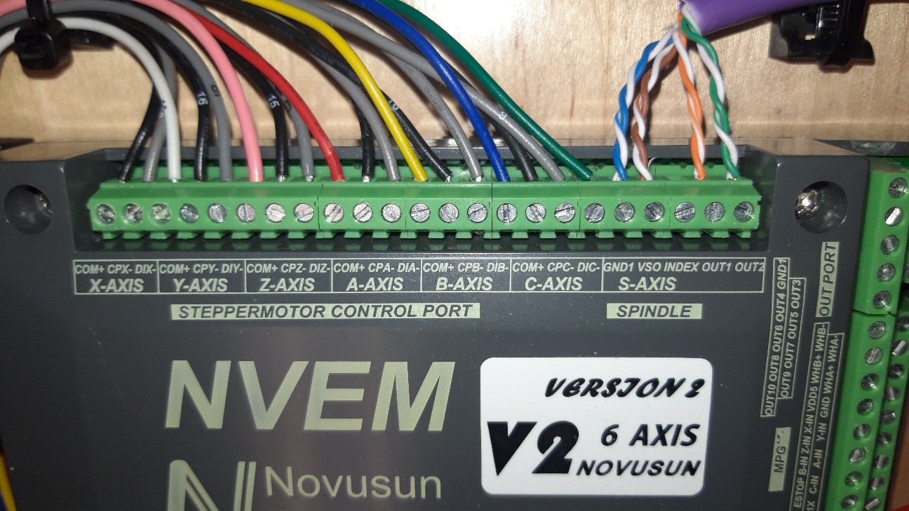

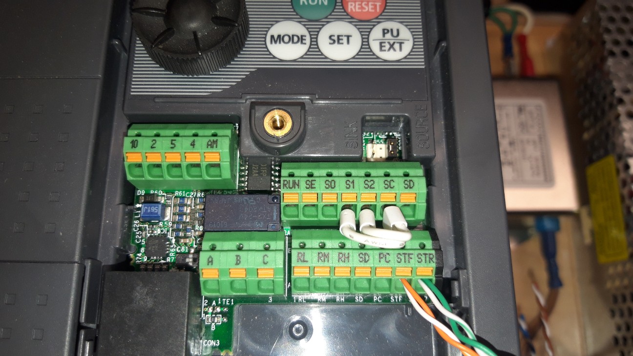

Nvem S-Axis out1 Orange and White twisted pr goes to STF on the VFD..... through relay
Nvem S-Axis out2 Green and White twisted pr goes to STR on the VFD.......through relay
S-axis /Gnd1 goes to terminal 5 on Vfd which is Analog Gdn
S-axis/VSO goes to terminal 2 on VFD which is 0-10V.

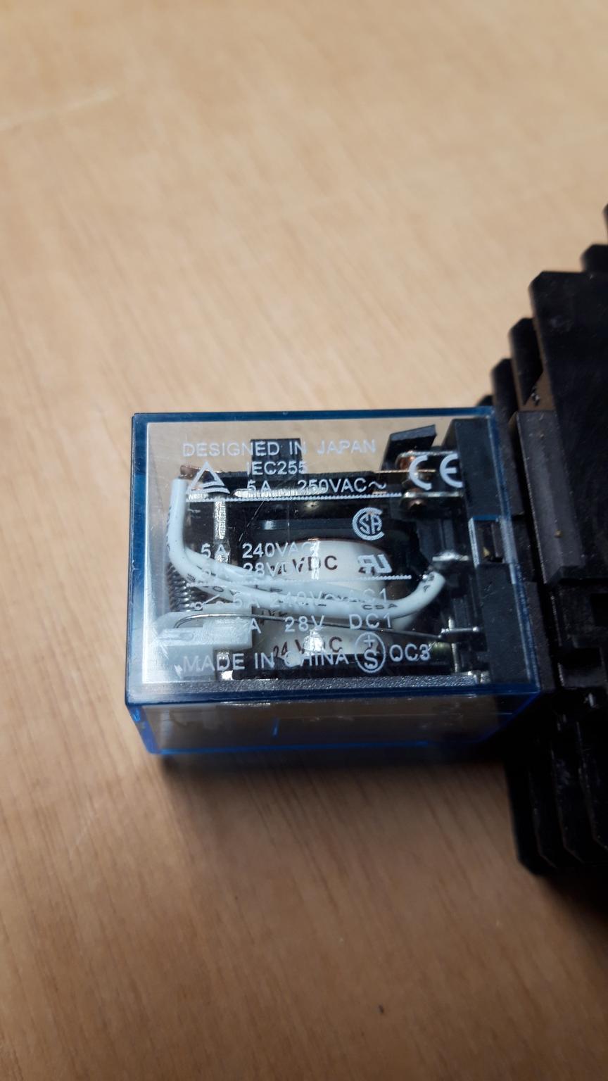

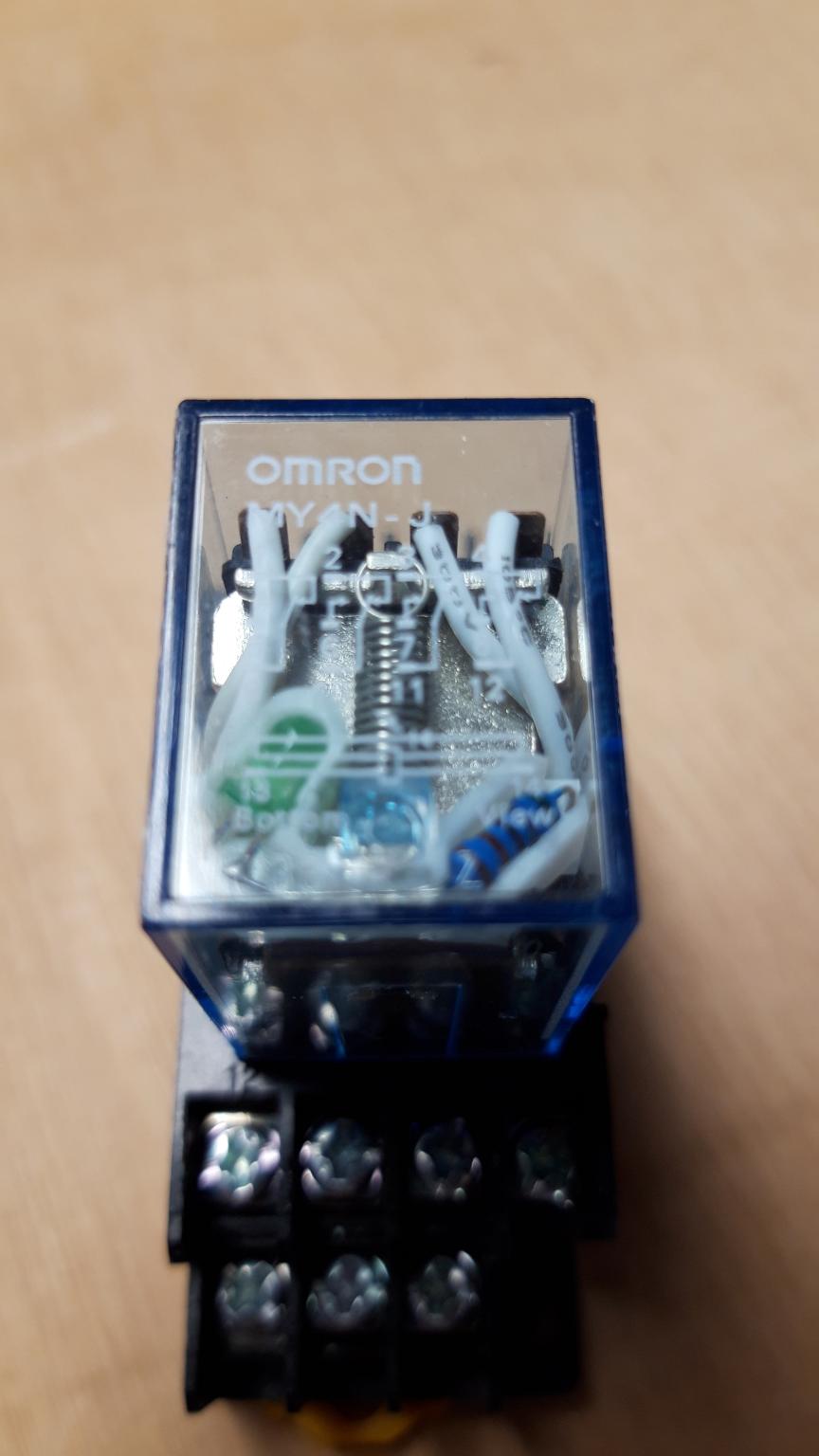

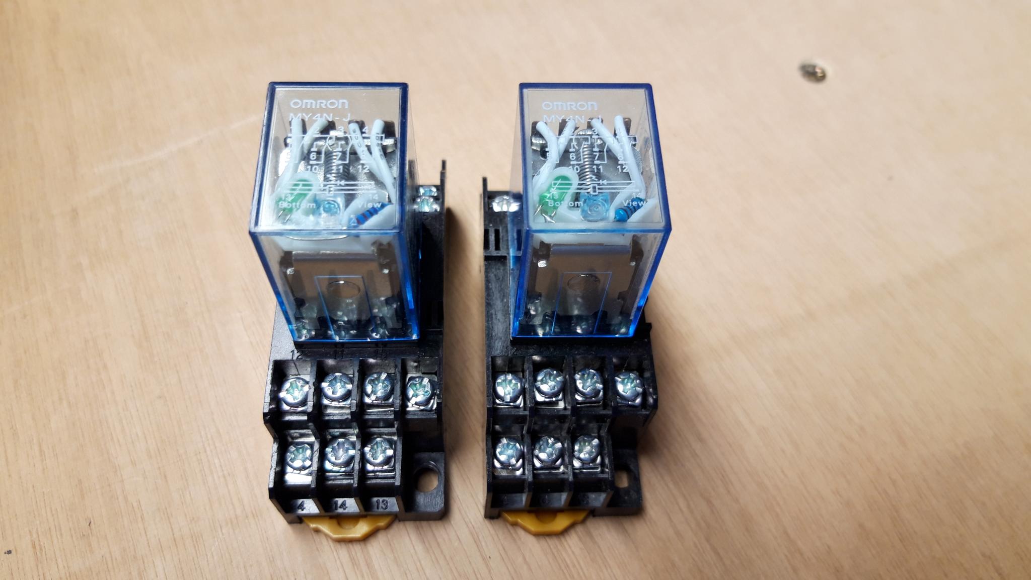

So do i keep the above connections but with the addition of a relay,

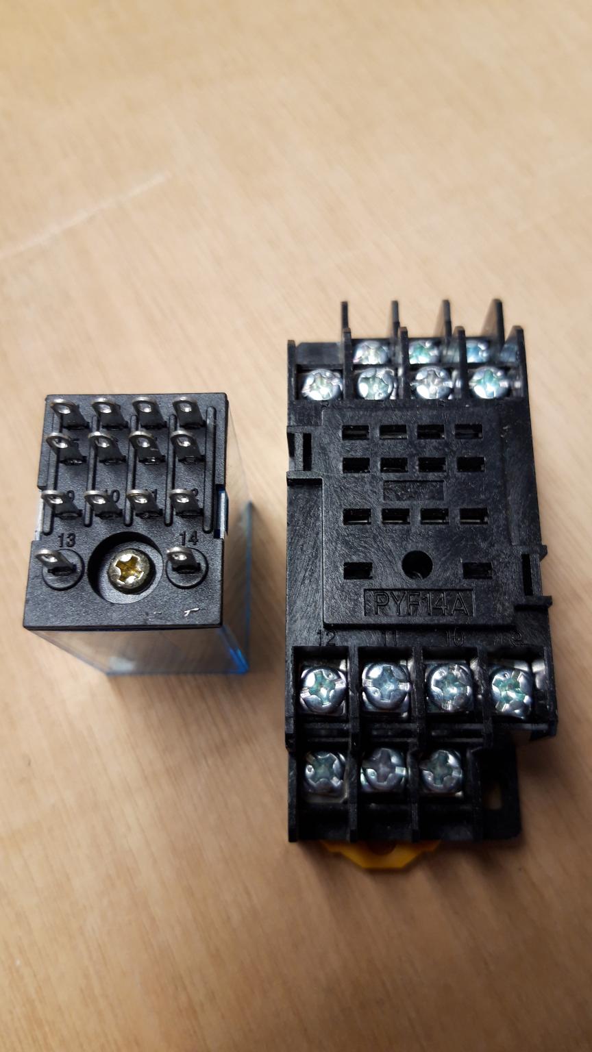

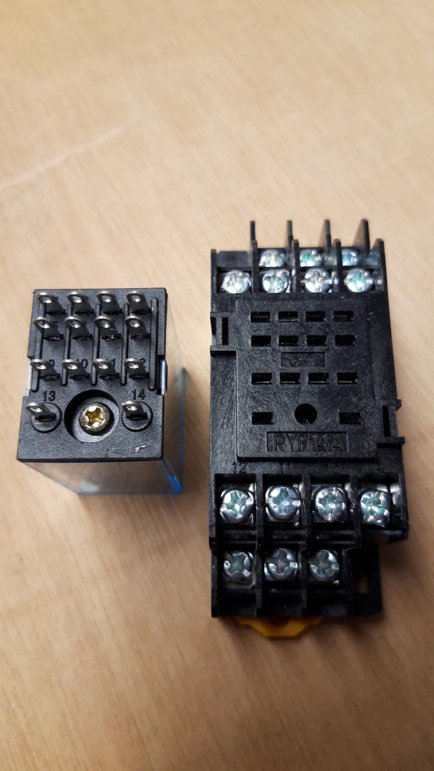

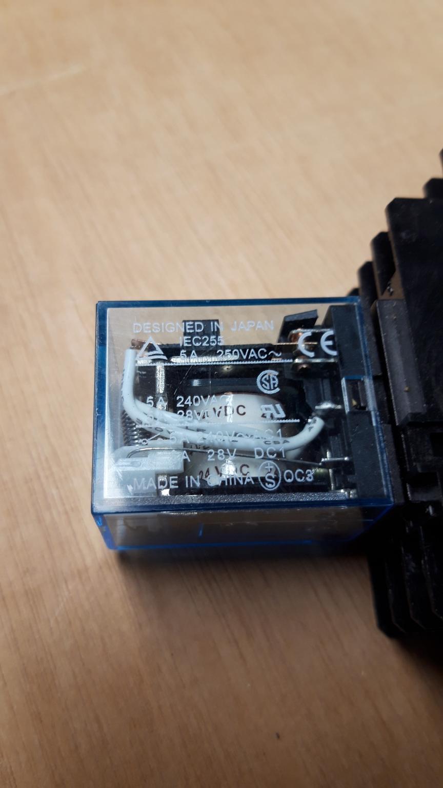

i have these relays that came with a box of parts i ordered.
Attachment 27763
Attachment 27764
Attachment 27766
Attachment 27765

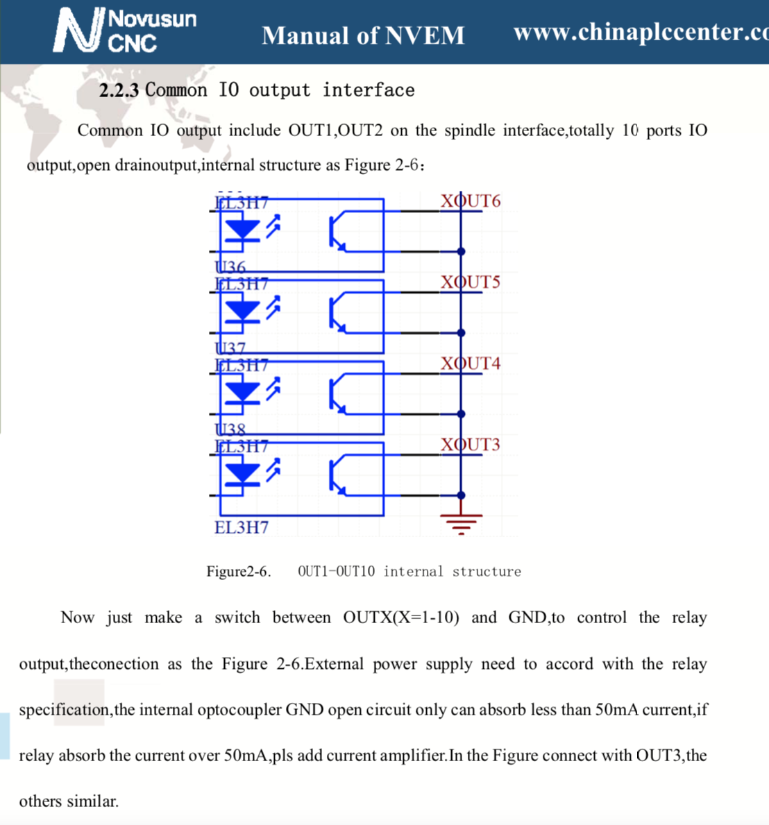

From the manual...
Attachment 27767
The outputs are opto-coupled, max 50mA. But that "max" is the maximum capability of the opto's transistor, not a guarantee of switching current (this might, probably will, be less).
I've googled the coil resistance of the MY4N-J and not getting anything sensible, similar OMRON power relays, 24V are around 650R so we can guess a switching current for reliable operation around 50mA. Whether you get that out of the NVEM will need you to experiment but I wouldn't bet the house on it working. If not, you'll need a current amplifier (a simple NPN transistor would do).
And you'd need to protect against the back-EMF from the relay, regardless.
If that makes sense then I won't bother with a diagram, but if a diag would help then let me know.
Mike

I use these Omron MY4N-J and they typically pull about 36ma. Dave if you have a meter that can read current then test on the bench to be safe.

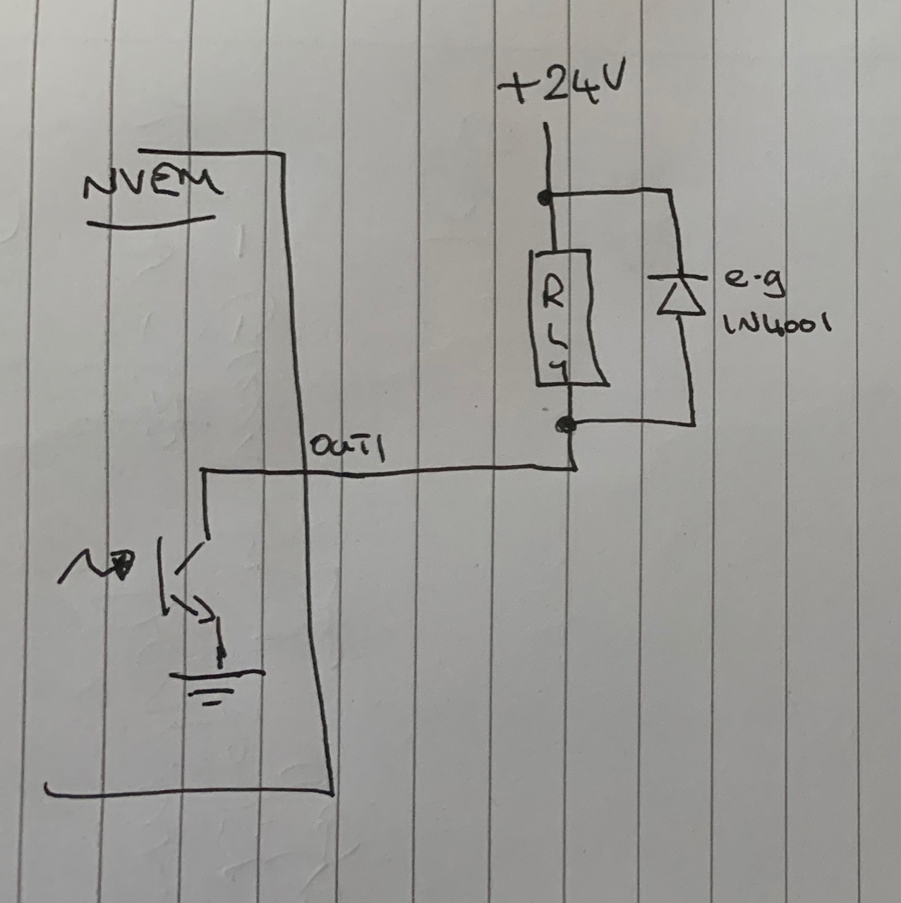

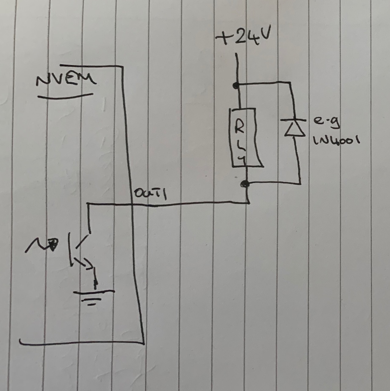

Quick and dirty schematic:-
Attachment 27769
First option if the NVEM will source enough current to switch the relay. There's a reason why it might not, and I'll put this on the bottom of this reply, but try that first. The diode is connected across the coil, it's purpose is to protect the NVEM from back emf. I'll let you google the reason for this rather than lying. It's important.

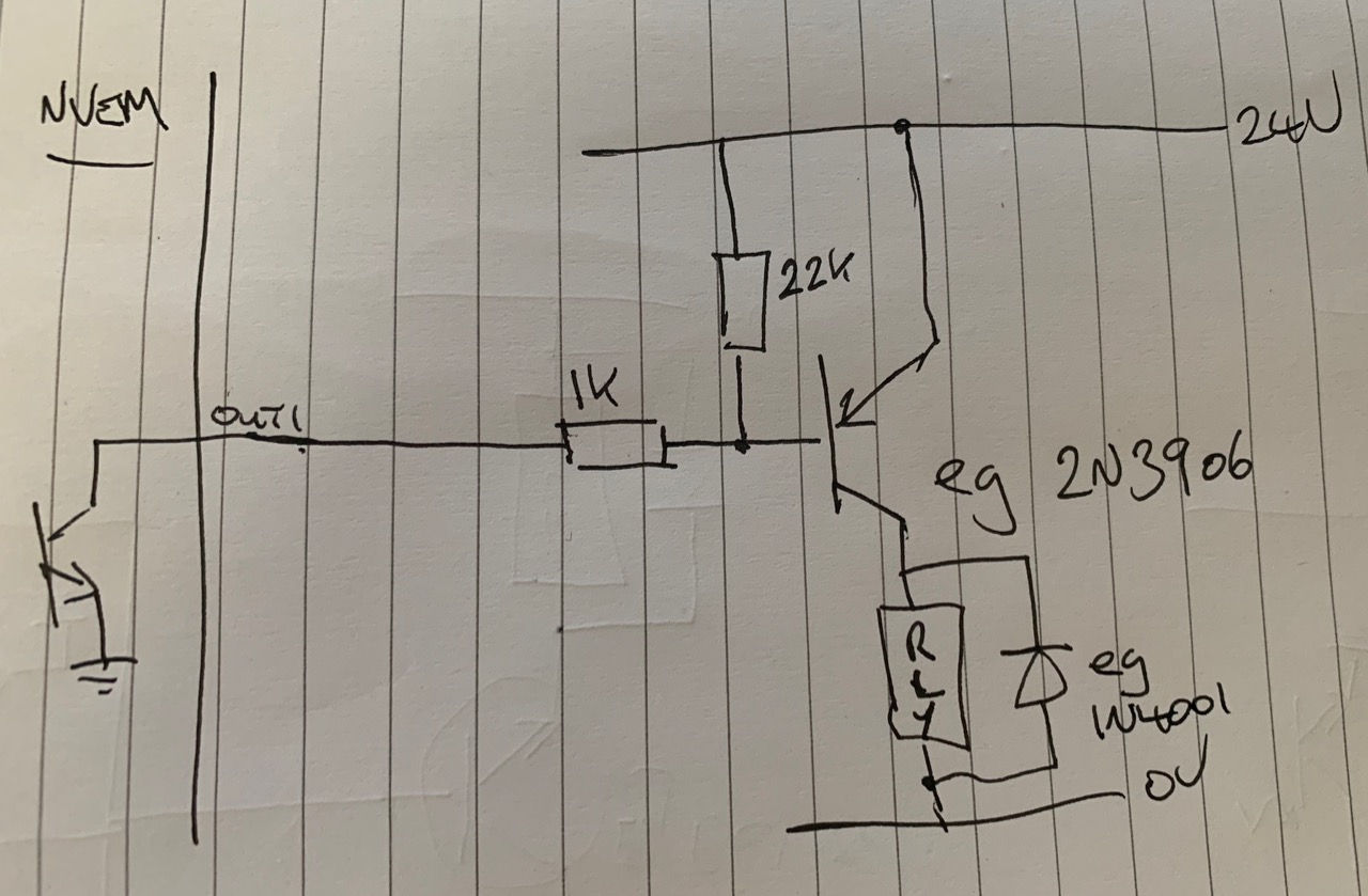

Attachment 27771
The second option introduces a transistor (any general purpose PNP would do with a VCEO rating of 30V, Ic of 50mA, and a hfe (gain) of at least 100. That describes pretty much any general purpose transistor. I'd guess at a 2N3706 but any similar would do. If the output from the NVEM is switched - it goes low - that will drag the base voltage on the transistor significantly below the emitter voltage (24V) and the transistor will conduct C-E, and the relay will actuate. The current through the NVEM will be in the order of 1mA.
The reason why I'm uncertain if the NVEM will source the current for the relay directly is centred around Lies, Damned-Lies, and Data-Sheets.
The EL3H7 opto-isolators internal to the NVEM are rated at 50mA Ic (collector current). That is, beyond 50mA you risk damaging the transistor. But, the actual Ic is a product of the CTR (Current Transfer Ratio) of the device and the forward current through the LED internal to the device. Typically designed around 10mA, could be 20mA, but the CTR is specified as between 40% and 320%. So, guessing a 20mA current flow through the opto-isolator LED, the actual transistor current will be between 40% (4mA) and 320% (64mA), depending on the manufacturing process. So... 4mA won't switch the relay, whereas 64mA would (though the relay coil resistance would limit this to 36mA).
That's why you'd be best doing a bench-test on the relays first.

Sorry, I meant that as means of example of interfacing a digital output from the NVEM to the VFD. That's the control for... STF. Repeat for Out2 and the STR input the VFD (if you think you'll use reverse - you can omit this otherwise). Then the analogue 0-10V output (and ground) is as Jazz said.

hi
sorry i have to hold my hands up as i am just not getting it,
heres my controller
Attachment 27773
heres my VFD
Attachment 27774
I need it in a bit more basic terms so if a diagram with what goes where on the nvem. vfd and relay would be very much appreciated
