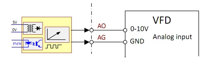

 Firstly - thank you for taking time to reply to my mind-numbingly simple posts.
So 0v to pin 4 (what does wrt denote please?).  Do I connect +10v to pin 1 or pin 3?
Pic below is MB3 0-10v analogue
Attachment 28864
thanks again
		Re: Lynx SM 16 wiring anomoly - help
		Connect A0 to pin 3, AG to pin 4.  Leave pin unconnected.

 Actually that is what I thought, I was just double checking. I really didn't want to blow it up for the sake of asking again.
News: Tried it - started first time, brilliant.
Thank you - your time and effort is most appreciated.
