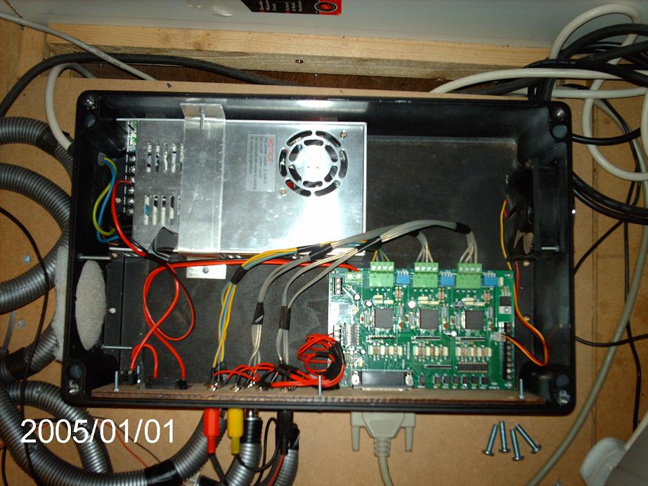

		Attachment 2212Hi Lee,
I did some more testing last night, and got the PC spec.
Processor AMD Athlon XP 2600
RAM 1.5Gb
Graphics card FX5200 128MB ram (i.e. not built-in)
MB Asus A7N8X Deluxe Gold
Windows XP SP3
A few years old, but plenty good enough!
Checked the output of the Parallel port directly and still got glitches on the scope.
Then disabled the PCI parallel port and got clean pulses from the main port! Quickly hooked up the steppers and got clean runs - for about 20 seconds, then the glitches came back. The allegro chips all got quite warm on the drivers, even though the current is limited to 1A. System3 is an all in one board, and for these tests it is out in the open. Shouldn't be overheating surely? Thinking about heatsinks and direct fans on chips to see if this helps (case has general exit fan).
I might need to remove AVG to see if that helps, but the chip heating needs to be checked out a bit more first.
Barry

I was beginning to think that this was a heat issue, but went back in the garage after work today and the reading direct from the parallel port was full of glitches again. I'm getting very confused by what seems to be perhaps multiple contributing factors.
Started disabling every other port and piece of hardware I could, and disabling AVG at startup, removed printer driver, and still got glitches on the port.
Only encouraging thing from this is that I've managed to ''hold" scope readings on the screen to work out the pulse spacing. Sorry I'm struggling to get these as a good photo (there is no output on the scope either), but I think the following will give you the numbers you need. These are the Mach3 settings, and theoretical pulse spacing:

Re-read your post, and thought I'd add a bit about the system 3 board and the heat.  There are transistors with metal plates which I think are the regulators (see photo in post above).  These do get quite hot to the touch within perhaps a minute or two, hotter than the allegro chips.  I had considered heat sinks on these, but with the glitches on the parallel port that area of investigation will have to wait.  Good suggestions about the cooling spray etc, thanks.
