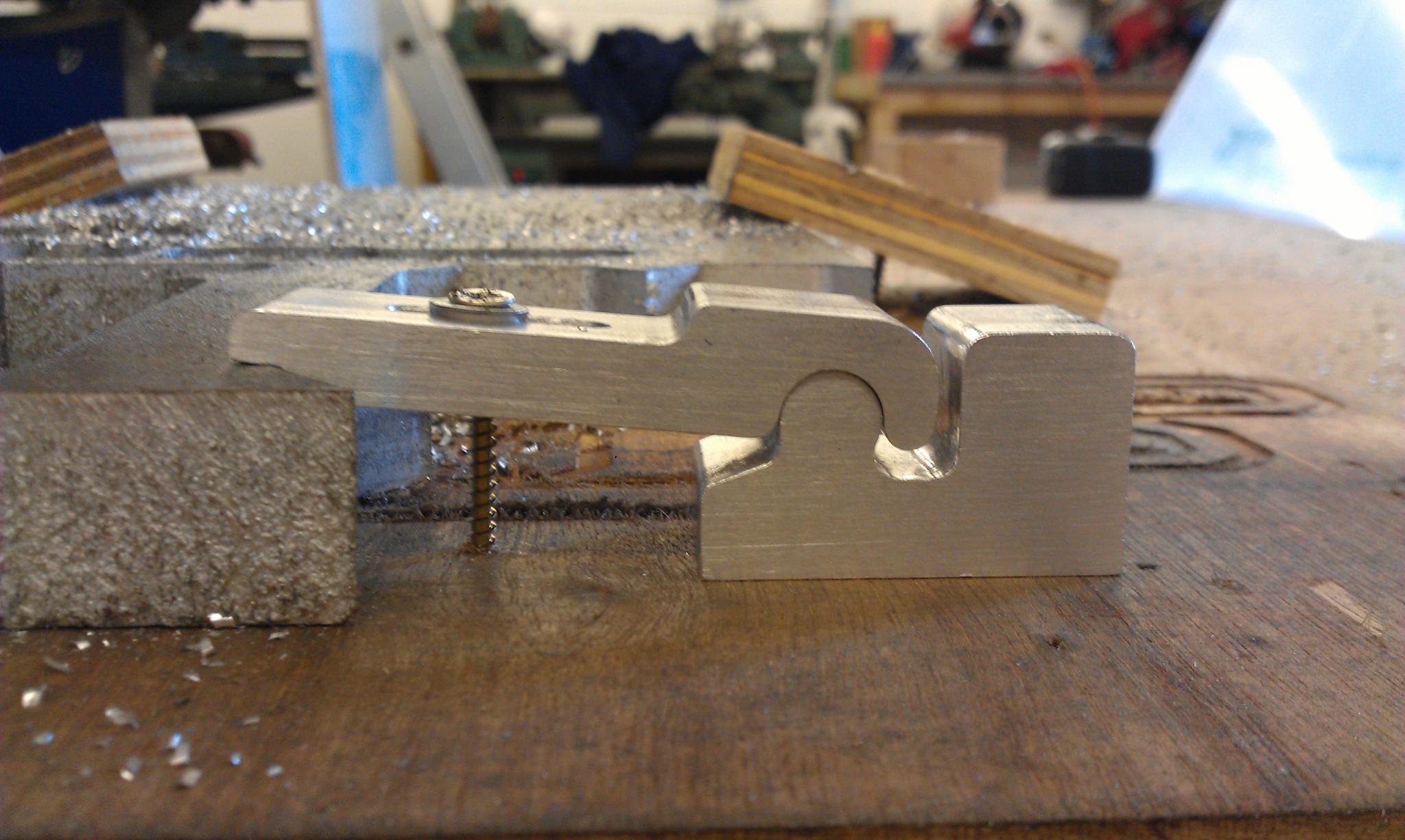

I've just posted this if anyone would like to make a set of clamps:
Link: Step clamp design - Hold down thin or irregular shaped objects while milling!

the beauty about a long clamp is that you don't need a lot of force to hold down the board, which means less warp upwards in the middle of the board.
it's very simply, but if you mill pcbs often, it's definitely the way to go
Tenson,
hopefully this pic will give you a better idea of how it works. This is 25mm thick plate its clamping. At the moment I have a wooden bed so Im using a wood screw but once my ali bed is in place I can use a 6mm bolt.

Hence I just use double sided tape for PCBs. No distortion as well, no force really...
