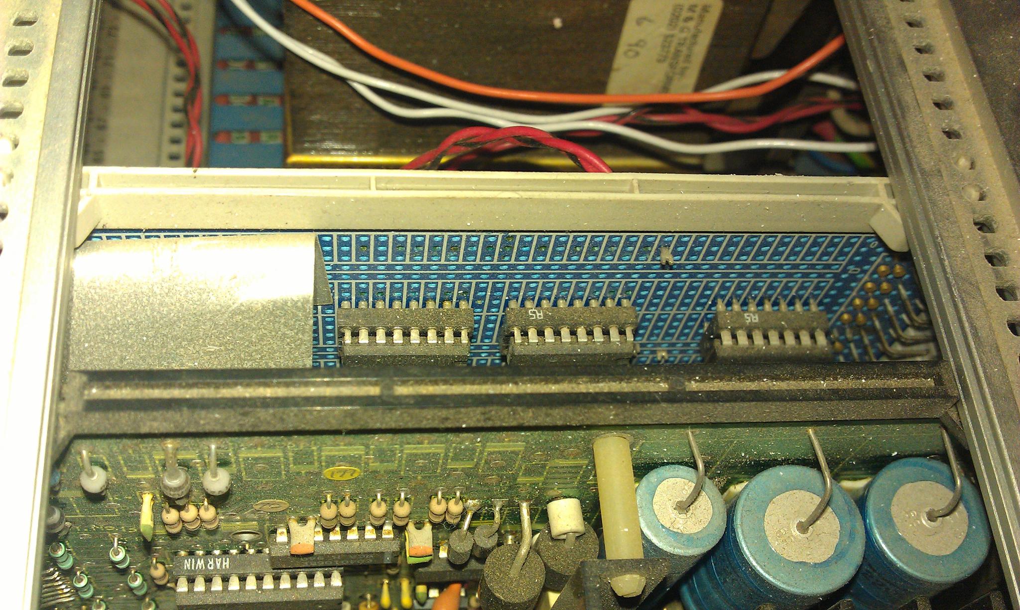

Hi Guys,
Please find attached the images and let me know if you need anymore. I have tried to take as many pics as i can but just incase i've missed anything out i will retake images.
Thanx again guys.
What a rats nest.
Plus the SD3 drives are only full or half step.
seeing as you got a free machine it would pay to dump all this crap and get a new breakout board, power supply and 3 drivers and you wll be set up for a long while,
what does it mean by the sd3 drivers being half step or full step??? I would like to redo the control box but i just want to get it working at the mo.
Would it need a rewire if so how can i learn to do this?? are there any control box for dummies thing i can read?? Im a complete beginner!
That is a bit of a rats nest!

If you were handy with a multimeter, you should be able to figure out what's not working, but by the looks of it there's various bits in that control box that modern drives and break out boards don't need.
You really need to start by doing some wiring diagrams. Start at the power in, and trace the wires through the various components to the drives. Then do the same with the wires from the parallel port.
You may find buying 3 new drives, a breakout board, and starting from fresh is easier and quicker.
