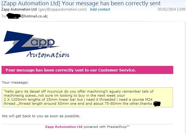

i thought chia did this rail i was going to ask him if he,d thread it, still waiting on a reply from zapps,cheers

hello gary
this is the confirmation i got after mailing you.your normally quite prompt with the replys so i just assumed you wasnt interested,no worries

Not sure how we missed this one.
The reason why we dont want to do this is because the M24 thread will still be within the hardness (Partially) so annealing will need to be done.
This may also cause the shaft to bend slightly?

i dont have a lathe to do this so what im looking at to get 2 X 1200mm lengths of 25mm linear bar threaded i need a course M24 thread ,thread,thread length around 50mm one end and about 75-80mm the other.
i havent bought the rail yet case theres alternatives its for a shed injection moulder i just need to complete the top half assembley and planned on useing flanged bearings,it will be very simular to the one in the link but i cant make out how they have fixed the ends of the rail to the plate top and bottom so my plan is to screw the rail into the large bed plate at the bottom and use nuts top and bottom of the top plate.
