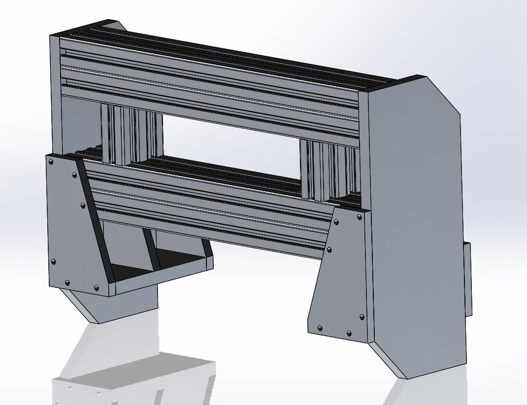

There we go, third iteration. I've switched to square rails, 20mm. The frame is now a mix of 60x60mm and 80x80mm alu profiles. The alu plates are 20mm, except for the backpiece spanning the gantry, that one is 10mm.
The steppers should be more securely mounted, the gantry should be stiffer and hopefully I think it might be slightly easier to assemble.
What do you think? For some reason it just looks "wrong" to me, can't really put my finger on it.

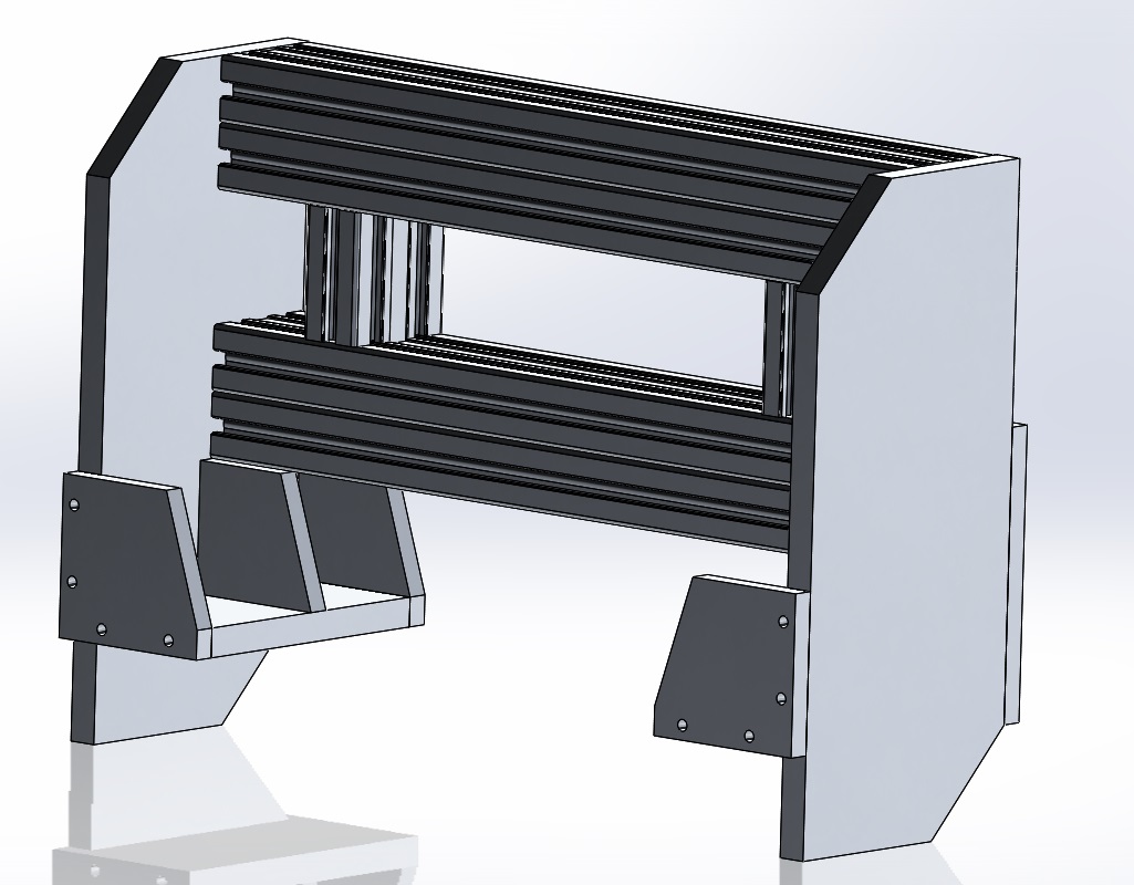

Re: Aluminum router build - Could use some input
This machine will be ok for medium duty aluminium cutting and will cut at those feeds and speeds but you will need some form of cooling with aluminium to get good results with finish. either Mist, flood or blown air.
One thing I would do is get rid of those openended profiles has the offer very little strength and they will actually make building harder.? How will you access the Bearing bolts.?
You will get the same or better strength from some simple 90deg triangle shaped plates bolted thru the gantry sides and into the bearing plates. Something like in the pics but made better looking this was just quick throw together.
This will also allow easy access to the bearing bolts and make simpler to build and adjust etc. You could drop that plate at rear or just use some Thin 2mm plate as a blank if you want to close gantry but I wouldn't and would leave open so chips fly thru.!
Attachment 12719Attachment 12720
Also I wouldn't connect direct to the screws with steppers but use timing belts and pulleys. This will help with resonance and give other advantages by allowing ratio to be applied if needed. It's been discussed many times on forum so do a search if you need to know more.
