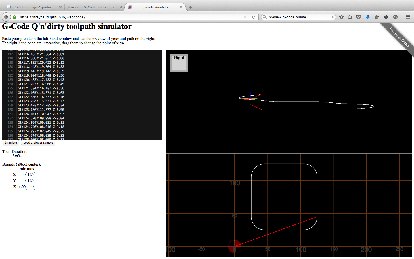

Hi Rufe0,
Very cool - I'm always blown away by the skills of programmers. Just amazing. I have a couple of observations, although I'm pretty certain you'll be aware of 'em. When using the script on a rounded rectangle, there's a more pronounced drop on the 'rounded' segments due to the extra lines of Cut 2D code that are forcing extra incremental drops in the Z-axis:
Attachment 16558

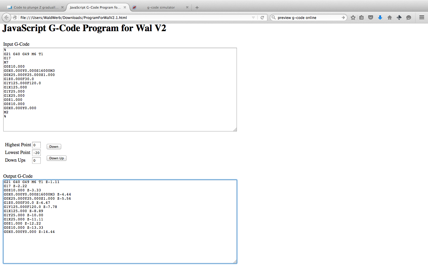

The next pic shows that despite asking for a drop of 20 on this square, the Z only drops to 14.44, other shapes have dropped the specified amount, so perhaps this is an incompatibility between your script and the way Cut 2D formats it's code when dealing with different shapes..?
Attachment 16559
