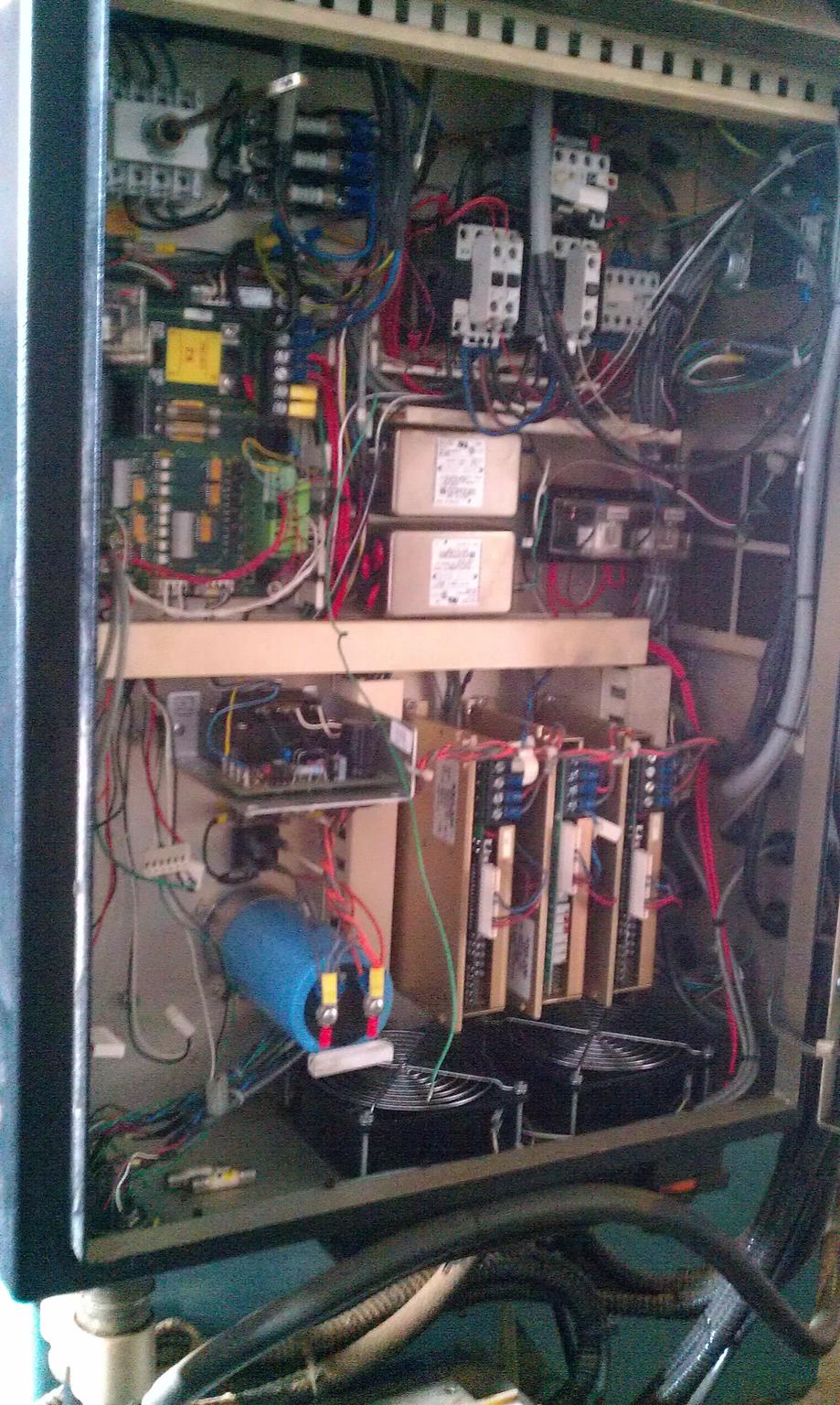

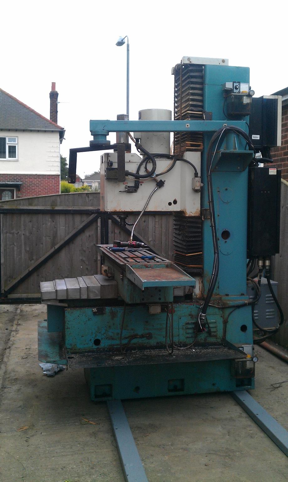

Here's a prime Example of what £600 buys you in Old money.!! . . . . Purpose built CNC not converted Mill with 1000x500x450 travel. DC Servos, 7.5HP 40 taper spindle with power drawbar, Ground ballscrews and linear ways.
All this machine needed to get working was the controller replacing and 3 phase power. It uses Brushed DC servos which I will be replacing with modern Servos and the Spindle will be run from a Converter.
But the point is that if you had 3 phase power another £600 would have had this machine fully working and running like it never did before on it's old controller.
There are old machines like this coming up all the time at very low money and if you throw 2-3K at them you will have a very very good strong accurate machine will all modern components.
