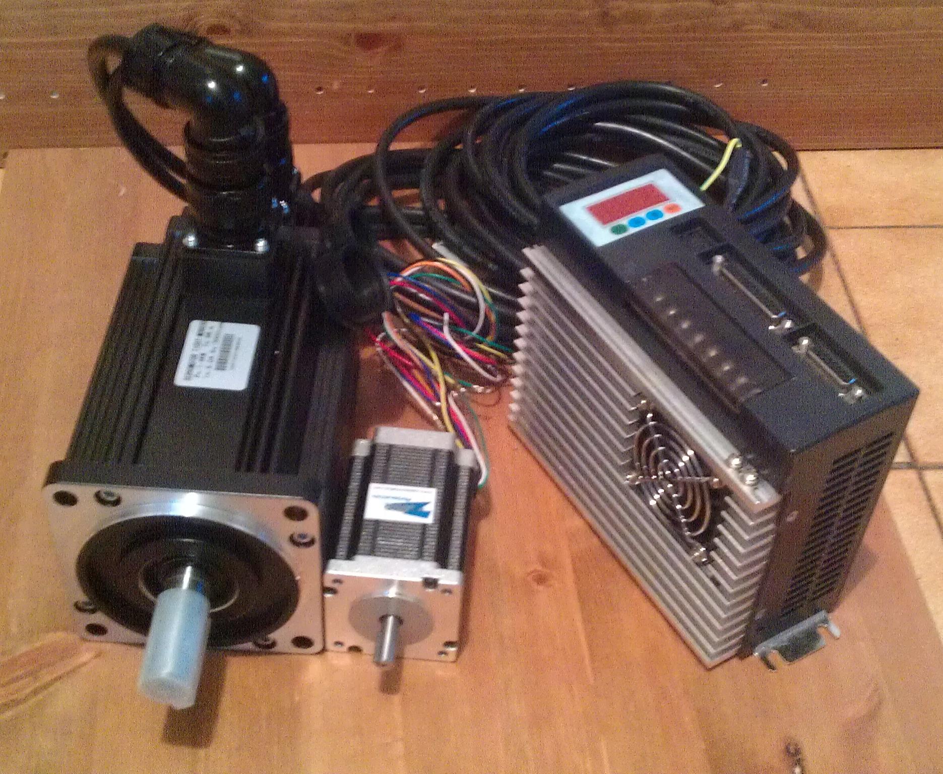

Mine arrived yesterday has well Matt and these 1.8Kw puppy's do make nema23 steppers look small.!
Set them up last night and seem nice enough. So far I'm happy with them but that could all change when they hit the road so to speak.!!

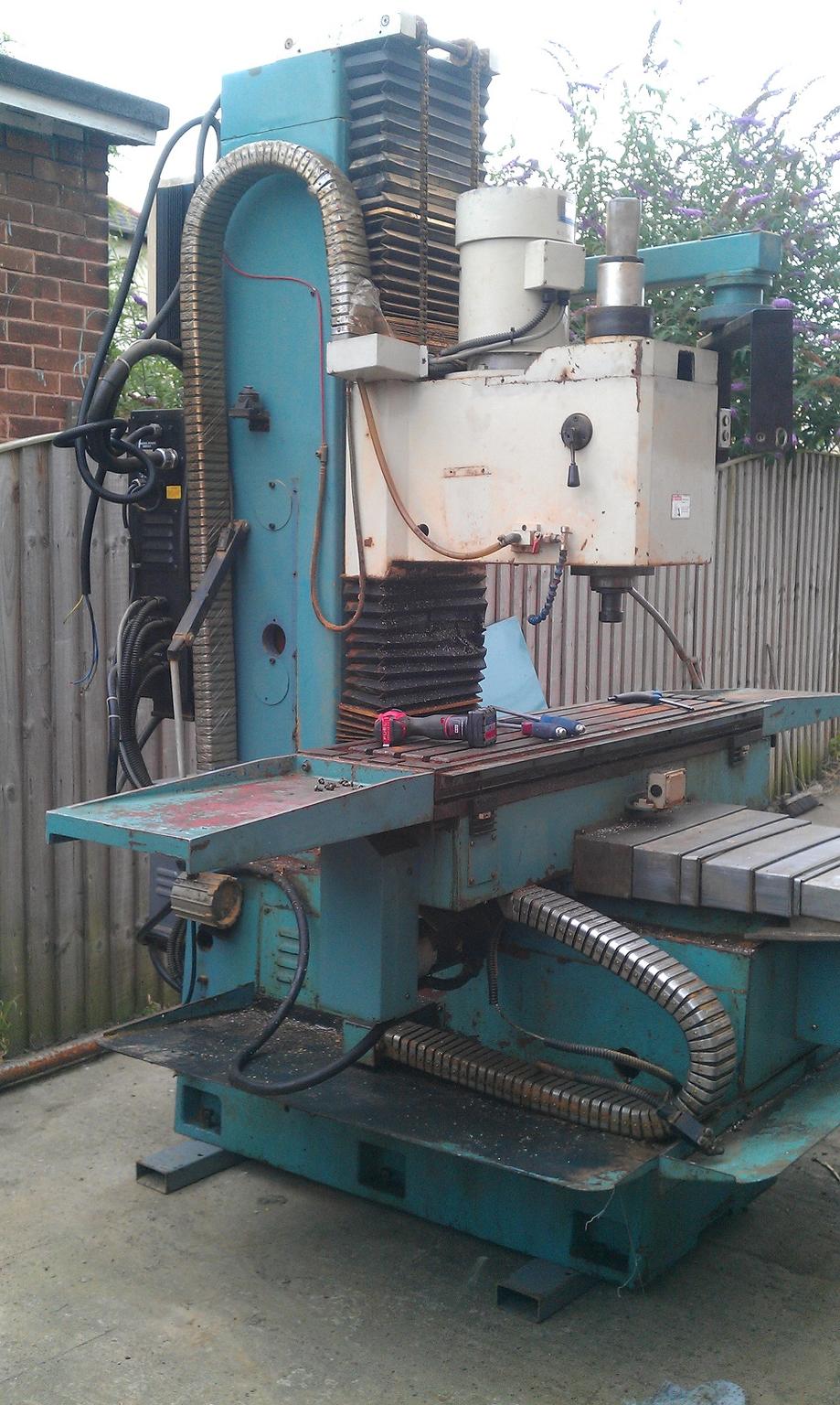

Fitting to this.! . . . Replacing Brushed DC servos.

Nice is it yours, looks like a big boy and a nice project to work on...

It's mine for now but could be somebody else's when it's finished and fully Converted. I may put a Build thread up actually.
