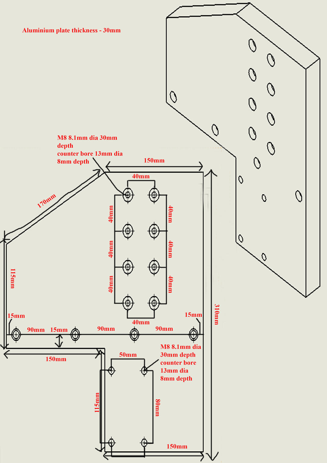

just to throw something in there would this make sense for you guys or does it look confusing :)
Attachment 17622
I think you have too many measurements some are duplicated also the bottom 4 holes are drawn differently ie not showing the countersunk bit. I don't see the line down the centre holes sizes. If all the holes are the same size you can say that. Unless the holes tapped just say the hole size ie not M8 8.1 as a M8 hole would be 6.8mm to be tapped.
If hole are through holes I would say that instead of 30mm.
I would reference all the measurements from one end and one side. Do you really need 30mm plate?
Do you have a dxf file for this. If not I can do one for you.
Just to add to what Clive says, I don't see any measurement for the actual position of the 4 and 8 grouped holes on the plate, try and pick two sides(Datums) to take the measurements from and maybe positional tolerances if its important to you. Also you don't need the length of the angled side, an angle would do.
Cheers, Charlie
ahh yeah sorry i forgot about the position of the holes, as for the bottom 4 the reason why they are different is because the counterbore are on the opposite side. i do not have a dxf file as im new when it comes to drawing so that was actually my first drawing to show you guys lol.
cheers
Ash
forgot to mention i want a close fit on the through holes so instead of 8.4mm i wanted 8.1mm thats what i meant to of said.
