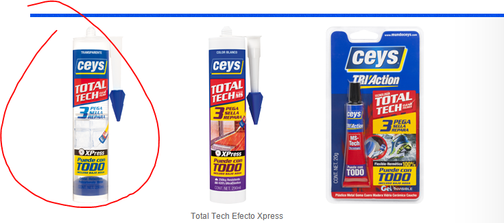

The material is PVC. I've tried some general purpose solvent free glue and it is poor. Or do you mean I should try silicone adhesive?
Its not exactly silicone, just looks like silicone. Do you know the glue that glues all to all and is weather resistant and flexible. They sell it here in Spain in every big shop. In a plastic bottle like silicone. Its for automotive use. I am just now going to the shop where they sell glues, so will post a picture later. Its called Ceys Total tech I used the one on the left , i think that the only difference is that its transparent
Attachment 17719
We don't have that in the UK. It looks like 'PinkGrip' but maybe it's differnt? http://www.everbuild.co.uk/pinkgrip/pinkgrip-1
I wonder what the technical name of this adhesive is?
No, what i am saying is maybe some kind of polyurethane or silicone, what you say is polyester type glue, similar to what they use to fit doors and windows at houses, very easy to spot, look at sheet and when you see that " Do not use on polystyrene/Styrofoam/expanded polyurethane "
While searching for other glue, i found this one, that seems it will definetely do the job:
PU18 Black Flexible Polyurethane Adhesive
