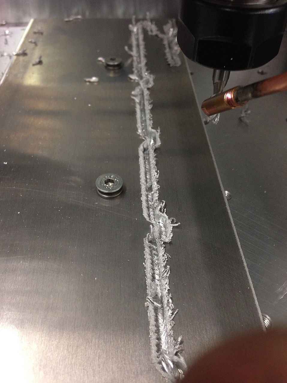

WD40 is the easiest, I am running a paraffin/oil mix which is basically WD but you need to watch the job closely, if the cutter dries out fully it will load up and snap in an instant, there is very little warning.
Here's one i buggered earlier ;)
Attachment 18116
The copper pipe in front of the cutter is my fogless air/coolant jet, it stopped working and that was the end of the cutter, surprisingly the cutter did not break this time - the machine had enough strength in it to carry on mashing through the metal even though the tool was completely loaded. I never managed to get the metal off the tool as its welded on.

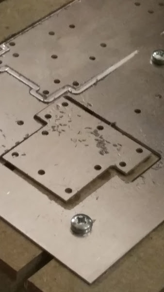

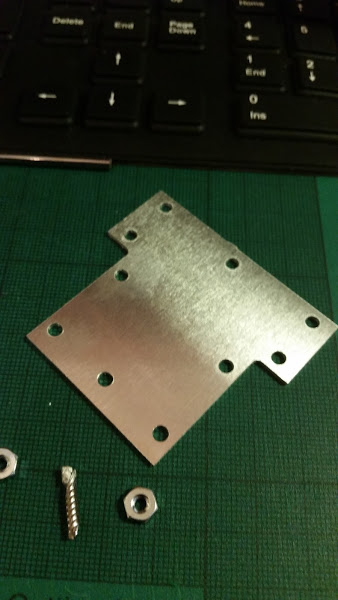

2 Attachment(s)
Re: Tips for cutting 1050 aluminium
I think I love you guys.
Wow what a difference. The cut was perfect!
I messed up and set the cutter a little too low and so there was no onion skin so the part jumped out and nicked a little in the middle of the long edge. And I need to come up with a solution for not destroying the MDF board with lubrication.. but apart from that.. there was no welding sides.. just lovely chips.
I did 23k RPM & 370mm/min with full 1.4mm DOC.
PS. I just left the old metal on there as a practice with some more screws rather than taping up a new sheet, as I wanted a little practice before ruining another sheet of metal!
Attachment 18129Attachment 18130
Nice, thats useful to me too as it means i'm getting a grip on speeds & feeds :)
As you have holes in the part, why not add a g-code pause then bung in a couple of screws to keep the part down??
The mess is a tricky one, my machine is all aluminium so it just wipes off, you could try putting a sheet of paper down first then fixing the plate on that, might keep a fair bit off the MDF bed?
