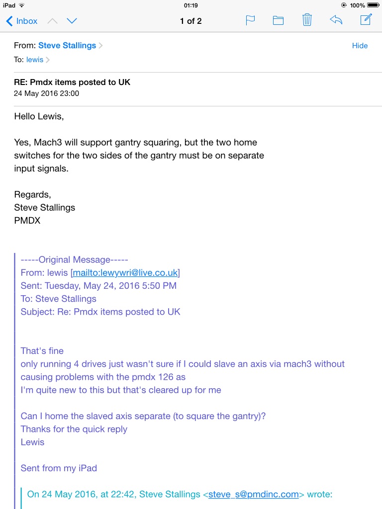

Asked pmdx direct And got Instant replies as I wasn't 100% on slaving and squaring
Attachment 18511Attachment 18512

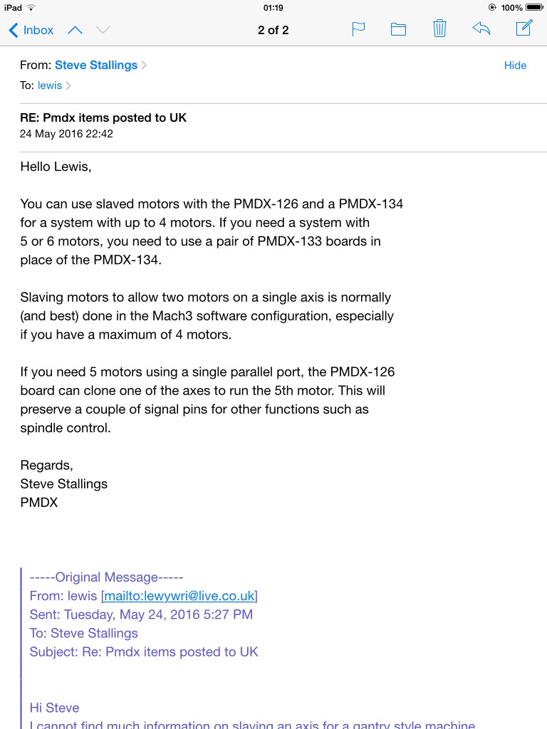

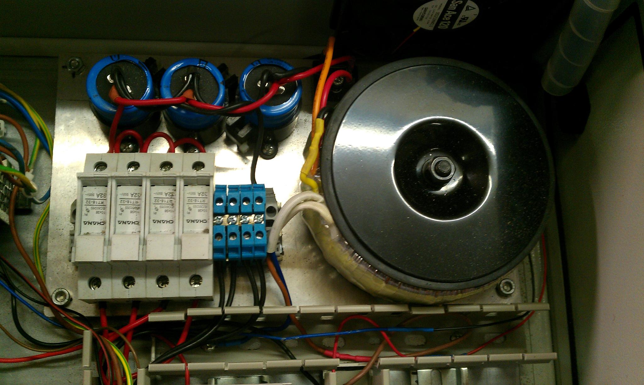

The wiring is simple as it gets. See pic to give an idea of how simple.
Attachment 18519
