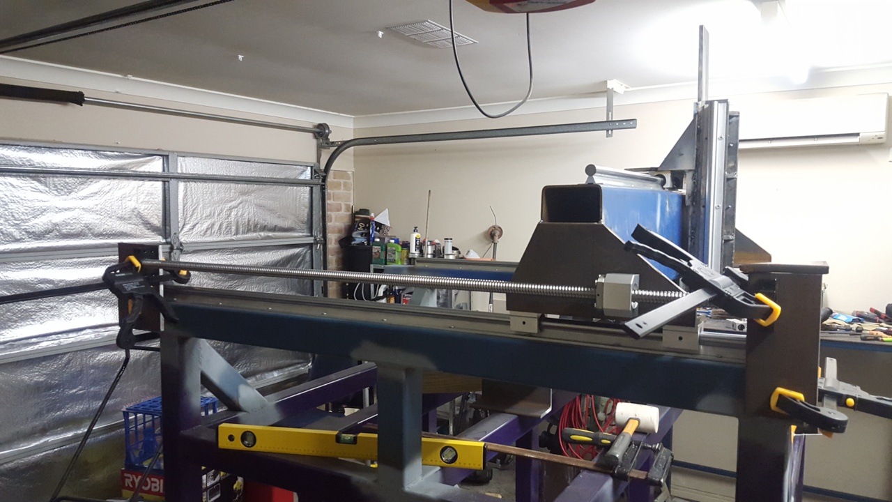

Re: New build - Steel - 3 Axis initially then conversion to 4 axis.
X and Y axis bolted and mounted. Was a very tight fit on the Y axis bearing blocks but It fits like a glove :)
Attachment 18733
Attachment 18734

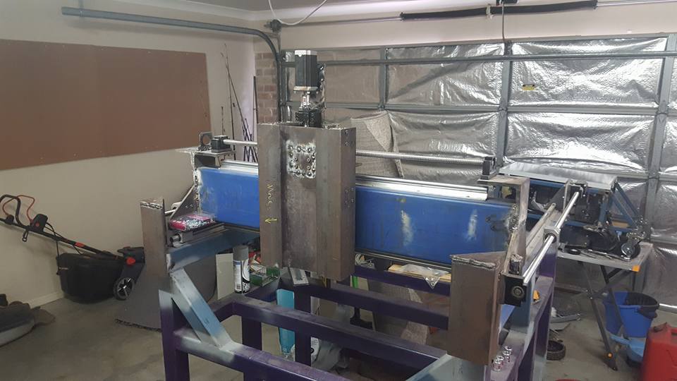

9 Attachment(s)
Few more updates. a redesign of the Z axis and some major work to keep it all straight. moves very smoothly now. Z axis is 6mm steel. working on the ball screws next.
Here's a quick vid of the movement: https://youtu.be/DRLe3EPQ01M
Here's some photos.

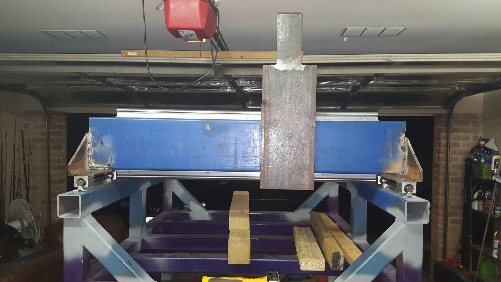

3 Attachment(s)
Z Axis finally fitted and relatively smooth with motion (No racking), Some filler welds will be done in the coming days and the wiring should be done shortly. :) I'm finally starting to see it all come together. I wasn't really sure if my Z design would work, but it seems extremely rigid. Although I've lost 100mm of travel on the Y axis I've maintained a good center of gravity on the Z axis and increased the X axis work area.
Hopefully cutting in January!
Attachment 20049Attachment 20050Attachment 20051
Nice concept of Z axis, only problem is that doesn't allow for any adjustment other than shims. How smooth it travels up and down?
Asking as I machined similar stuff on chinese mill and wasn't parallel.
Same thing for entire machine - you are mounting rails directly to profiles - no machined base, no epoxy for leveling (parallel, squareness?)
I do not criticize you - just wander if you aim for accuracy in your machine.

Pretty smoothly. I do have a video of it turning by hand..
https://youtu.be/lEZzJ3c4UJA
I think the reason for the success in motion is the heating of various sections during the fabrication process.
I like working with steel because it warps and moves when heated.
When designing the Z most of the welding occured on Job with clamps. As the steel heats and warps it smoothly contours around its pressure points. I.e: the fasteners on the bearing blocks and the tension applied by the SBR25 rail.
Not to mention meticulous time spent hammering the fudge out of it at times :) the outer walls were hardest. They have a slight warp in the 6mm and needed lots of bashing and even driving the car over it.
Cutting a square for the ballscrew bracket was the best idea. As it allowed me to drill it then weld it back in with just the tension of the ballscrew to warp to.
There really was no other way though. Accessing the correct drill points would have been almost impossible to get right as it was completely blind.

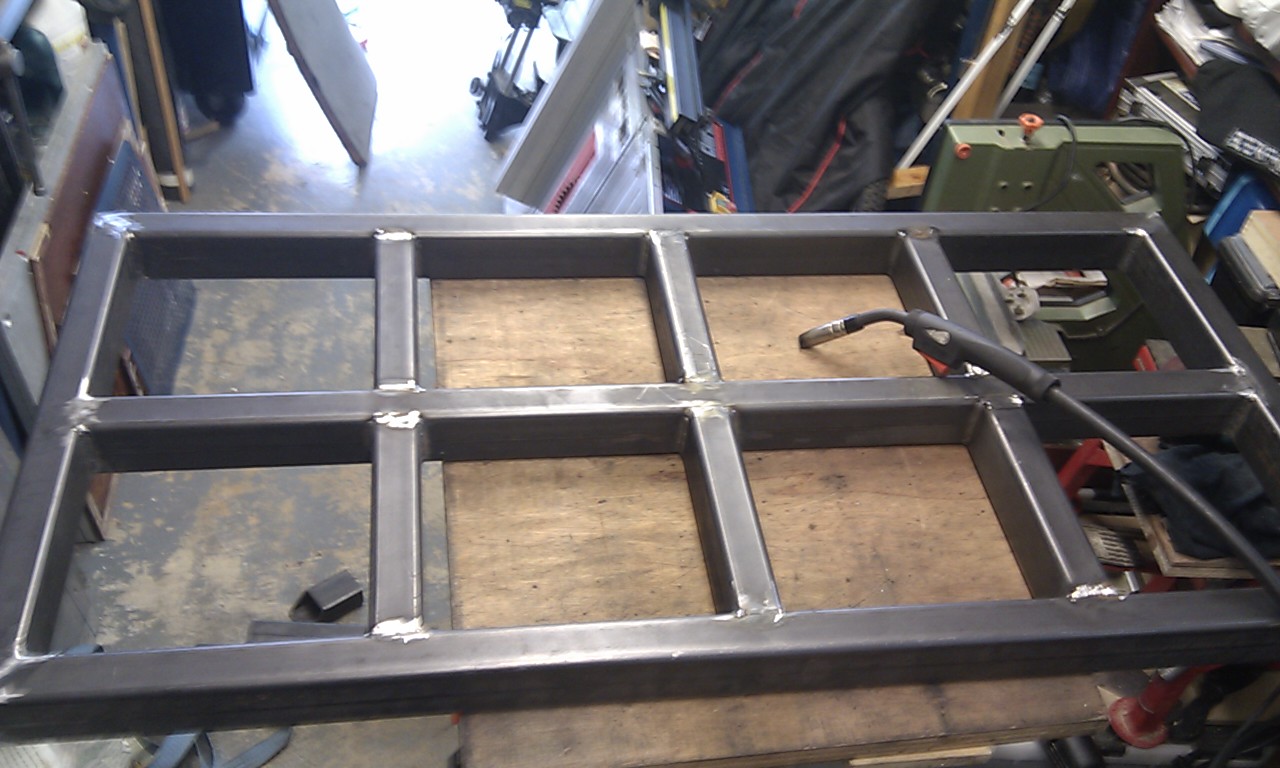

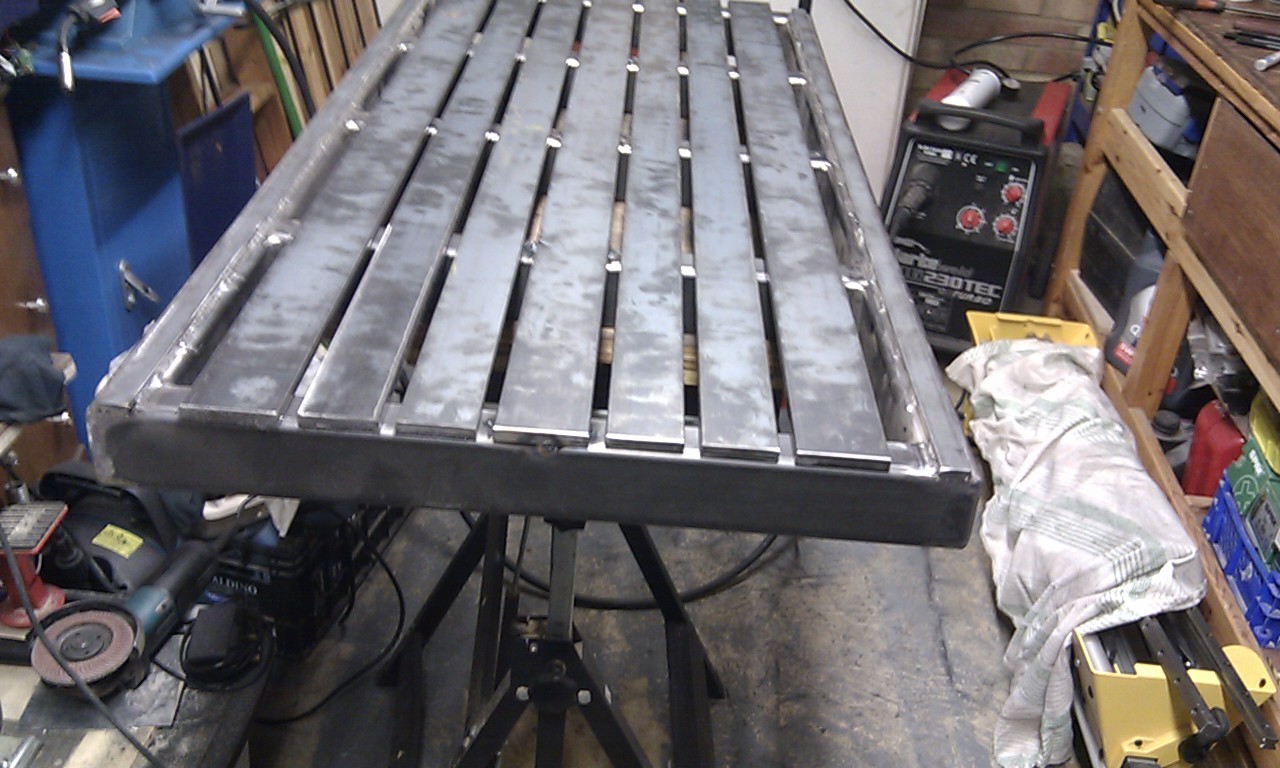

My first bed was ok till I weld those flat bars 8mm thick - it warp badly in the middle
Attachment 20096Attachment 20097
Tom J
Looking goid mate! Tack welds are the way to go. And lots of clamping. I would have got a piece of say 35x70mm box tube and clamped it in several places to the flat bar piece you were working on. Then going from the outsides in to the middle as your box frame will also slightly warp from the welds. Tack everything first then repeat the clamping process all over again with your filler welds.
It's hard with long runs like that. Partly the reason bojan S uses C channel for his bed. Although I find welding much easier, drilling and bolting would have given a better result.
Whats the link for your thread?
