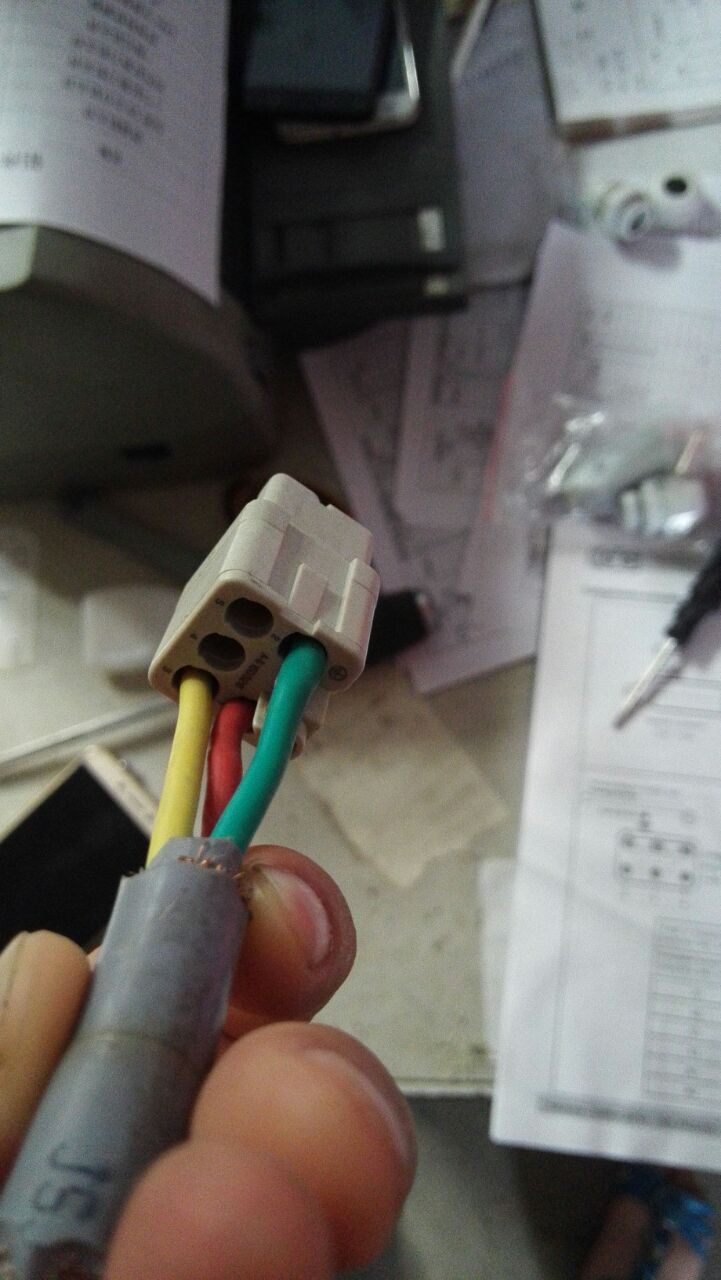

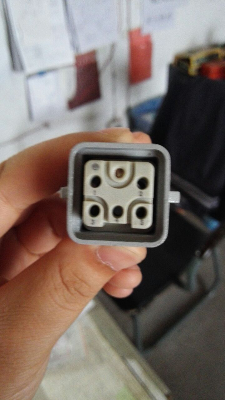

Various adverts give nothing like the amount of technical detail that I'd like, however, most, do clearly state the two voltage options, and a close-up of the 6 pin connector.
e.g.
http://www.chinaseniorsupplier.com/M...tificiate.html
They show 2 different PDF. One for the 220v another for 380V which suggests it's not dual voltage which is changable via usual methods. Also there is no Star Delta connection on the connector which also backs this up.

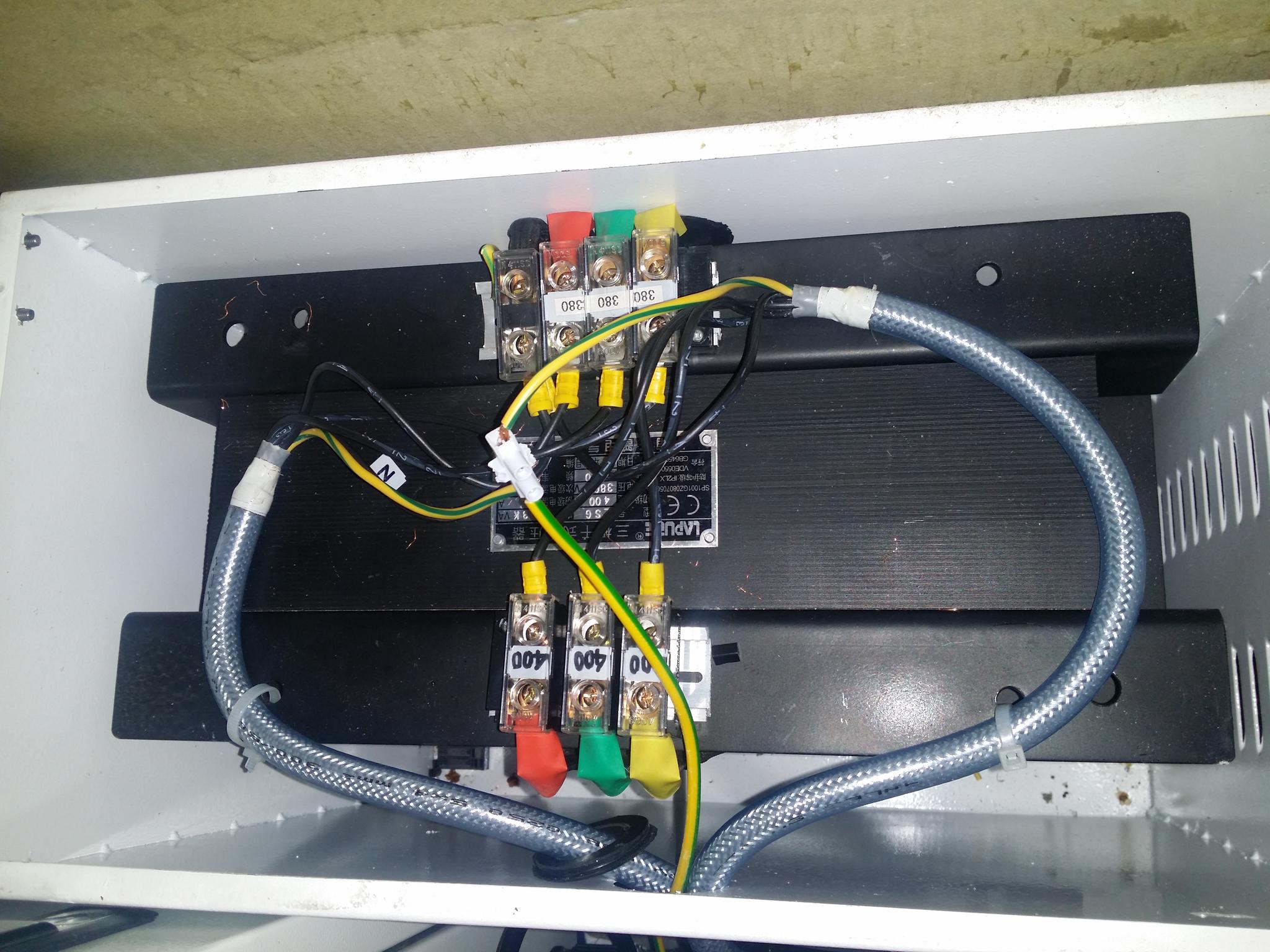

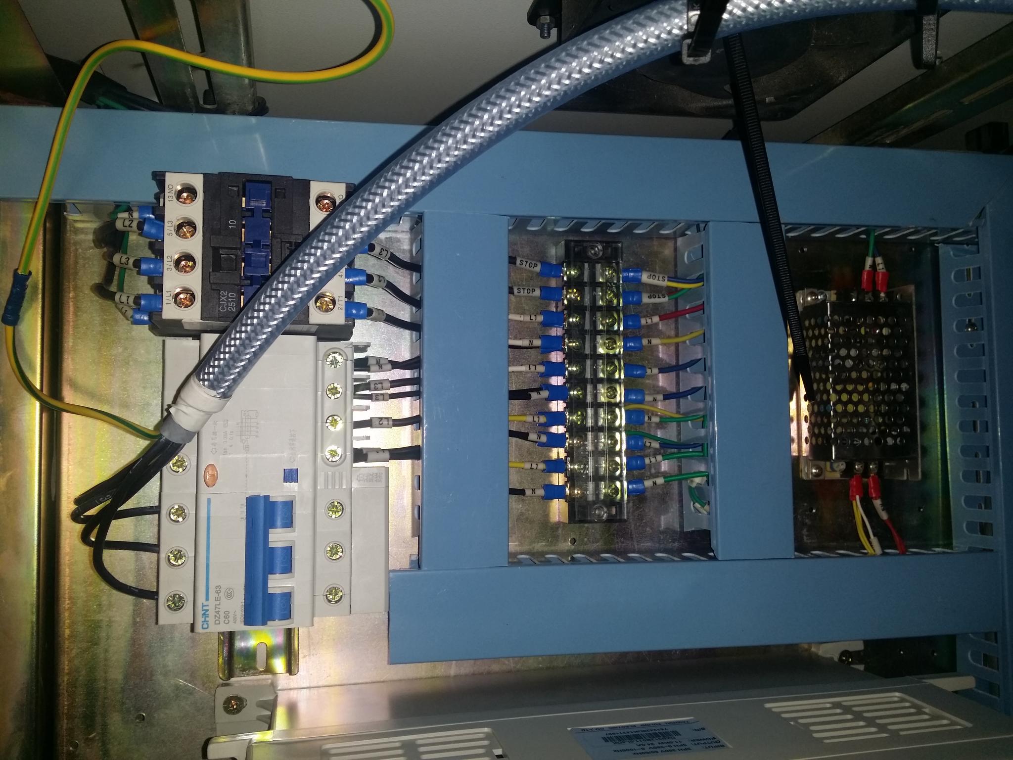

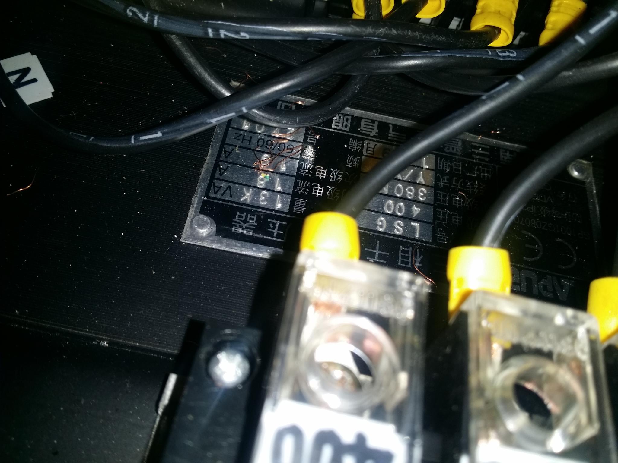

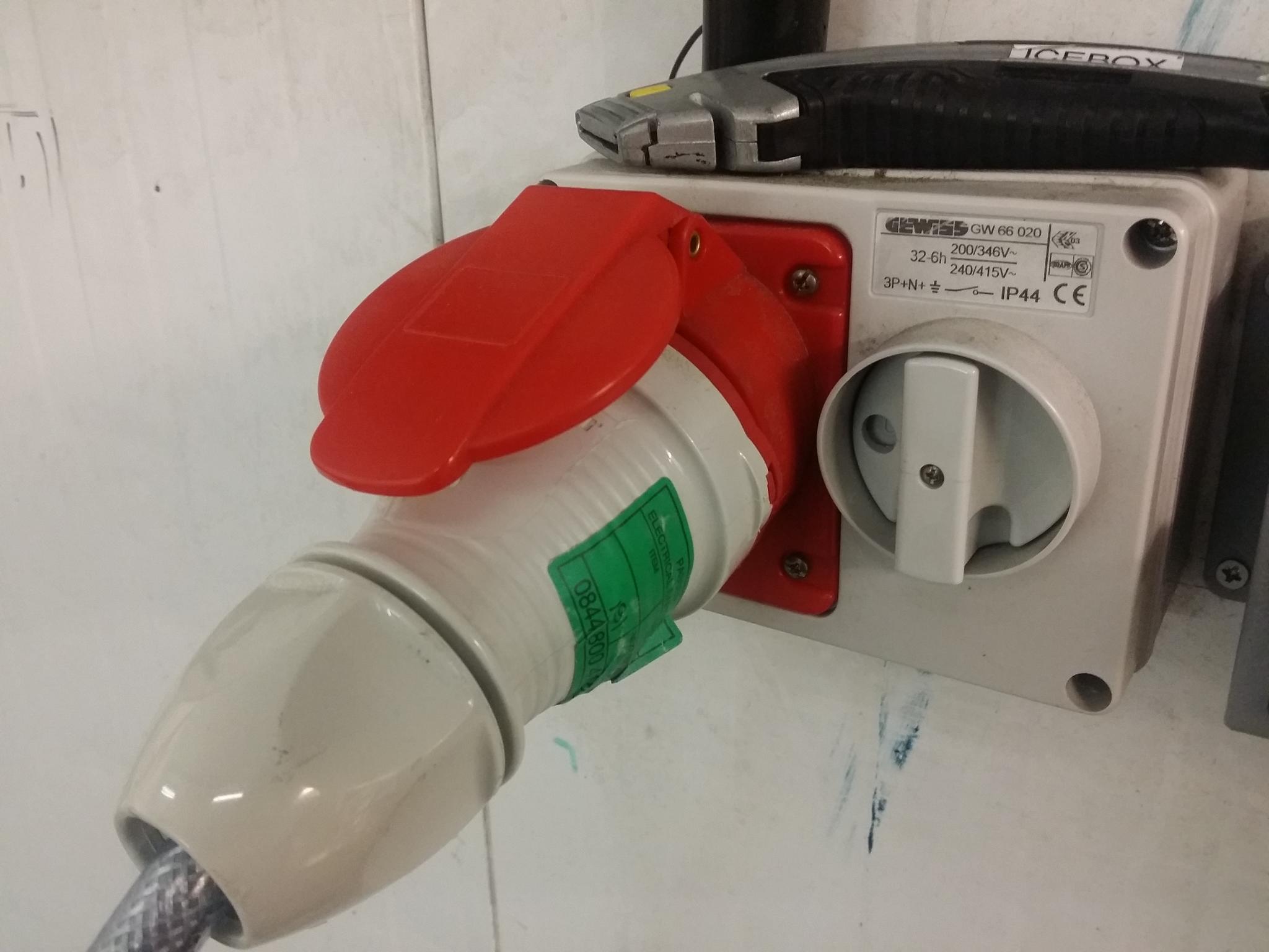

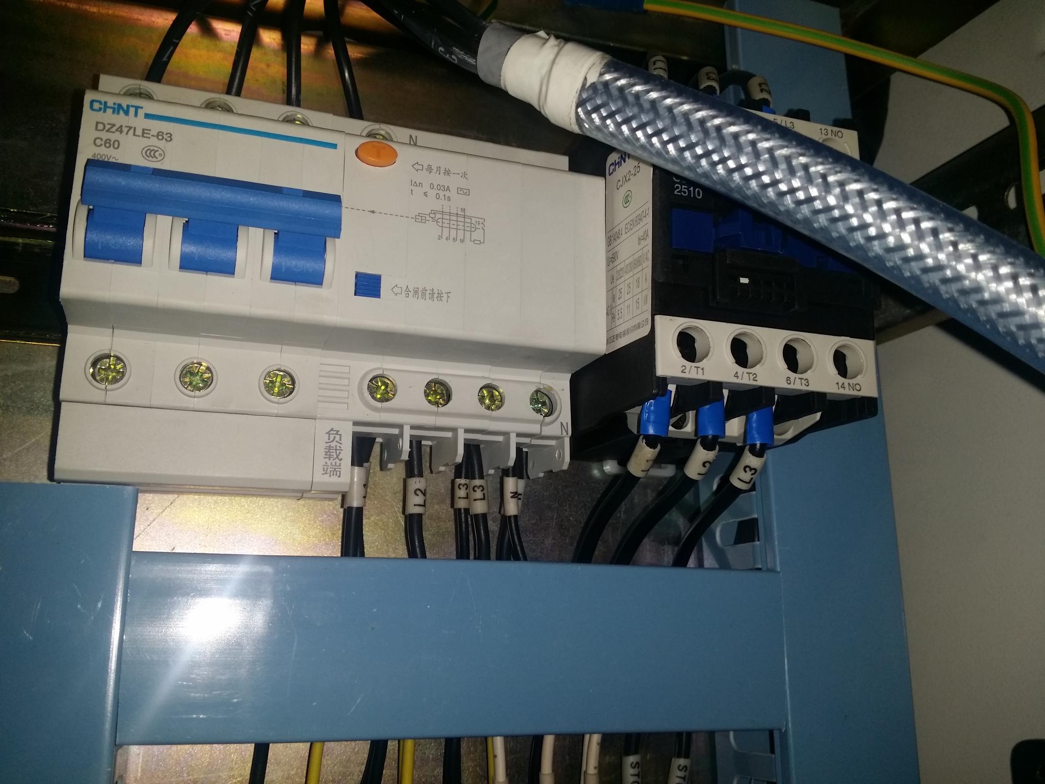

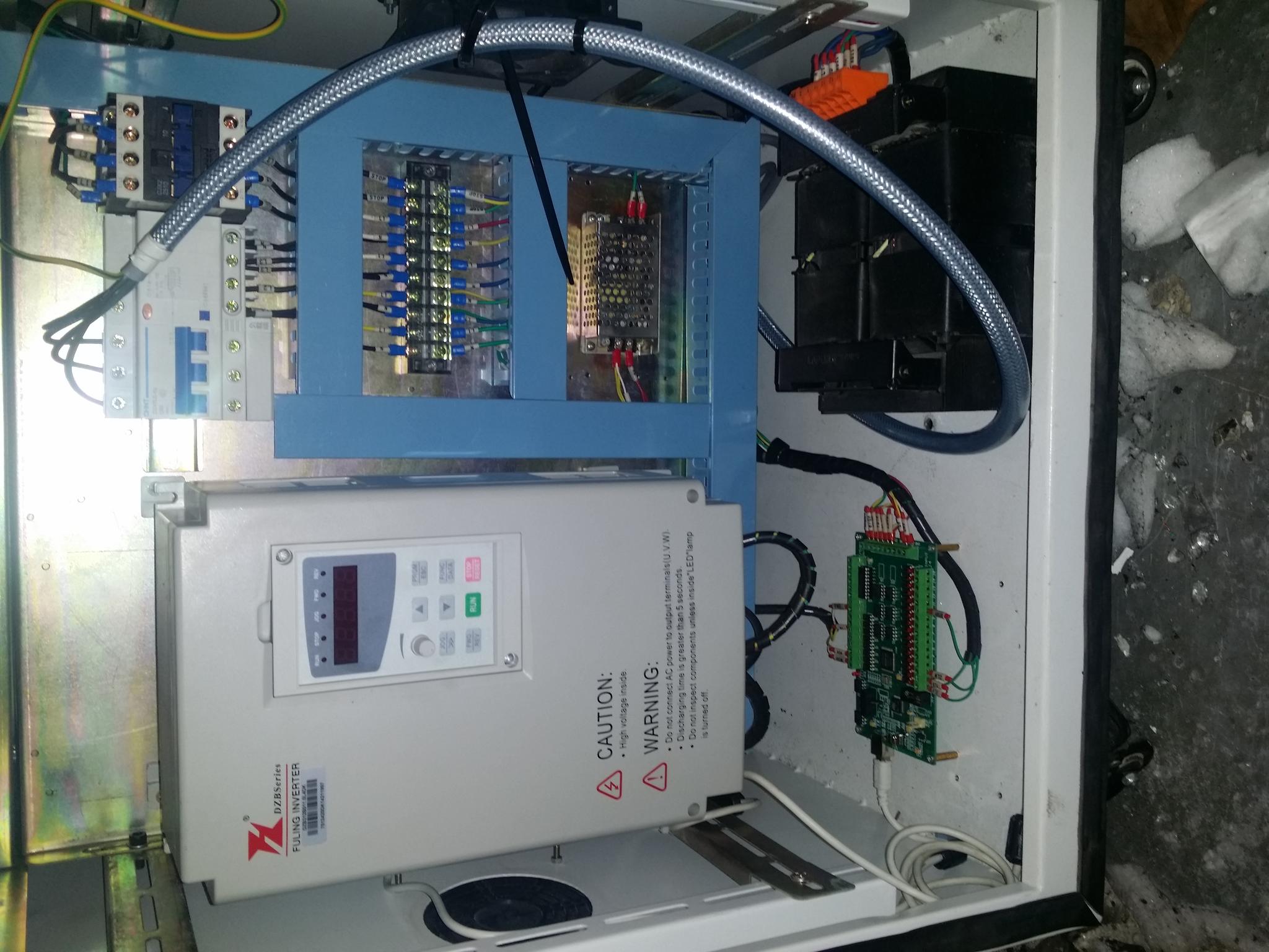

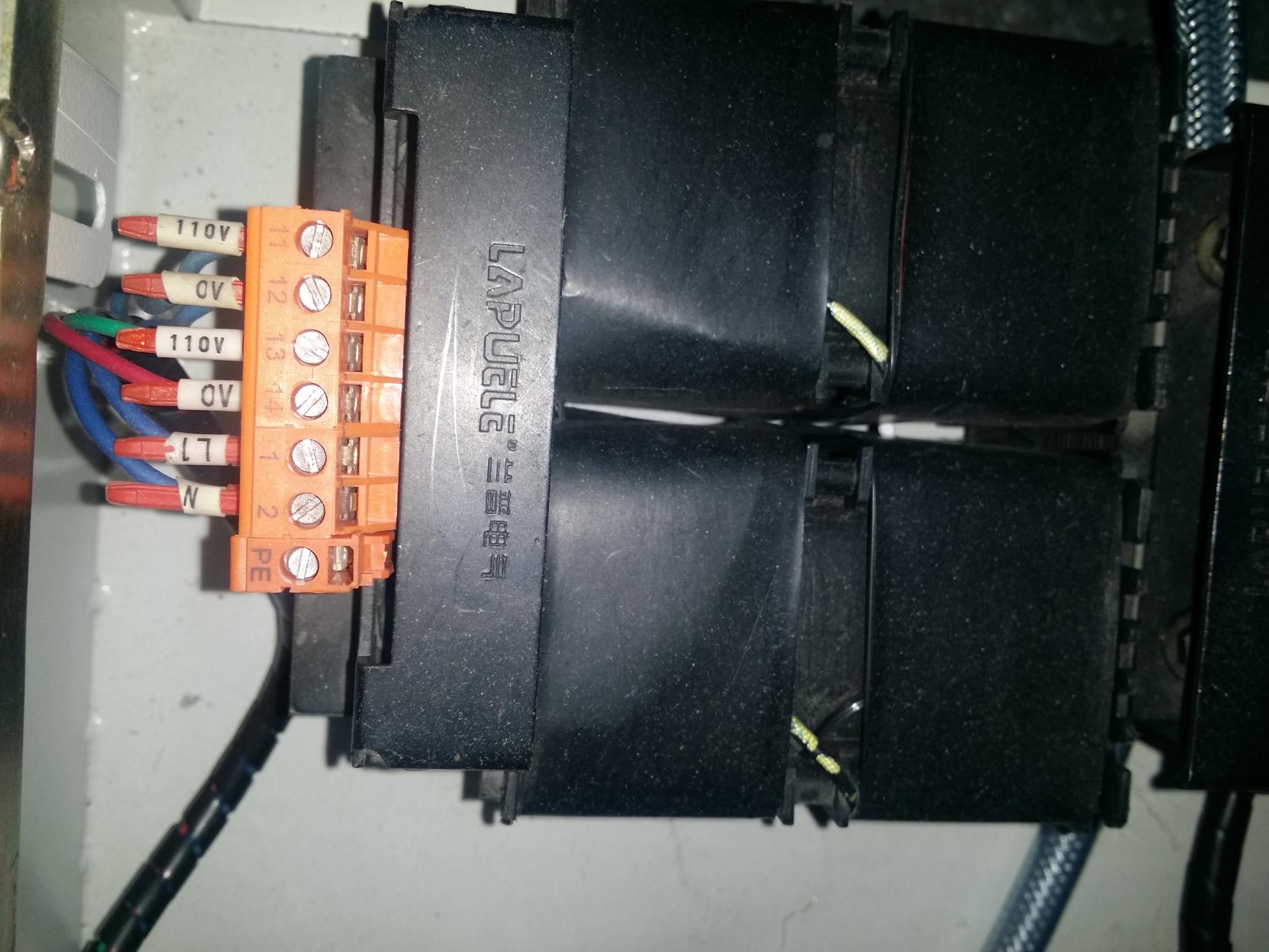

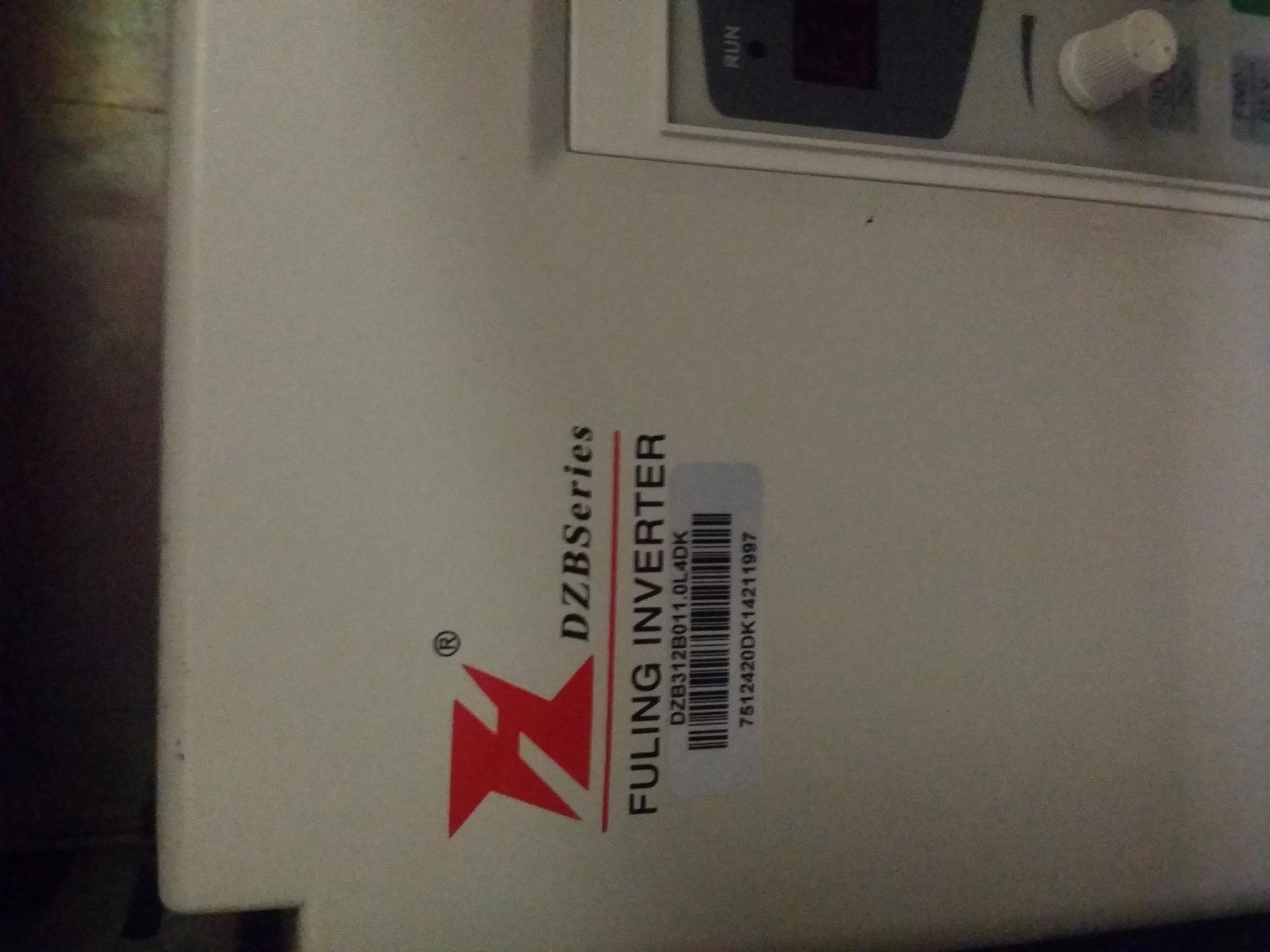

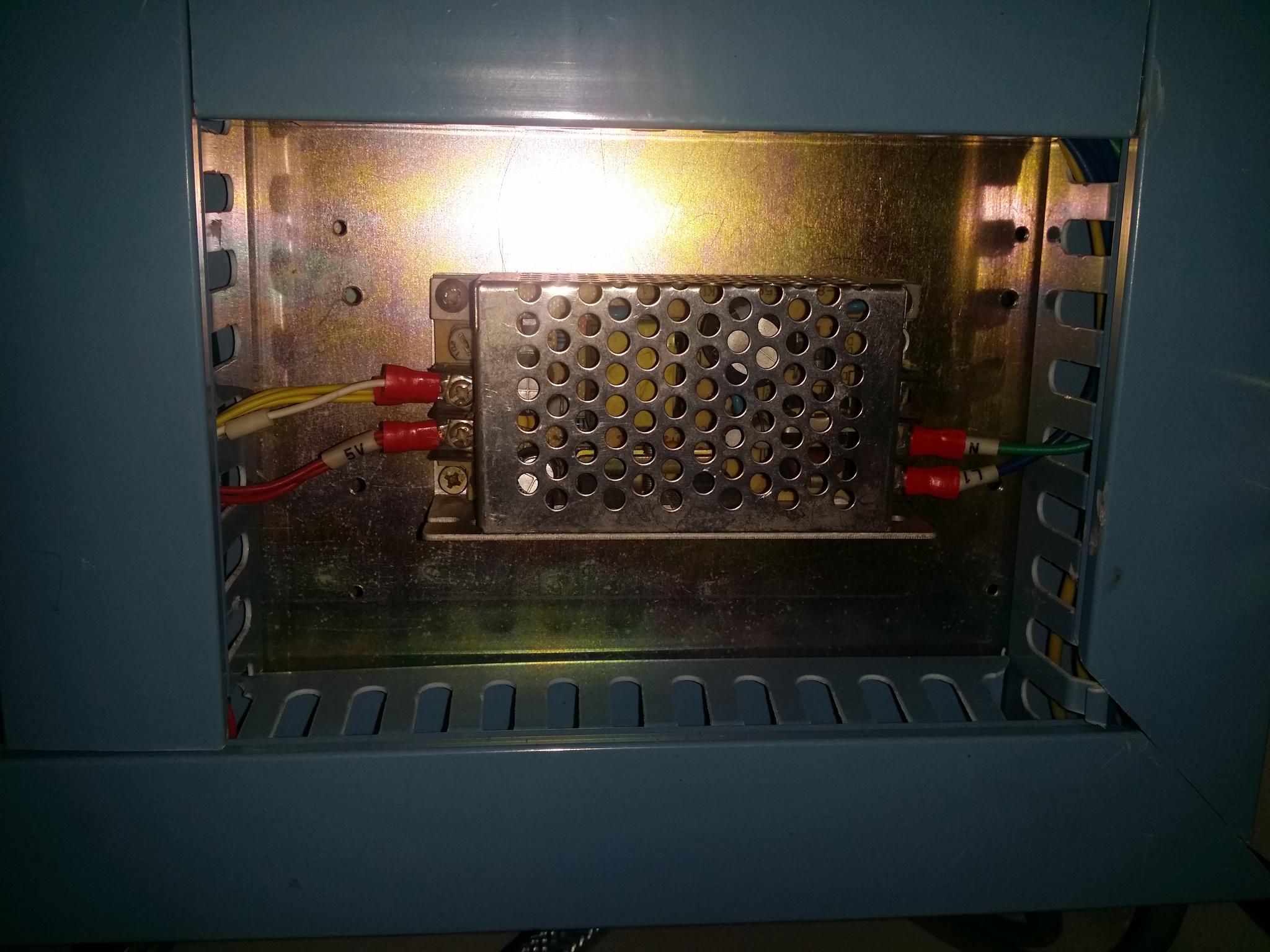

Please see the wiring pictures attached. If you need any more specific ones please let me know.
Also this current issue with the colombo highlighted some serious dangers that minor software issues can cause. We had incidents before when an apprentice spun the spindle with a tool not intended for that code and well.... the tool was flying across room in pieces as instead of 5000 RPM it was spinning at 18000 RPM. So if someone could explain us how to control the spindle straight from the VFD instead of going through Mach3 that would be great as a backup option for the future. We have a smaller machine on which we control the spindle from the VFD and although it takes a bit more time it might be safer.
We still don't know if we have a star or delta connection but hopefully the attached pictures shed some light on that.

The Plug that supply's the whole system:
Attachment 18829
The Colombo wiring:
Attachment 18830

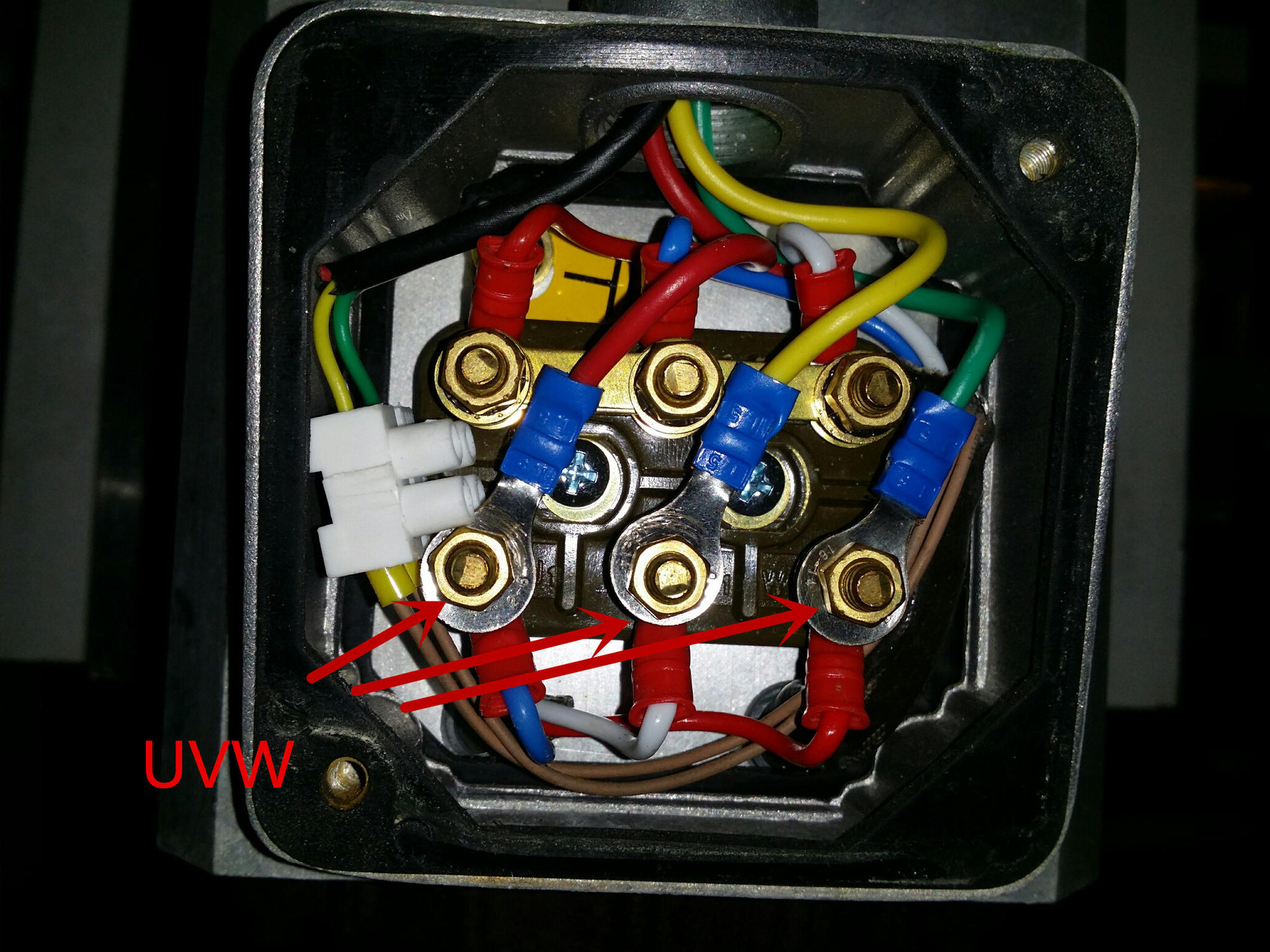

The new Chinese spindle wiring:
Attachment 18831
Attachment 18832
Photos of the inside wiring:
Attachment 18833
Attachment 18834
Attachment 18835
Attachment 18836
Attachment 18837
Attachment 18838
Attachment 18839
Attachment 18840

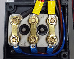

Ok well the chinese spindle is wired Star(380v) so you need to change it to delta. This will cure your speed problem.
Remove the screws and those gold jumpers can be changed around. Set them like the pic.
Regards the Speed changing when code runs then are you 100% sure the code isn't changing the speed.? Other than that then would need to see the XML to make sure spindle is set correctly.
Regards the VFD Speed then unfortunatly it's one or the other. Yes can make speed adjustable from VFD with quick parameter change but you will lose external control via Mach3.
Attachment 18841

Just a thought check to see if the motor is running in the correct rotation when done. If it does not you will have to swap over any of the 3 phases.

Just to make sure although it might be a dummy question, but do we remove the back cover on the chinese spindle to do the re wiring as that does not have an electrical box on the outside. So my guess is that is somewhere under the cooling fan assembly.
