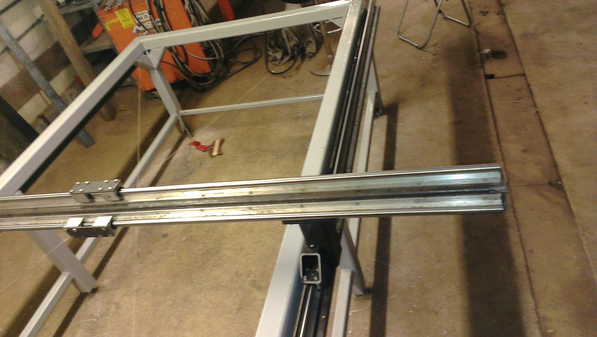

all the switches are mounted
Attachment 20517Attachment 20518Attachment 20519Attachment 20520

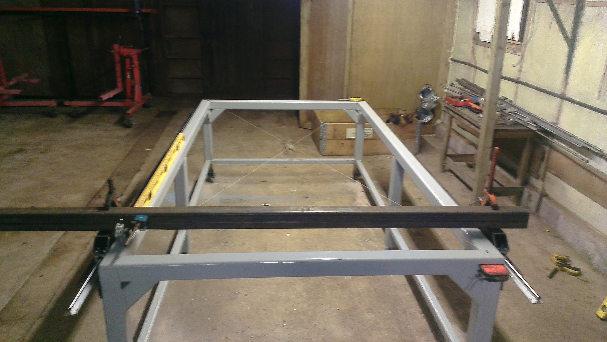

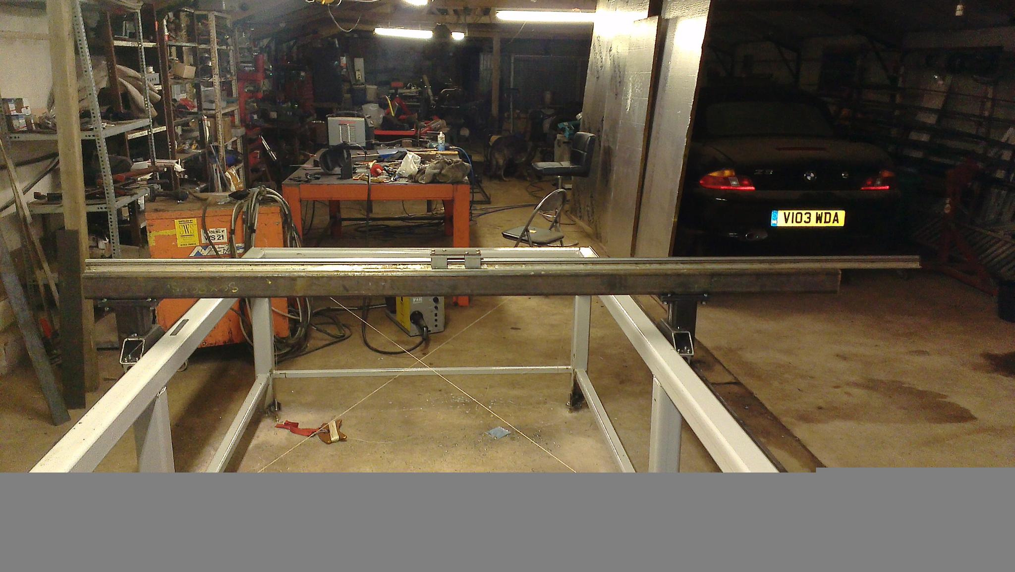

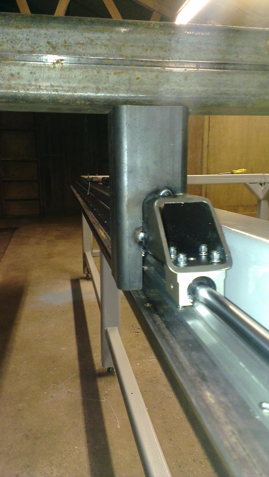

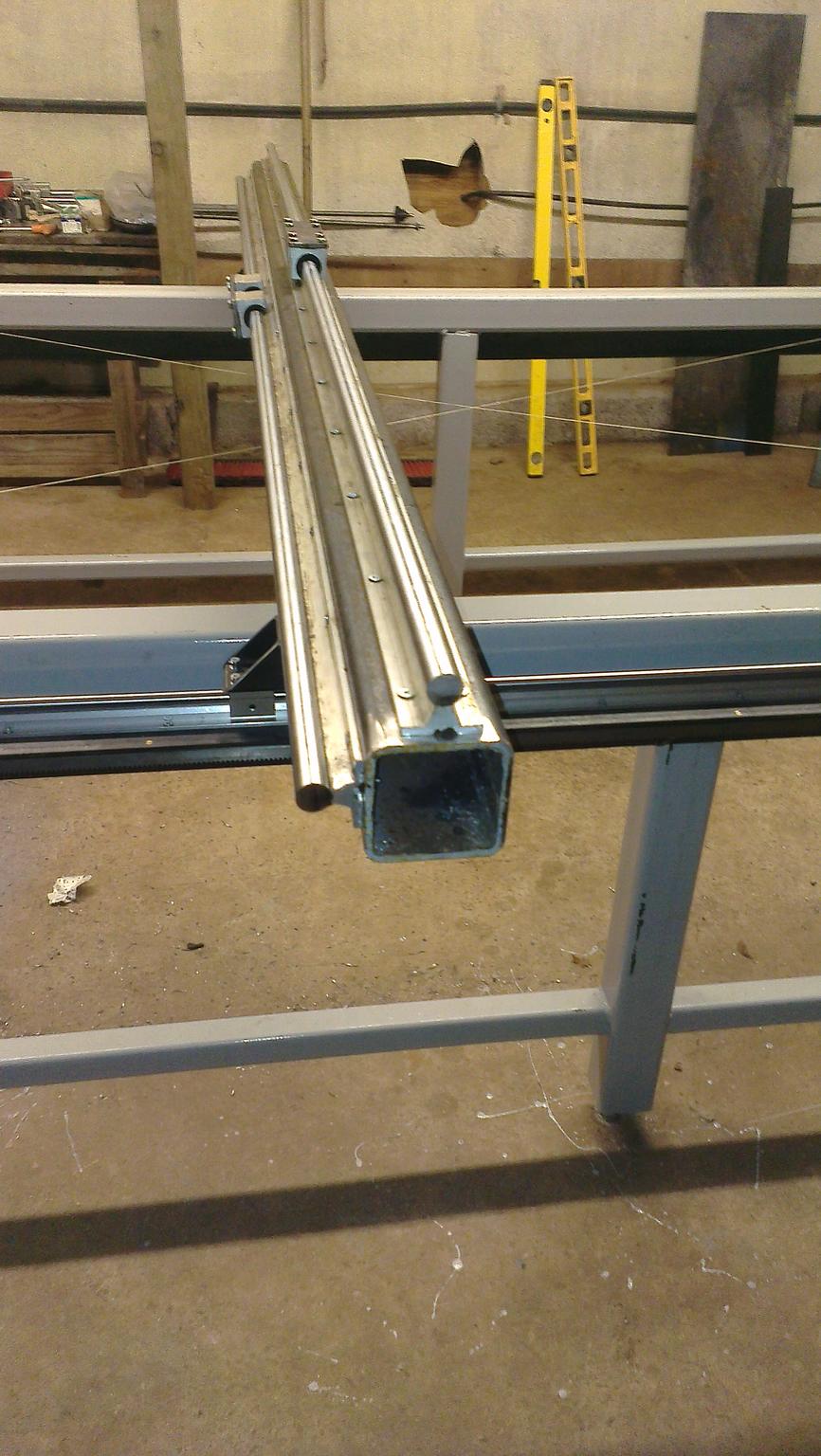

all the cable runs are in and threaded through the cable drag chain..
Attachment 20524Attachment 20525Attachment 20526Attachment 20527

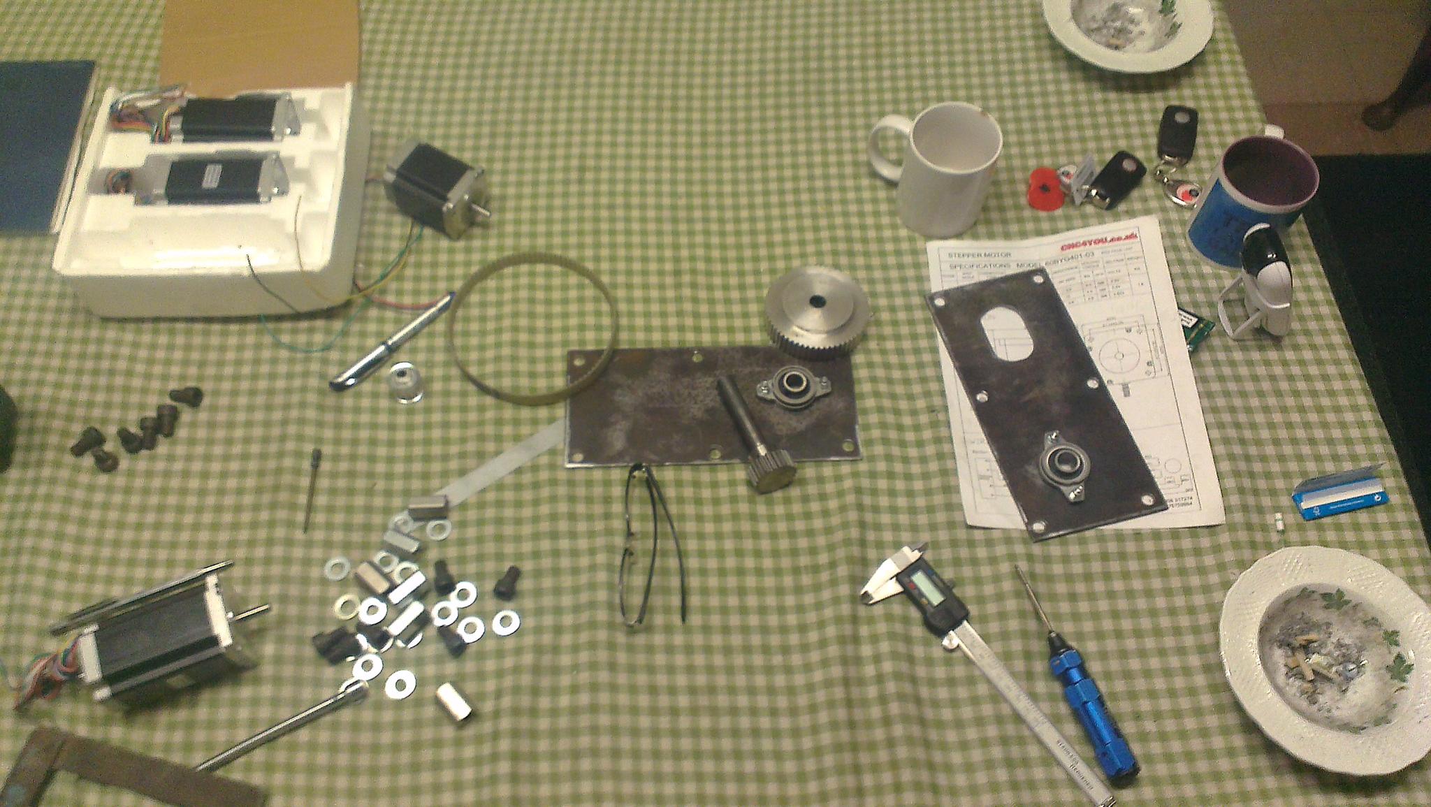

and the fun begins!!!!
Attachment 20580Attachment 20581
ok the problems begin....there isnt enough pins on my bob to run my proma thc and another axis for the rotory or the air scribe...so a friend has a uc400 knoocking about that he hasnt got around to using yet...

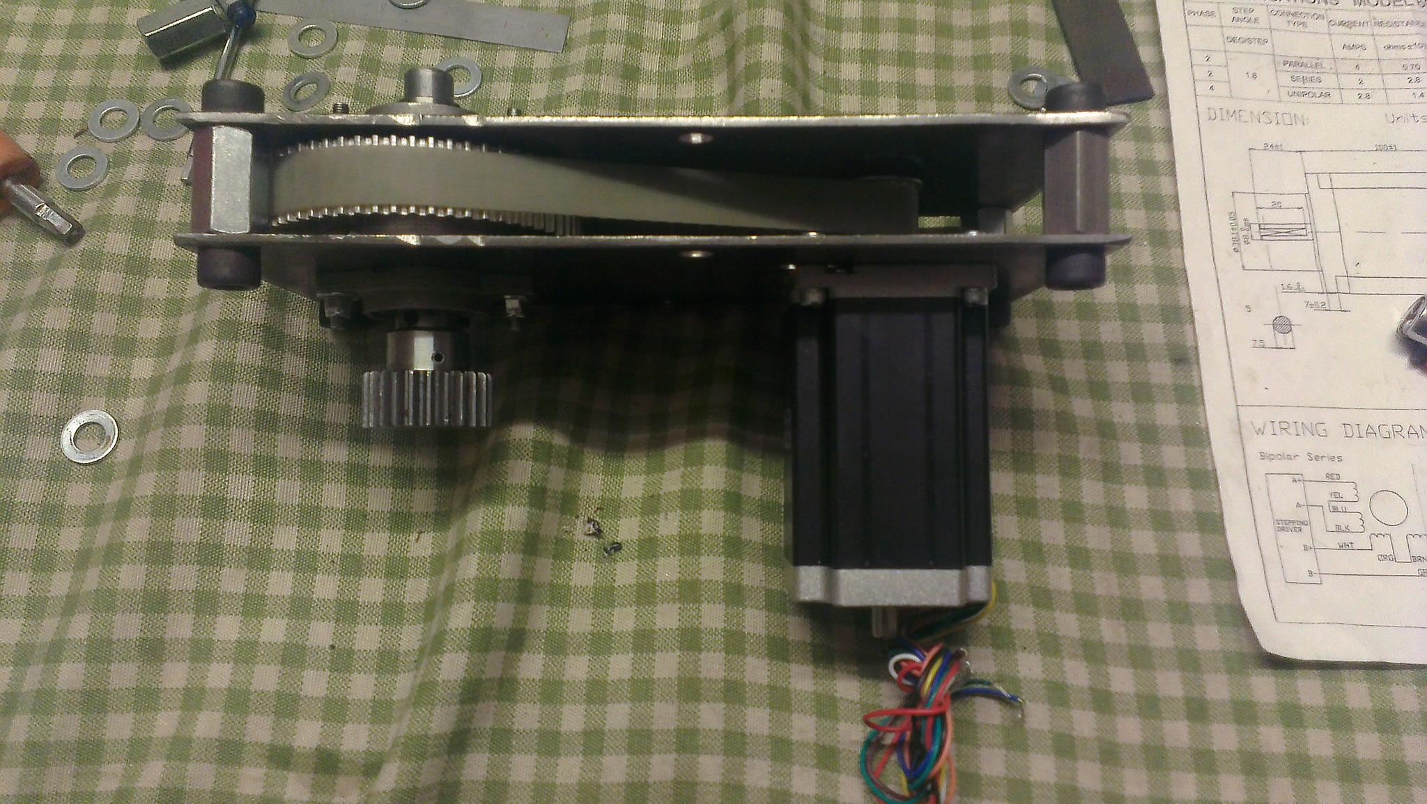

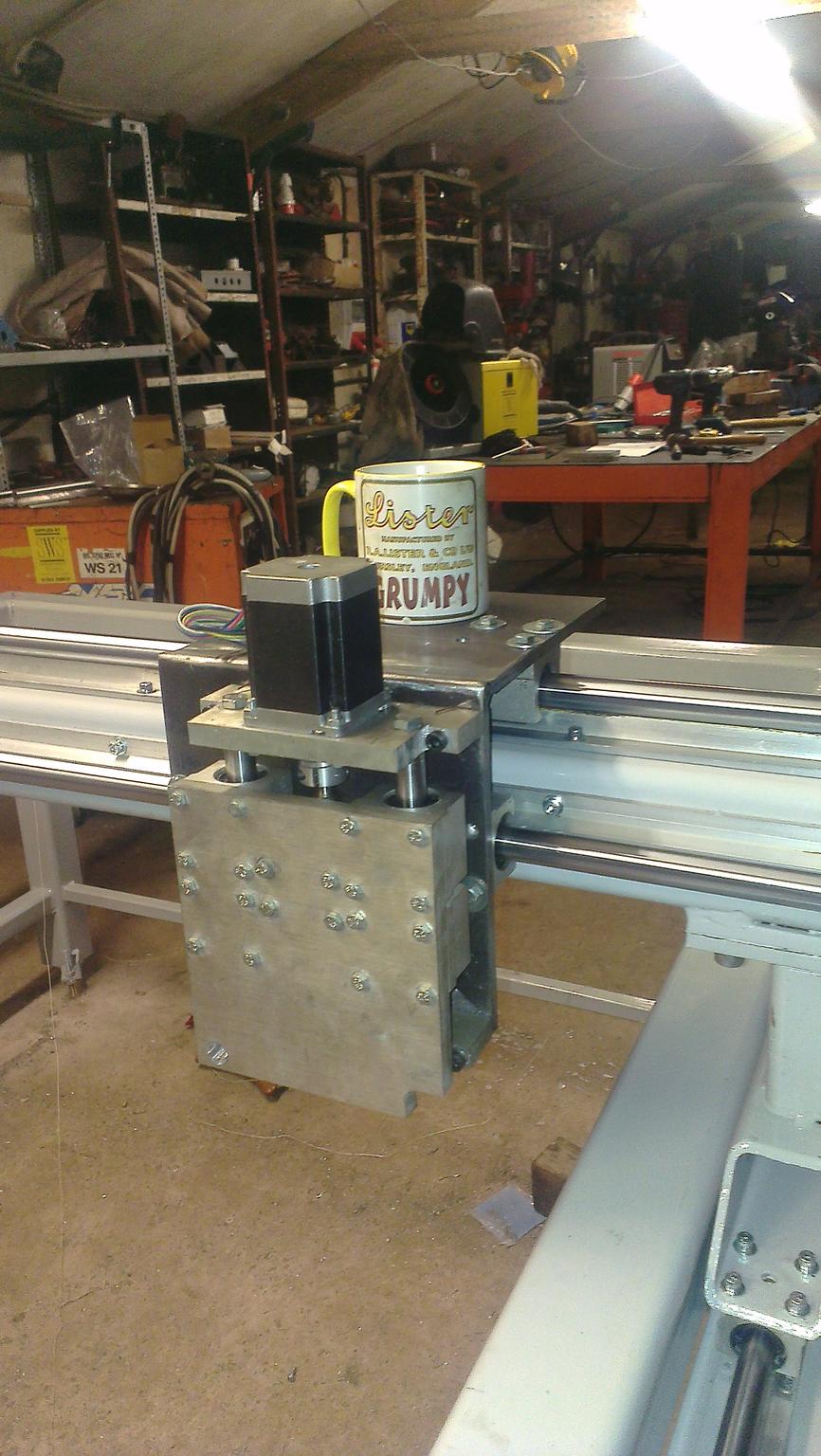

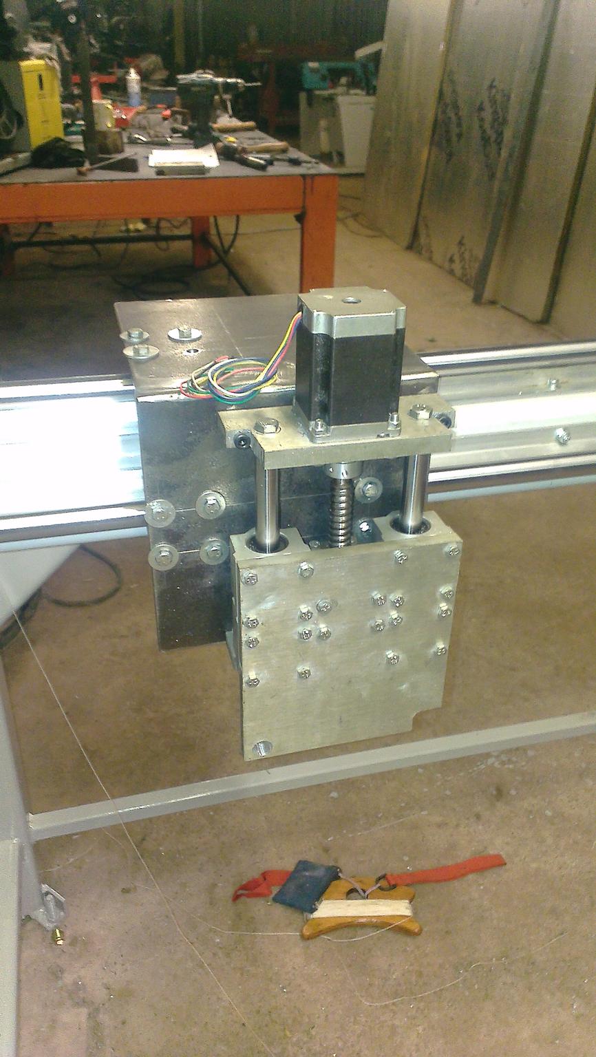

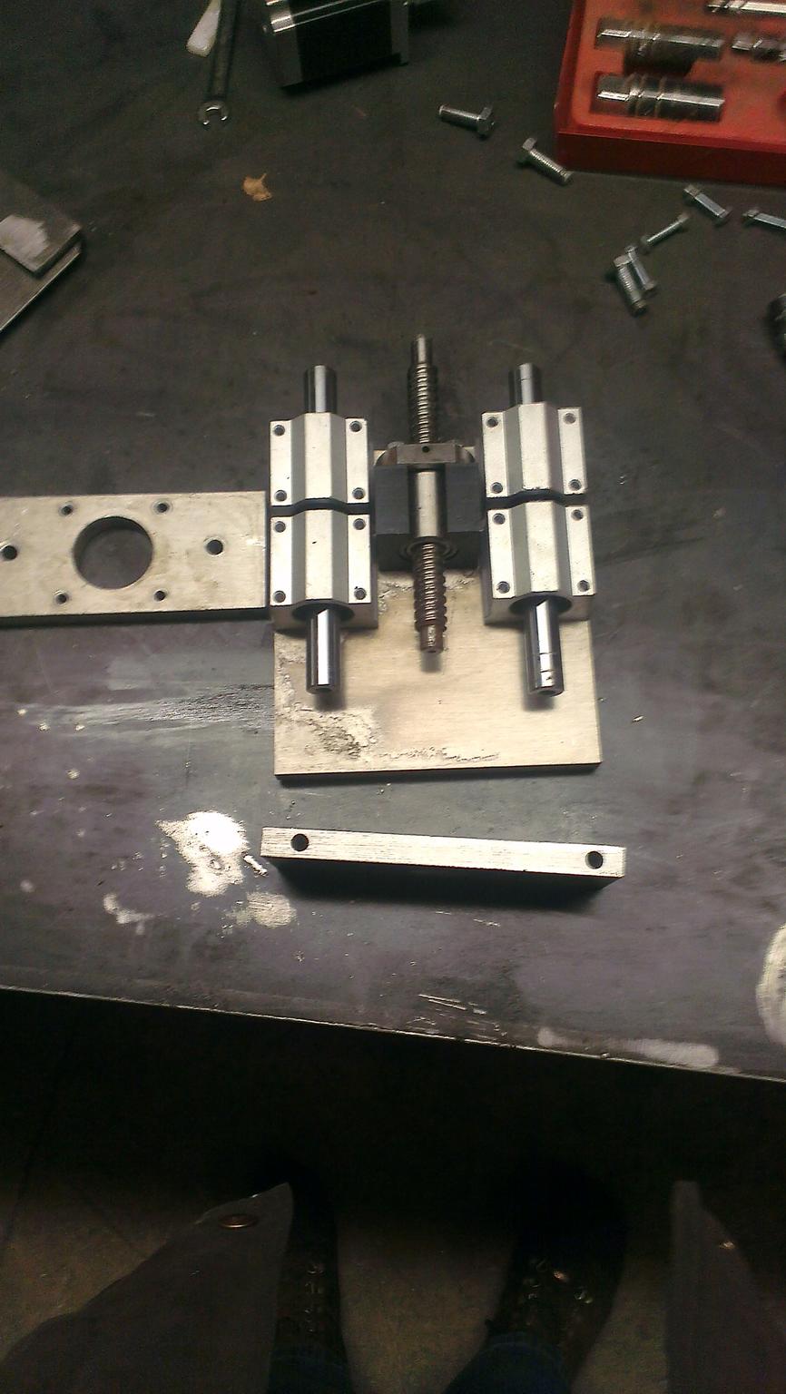

Attachment 20784Attachment 20785Attachment 20786Attachment 20787
a few photos of the computer cabinet,

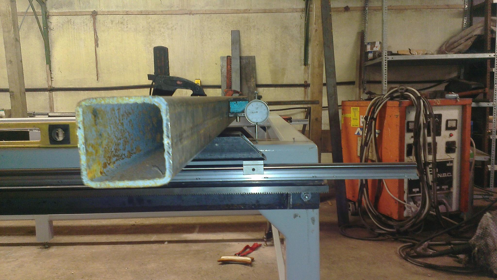

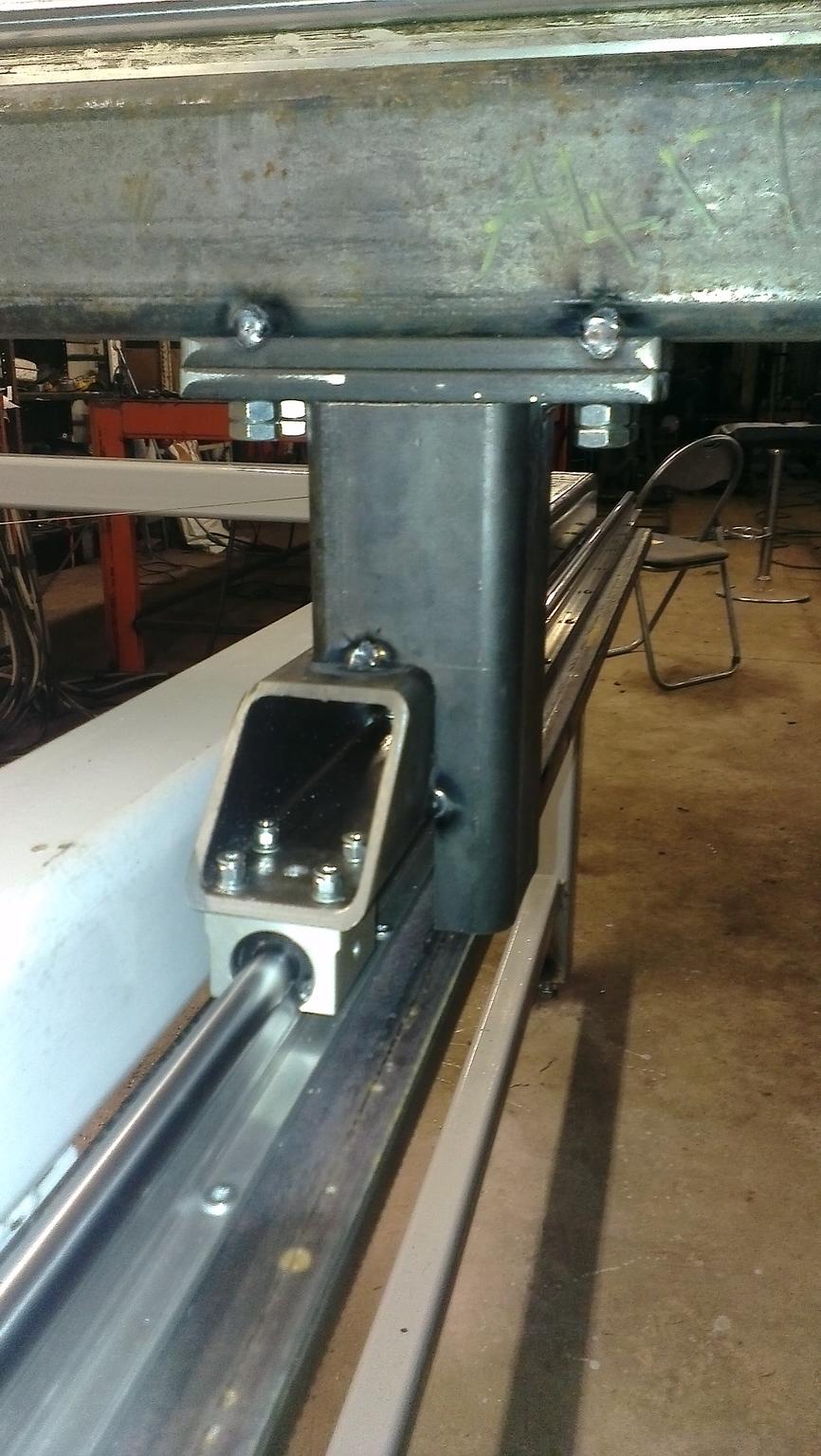

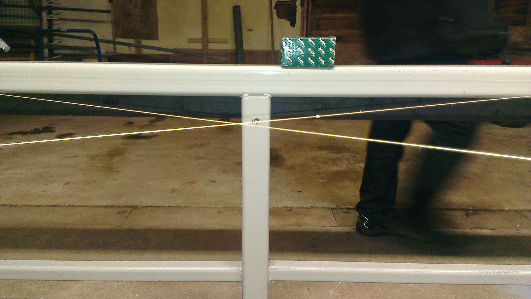

managed to get it wired up and have started configuring it...after a few attemps it now travels 1000mm accuratly x and y axis...the gantry was 3mm out of square over a 1000 x1000 square have now got it down to .75mm and should have that near perfect tommorow......

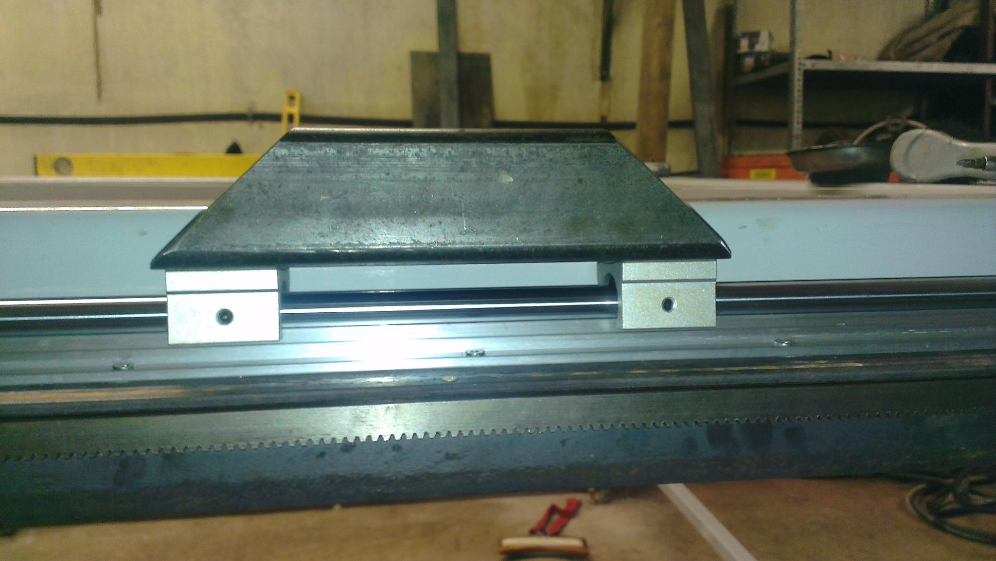

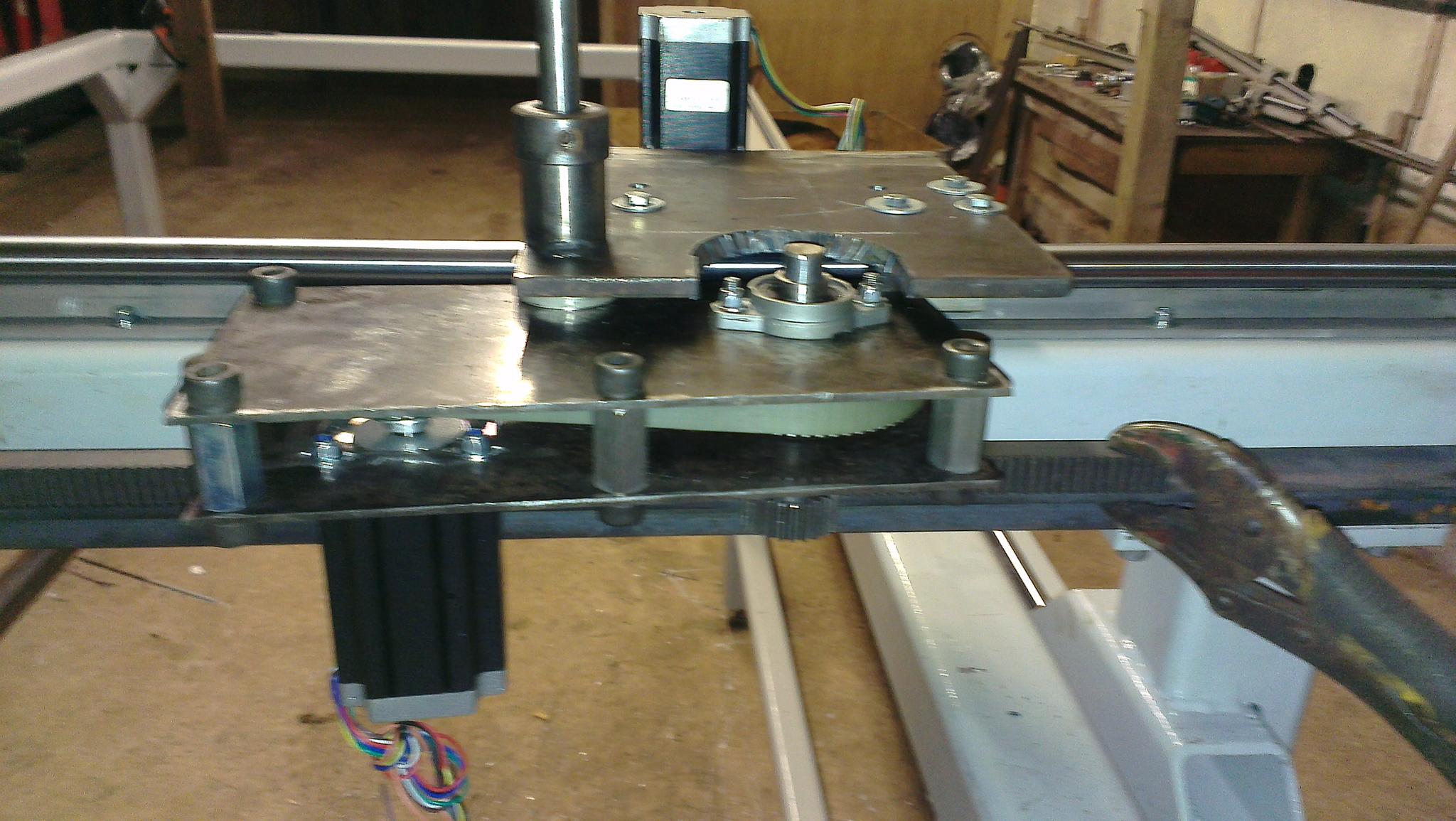

finally tracked down a machine torch and have got it mounted..iv used four magnets and a few domed head bolts
Attachment 20878Attachment 20879Attachment 20880

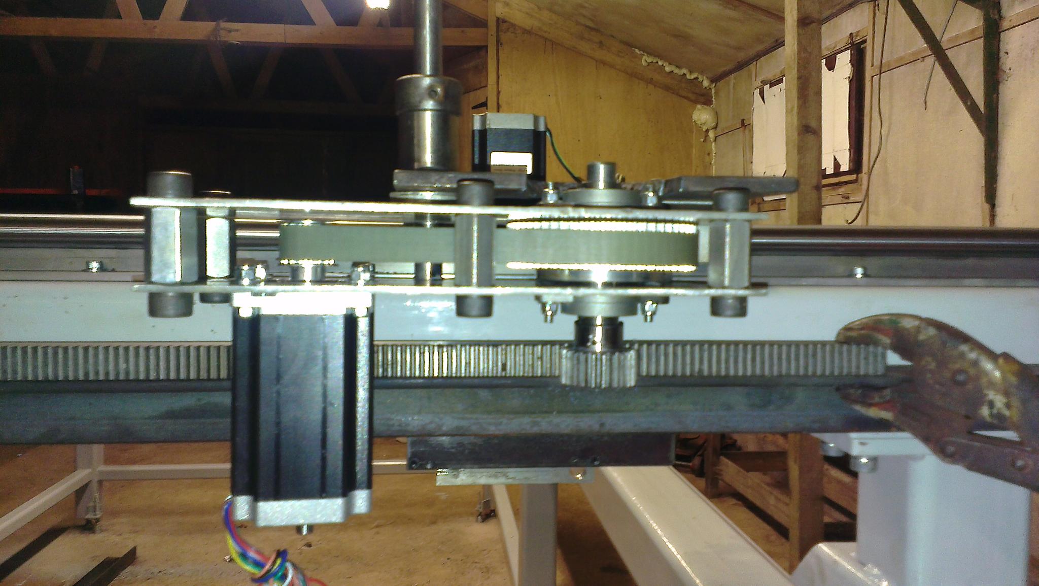

how you getting on Warwick, any progress? gonna launch a build thread now, the day has come.

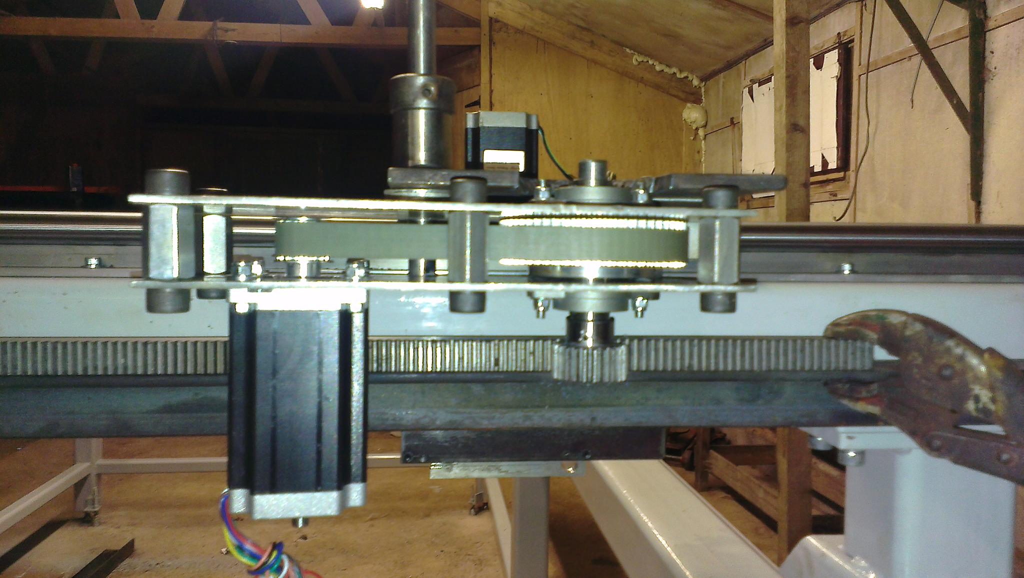

Warwick you there? hows it going man? The extra bit on your x axis, is that for a rotary axis? I want one!
hi ned, sorry i havent been about much....tables working fine,,,cutting with it most evenings.....yes the extra piece on my x axis is indeed for a rotory ...i havent really thought about the scribe or the rotory axis yet.......i get email notifications if you post or message,,,,
aright man ) well done, good for you. I'm going to do the same, building the x axis out for a rotary axis. I want to be able to cut tube neatly. Lots of potential there.

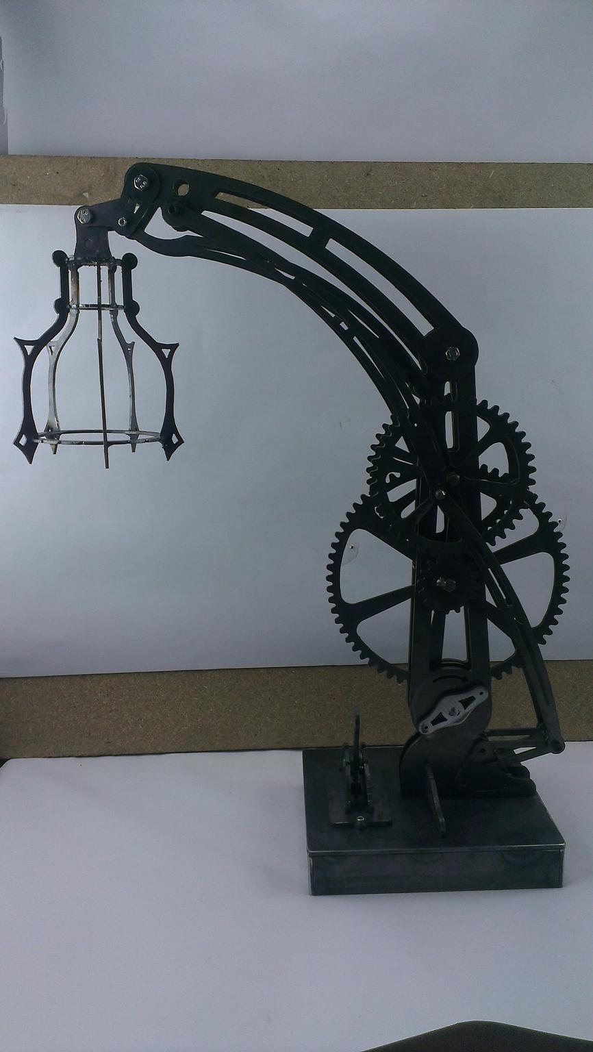

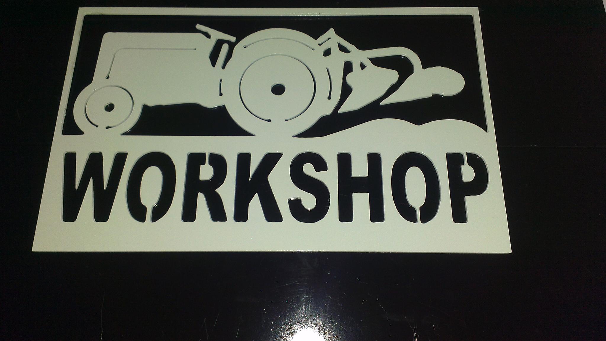

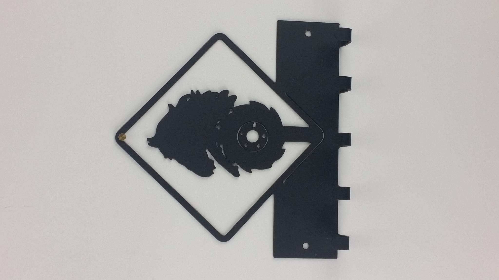

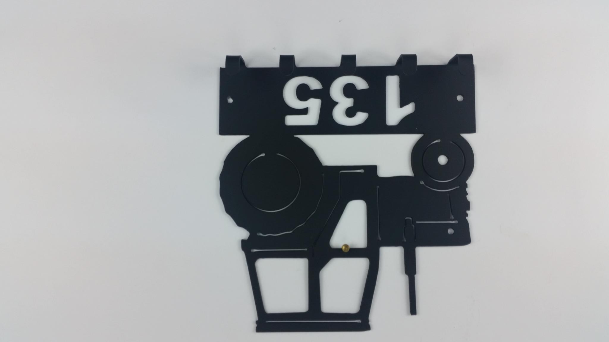

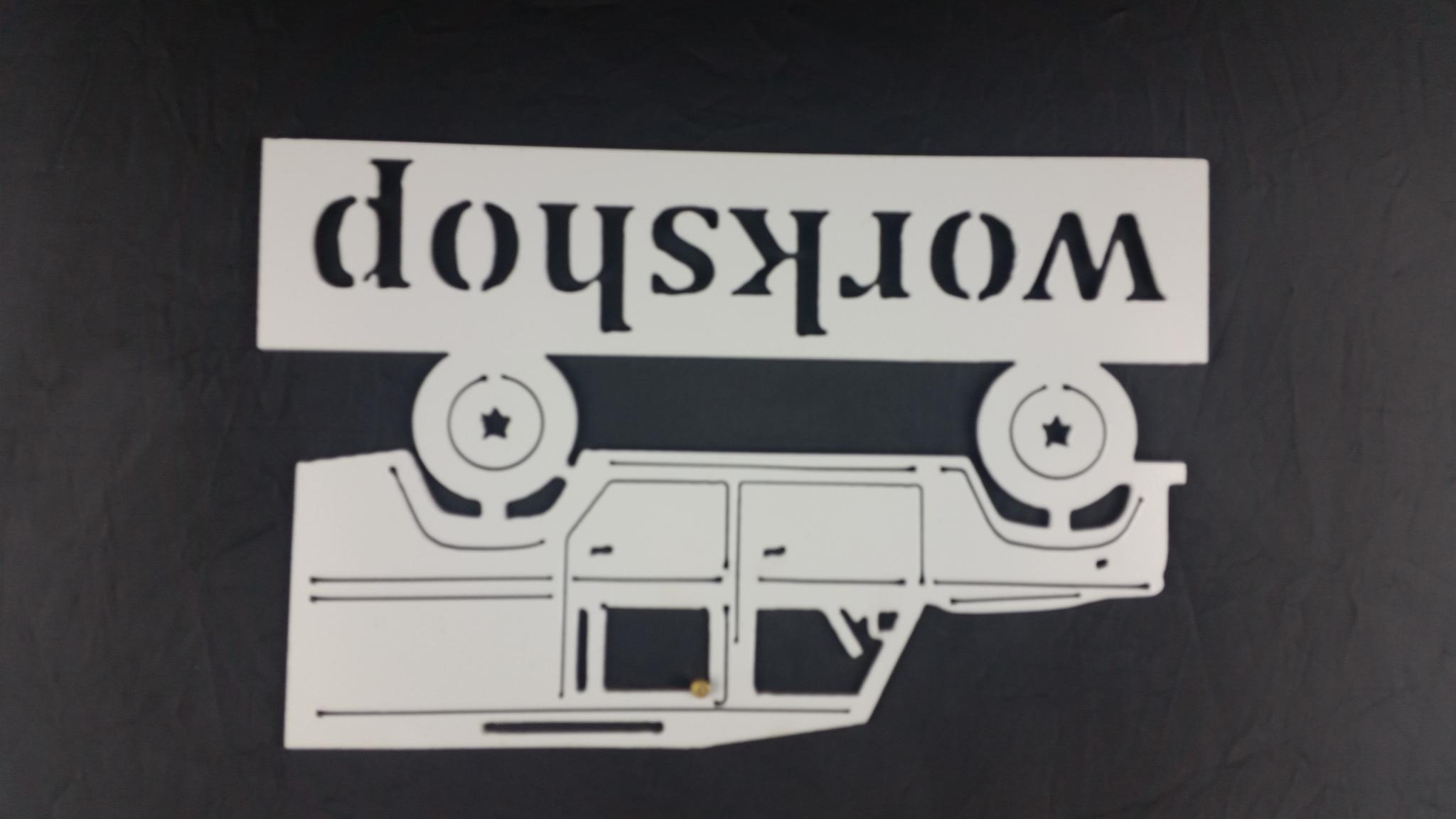

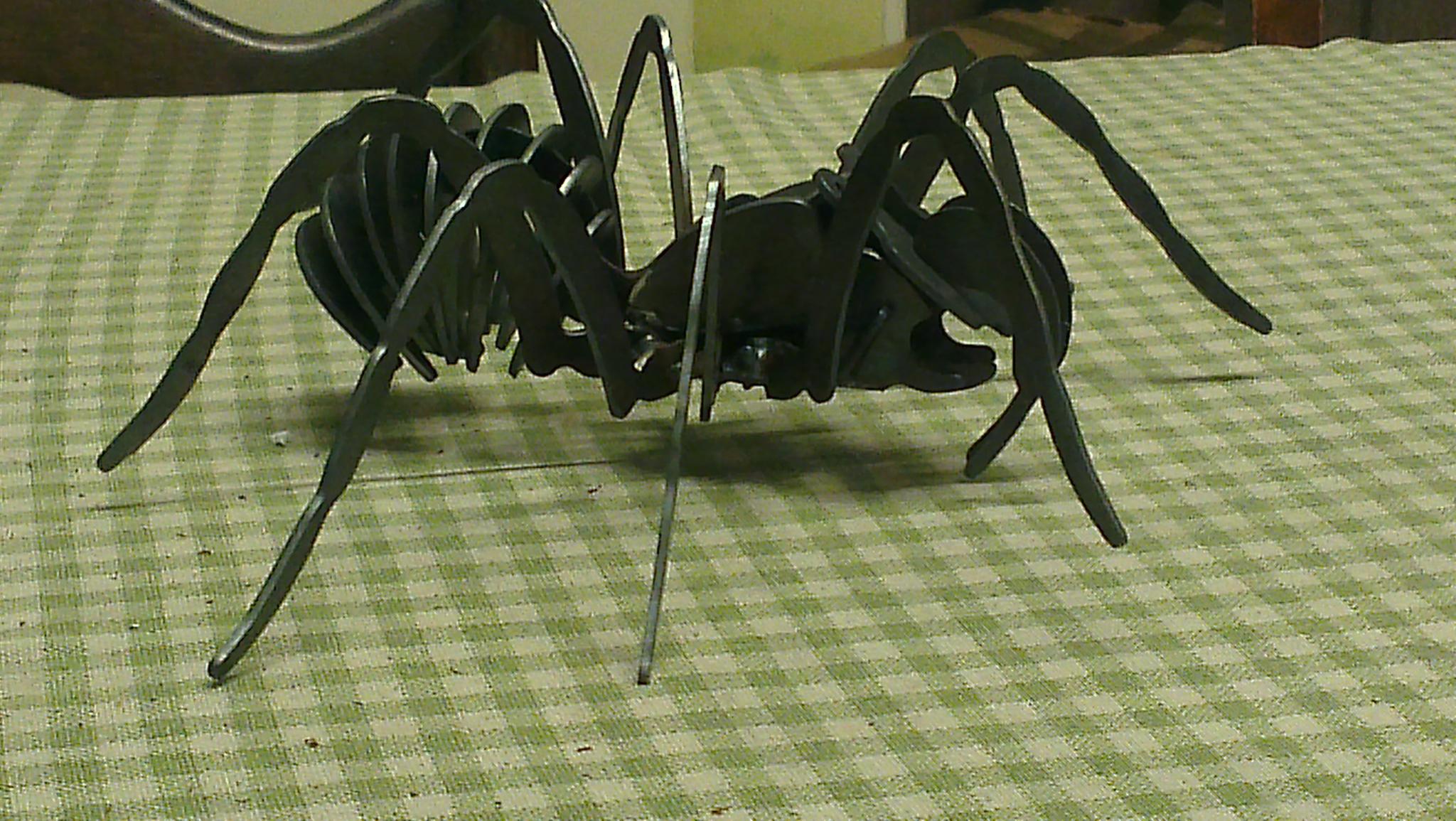

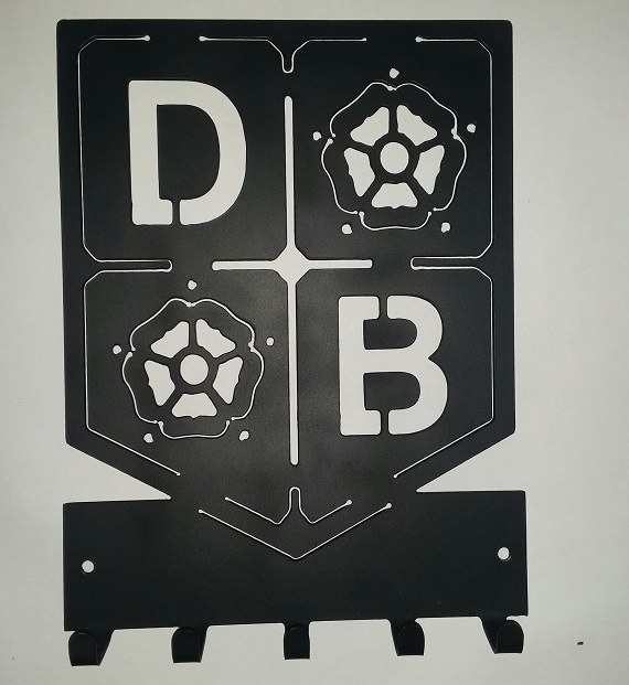

hi chaps, thought id post some of the things weve been cutting...im just starting a stretch on our narrowboat so between getting the plasma business going,keeping a roof over our heads and doing the boat it hasnt left much time for anything else....please dont think iv used to the forum to build my machine and im not giving anything back...
Attachment 21844Attachment 21845Attachment 21846Attachment 21847Attachment 21848
done countless brackets for different jobs...
Attachment 21849Attachment 21850
I like it. What sort of tolerance would you have through a 3mm steel plate? Do you do mail order?
hi robin, when i first set the table up it was doing .5mm tolerance, i havent checked it sinse as iv been doing the above sort of stuff and fabricating type brackets that dont require an engineering type toleronse...if you need anything cutting please get in touch....i stock 2mm 3mm 5mm 10mm mild steel plate...iv done a small amount in stainless steel and havent tried aluminium yet....
