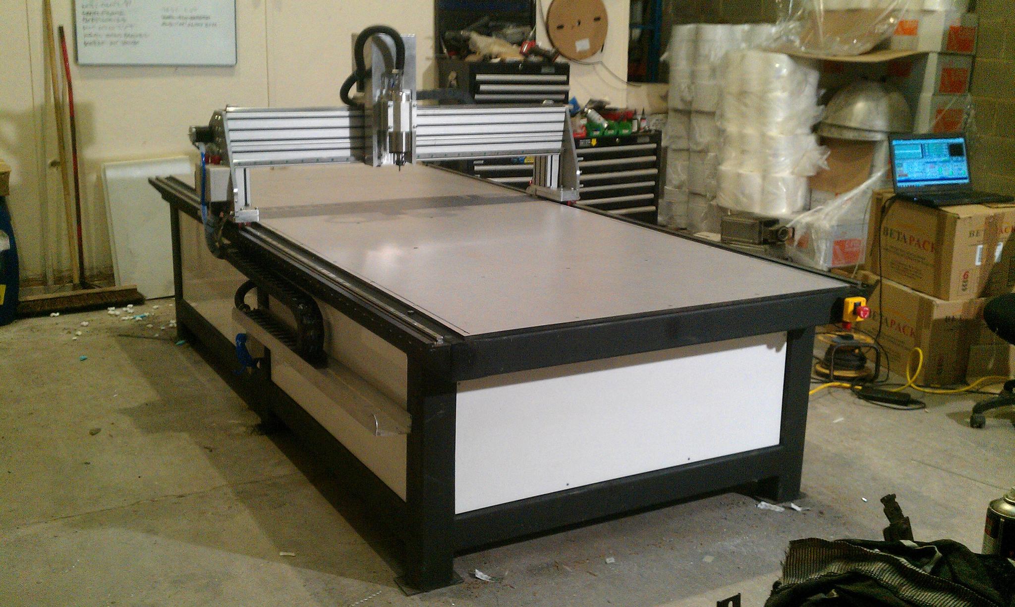

Hi Nick,
As per your pm:

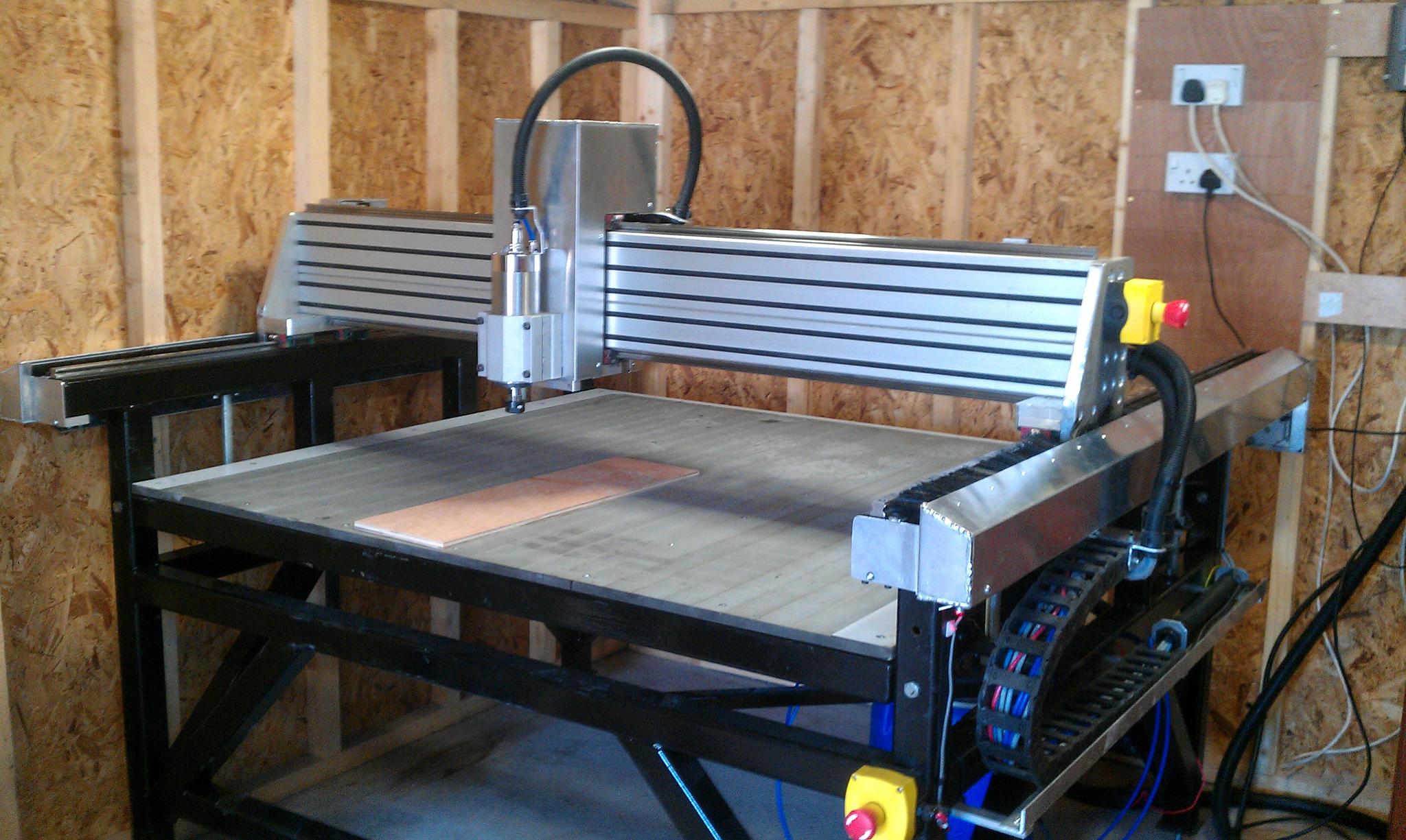

Your requirements are to cut wood, guitar bodies, and occasional aluminium.
The L shaped gantry in a pair of 90x45 extrusions has been used many times on this forum and will cut your requirements as above. At 900 mm gantry width it is starting to get a bit wide, but I would say still OK.
The raised X axis can also use 90x45 extrusion so long as there are plenty of supporting uprights connecting it back to the main bed.
Would this be good enough or should you use steel? Well, I would say you are OK to use aluminium profile on the gantry and the X axis and still cut the requirements above. If however you want to do regular aluminium cutting then I would upgrade the raised X axis sides to steel.
Here are some aluminium gantry, steel sided machines:
Attachment 22667
Attachment 22668
You wanted to use profile to avoid using epoxy leveling - well I've not found the profile extrusion to be particularly level and flat. You can buy specially machined profile, but regular stuff is not likely to be flat. If you don't want to epoxy level you can always shim the rails manually, but need a master straight edge to compare to.

I have some positive news..
Mostly ... In most-all alu designs/builds I have seen, little to no serious alu cutting has been done.
BUT..
You can later upgrade the machine stiffness, pretty easily, imho.
If You do need to, that is.
It will be perfectly feasible to drill/ream a few dowel pins, through clamped flats into the alu, and fix steel flats onto the sides of any beams.
And You can even fix them mostly by gluing .. if You use industrial epoxy glues.
And yes, they are strong enough, and no, they wont reduce rigidity.
As-is, I would not give any advice.
You have a pretty good path, and it is likely to work out very well for wood.
And with suitable parameters it will likely do some alu, with hsm toolpaths and smallish cutters.
But rigidity-needed is related to machine work-envelope size, esp. free-length ie the working length of your beam.
900 mm is pretty big.
A mechmate at 1200 mm beam is pretty close, and they are a near-professional tool, in steel, heavy and expensive to build.
In a nutshell;
looks good.
Likely to give great results in wood.
Well done.
Keep going.
If You need to, *anything* can always be upgraded.

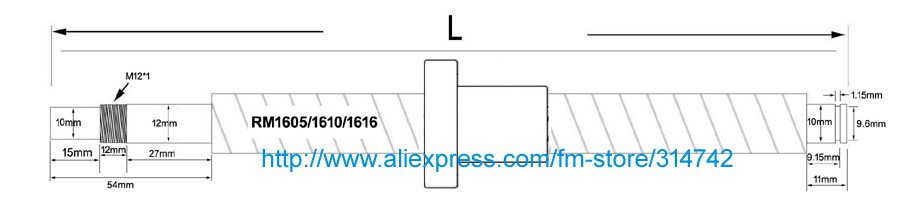

Attachment 22714
This may be of use - its the technical drawing I made when ordering my screws. The dimensions are suitable for an FK12 angular contact on the motor end and an ff12 floating bearing on the other end.

Nick time for a reality check. First you appear to be using direct couplings from the motor to the screws and then you use the above statement which to me it appears you want to use a belts and pulleys .Quote:
I will use ratio at all screws to lower the screw speed for cutting aluminium.
Re the list of the screws. Not sure why you need 2010 screws. Generally the screws don't need to be as long as the rails.
Have you done a full cad drawing to show how they will fit? You are going to spend a lot of money and certainly don't want a mistake.
The 30mm you mentioned is the F length of the screw ie just the bit that the coupling or pulley will fit on.
Thanks again for the reply Clive.
My mistake about the coupling, I do not know why I put them in the order.
I will go for pulleys and belts for space reduction, vibrations ,torgue speed change and everything else you guys have analyze here so many times, lol.
I was thinking 20 balscrew for not wiping at critical speed because of length at x axis (1200 mm) ....Am I thinking right?
I remember that,we discuss it also with Zeefleeboy but at BST Automation there is a photo that show that the length at the description is the total length.
Did I misunderstand something, maybe I have to check with Fred from BST.
Attachment 22719
OK when you quote for the screw you tell him the total length (including the F length) and say what F length you want, the standard is about 15mm but that is not enough so ask for the F length to be 30mm (this is the bit where the pulley will fit).
If you PM me your list I will format it for you so that Fred will understand it. You also have to ask for grease nipples.

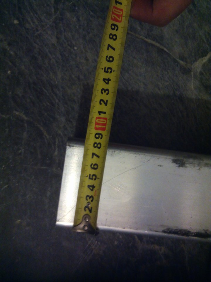

Not really an update but I have a good finding that I would like to share.
A friend of mine gave me three of those aluminium beams that he found as reinforcements in a box that had inside a big ladder !
It is like early Christmas, how can I use them at my build ?
First think that came to my mind is to cut the small square tube, the one that is weld perpendicular to the long one and use it as base for the motors and cut longitudinal the long part ,and use it as a support to L beam of Y axis?
Any thoughts ?

You know you suffer from DIYmadness when you see a use in every metal part you find :D
