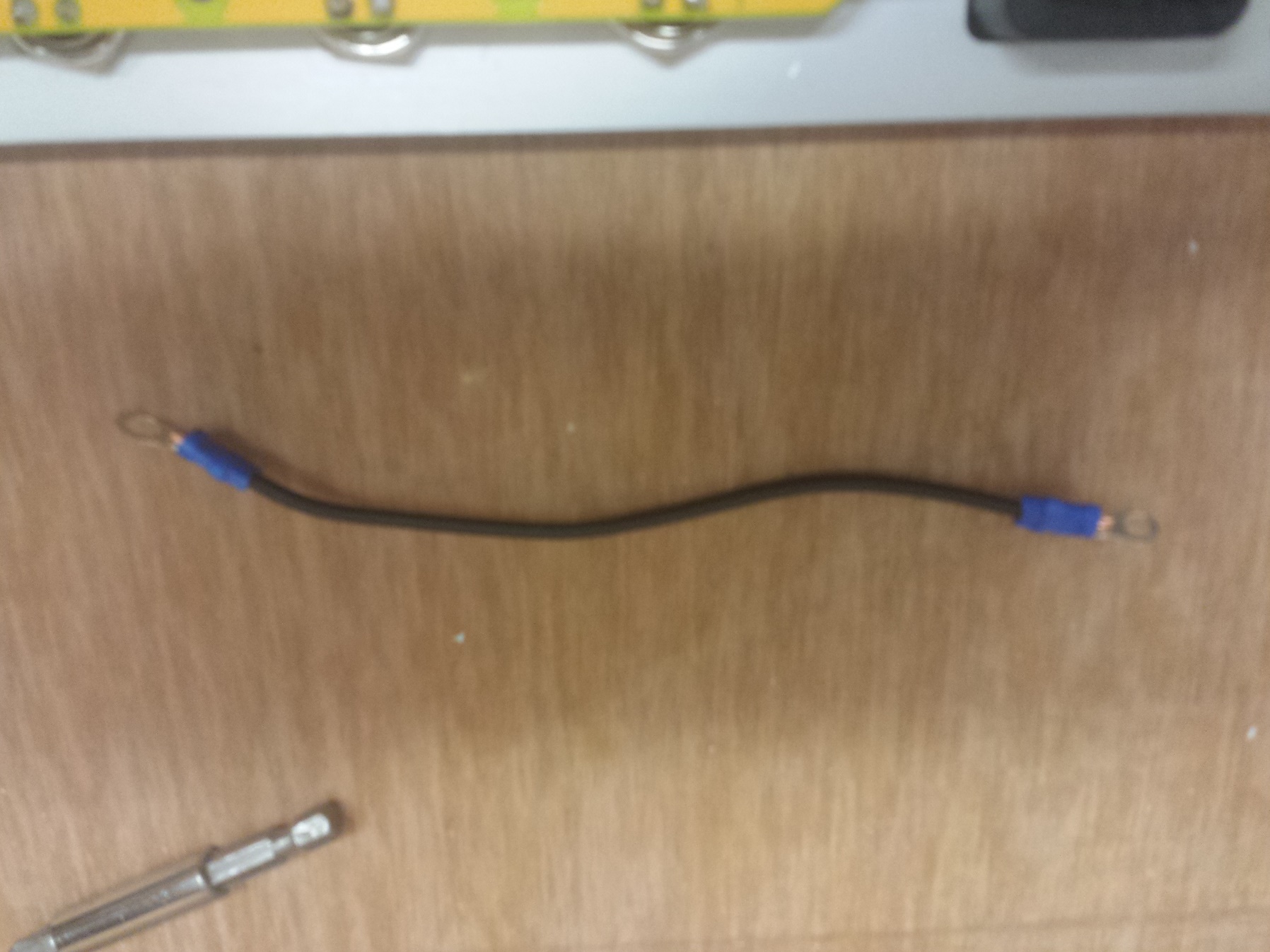

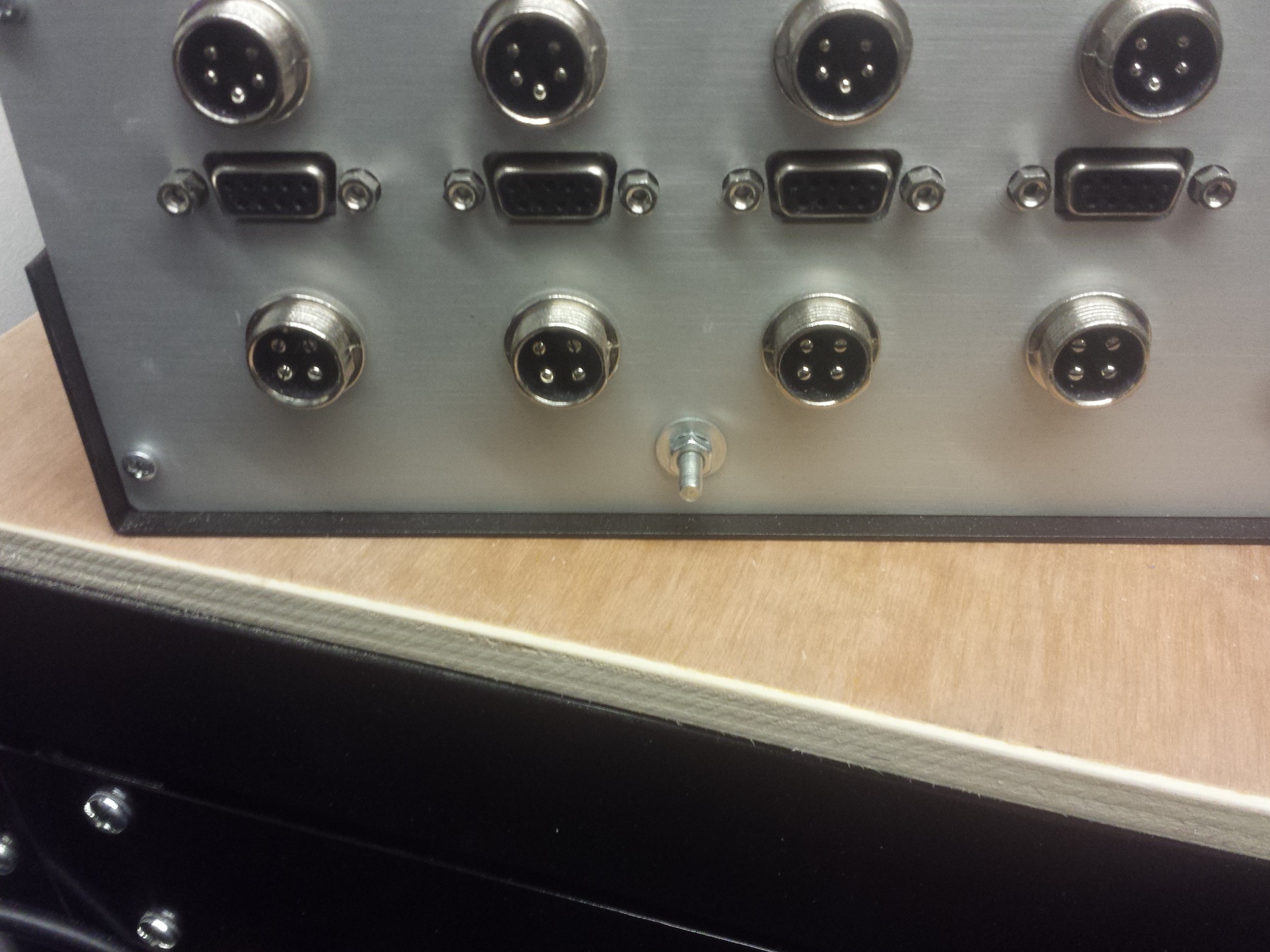

not too sure what a star point is, how do I connect it to the metal braid screening?
Printable View
here is some reading for you.
https://en.wikipedia.org/wiki/Earthing_system
Advise welcome, instructions even better. Searching is great, but is something can be answered in a simple sentence then that saves a lot of time. Will do a search now and see what I can find.
That wiki link explains a lot. Except the best way to go about physically achieving it.
I now understand what a star point is. Can I splice into each of the motor cables just to expose the outer metal braid, then solder/heatshrink a cable to it which can then me linked to a star point in the box?
the screen is just metal that picks up the noise and passes this noise back to ground as current, so as long as you have a good connection to ground that is all you need. so use your initiative and solder a wire onto the screen and connect it to gnd.
how you do it is up to you and depends on how messy you can accept.
Great Gary, I understand that. Im pretty sure I can do that nice and neat and finish off with a bit of heatshrink to keep it all covered up.
Awesome lee, instead of doing it like that I will do it a bit further back as ive got plugs on the end of my cable which connect into the planet control box. But I will put a earth point where the plugs go into the box, so there will only be a short length from the motor cable to the box for earth, should look reasonably neat. Thanks chaps for explaining in laymans terms, helped a lot. Will crack on later tonight and report back with some more pics

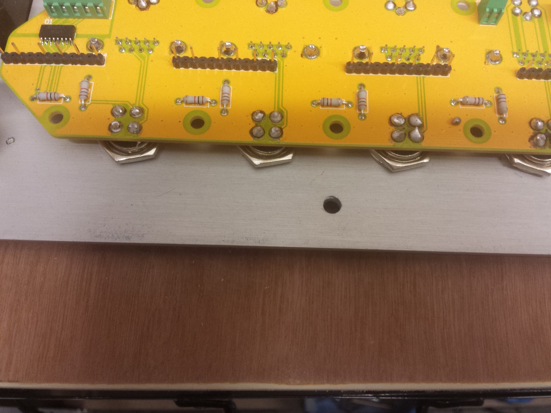

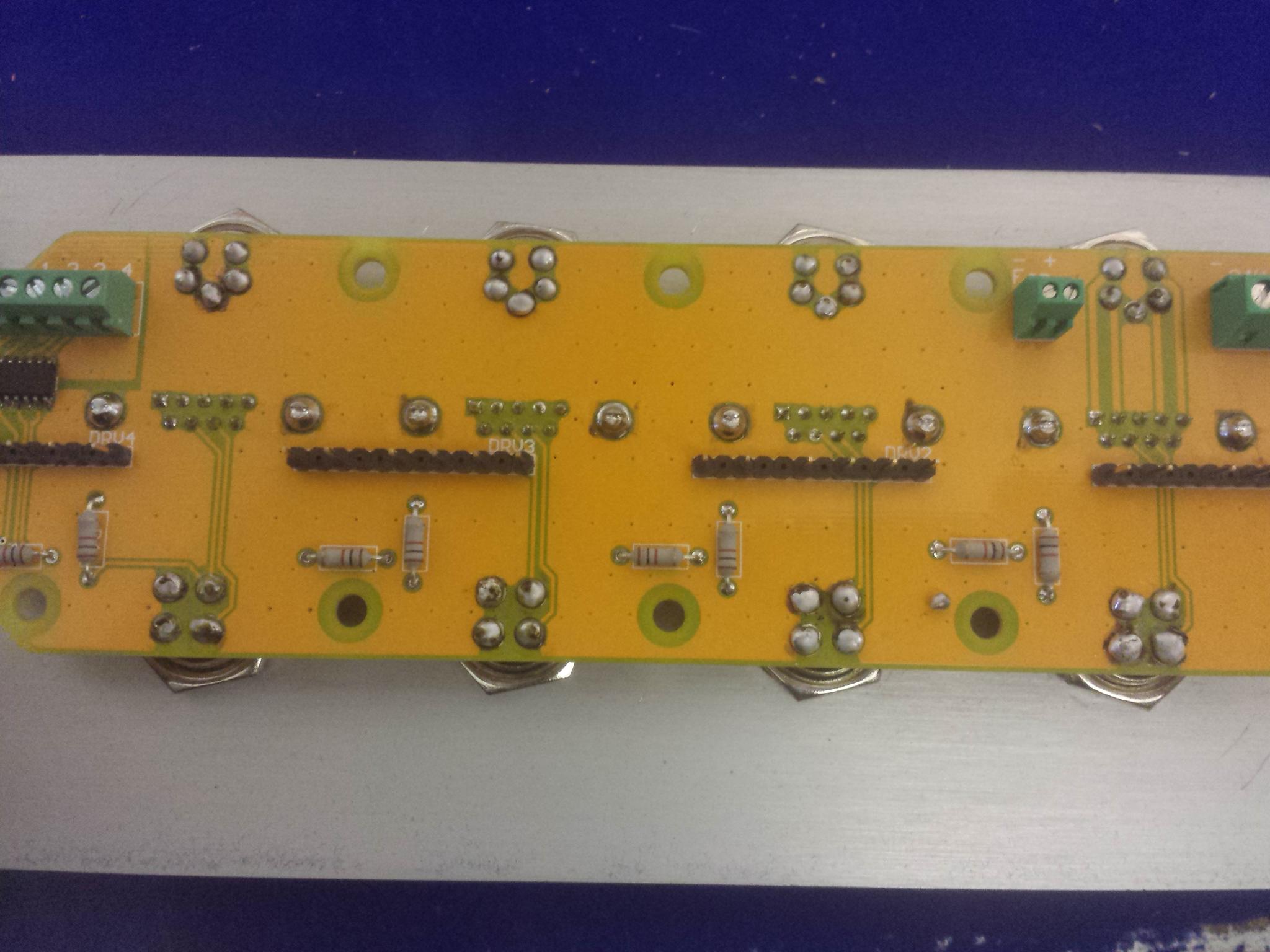

Sorry, but all the soldering joints you made looks like really bad work. I would redo this. Get a solder sucker like this...
Attachment 22344
...remove every large clump, make sure your soldering iron is not too large but is designed for the purpose and that the solder wire is thin enough, quickly melting and floating well on the surface. The surface must be clean and the tip of the soldering iron must be kept clean using the wet sponge. I clean it after each and every soldering point.
Here are a few do:s and don't:s:
Attachment 22345
You need to practice on something which is not going to be used, not something which you need later on for reliable operations. Get a magnifier and check/fix every point. You will get a lot of headache later on if you box this and start using. Even if it works now, it may fail at any time.
Thanks mate, why are they bad? in the link you sent me it stated when the older balls at the top of the connection and doesnt make contact with the metal ring on the board it is bad, but the ones I have done which are balls but they are making perfect contact with the board rings? I will revist this though just want it clarifying so I fully understand mate
solder sucker bought and arriving monday
I can't spend time marking every point, but like I said, get a good magnifying glass and have a look at each one of them. Unless they are not looking like the one marked A in that picture I posted above, you have to redo it. Most of the ones I have seen in your pictures (not only in the one I linked to) are bad. If you have a ball it means the solder wire did not melt and floated out, or there was dirt on the surface or the iron or you did not heat up the wire you solder AND the surface you solder it to and so on... Just google "how to solder" and you will find millions of answers regarding soldering with pictures and Youtube video, so I will not go into more details.
Ravi,
Just a couple of notes:
1. There is to much solder on each one
2. Get yourself some soldering flux, liquid preferable
The flux and soldering go hand in hand, when the solder "flows" better (you'll see the diffrence) because of the flux, it just works and you'll see what I mean about there being to much on each joint.
Flux isn't cheap depending on what you get, however if you get liquid flux you simply apply a very small amount, so it last's a long time.
If you keep application to a minimum you wont need to do a lot of clean up, in fact look for no-clean flux, I like to use isopropanol alcohol to clean any soldering/pcb jobs I do.

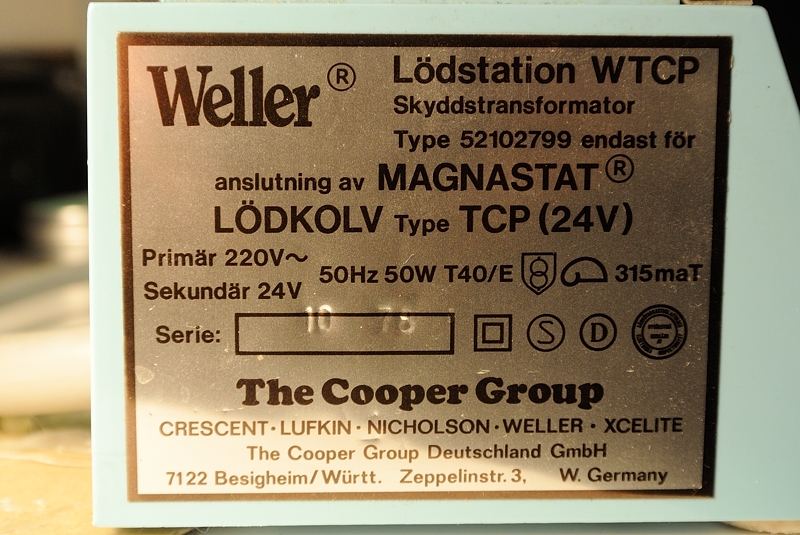

My iron is a 24v 50W Weller from 1978. It still works well. Of course, it does not have the fancy temperature regulator and display, but I never really felt any need for that.

Well I have redone the soldering, and im pretty happy with it. Its still balled up a little but the prongs stick out through the board a fair bit so didnt really have a choice as I wanted the whole of the prong covered in solder, they are very round and meet the metal contact on the board pretty much perfectly, plent of solder also flowed into the connection to begin with :-)
Before
Attachment 22414
After
Attachment 22415
singed the board coating a little but the solder had made a solid connection and like I say plent of solder has flowed into the conection

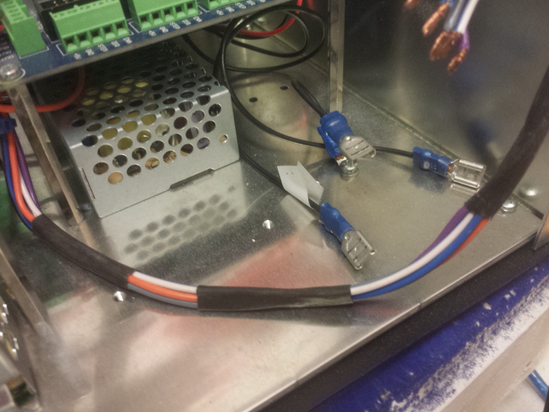

After you all explained what a star was in the box it was obvious where it was when I opened it up. I have drilled a small hole near the motor connections and linked a bolt to the star so I can attached the earthed wires from the motor cable screens to it
Attachment 22416Attachment 22417Attachment 22418Attachment 22419

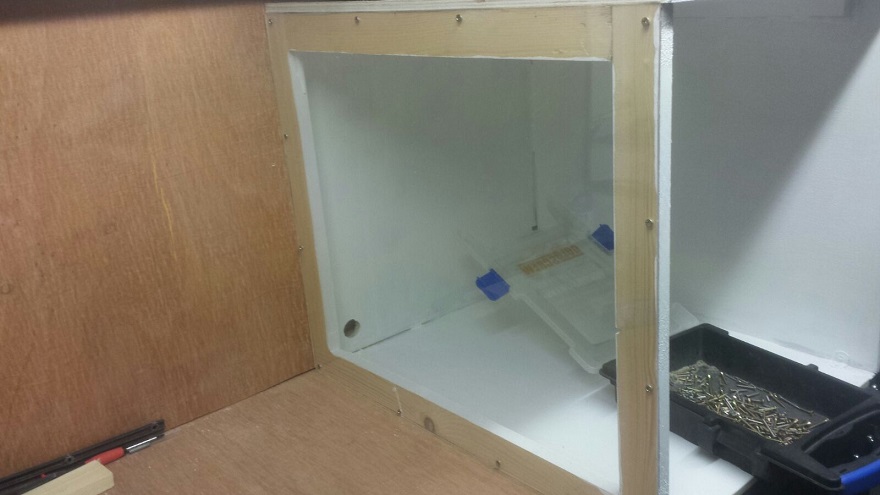

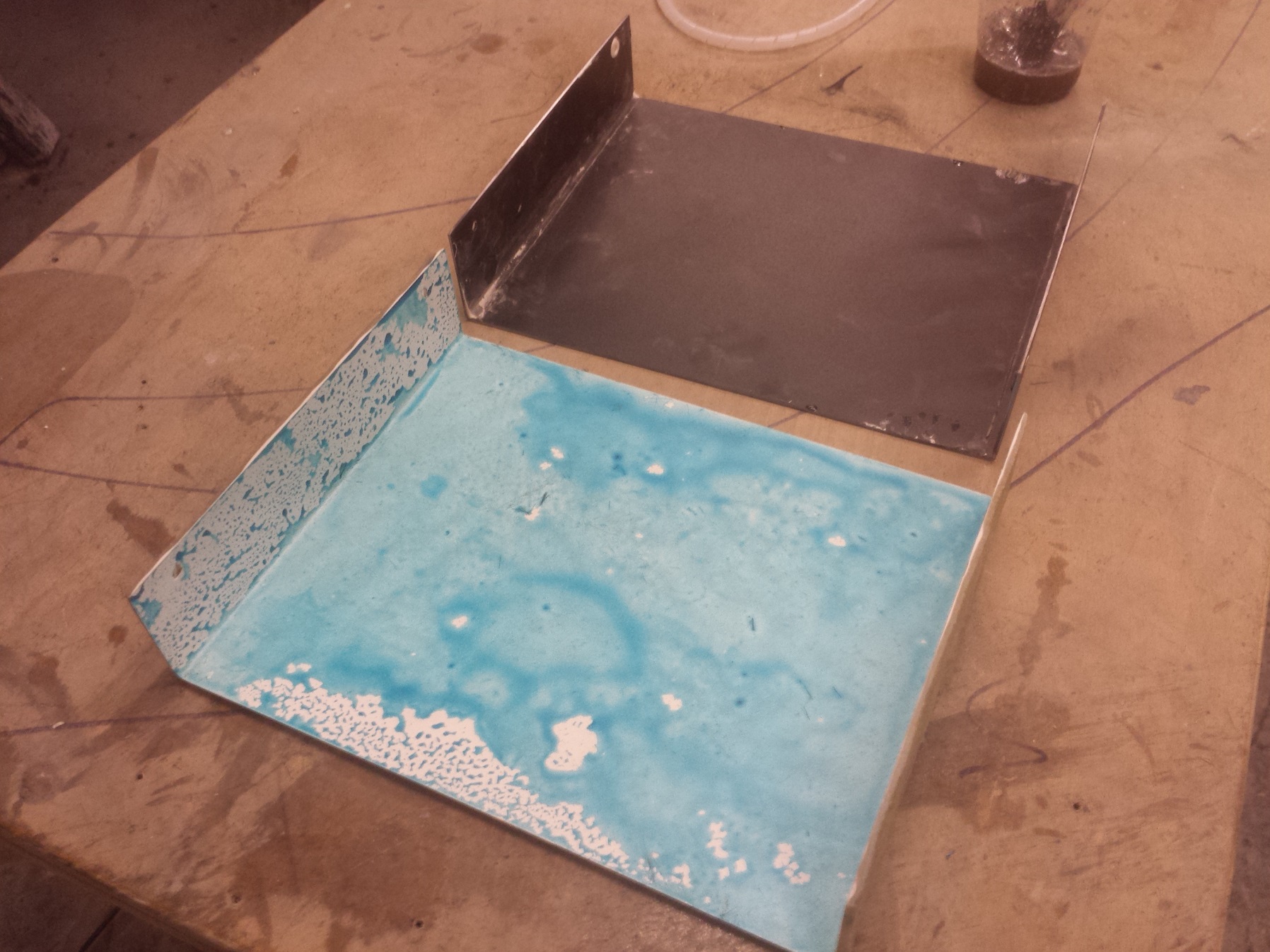

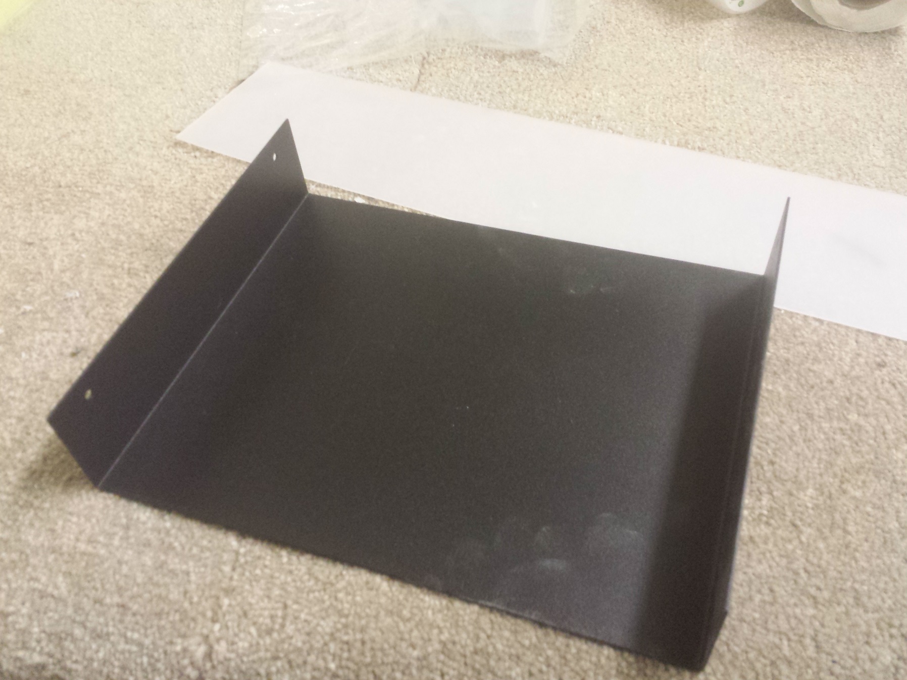

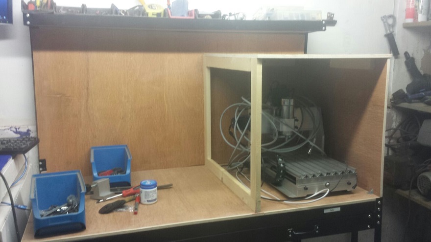

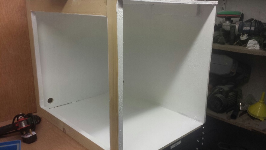

Work has been crazy busy at the moment so only been able to do a little bit on the build. I have started to create an enclosure for the machine, this will consist of a sealed unit with 2 led strip light running at the top of the enclosure front to back each side. One side of the enclosure will be perspex and and front will be a hinged perspex door. There will be an extraction system installed on the side opposite the perspex. Its a very make-shift idea but it will serve a purpose I think and help keep the area as clean as possible.
I have replaced all the wood on the workbench from cheap thin mdf to 12mm thick ply wood for stability, weight and strength.
Attachment 22433

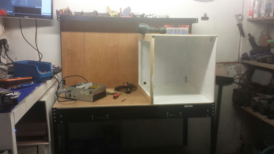

Now I have added a few coats of paint to the inside of the enclosure to aid lighting
Attachment 22434Attachment 22435
And here is the side perspex screen installed
Attachment 22436

Have you had it cutting yet?
christ no lol
waiting on some more cable track to feed the limit switch cables through, also need to solder the earths onto the motor cables, trying to run the cables as separate as possible hence the additional cable track, once the enclosure is finished I can work out the exact length of the cable so they are as short as possible.
Im not too keen on firing the machine up when its half way through installation as I know I will start making loads of stuff and just make a mess everywhere lol

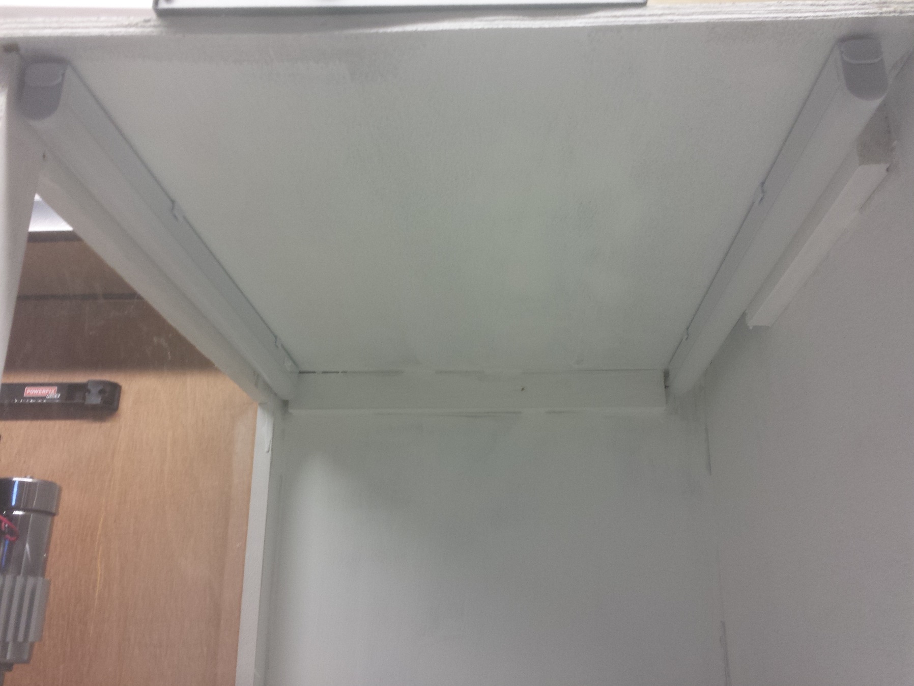

Spent a few mins last night installing the new LED strip lights inside the enclosure, just need to sort a switch out then they will be fully functional.
Attachment 22449
