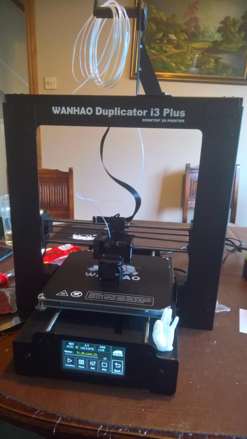

Ok so Im coming to the conclusion that I will have to build one as Id probably end up rebuilding whatever I can buy.
If i was going to buy one I think the Wanhao I3 plus looks the best as it is 24v and touch screen, that said people still upgrade the extruder and have to brace the gantry to improve stability.

Wow, i would never do that :hysterical: My printer prints non stop and why i would need to spend time watching its whats its doing, as if all is setup right it works flawlessly. last time i had a crash was when filament went from 1.75 to 2.5 at almost end of bobin...

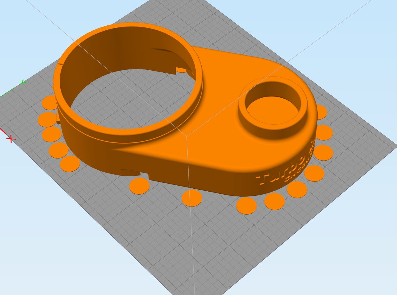

I print ABS in an enclosure, rafts and supports always. Plus some extra coins that help against lifting. PLA same. Nowadays i use mainly PETG for functional parts/ up to 70C/ .
Whatever they tell you each one of the materials lifts, shrinks and so on. I print the dust shoe from my signature and there is not even one material that it will print ok due to the specific shape, if i did not knew how to counter effect that. All else is marketing.
See example below of the coins, how i situate them, or all hacks up...

3 Attachment(s)
Re: looking for a good 3d printer
Inspired by this thread, and on a bit of a rush of blood, i decided to buy a Wanhao Duplicator i3 Plus.
http://www.ebay.co.uk/itm/Wanhao-I3-...72.m2749.l2649
It arrived yesterday :-)
I'm a total 3d print noob, so the reasons i went for this particular one are:
- Was mentioned as a good choice in this thread.
- Price, £379.
- Generally positive reviews on internet & You Tube.
Overall I'm very impressed, for the money.
As I had already watched quite a few YouTube guides, assembly & setup was a breeze.
It took me about 45 mins from the box coming through the door to starting my first print. (the 'ok' hand that comes on the SD card)
The print quality is pretty good. Again i'm more than happy with it for the money paid.

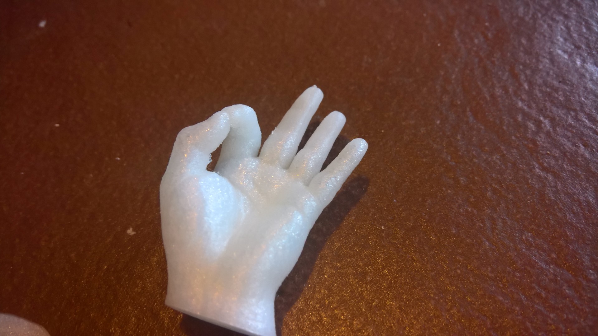

I've printed a lens cap & gimbal mount for my camera using STL files downloaded from the internet(Thingiverse) and then used Cura to generate the G-Code
It was all relatively straightforward & again very happy with results
Next step is to try some of my own stuff drawn in Fusion 360.
It's worth pointing out that I have never even seen a 3d printer 'in the flesh' before this one, so don't take my impressions as worth much. I don't have anything to compare to!
The photo's are of my first few prints. They look better in real life than in the photos! (The white plastic doesn't seem to photograph very well)
I'm stoked :thumsup:
Nice one, Kind of wishing I had just bought one now...
