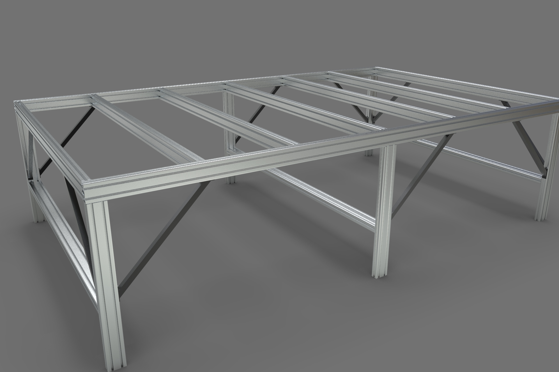

Re: welding steel base or just getting aluminium extrusion
i ain't saving any money lol not when you take into account that i need welding equipment/free standing press drill/new angle grinder/clamps/straight edges :lemo: but on the plus side ill be adding to my new workshop full off tools that will be needed in the future anyway. the frame as it stands in materials is costing me £725 and thats for 90x90x5mm mild steel
any tips on the frame guy's? also have a few question's
1. what welder do you recommend for welding 90x90x5mm steel
2. do you wait until all the frame is together before you drill holes and fill with sand
3. best method used for drilling and tapping for the linear rails
cheers

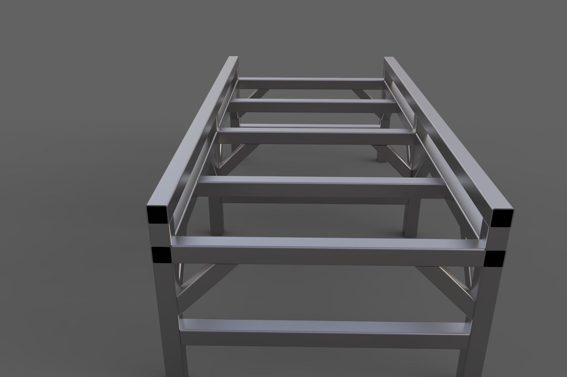

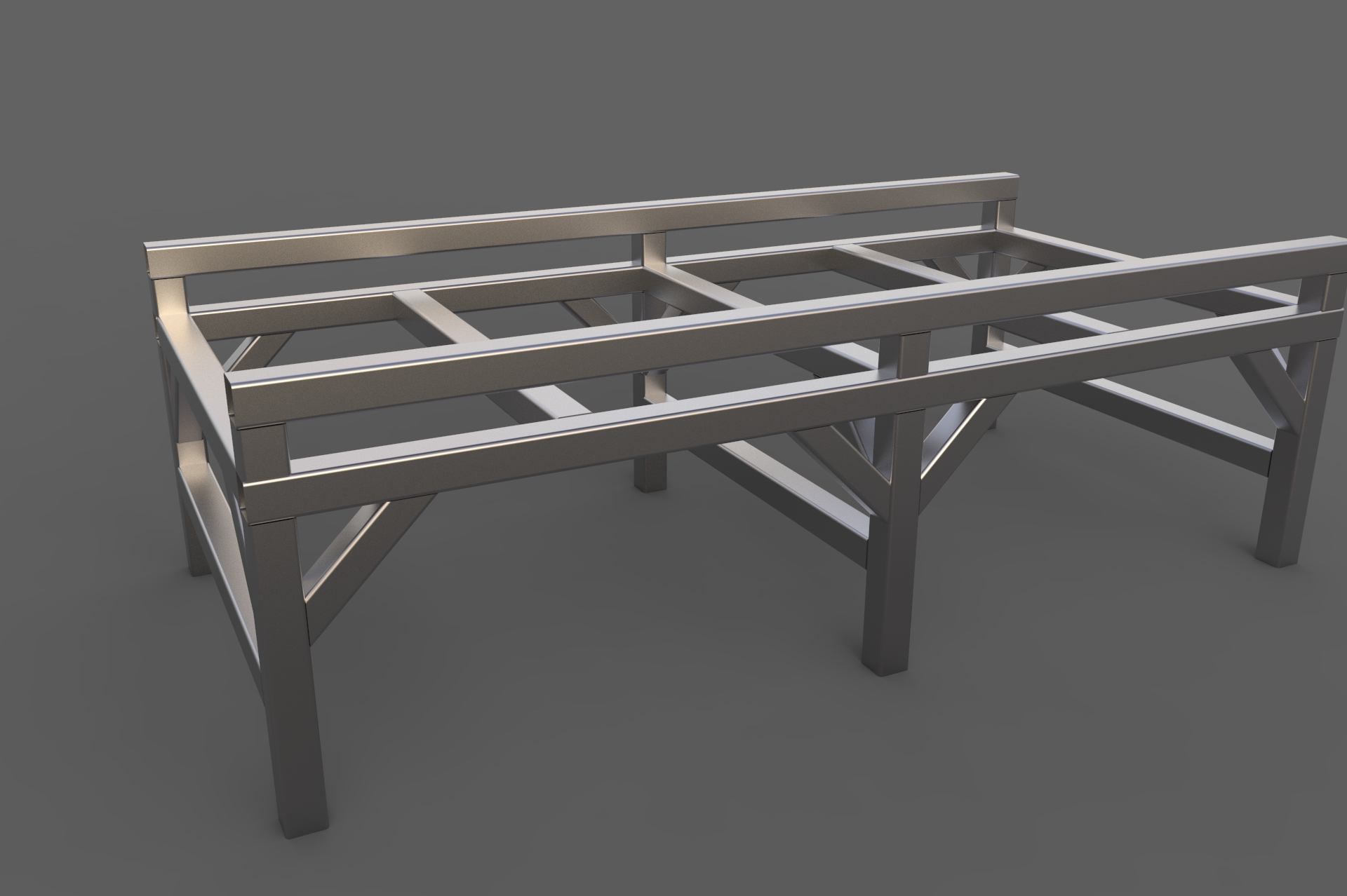

2 Attachment(s)
thanks boyan, about the frame do you think i am on the right track with the frame design? i just want to get the design nailed so i can crack on with pricing and getting required tools ect.
Attachment 23339
Attachment 23340
Weld it on as flat a surface as you can.
If I was going to do something like that, I'd be buying a big spirit level to ensure the main frame was set as level as possible to welding, and a big set square for ease of checking things are square during initial setup (I'd also be measuring corner to corner to check squareness after the initial tacks are in place).
If you order metal pre-cut, you may still have to grind it to length, as cut tolerances can be quite big (typically -0mm to + several mm).
As for welder, I'd go for something in the 150-200A range. You won't need that much capacity, but at that rating you shouldn't need to worry about duty cycle. Ideally gas MIG is better, but the cost of gas can mount up if you're using disposable bottles, and the rent on full size bottles is quite costly. There are suppliers where you can buy bottles, but you really need to find one locally, and check to see how much the gas works out to per litre (some of the schemes where you buy bottles don't fill bottles to that high a pressure, so you don't actually get much value for money).
Other option is gasless MIG using flux cored wire, but then you have to deal with flux/slag cleanup afterwards (best way to describe is, is it's pretty much ARC welding, but with a roll of wire instead of rods).

Ps I find it hard to comment on a frame without seeing it in context with the rest of the machine but on the face of it it looks pretty solid

You forgot diagonals when looking in the plan view, see here what I mean; http://www.mycncuk.com/threads/6565-...2425#post52425

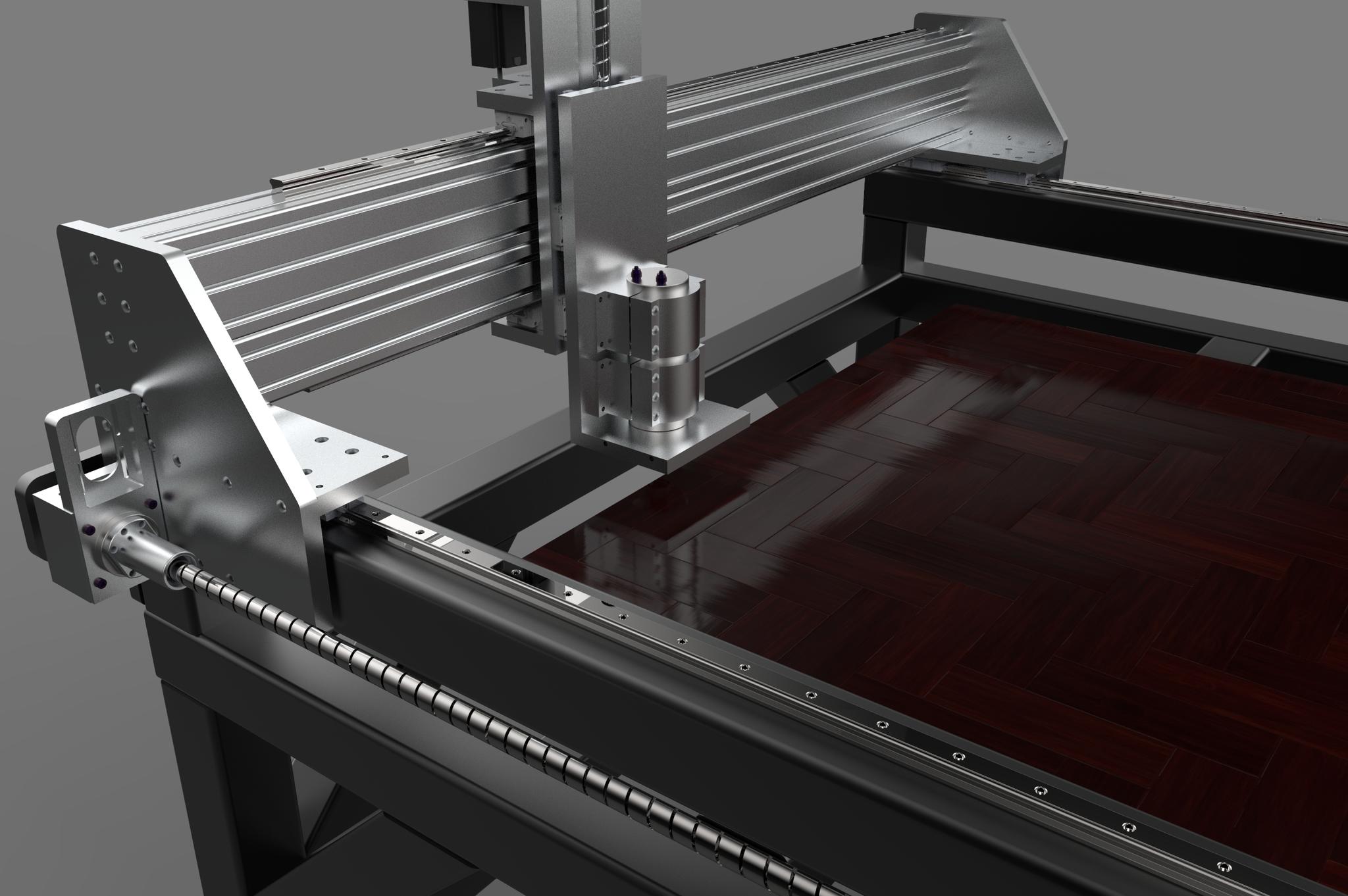

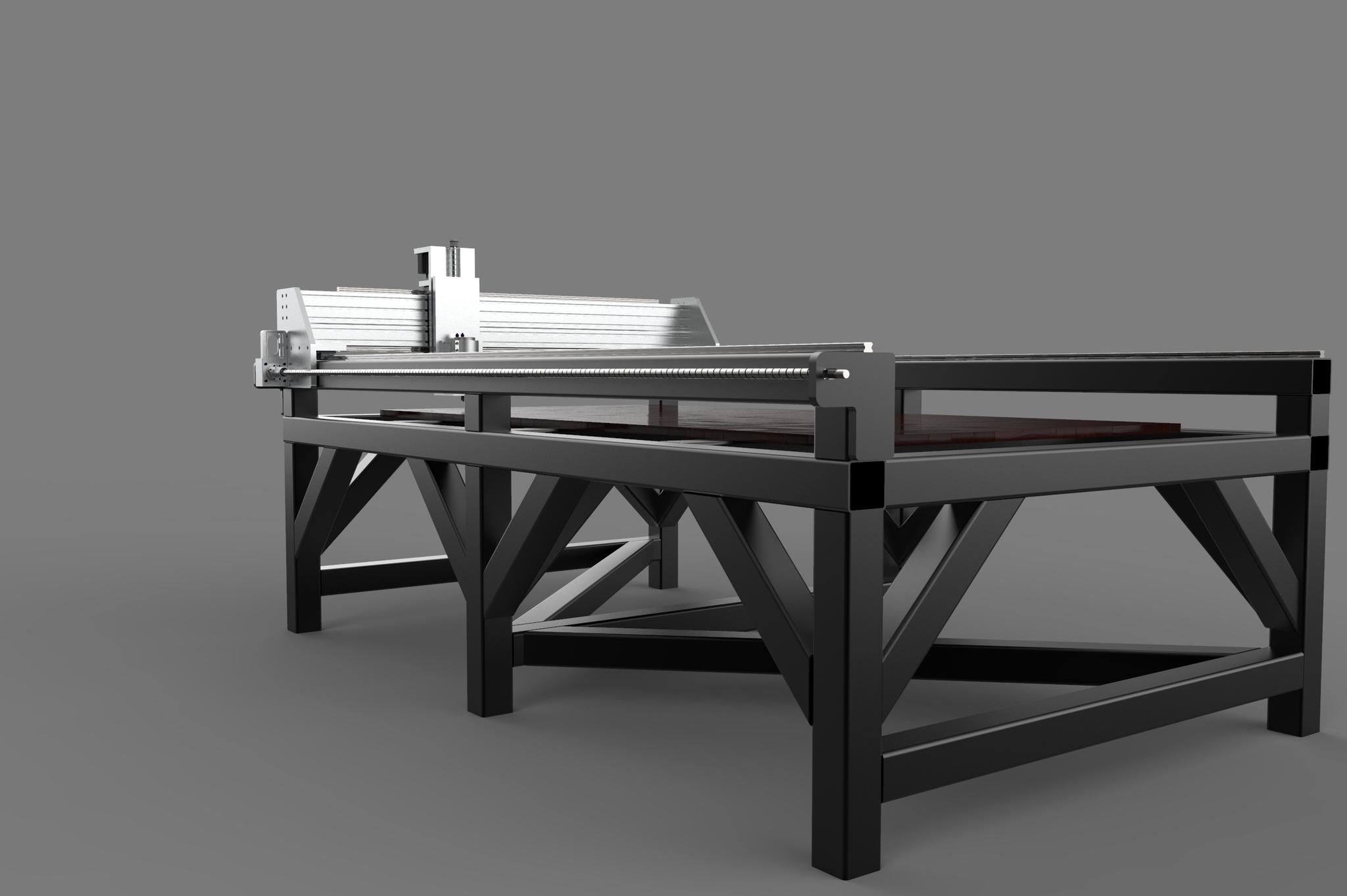

3 Attachment(s)
if only you could get the steel this clean lol, anyways i know i did this all before but ive done a few tweaks but i am a little concerned with the gantry side plates being so wide and because the aluminium gantry beam is pushed to the back it leaves a large space on the flange plates. this is because i was reading about not having the z axis over hanging and to have the gantry side plates in front of the z axis.
I have gone with 100x100x5mm all round for the frame
all plates are 20mm thick aluminium
linear rails 25mm
ballscrews r2010 driven on both sides with nema 23's 4nm and a rotating ball nut due to long 3000mm ballscrews
still thinking for the rest but whats your thoughts?

What's with the parquet bed?!
using keyshot as a quick render and was looking in the wood library and thought this looked quirky lol
Yes it looks cool! Not such a good idea in reality?! Wish I could afford keyshot, looks amazing. Btw you probably won't need two mounts for the spindle and it will make it harder to align.
you can get better results using vray in 3ds max but i can't be bothered to spend hours making materials and setting render up lol. thanks for the heads up on the mount i will remove one of them
