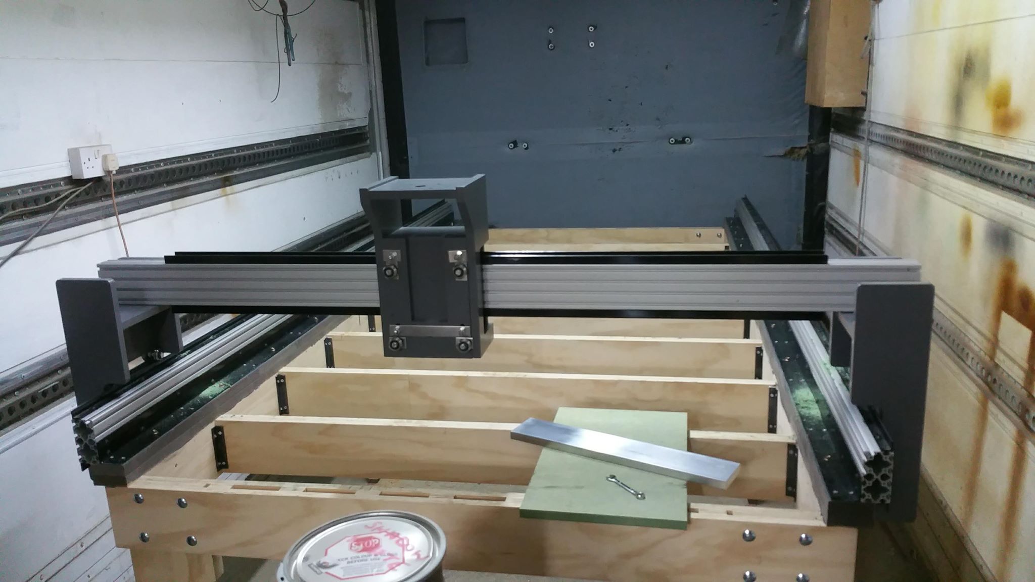

So I finally got my Z axis done
Attachment 24216
Will probably swap out the MDF that the spindle is mounted on for some Ali plate at some point.
Added end supports to the x axis mount points for added stability.

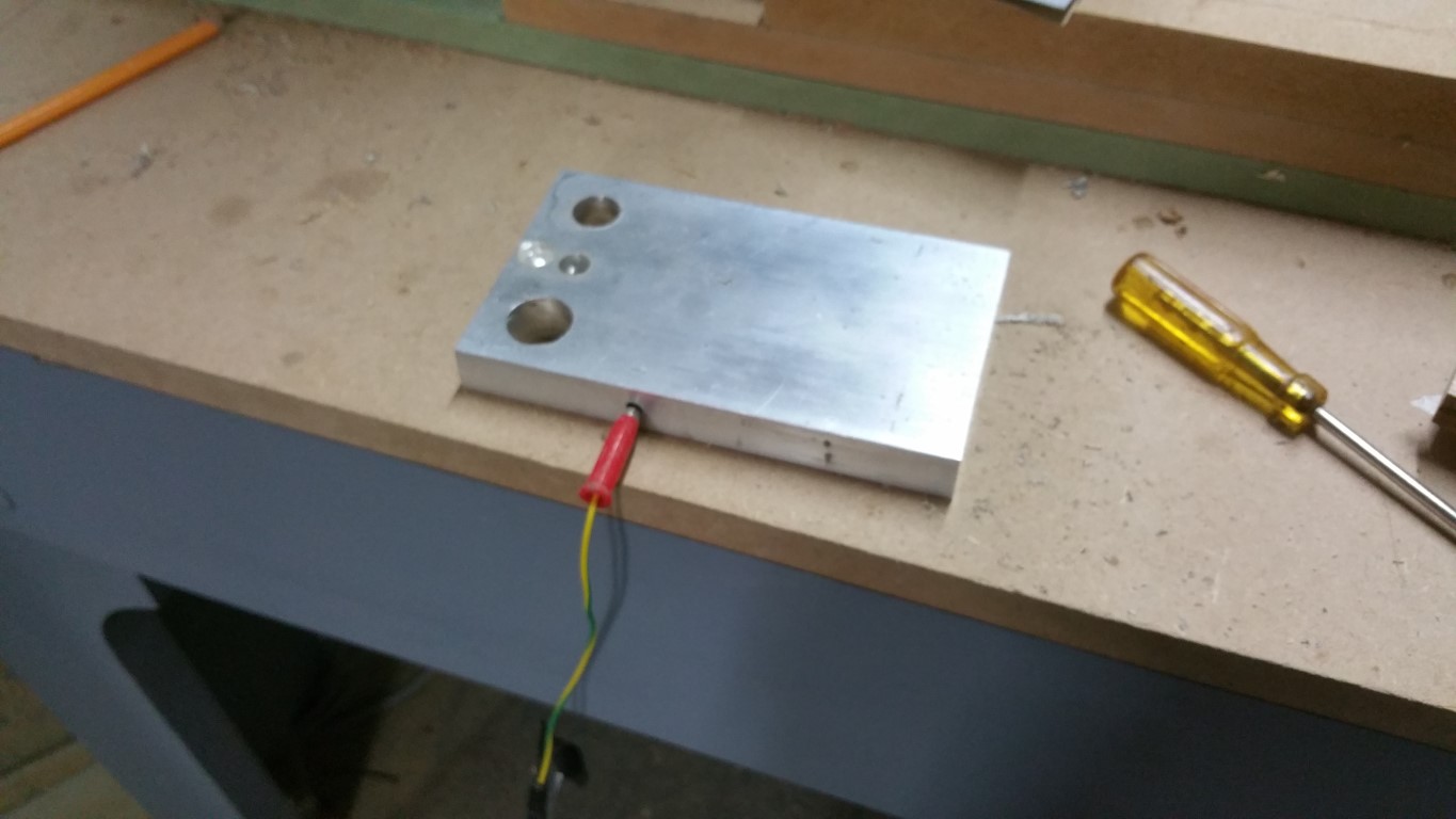

Got rid of the masking tape holding various wires and also 3d printed some mounts to hold the water pump:)
Wasn't impressed with my dust shoe so just bought one in the end and for £20 it catches all the dust so job done!
One other thing I've added is another breakout board as i ran out of inputs to add an auto Z touch off plate- so ticked that off as well- also means i can add another 5 axis if i should ever need to! lol (although a 4th axis seems fun!!)
Just an arm left to make to carry the dust hose

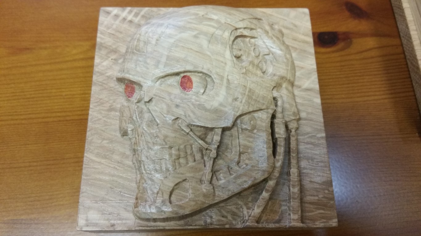

just a few things I've made so far -still learning ...or playing:)
