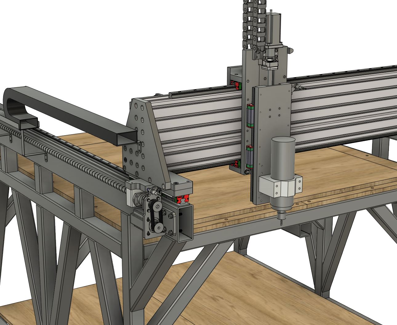

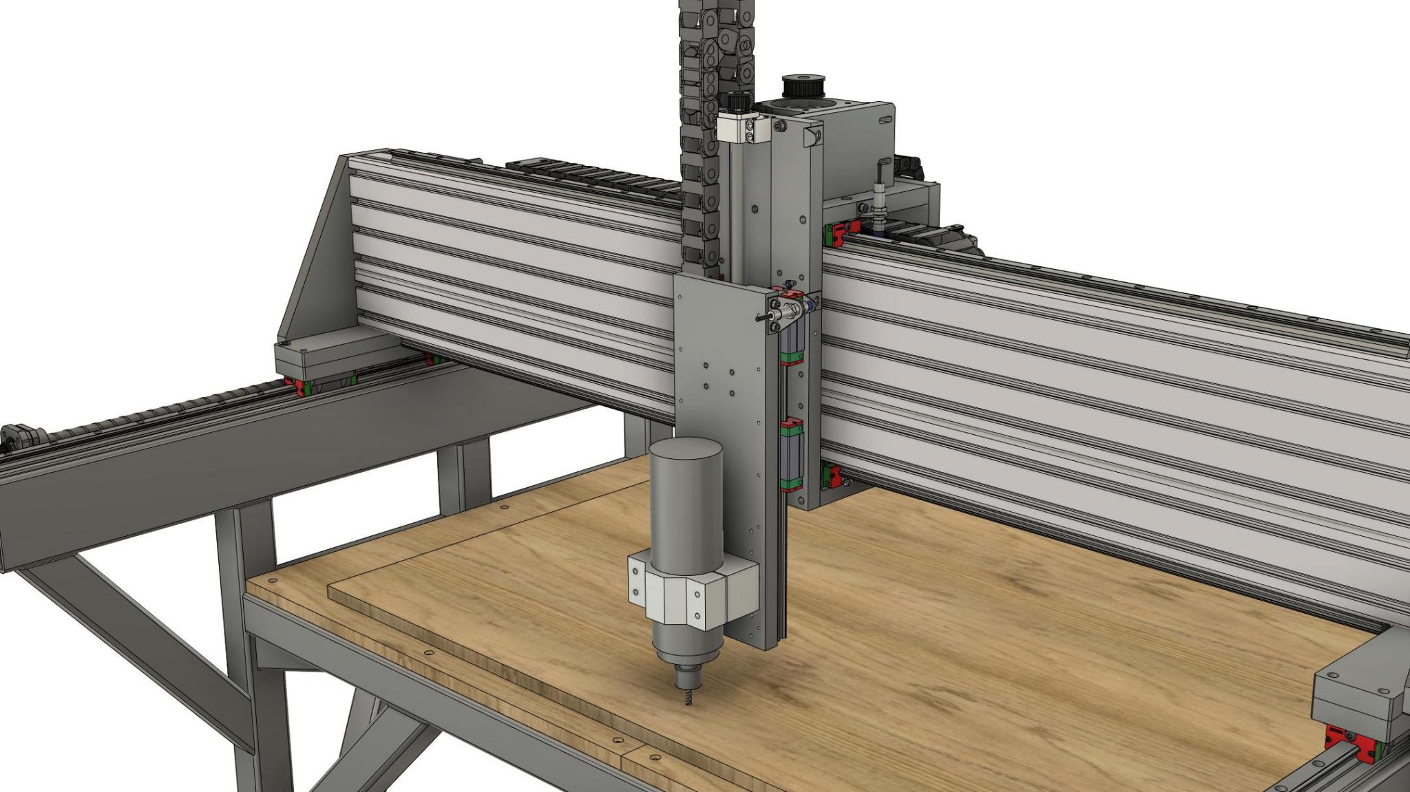

Finally some progress! This project has been rolling along slowly in between the many other things that I've had going on, thought it was about time for an update.
This is where I'm at:
x-axis:
2010 x 1480mm ballscrew geared down 2:1 from 4Nm NEMA 23 motor
2 x 20mm x 1450mm HIWIN rails + 4 x HGW20HC2R carriages
y-axis:
2 x 2010 x 1750mm ballscrews geared down 2:1 from 4Nm NEMA 23 motors
2 x 20mm x 1900mm HIWIN rails + 4 x HGW20HC2R carriages
z-axis:
1605 x 412mm ballscrew geared 1:1 from 4Nm NEMA 23 motor
2 x 20mm X 400mm HIWIN rails + 4 x HGH20HCA1R carriages
Frame:
The frame is a mixture of 60 x 60 x 5 and 60 x 120 x 5, possibly overkill with the bracing so might think about simplifying it a bit.
I am planning to use a strip of steel with rivnuts to secure the y rails to the frame rather than tapping the frame - thought this would give a bit more adjustment.
Gantry:
2 x 160mm x 80mm in L configuration
Intermediate mounting plates for squaring the x & y axis
I'm at the point now that I really need to tie down some key components so that I can finish detailing everything and have a few questions for the hive mind:
Motors - Are the CNC4YOU 4Nm NEMA 23s the way to go for all 4 motors? Electronics is definitely not my strong point, I'm going to need a lot of help to get through that part of the project!
Pulleys - are HTD5 the ones to go for? I've modelled up 14T & 28T (copied from Joe's amazing design) and there are a couple of things I'm not so happy about. Firstly the motor shaft is not long enough for the pulley when using one with a boss, it overhangs the end which doesn't seem ideal. The alternative is to use a pulley where the grub screw is on the toothed part and it seems like that will munch through the belt as it rotates - anyone got experience of this pulley type? My second concern is fitting the smaller pulley onto the 20mm ballscrew - the shaft is nominally 12mm which looks too big for the pulley to fit, turning the ballscrew down to 8mm or so seems like it might be too weak? The alternative to this is increasing pulley sizes which will make the motor pulley quite large.
Cable chains - What size do I need (I'll be using a water cooled spindle)? Should I use the same size for all 3 chains or should they get progressively smaller?
I appreciate all the help, cheers!

Why are you gearing 2:1 if using a 10mm pitch.? It's not required and would actually be detrimental to the machine as it will be slow. If you are trying to lower the screw speed then go with a 20mm pitch and then use the 2:1 ratio, this will give the same travel velocity as 10mm but with half the screw speed.
If not lowering the screw speed just go with a 1:1 ratio with a 10mm pitch.
Yes, they will work but if you are going to this trouble then I would go with Closed-loop steppers as the price difference isn't massive and they are much more accurate.
Also, it's not just the motors you need to decide on, the drives which control them and the voltage you run them at are important. Don't go with any drives that are rated, 50Vdc Max. To get the best from 4Nm motors you'll want to be running them around 60-65Vdc or 50Vac if the drives support AC voltage which many do these days. You also need a safety margin on the drive's Max voltage or around 10%, so if using 60Vdc you want drives with a max voltage of 70Vdc or more.
HTD 5 x 15mm wide is perfect for this job.
Regards the grub screws then turn the Boss inwards so it's on the shaft if possible, if not then it's ok to drill between the teeth provided you remove any burrs. However, you say you are putting the small pulley on the screw.? You have this the wrong way around, you want the small pulley on the motor and the large pulley on the screw if you want 2:1 ratio.
Larger is better, the worst thing you can do is use too narrow cable chains and have the cables rubbing against each other, worse still if your running noisy cables like the spindle cable with signal cables like limits, etc, which you will be.
You also don't need 3 chains, on the machines I build I only fit chains on X-axis and Y-axis, the Z-axis which is mostly just the spindle cable and water pipes, I run thru flexible conduit.
The energy chain I supply has internal dimensions of 25 x 58mm.
This pic shows the flexible conduit and energy chain, there is the same chain at the rear of the gantry.

Hi Jazz, thanks for the reply, I appreciate the help.
I thought I'd read about gearing the motor / ballscrew to lower the screw speed to prevent whip whilst keeping the motor running at it's most efficient speed? Maybe I've got it all wrong. So 1:1 is the way to go is it?
As I mentioned the electronics side of things is really not my strong side, the more I read about it the more lost I get. Could you point me in the direction of some suitable closed loop steppers? I've had a look but they seem to be around £200 each? I had been thinking of going with a UCCNC ethernet controller, is this a good option? Do closed loop steppers need a different controller & drives?
I had put the big pulley on the motor based on what Joe did in his video: https://www.youtube.com/watch?v=gQz9G_Dlv3w about 45 seconds in.
The cable chains I have modelled are 50 x 17.5 internal - I'll increase this to 25 x 58mm as you suggest.
Thanks again :beer:
Yes this correct but the way you had it was doing the opposite, this would double the screw speed not half it.
The reason Joe used a large pulley on the motor with a small one on the screw was to increase the speed because he only had 5mm pitch ball-screws. So he needed the 1:2 ratio to get the extra speed but in doing so he doubled the screw speed which increases the chance for the whip.
As the above demonstrates, Be careful with blindly following someone else's component choice or build thread if you don't fully understand what or why these have been used.?
It's very easy to select the wrong components and end up with an unbalanced machine or worse completley unusable machine.!

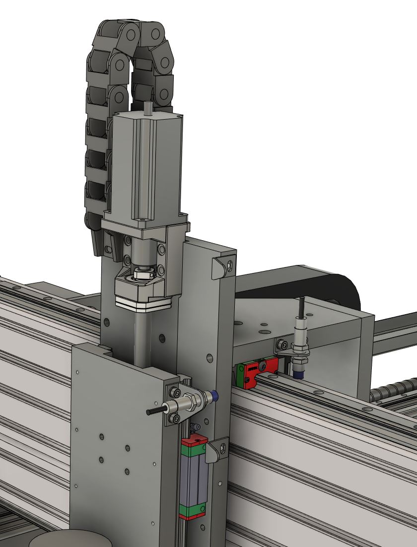

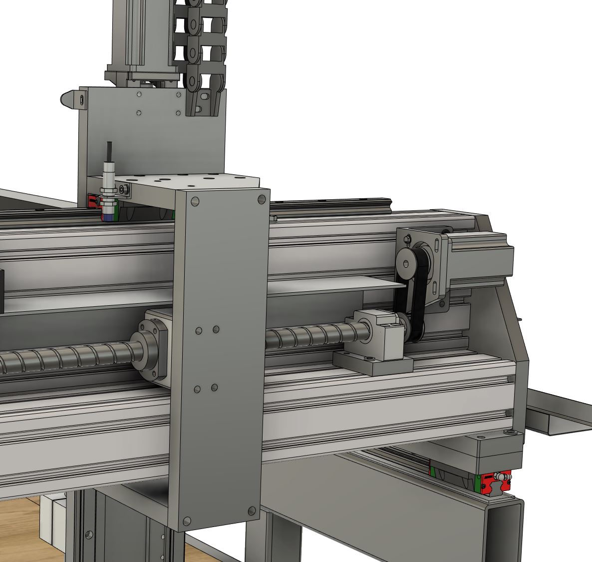

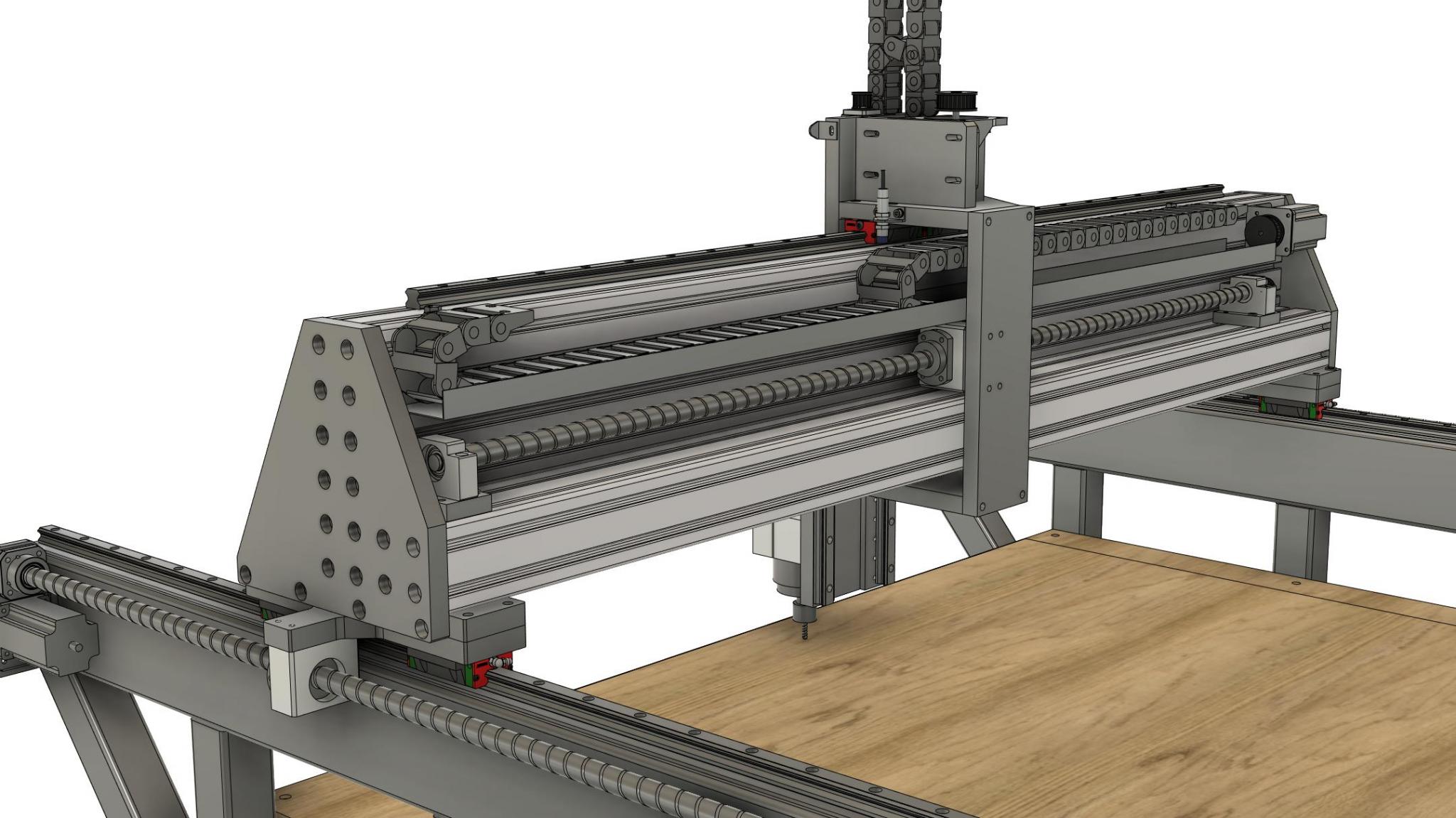

I've made a bit more progress on the design......
I have removed the gear reductions, now the x & y axes are geared 1:1 with 20T pulleys and the z is direct drive. I am still working with the 4Nm Nema 23s on all axes.
I have also tidied up the end stops and proximity sensors.
The x & y cable chains now have inner dims of 25 x 57mm (I couldn't find 25 x 58mm).
Think I'm nearly there with the mechanical design, soon be time to concentrate on the electronics - not looking forward to that one!
:beer:
Attachment 29768Attachment 29769Attachment 29770Attachment 29771
Looks good to me. The only thing I would point out is that you have the proximity sensor end-on. There's very little room for deceleration between detecting the gantry and being smashed by it. A safer option is to have the sensor pointing uipwards so that it detects the gantry riding above it. You already have a non-smashable mechanical end-stop in case that fails.
Kit
That’s a fair point, I’ll look at moving them through 90 degrees. Thanks!
I personally would turn the Z axis sensor the other way round ie. fit it on the back plate. This will make the cable neater.
You could just drill the back plate.
Thinking about it, I think the reason I didn’t do this is because the sensor would have to be where the lower target thingy is now and there isn’t enough depth to fit it between the gantry and z plate. Unless I’ve misunderstood what you’re suggesting?
I haven’t looked at the data sheet for the sensor but. I’d assumed that it would be triggered 2 or 3mm before contact and I could then have the hard stop almost flush with the sensor z. How much overrun should I allow for? I guess when it’s travelling at speed something like 5-10mm would be better?
You need about the same length as a piece of string! All depends on the weight of the gantry, your approach speed for homing (crashes at rapid speed will hopefully be avoided by soft limits once the machine is homed which is the first thing you will do after switching it on) and some stuff to do with drivers that other regulars will understand better than me.
Your Z and other axis (it's Y on my machine but X on many) sensors are right. In practice the overlap of the sensor and your target will not be very much when it triggers. I put slots in the mountings of my targets to make things adjustable but this does increase the risk of something moving and messing up the repeatability of homing.
Kit
The distance is determined by the sensor spec, if using just for homes then 2-3mm won't be a problem but if using for limits then usually you will be traveling at fairly high velocity when tripped so the inertia will easily travel 1-2mm if at high feeds.
Also, the accuracy and sensitivity are affected by distance, so it's best to keep the distance on the smaller side of the sensor spec. This way it will react faster but obviously if end on you have less room to stop. 90deg is a much safer setup.

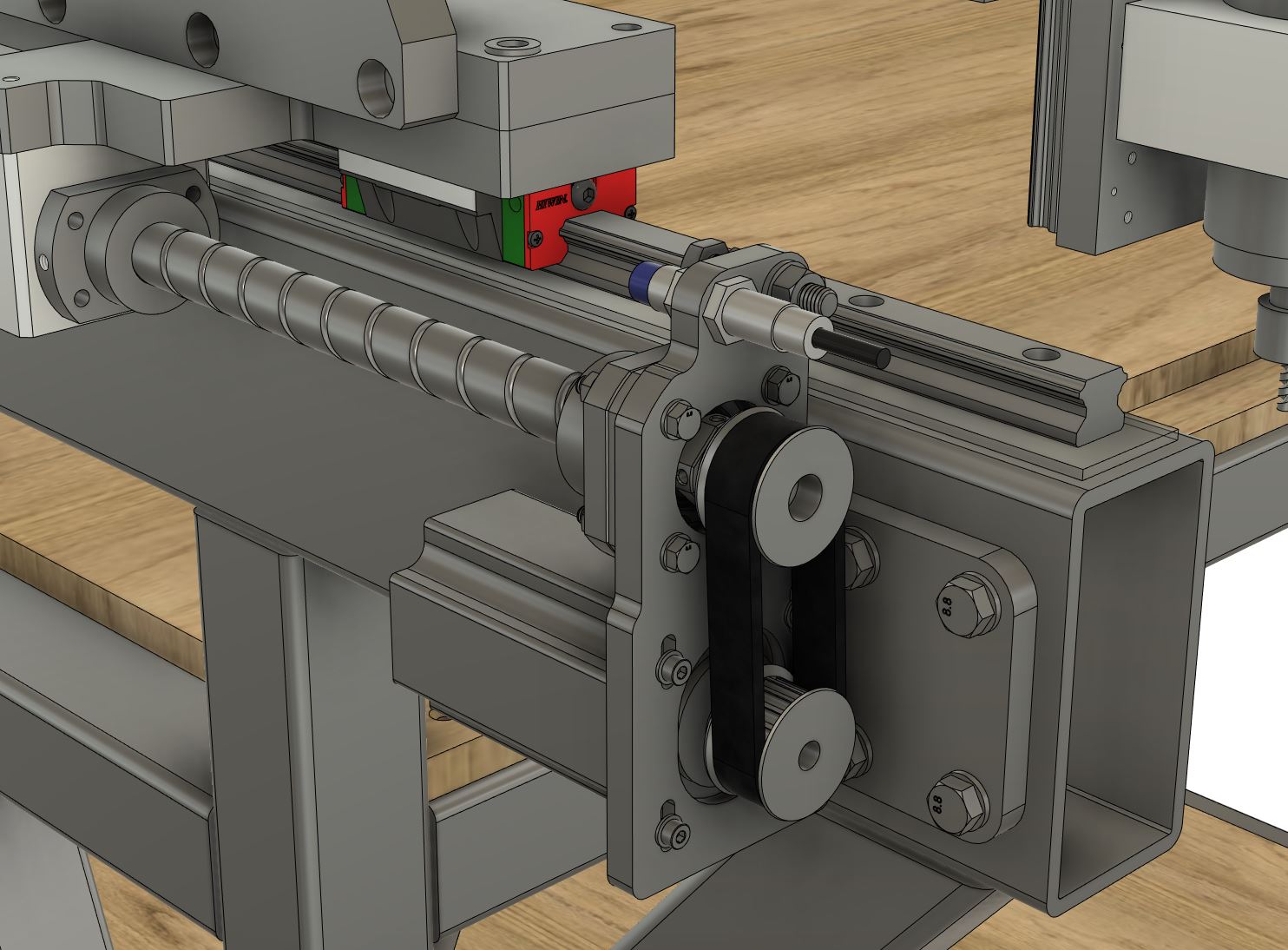

Finally got around to sorting the proximity sensor bracket:
Attachment 30001
I think I'm finally there with the design, still need to finalise the motor choice and sort out some sort of levelling feet - can't decide whether to add levelling casters, they're pretty expensive but probably worth the money if I ever need to move the machine. At the minute I've just got M12 nuts welded on to the base of each leg - they look a little small to me but it seems M12 feet are good for 1000kg each - should be enough!
Attachment 30002
I made some steel discs as targets for mine as the sensor will be more sensitive than on aluminium, but both will work.

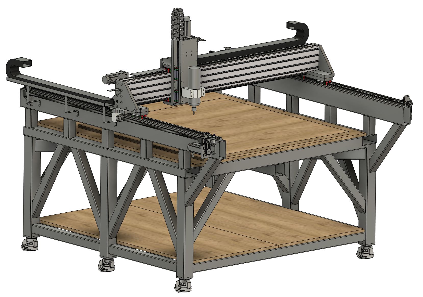

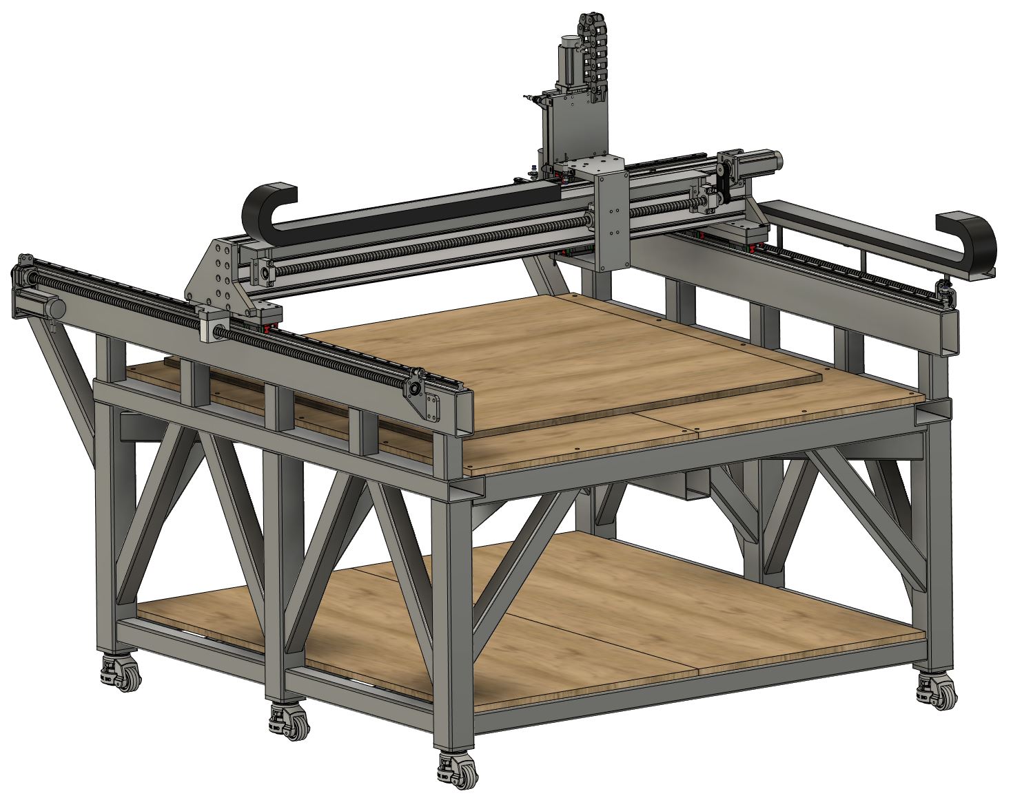

I have reworked my frame to include the 80 x 80 x 3 that I have, I used it on the machine bed and the main uprights - I figured the bigger second moment of area compared to 60 x 60 x 5 would make these parts stronger. The frame now looks like this:
Attachment 30747
Attachment 30748
Attachment 30749
Attachment 30750
I am also pondering whether to have just a single aluminium extrusion for the gantry to save a bit of money. I can see that it adds a lot to the stiffness to the gantry but £500 each piece is a big investment. I have seen people get pretty good results on lesser machines with far smaller gantry sections. For example a single 160x80 section has a second moment of area 22x greater than a gantry made from C-beam. I'm not 100% convinced the extra cost will result in a significantly better machine - interested to hear what people think of this?
This is how the machine looks now:
Attachment 30751
Attachment 30752
