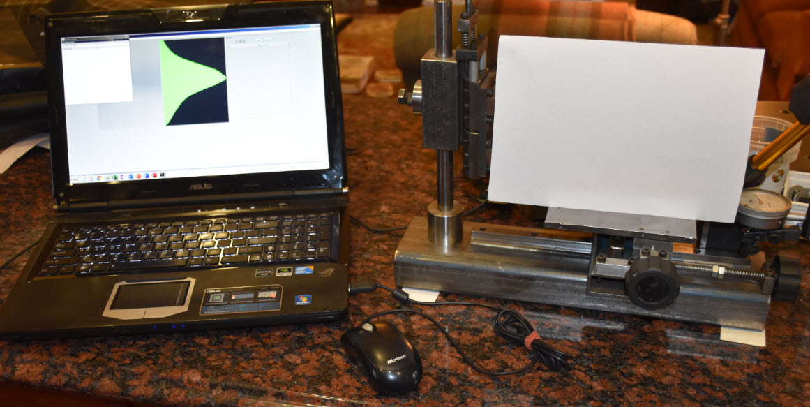

3 Attachment(s)
Re: DIY Laser levelling using webcam and laser level
Hi Devmonkey
Hi All
First tests!
Today I set up a quick test to determine what sort of accuracy might be achieved using a Webcam and laser.
I mounted the webcam on a linear rail slide, I was going to use gauge blocks against a stop to measure the resolution of the device using a cheap laser that I picked up from Aldi one day. it is the only line laser I have. That did not work because the hard plastic ends on the linear rails were too flexible, I could not get constant results.....
The Webcam is a 640 x 480 resolution Microsoft LifeCam VX -1000. It has an adjustable lens that I was unable to remove quickly so I just used it as is! Pointing the laser directly at the camera produced horrible flare. However angling the camera did work! I am not sure why? Probably something to do with the lens. The next tests will be done without a lens.
I think you could say that the tests were a bit of a comedy of errors!
Fortunately I has also set a magnetic base 0.01mm indicator on the rail. It saved the day. By simply pressing on the linear slide I was able to move the slide laterally about 0.04mm with medium pressure. when i released the pressure the indicator went back to zero. This is all I needed...
Now for the exciting part; Hidden at the bottom of the Gaussian graph there is a tiny numeric value, It followed my indicator movement when I moved the slide. very roughly a value of 1 to 4 on the graph value to 1 to 4 ticks on the 0.01mm indicator. I assume this correlation may not have been planned however with the particular camera I used it was very convenient.
I ran the test several times and it was repeatable.
0.01mm is equal to .00039" (about 4 tenths)
A very good result from a crude setup.
The following improvements will no doubt greatly improve the results.
A better camera with the lens removed.
Controlled ambient light. moving around the room can move the graph also sunlight entering the room moved the graph.
The sensor needs to be shaded as much as possible.
The numeric values at the bottom of the screen needs to be enlarged. Optional rounding and time averaging settings that can be applied to the displayed number would help to reduce the flicker.
I have yet to test the device with wire.

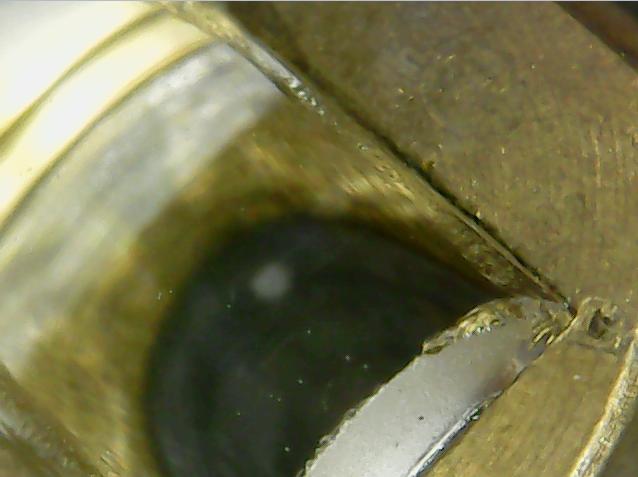

2 Attachment(s)
Hi John,
I'm just using a bog standard Dewalt laser level, part number DW088.
I'm curious, the laser you have, how thick is the line at 2 and 5 or more meters? If it is still a nice narrow line 2-4mm thick it could still be usable, try moving it further away from the sensor. Also try using the laser without the case on, maybe the window is distorting it as well?
The £3 diffraction based lasers I have that are total rubbish but still work but can only be focused to a fine line line at a specific distance making them useless for any actual measurement we need.
This is what the crap lasers look like looking into the lens:
Attachment 26294
This is what a cylindrical lens looks like on the DW088
Attachment 26295

Hi Kit,
At the moment the app is only performing a gaussian fit in 2D, i.e. one spatial dimension say Z and intensity. I could probably add a 3D fit which would allow you to use a dot laser.
The method I'm going to use will not require this as I think it is considerably easier to straighten in one dimension at a time having done some shimming and scraping in the past. I will use the laser horizontally to flatten the rail in Z with shims then rotate the laser and camera and straighten it in X, trying to do both at once is a nightmare in my experience, not from a measurement perspective but from an adjustment perspective. Since i'm only getting the errors in a straight line rather than trying to get the rail parallel with the laser it doesn't matter if the laser and camera move relatively to each other all over the place when you rotate them, the two operations (flatten then straighten) are entirely independent.
This is the camera I'm currently using, very easy to take apart and remount and only £7, works superbly.
https://www.amazon.co.uk/gp/product/B01L1XAQAS
Cheers, Joe

Hi Kit,
I wasn't thinking of measuring in two dimensions at once, just wondering if the software would cope with just a spot, treating it rather like a short line segment covering only part of the sensor. I would always expect to rotate the sensor to select between horizontal and vertical error measurements. Please don't do even more work just to suit my whims! This was more to do with removing the problems associated with the line-laser lenses. As you would only ever be working with the same central area of the laser line anyway if used as I was thinking, it probably makes no difference.
The camera I've ordered is this one, it looks suitably flimsy at the front and is even cheaper than yours!

Hi All
Today I tested the software using a 640 x 480 VGA webcam without a lens and #2 Roslau Music wire (0.0010" thick).
Digging around the workshop I resurrected an accurate XYZ jig table I lashed up with some star linear bearings and preloaded 8mm screws some time ago, this enabled me to precisely position the webcam now stripped from it plastic housing and mounted on in an aluminium bracket securely clamped on the XY stage of the jig. Measurements were taken with a Mitutoyo 0.01mm per division dial indicator.
The wire was positioned about .0015" above the face of the Camera sensor.
Calculated resolution achieved was 130 lines used to measure 0.05m = .003846mm per pixel line 0.000151") see Excel Image below.
This was repeatable I performed the test several times. however there are some issues measuring small values. It was difficult to measure .01 increments repeatably due to the software constantly recalculating very slightly different values. the source of this error needs to be tracked down. It may not be a software issue, I suspect It may be a combination of hardware and software issues.
From various tests I have observed changing light conditions cause the measured value to change in a very substantial way. I also observed this using the laser in earlier tests although to a lesser extent.
In the image below notice the paper tent covering the sensor this is essential to reduce the effect of stray light while providing somewhat even illumination of the sensor. It is not Ideal. I need to enclose the sensor in total darkness apart from an even illumination source behind the wire. I think this light source needs to be variable intensity to provide the correct grey scale balance for the software.
Once the correct lighting conditions are achieved I will run the tests again.
The tests today have proved that the Webcam software is already capable of very good repeatable accuracy. and that there is still plenty of room for improvement. Very exciting!
John
