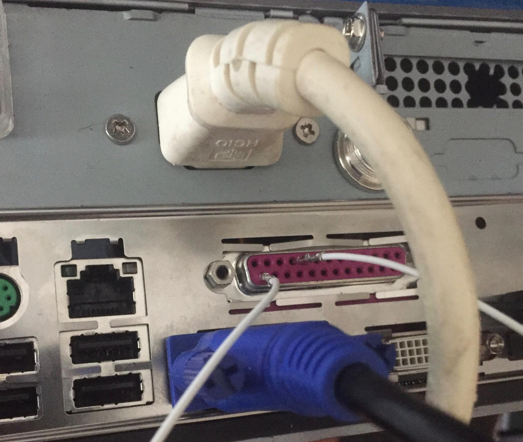

Hmmm, the PC parallel port is female - you need to short these out either on the PC port itself, or on the other end of that cable.

Can you measure the pin 17 voltage on the parallel port, with respect to gnd (any pin 18 through 25). Again, this is computer-side only.
From the RUN page, slew the X axis left and right (verify with DRO). In one direction you'll get 5V on pin 17, in the other, 0V.

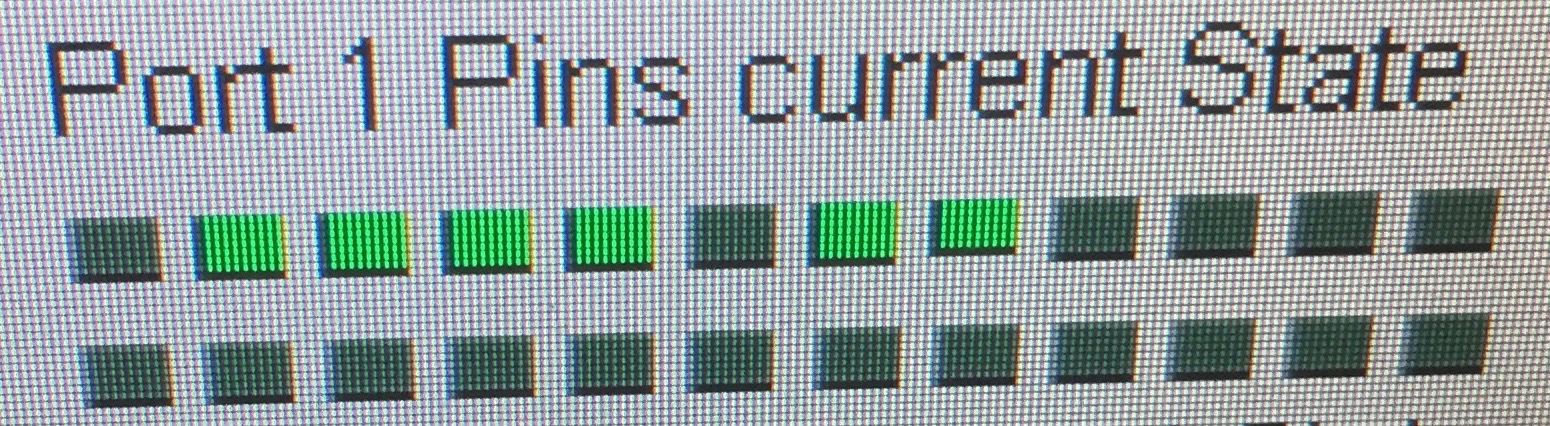

Let's test that the inputs into the parallel port are being read correctly by Mach3.
Use a jumper to short from pin 25 (GND) to pin 10 - on the PC's parallel port...
Attachment 26297
On the diagnostic page...
Attachment 26298
Move to 25->11
Attachment 26299
25->12:-
Attachment 26300
25->13:-
Attachment 26301
25->15 (NOTE: skip 14 - that's an output!, not input):-
Attachment 26302
Confirm that behaviour then we're confident that the parallel port inputs are able to be monitored by Mach3.
If that works, short the X-DIR pin to one of the inputs, for example I shorted 17 to 13...
Attachment 26303
Now, by using the cursor left/right and verifying the change in the "X Pos" on the diagnostic screen, I can toggle the state of the pin 13 LED. This verifies that the Mach3 X-Axis Direction output can be set correctly by Mach3. Note, I'm ignoring the X-Step signal because this is a very short duration pulse that won't be shown on the LED status on the diagnostic page.
Ignoring the Step signal - which is critical to this, but noting the difficulty in measuring it. If the X-DIR signal and X-Step signal work then the X-Axis of the machine when plugged in should work and should be under user control with the Cursor Keys. If not, then we move to the Syil.

Right. I'm reasonably happy that the PC/Mach3/Parallel Port is working at least in part. Of interest, we know that all the inputs are working and at least the X-DIR output.

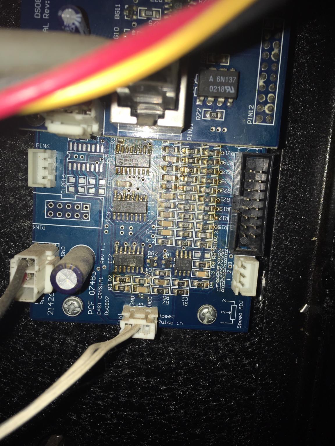

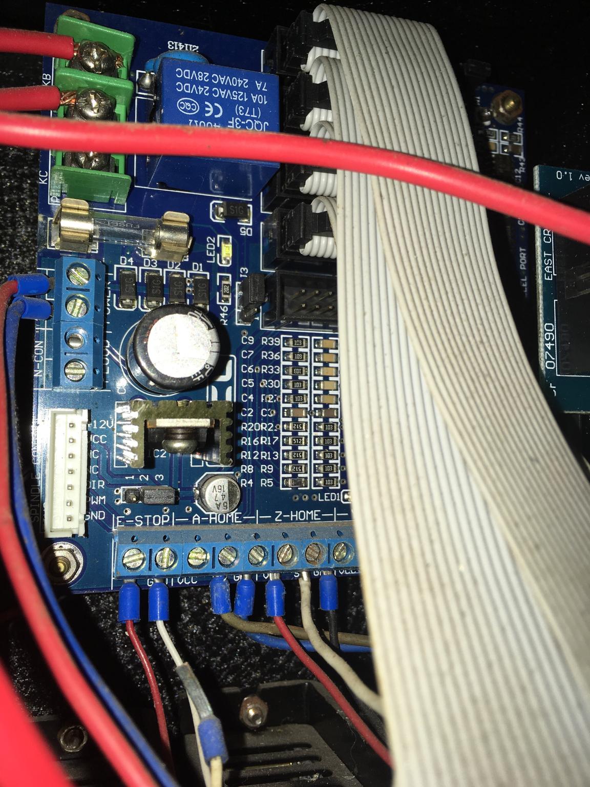

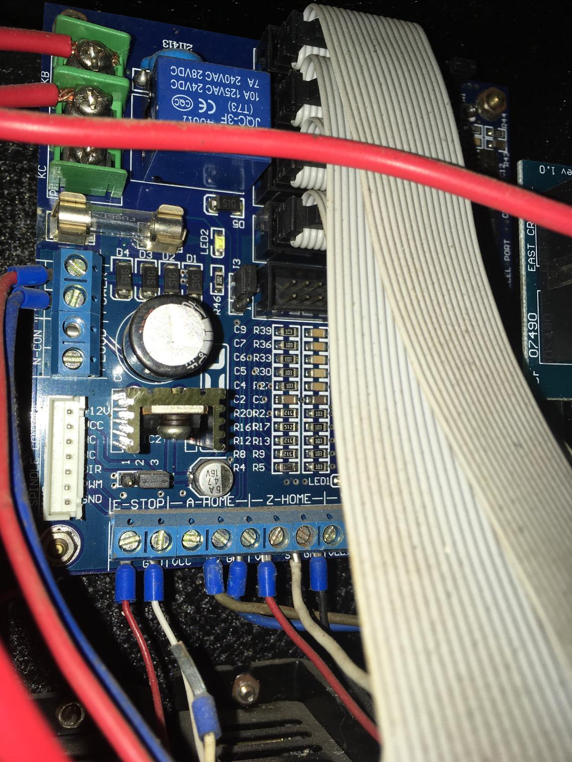

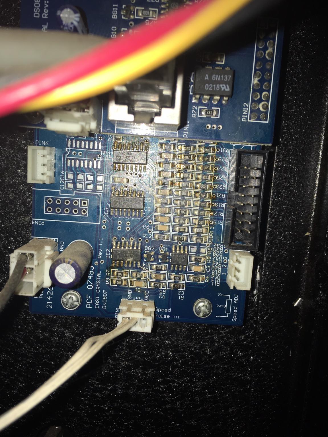

I’m not sure if this is anything but yes the estop is wired directly to the bob - however
There are 2 wires that run from the bob to estop -half way along they are inserted into a ‘plug’ then continue onto the estop.
The plug is male and there is its female companion vacant nearby on another board - is this a coincidence or should it be plugged in?
Attachment 26314
So white and red go to bob and the red and blue go to estop button

This worries me a bit. I would NOT plug the connector into the board - from the schematic and the legends on the board I do think that the board terminal is carrying 24VAC for the E-Stop relay, plugging it in could throw 24VAC into the BOB input channels. You've already established that power is present on the BOB which means that the schematic and the E-Stop isolation of the BOB isn't effective (wired).

That board is the spindle board. The connector is the enable and is being used to signal E-stop occured. The pins could just be jumped and it would work.
If your 100% sure BOB is getting signals then start by making sure power is getting to the Bob.
The schematic shows that the E-stop controls a relay which provides 12v to power the BOB and the spindle board. The E-stop on the BOB is just shorted to Gnd and isn't actually used thru a E-Stop button.
This is a simple BOB and should work if provided with power and signals. Nothing else external controls it's functions ie: enable, charge pump etc.
If its getting power/signals and your pin settings are correct then it will work. So if it's not then call it dead and move on.

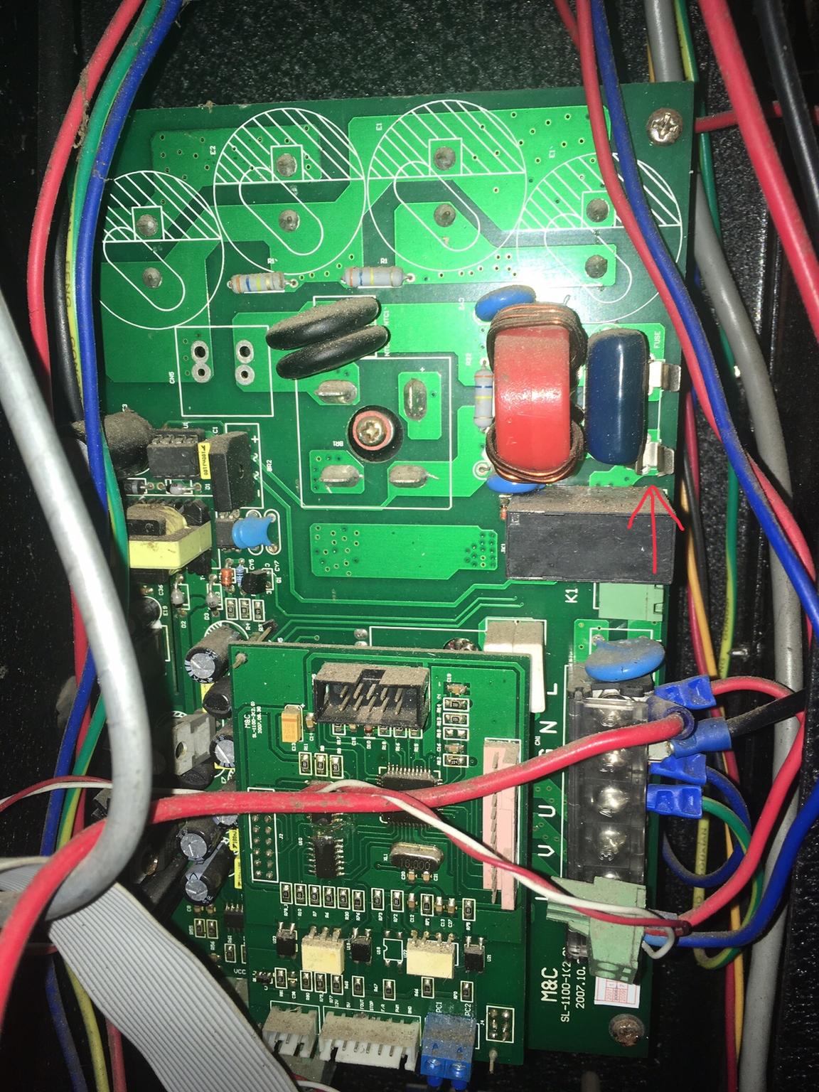

Sorry, I know more questions than answers. That board that presents the connector similar to the ESTOP connector - there's three wires - L, N and FG wired up. Is there ANYTHING else wired to that board?
This is really looking like a FrankenSyil machine. That board ("Main Board") is the primary supplies for the rest of the "normal" X4 as well as the 3-phase controller for the brushless spindle motor. None of that appears to be wired. If that's the case, it's not necessarily a bad thing but might help us understand how much of the standard Syil configuration can be ignored. Right now I'm half convinced you can lose that board.
I’m guessing there should be a fuse here?
Attachment 26315
