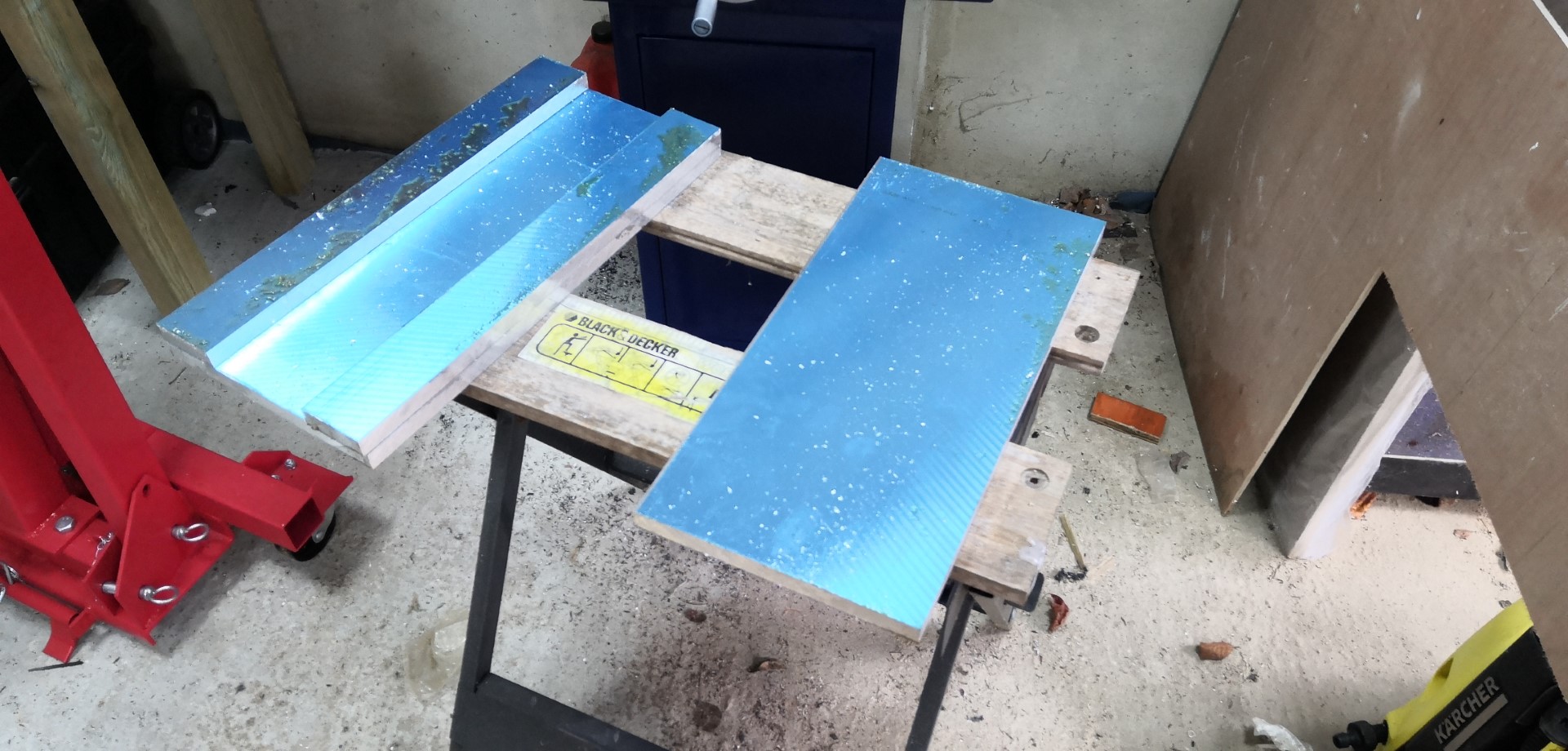

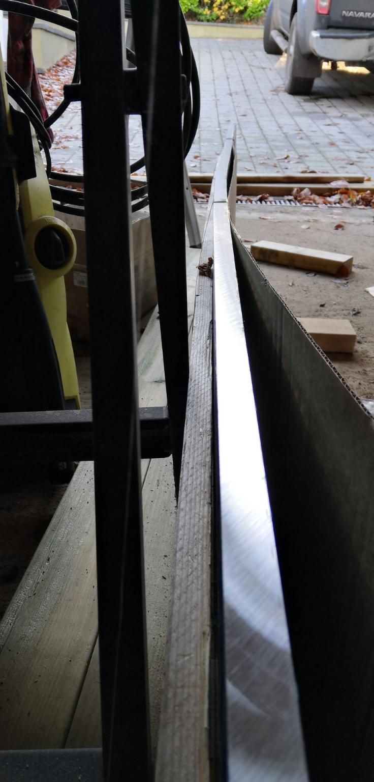

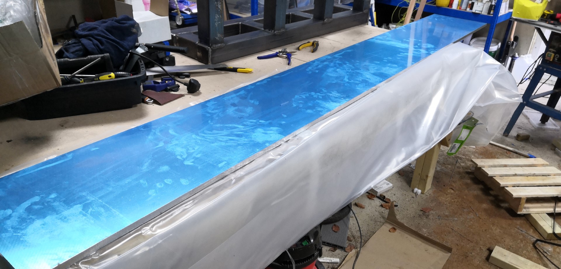

5 Attachment(s)
Re: Joe's 1000x600x200 steel and aluminium router started
Well I've milled 4mm either side of the slot flat on each side of the extrusion. Setup took a long time making sure everything was flat with the dial indicator, nipping up the gibs to try and counter the sag from the long overhang. I pretty pleased with the result, seems at least as flat as the extrusion. I need to get some rails mounted to it and make the Y bearing plates so I can see if it is sufficiently parallel to be usable. DOC was about 0.25mm with a carbide endmill, could feel it was cutting deeper on the outside due to the increased slope as discussed in the previous posts.
I had to make the cut in two steps, moving the beam and refixing between cuts since the mill table wasn't long enough. I can see the transition but cannot feel it. Nice hatch marks show the head was in tram.

I agree with voicecoil. My only suggestion when you cut the other one would be to support that overhang with an elastic luggage strap from the roof of your shed.
Kit
Hi Kit, I cut them both in one sitting yesterday, i measured the effect of the sag over the saddle with a DTI 4mm offset from the spindle (I used an 8mm endmill for the facing operation) whilst lifting the weight of the overhanging part, didn't really have any effect with the gibs tight as you would expect given the table pivots on the saddle. Probably not an acceptable way to fly cut but with a small endmill it works. I thought about slinging the overhang to my engine hoist but the problem with that would have been as the table is moved to the other end you would need to reverse the force since it becomes overbalanced the other side.
I think the best possible way to balance a job like this is to put a sliding counter weight inside the extrusion and move it through as the work moves (in the opposite direction), but I couldn't be bothered in this instance, if I was using the large fly cutter I would have had to bother else it would have cut a tapered scallop in the top surface.

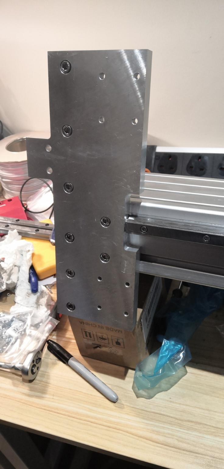

3 Attachment(s)
Got the rails mounted on the milled gantry, worked really well. I've tightened them down but not yet aligned straight, for that I will mill up a couple of precision setting tools.
I then finished the Y bearing plates and bolted everything together. Everything slides very smoothly with bolts tight, very exciting! The Y bearings have the same smooth action across the entire length with no hint of any variation so I presume the gantry milling was sufficiently parallel.
Attachment 26939 Attachment 26940 Attachment 26941
One thing I need to do before too long is hit the corners of these plates with a sander, they are razor sharp and I keep bleeding all over the lovely shiny parts.

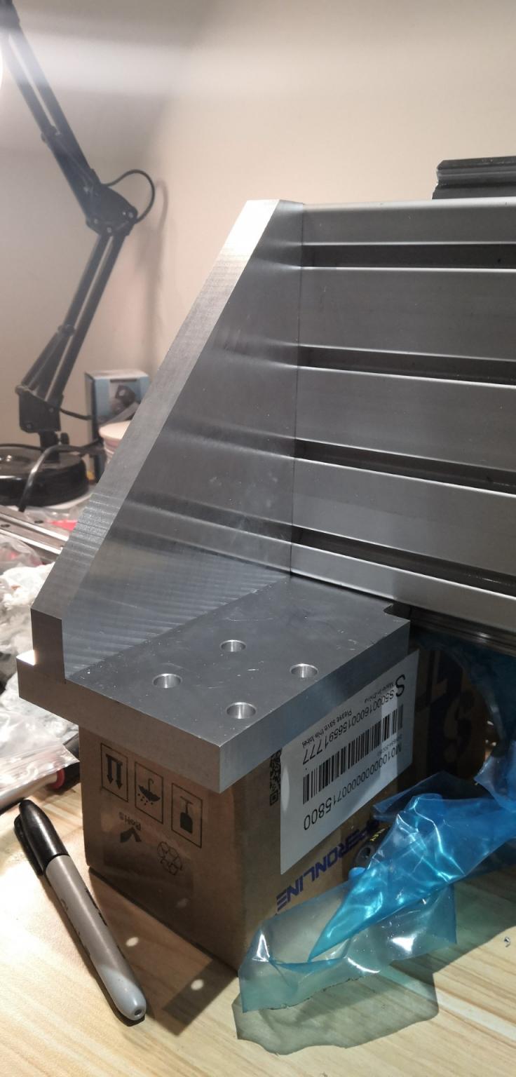

5 Attachment(s)
Happy new year everyone!
Small progress update, I have finished the gantry end plates and X bearing plates.
Attachment 26970 Attachment 26971 Attachment 26972 Attachment 26973 Attachment 26974
I have about 6 small plates to make for stepper and bk mounts then finished with the manual milling.
