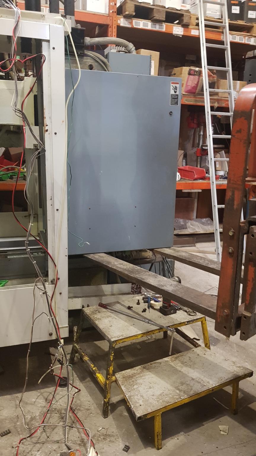

Ok quick update.
I'm still in the process of trying to decide which controller I'm going with. I'm narrowing it down slowly and I think I'm nearly there.?
These are the candidates that are still in the running.?
Linux CNC with Mesa Cards 7i76e + 7i85 which I've already purchased and are currently being played with by Clive (Clive S) testing with AC incremental servo's and closing the loop back to Linux CNC.
Next up are two Chinese industrial controllers both using 2Kw Bus type Absolute Servos. Newker 1000-18i-Mi and Gunt - 350iMa both with C type Subpanel with MPG.
These are interesting to me because I like the idea of an industrial controller without a PC. I also like the idea of Bus type Absolute servos because of the ease of use wiring/setup and servo's always knowing their exact location even after power down so not having to install limit or home switches.
My reservations are both of them are Chinese and I'll be dealing with Chinglish manuals which won't help when it comes to writing ATC macro's and using PLC.
However, I'm used to Chinglish and dealing with Chinese company's and the price is very very good.!
Only downside is I won't be able to use my 4th Axis so I'll probably sell that if take this route.

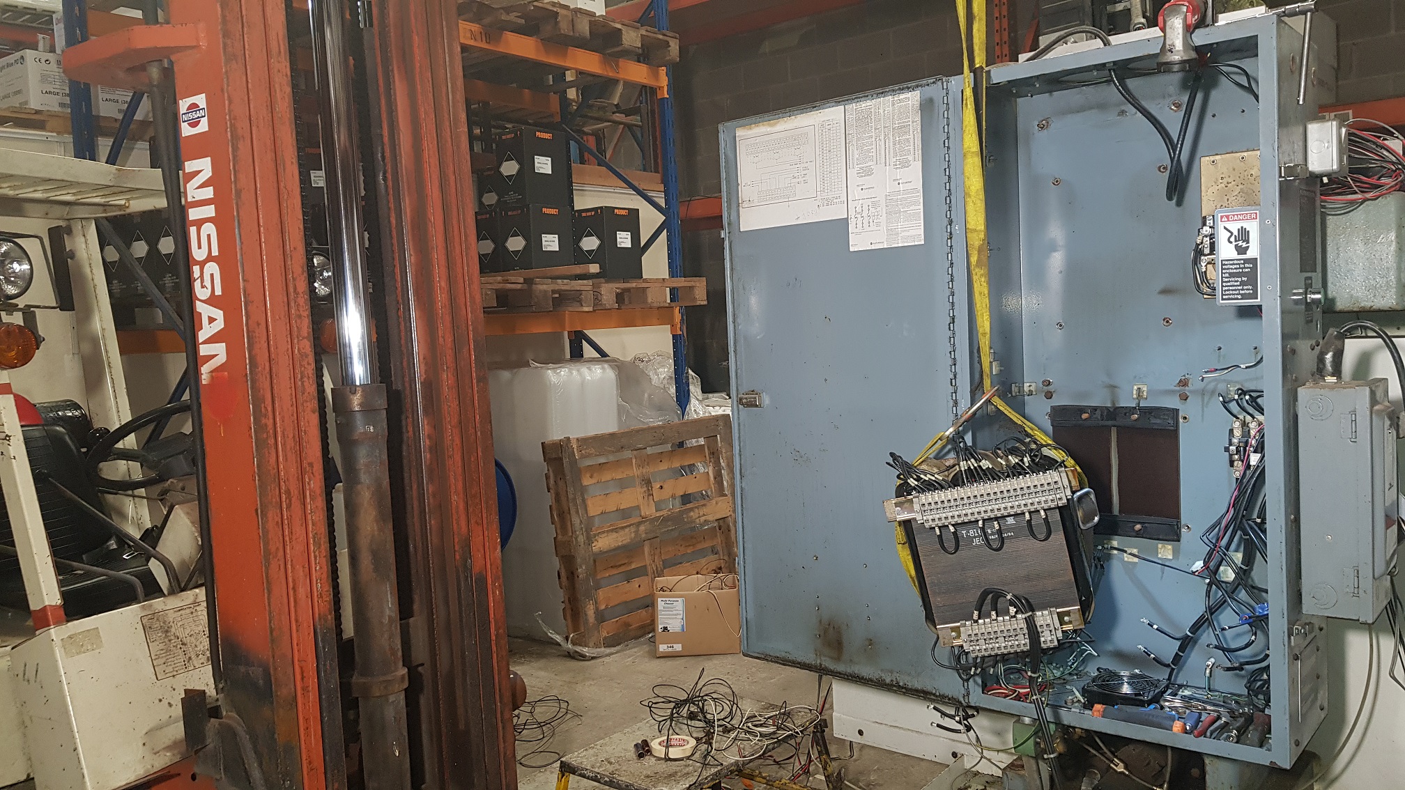

Ok well, it's decided I'm going with the Newker New18Mi Bus type Controller with 2Kw absolute Motors and drives.
Attachment 27382
It's a bit of an unknown using this controller and the Bus type controller but I've read the manual cover to cover a good few times and Newker has been helpful answering my questions quickly with good explanations of few things I wasn't sure about. So decided to give them a shot and the price is excellent, which I won't disclose as I promised them I wouldn't because they have done me a bit of a deal so please don't ask.
If it performs as I hope then it should make for a very nice addition to the machine increasing performance and reliability.

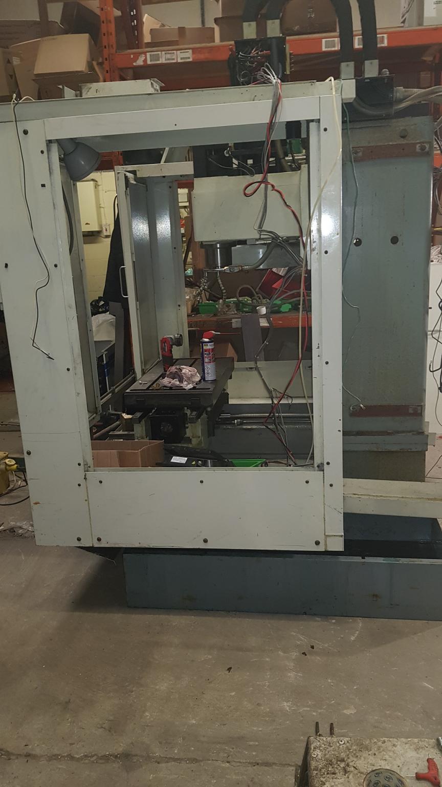

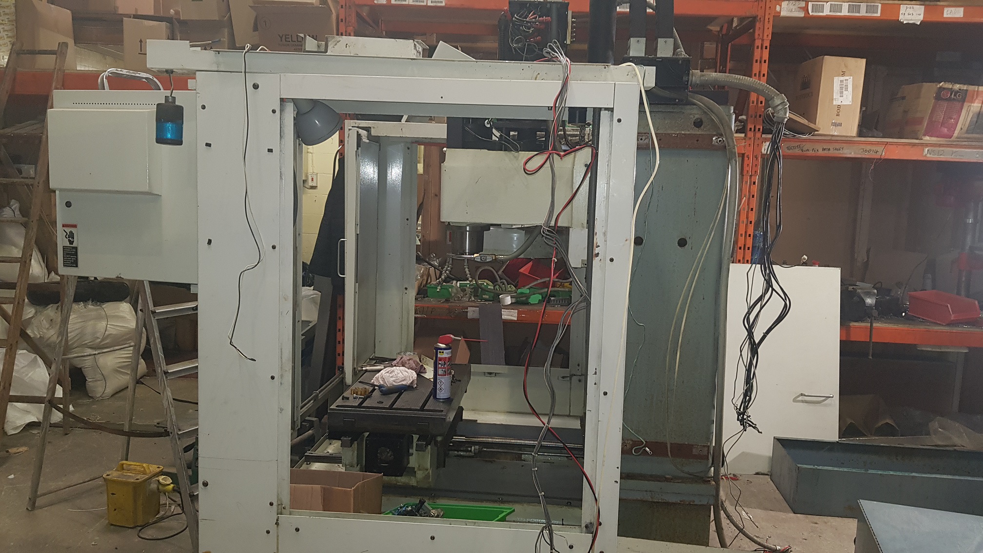

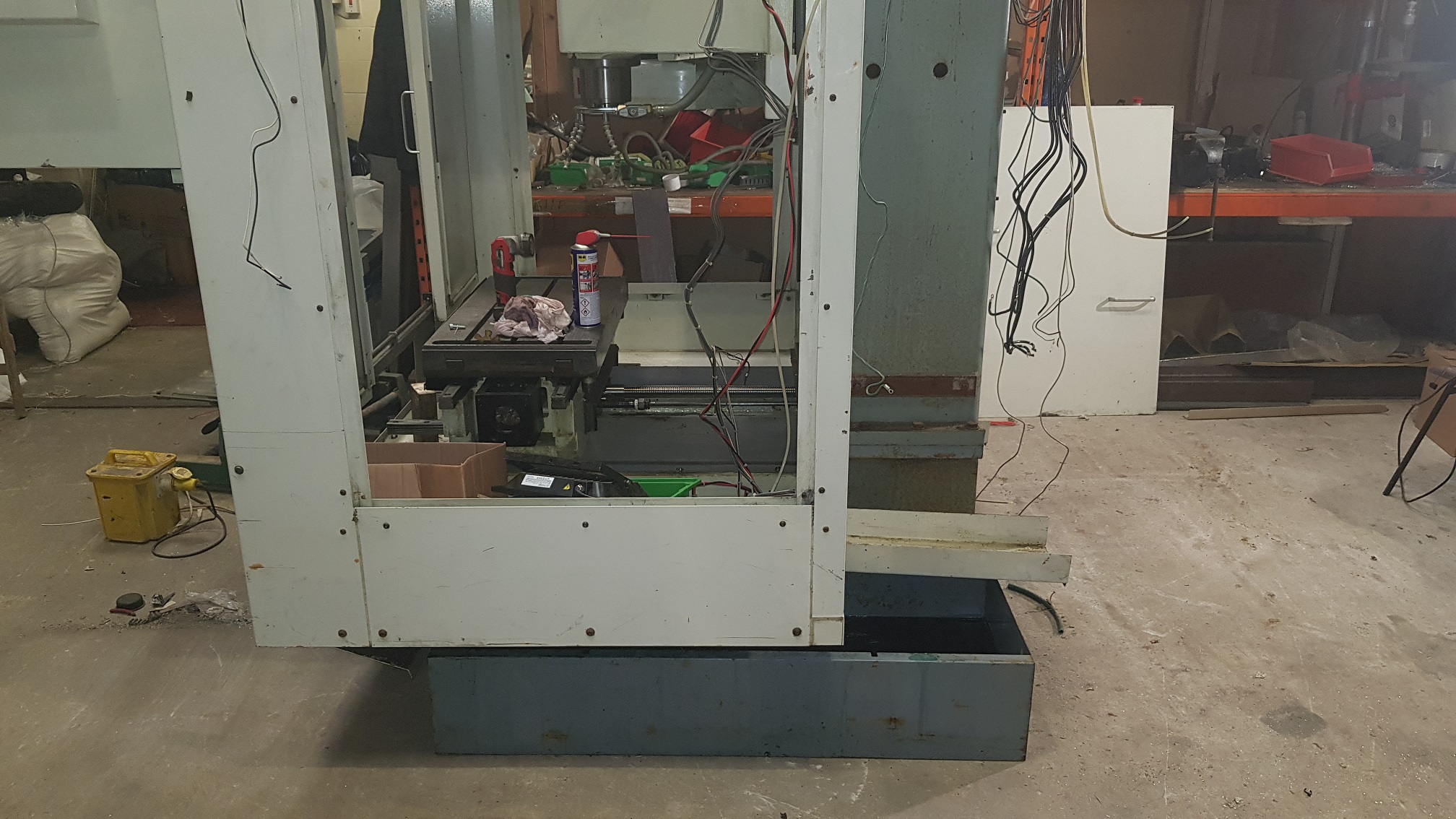

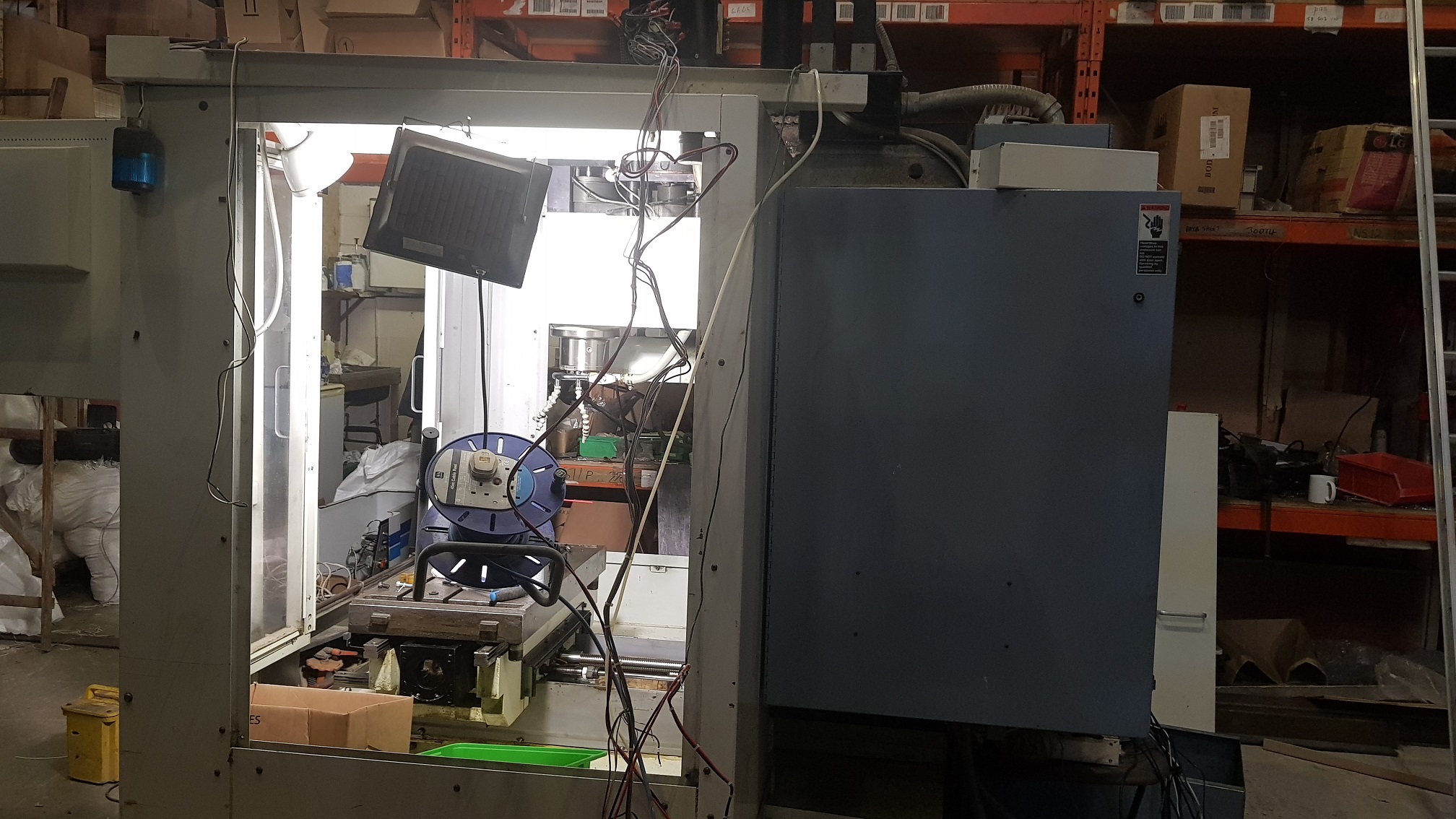

Ok well bit of an update and a little twist in the plan.!!
https://www.youtube.com/watch?v=LlHceUhKTIY
Looking good Dean:toot:
Dean - you mention running this off single-phase. What kind of spindle motor would that be? It looks like a big, heavy machine so 4KW or so spindle motor? Just curious - no way would it fit my workshop! Interesting to watch the design/component choice/build proces - thanks for letting us watch the thought processes!
