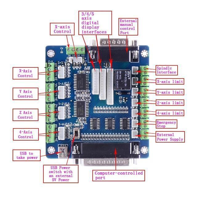

And do you think you'll need more than 10 inputs and 24 outputs.? I'm also not sure if some of those Outputs on the second port can be configured as inputs in software.? Only if you plan on having an ATC will you probably need more than 10 inputs.
Regards the Cheap BOB then yes, of course, it will make a difference. It's like having 500HP engine and fitting bald tyres.? Pointless.!
Any machines only as good as the weakest link so fitting a good card with a cheap BOB that probably can't keep up doesn't make sense to me. This whole thread proves this.
I fit good electronics, which yes cost more, but I never have any of this shit to deal with and the extra cost is made back by the fact I'm not running around fixing machines or put another way the owner doesn't have any downtime which costs money.!! . . . . You get what you pay for.!
If your going to use a cheap BOB then save your money don't buy ESS or ETH400 and use Linux CNC. You have half a chance of good machine and won't cost anything other than it's a steep learning curve.

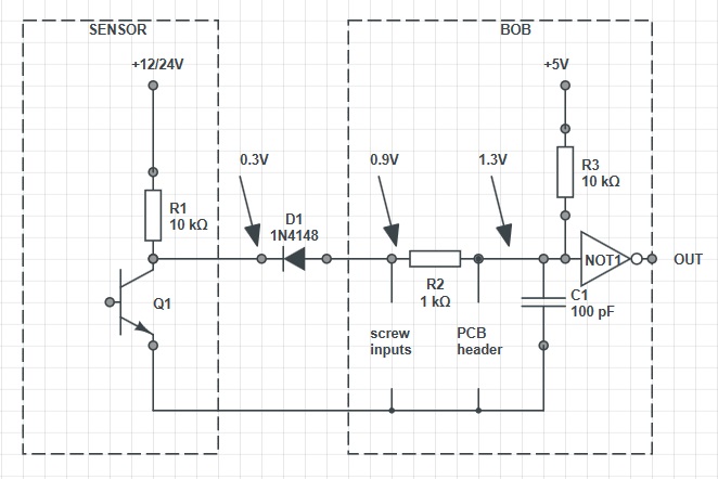

Embarrassing but I must own up: I realised during my tests that for all these years I've left the 36V supply for my stepper motors floating. Neither rail was grounded so the whole supply was bouncing up and down by 8 Volts at several KHz. It's a miracle the machine worked at all! Any way that's now fixed and some of the bits from RS have arrived, though not the screened cable for re-wiring the sensors yet.
Fortunately I have access to the highly sophisticated electronics test laboratory shown below and have been able to make some very revealing, noise-free measurements on the spare cheap Chinese breakout board. Earlier reported voltage measurements were made in the presence of noise and are not reliable.
With an input fed to the board header rather than the screw terminals, a falling voltage must drop below 0.6V to set the output of the board. A rising voltage must go above 1.7V to reset it. This gap is the hysteresis we expect from a Scmitt trigger input chip and provides some noise immunity.
When using normally closed (NC) microswitches as sensors the inputs are a good solid short circuit for most of the time and only open briefly during homing. Excellent noise immunity is obtained in this configuration as proved by the fact that my machine has worked reliably for a few years!
Using proximity sensors presents a problem, even with opto-isolators or other electronic interfacing, since the saturated collector-emitter voltage at the output of the proximity detector or from an isolator when triggered is about 0.6V. No guarantee of reliable triggering here even without noise. The use of a potential divider circuit as described earlier is an option but I've decided to use a more direct and low-impedance option... reed relays. These will be fed by an NPN emitter-follower transistor which serves to boost the current available from the proximity sensor.
Some will scoff no doubt, but it actually makes sense for a few reasons:
I know from past experience that a solid short circuit on the inputs works reliably, even in the presence of high noise.
Low-pass filtering is excellent and requires no additional components.
When wired as I plan to have them, with the 12V from the sensor holding the relay contacts closed as the normal state (this mimics the previously known-good NC microswitches), the circuit is proof against wiring faults as any breaks will trip the limit input.
Regarding positional accuracy, a key point of using proximity sensors is improved repeatability over microswitches. The reed relays I'm going to use have a specified response time of 0.5mS. Allowing for, say, 20% variation that gives a repeatability of within of 0.1mS. I can't remember exactly what my second approach speed is set at for homing in LinuxCNC but if it's even as high as 1m/min that equates to a variation of around 2 microns. Which equals nothing.
The 4 relays are $20 the lot from RS, the transistors and a wee bit of veroboard are existing stock worth much less. The whole circuit has been tested on the bench ( I have 2 relays in stock already) and works a treat. So I might just have a fully working machine again well before Mark McGowan let's me back in the pub!

I'm somewhat surprised with the Vce(sat) for the opto, but if that's what you've measured then that's what it is. Personally at that stage I'd be using change-over contacts for single-switched inputs and using NC=gnd, NO=5V just to yank that signal line to one rail or the other (nothing left floating).
For the nay-sayers, what Kitwn's post is providing is belted-and-braced robust and deterministic behaviour. There's too many problems in the world to save pennies on uncertainty on our machines.
Perhaps I'm feeling humbled after a day's worth of trying to get my control box switching automatically between two machines... and making some stupid assumptions... right, where's that damned scope gone...
Not measured on a specific opto, but it is the measured output voltage of the proximity sensor when triggered. Opto outputs will vary depending on device and load current but with only 0.6V to play with I'm not chancing it. I was surprised at the low trigger voltage, but it's what I measured on the board input and the chip spec says it can be as low as 0.7V
This is likely to be a problem with any board that only uses 5V logic on it's inputs. I assume the more expensive boards are more sophisticated. They'd better be for the difference in price.
I'm happy that the 10K pull-up on the board will work OK with the single pole relays. The relay will isolate the actual board input from any noise on the wiring from the sensors and the overall noise level is going to be significantly reduced by my improvements to the wiring overall.

EDIT: Been doing a bit more looking at opto-couplers and there certainly is a big range of options. The Darlington output types have a higher saturated output (up to 1V) compared to the conventional type (as low as 0.1 - 0.2V at low current) so you really must choose your device, but there are devices that would interface successfully to the cheap card. Since this application is at a guaranteed very low frequency I'm happy to let old technology do the job this time.
It's a shame they've used a 74HCT14 for the buffer on your BOB, the old (and now probably uncommon) 40106 hex Schmitt buffer was a better chip for such purposes IMHO, as the threshold voltages are more or less equispaced around 1/2 the supply voltage, something like 2.3V & 2.7V.
