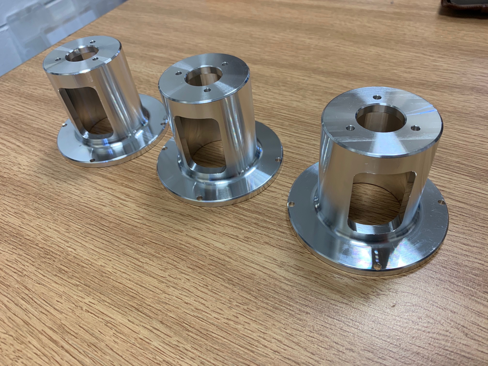

Started getting everything mounted up in the cabinet now, changed the layout god knows how many times. The base plate's like swiss cheese now!!
Got the mounts for the encoders machined up to bolt to the motors, they add a bit more length than I would have liked but I didn't want to start modifying and shortening the motor shafts really so I'll just have to live with it. Once (if) it's up and running I'll make a cover to protect them a bit more.
Also finished the new pulley mount for the Z axis ball screw. (and yes, I did reassemble the ball screw the wrong way after machining it...that was rather annoying to assemble twice!)
Starting to get somewhere now though!

I enquired about buying something small from them once - think it might have been a line driver board - but never got a reply. You might need to give them another nudge until you get a response or you may not see it. Larger orders possibly attract their attention more easily.
Dunno if you are aware that there is a cncdrive forum - you may be able to contact them through that http://www.forum.cncdrive.com/
Those housings look the part. Good to have access to decent machines when doing this sort of work.
Looks as if you actually replaced the Z axis ballscrew / ballnut? Did you enjoy machining the hardened steel? Sparks everywhere?

Yeah that did cross my mind, the initial order was quite a chunk of money and I had a reply within a few hours.. I'll give the forum a try, thanks for the link.
Thanks, it certainly makes things easier! Worth taking the extra effort to make them properly, hopefully less head aches with setting them up knowing they are machined properly so the alignment between them should be good.
I replaced them both in the end, the old screw was cracked and it was an odd size. Also needed new bearings as well so just replaced the lot. Can't beat a bit of hard machining, sparks were disappointing though! It was actually worryingly not that hard if I'm honest... looked to be case hardened around 3mm per side, the rest was really soft...
