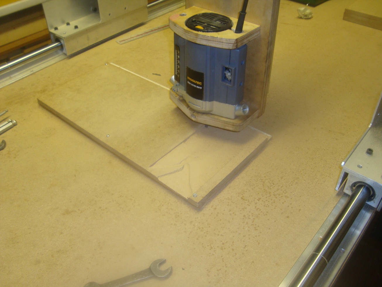

Finished all machining for router this morning! *Just* needs assembling - waiting on my dad to put some bigger legs under it since the previous arrangement was designed for a 10kg gantry, not >50kg!
Been thinking about how I can clamp stuff to the bed to machine it. It would be nice to have T slots like on my milling machine since then I could use the same clamps and easily put the vice/rotary table etc on it. I do have some HSS T slot cutters however I think cutting MDF will destroy them.
My plan is to buy two sheets of 18mm MDF. Glue/screw one down to the bed, get the router to cut the wider part of the T in that and level it, then put another sheet of MDF on top of that and cut the top of the T slot. That way I can use standard router bits...My only worry is if MDF is going to be strong enough?
Just been making collets for the cheap router I'm using. I'll post a video here soon...

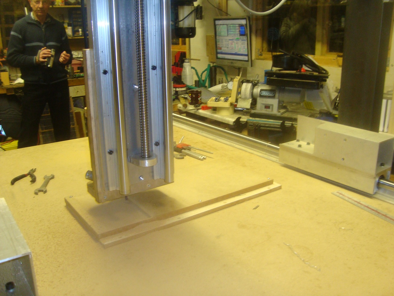

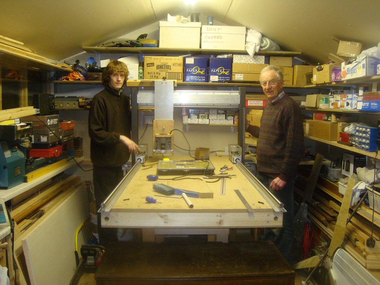

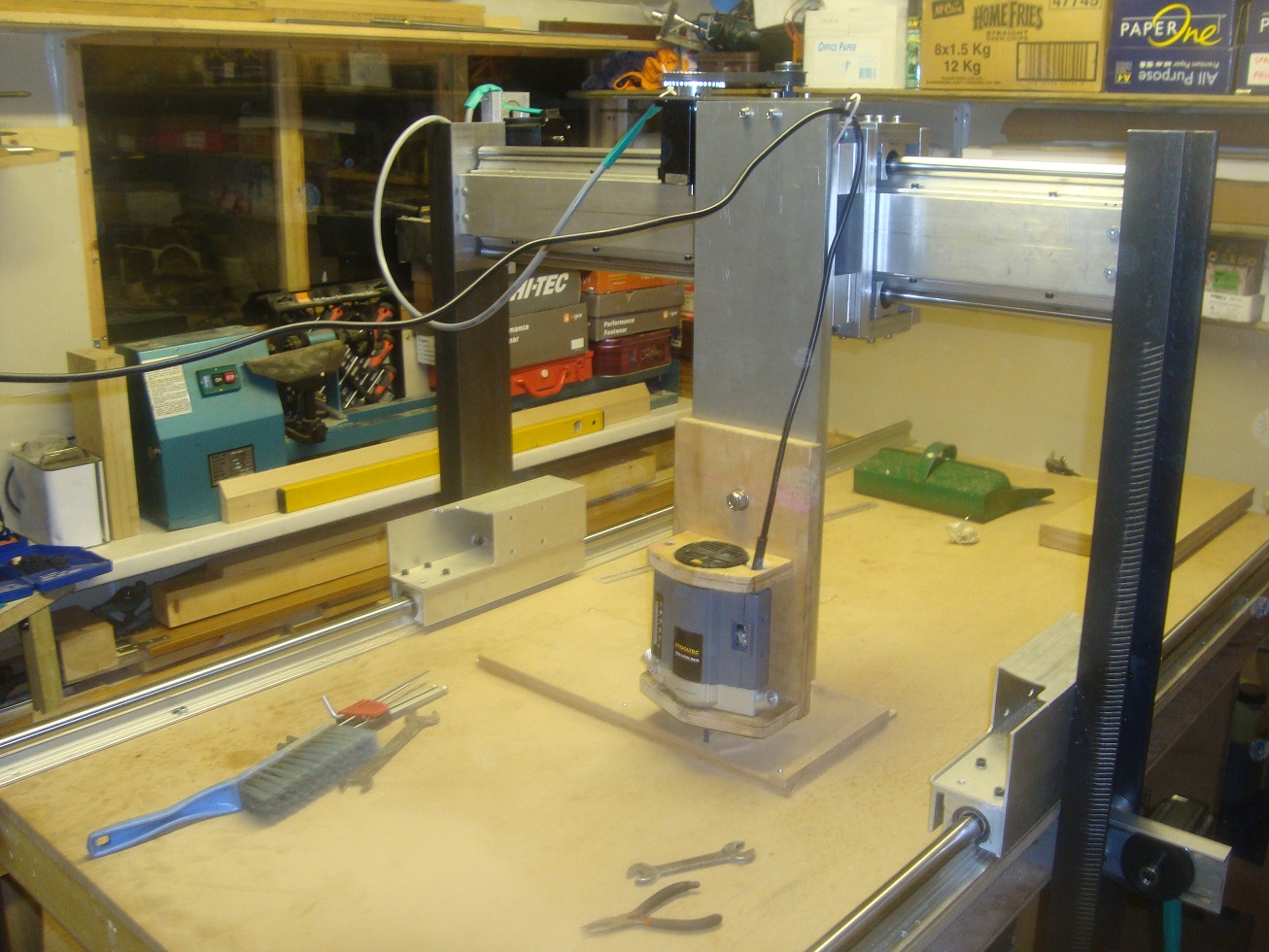

5 Attachment(s)
Re: 1.7*0.74*0.4m Mill / Router building...
Some pictures...
Legs:
Attachment 3488
Gantry side:
Attachment 3489
One X motor, need to tighten that belt:
Attachment 3490
Gantry side again:
Attachment 3491
Yeah my workshop is in disarray now:
Attachment 3492
looks well tidy to me:) i could live in that workshop
blackburn mark
It's much tidier than it was yesterday! There was a layer of swarf on the floor.
I want to get a metal bandsaw, but I'm rapidly running out of space.

It works!!!
I'll add photos/vid shortly.
I did a relief thing, 200x200mm ... 1mm stepover with a 6mm cutter. Varied the feedrate and seemed ok at 3000mm/min. One of the X motors stalled, twice, so that needs looking into. The result doesn't look very good, but that's due to using a flat not rounded cutter since I didn't have one.
4 Attachment(s)

Action shot, suspicious lack of swarf :confused::
Attachment 3496
View of gantry:
Attachment 3494
Z axis, extended to about 390mm:
Attachment 3495
Whole router, Dad snuck in on this photo (everyone suddenly appears in the workshop when it starts working!):
Attachment 3497

looking good jonathan (the router that is, you need a hair cut :)
hows it getting on with thet much Z ?
have you made a provision to drop the whole gantry down for your smaller /finer jobs ?

It seems fine. There's a bit of wobble visible on the latest part (see below), but I think other factors are contributing such as the whole router wobbling madly due to the floor not being strong enough...
I have measured the Z deflection parallel to X. I can bend the Z axis by about 0.06mm if I push as hard as I can with little finger, so a reasonable force but not huge. It takes a lot of force to bend it more than that which makes me think it's the linear bearings that are a bit sloppy. Not much I can do about that.
I've not made it so I can lower the gantry, it's far to heavy to be doing that sort of thing. I think I'll make a raised bed and machine aluminium stuff on that. It's a compromise, but the gantry sides are very strong.
Yes one X motor is much stiffer than the other. It's limiting my feedrate...
